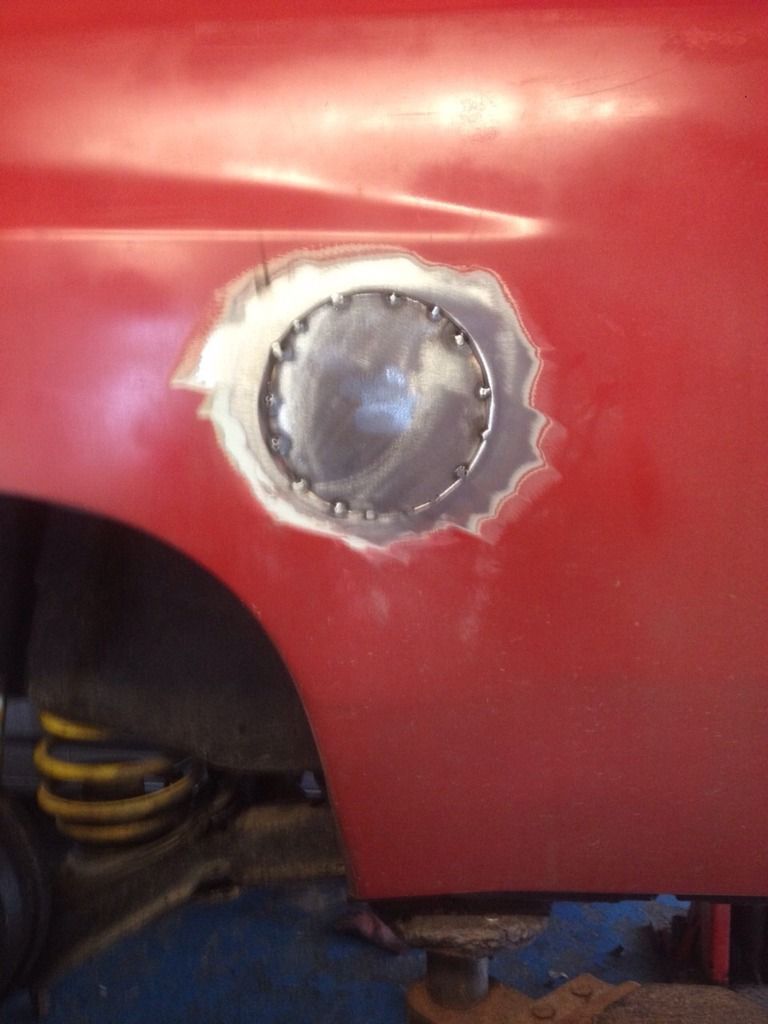

Reasonable, next was the filler location, brief chat with Iain, this seemed logical,
http://i27.photobucket.com/albums/c1...2F5328137F.jpg
Cut out and 5mm holes drilled ready to install
http://i27.photobucket.com/albums/c1...AEECE6795E.jpg
http://i27.photobucket.com/albums/c1...5C9C887C47.jpg
Looks alright, it was £60, lockable, I wasn't gonna pay £140 for the top of the range one, this one does the job

nice to see you placed the fillerneck in this position, I was planning on mounting my fillerneck just like that !
don't really like the silicone hose, I got my self one of these:
http://www.carbuildersolutions.com/c...57mm-2-14.jpeg
do you have any kind of rollover safety in the de fuelcell? in case of an accident you want the fillerneck to block off so the fuel doesn't leak in to the drivers compartment
He has rollover protection in the form of not going over 40mph on track
I spoke with CBS about the rollover device, the filler neck is sealed so in the event of a rollover fuel shouldn't be able to get into the cabin, but I'm working on a solution.
I did look at the flexi hose and liked it but CBS could only supply it in 500mm lengths and were out of stock today!!! I would have paid double for the black silicone hose but they were also out of stock!!!
The blue will do, I'm trying to fit in with all the Arden Blue Astras at PVS!!!

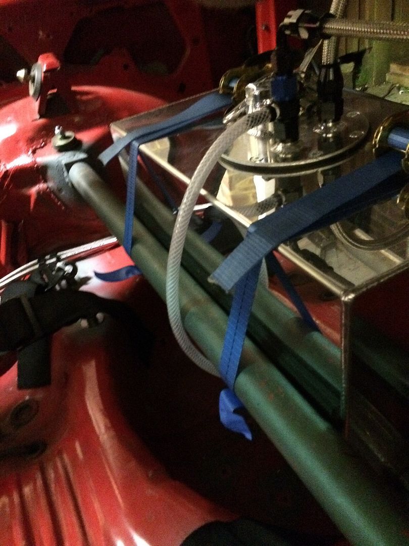

As I was sick of people telling me the ratchet straps (that were a temp measure) holding the tank, were the most unsafe thing in the history of car building and I should flog myself with 9 cats or whatever people got whipped with in the olden days. I decided proper tank mounts were required.
http://i27.photobucket.com/albums/c1...2E223CE651.jpg
Much happier and no comments from bellends at PVS!! I intended to remove the box and lower it as much as possible into the well but the chap that sent me the angle only sent 1 length instead of the 4 i ordered, so I've ordered more and once the tank is out of fuel I'll smash it on the proper angle mounts.

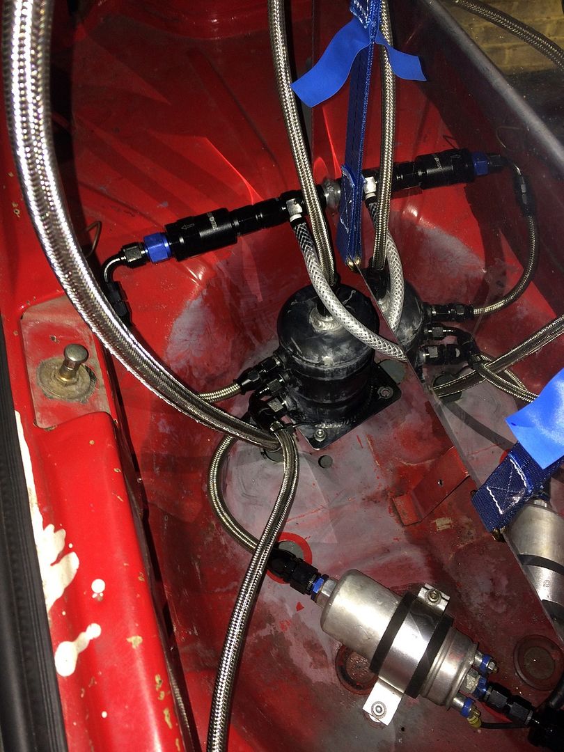

As you can see in this pic, rubber hoses for the FPR, I'd ordered an FPR with AN-6 fittings, decided to move it back up to the bay.
http://i27.photobucket.com/albums/c1...3B95FDDC41.jpg
Crap pic for some reason!! Wheel well looks so much better with all the proper AN-6 lines
http://i27.photobucket.com/albums/c1...DC383731B6.jpg
This is so much more gooderer. Made some changes to the lines from the bulkhead too, much prefer how they look
