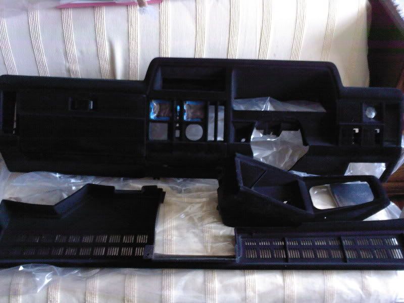

Cost ?2. ?2.50 posted. Each. I paid ?50 for the lot , so no profit etc etc..
cheers drape's. Hopefully it all look sweet soon.

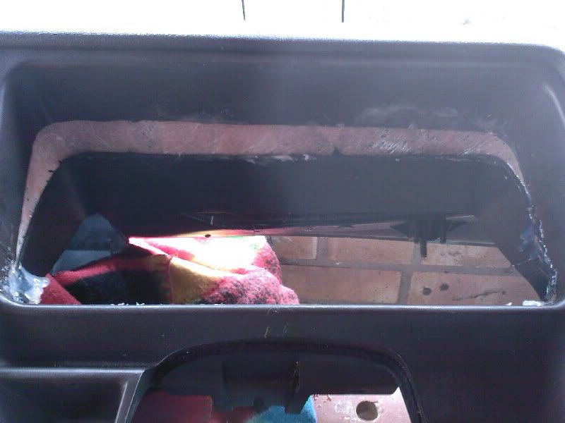

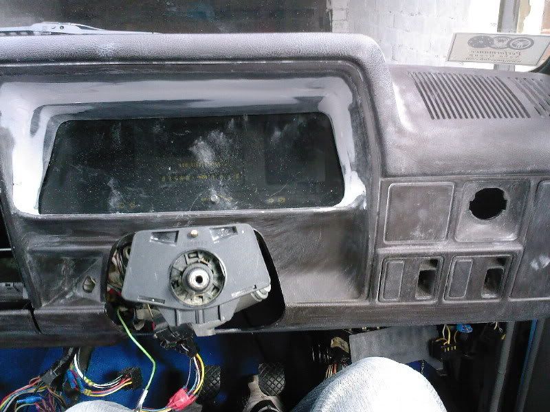

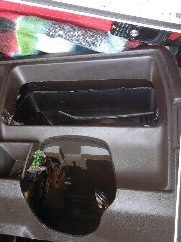

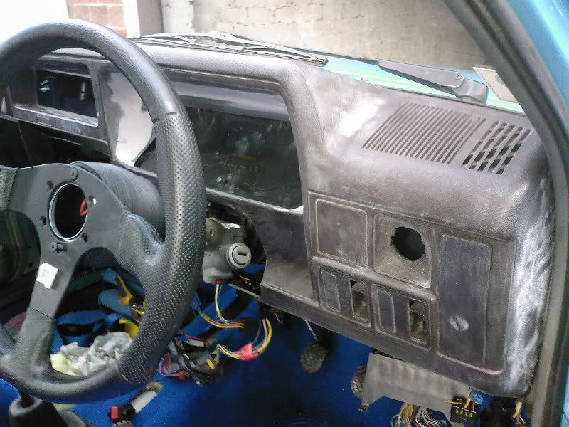

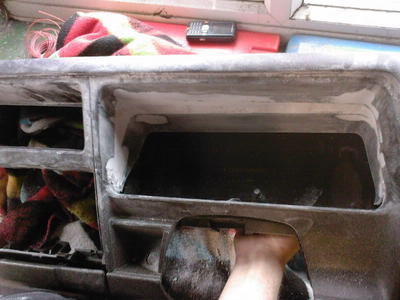

Pics below show progress with making digiclocks fit into mk1 dash. Basically, its gone the way of the filler. Looks messy at the mo.
We cut, in hindsight, a little too much of the mk1 dash off and with the mk2 astra clock surround (perfect fit fot the digiclocks of course) being a bit wider than the mk1 dash binacle, we've resorted to fibreglass n filler to make it all fit nicer, smoother.... Getting it all flocked; it will be hidden and look o.e.

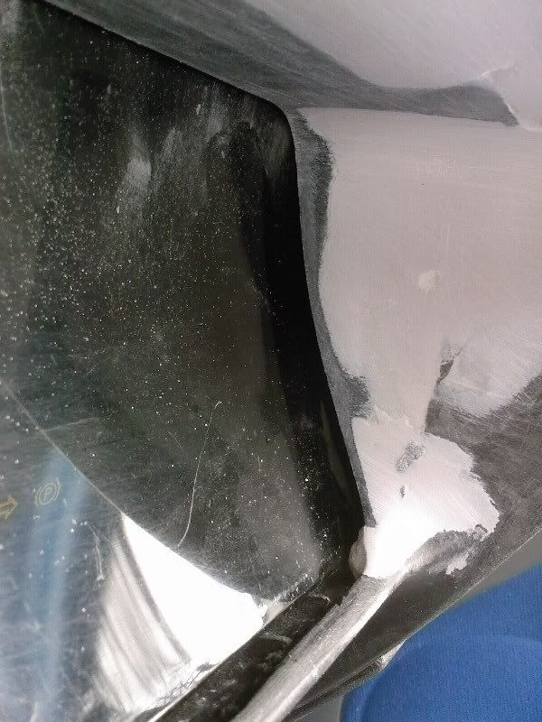

Trying it in the car, in a nut shell, its close - all thats needed is the two chunks of filler in the bottom right and bottom left corners of the binacle removing/flatting.. Then the clocks will sit flush against the now blended in astra part.
I fit the dash first and screw/bolt it up, drivers side - fitting the clocks after..

Nice work.
Looks a right nightmare trying to get a digidash into a mk1 dash!
liking the dash.wouldnt want to attempt it on mine.lol.
you want to do it for me?haha.
it is.. :( ermm... wudnt do it again. lol. thank god for the flocking is all i can say.
Looks like a pain in the a$$ but worth it. Once its flocked its should look ace!
