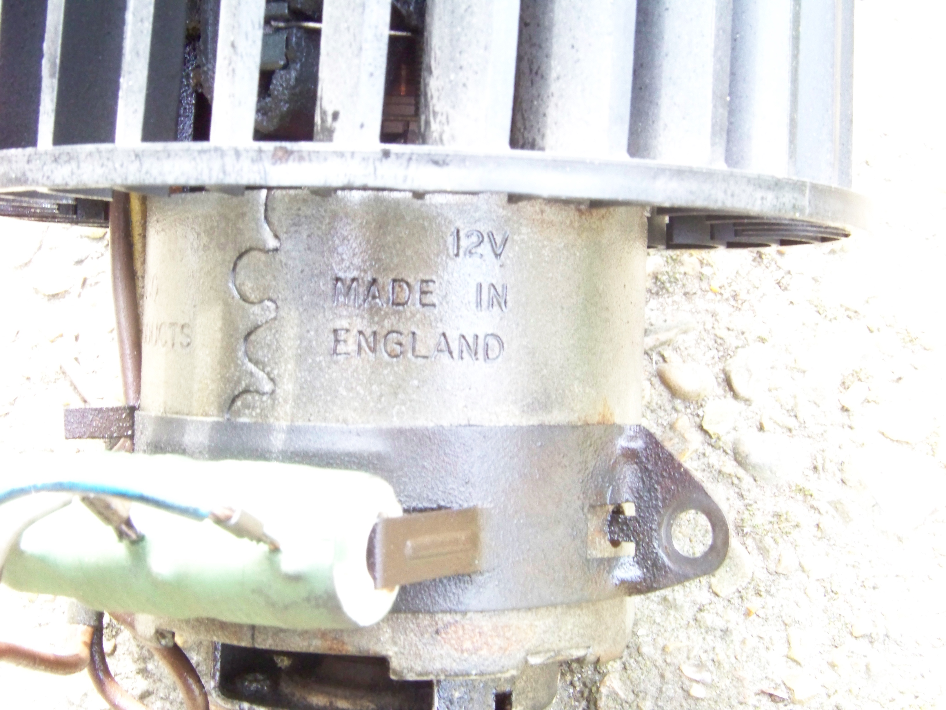

Another sunny warm day, so I got cracking with the bits I removed from the engine bay the other day.

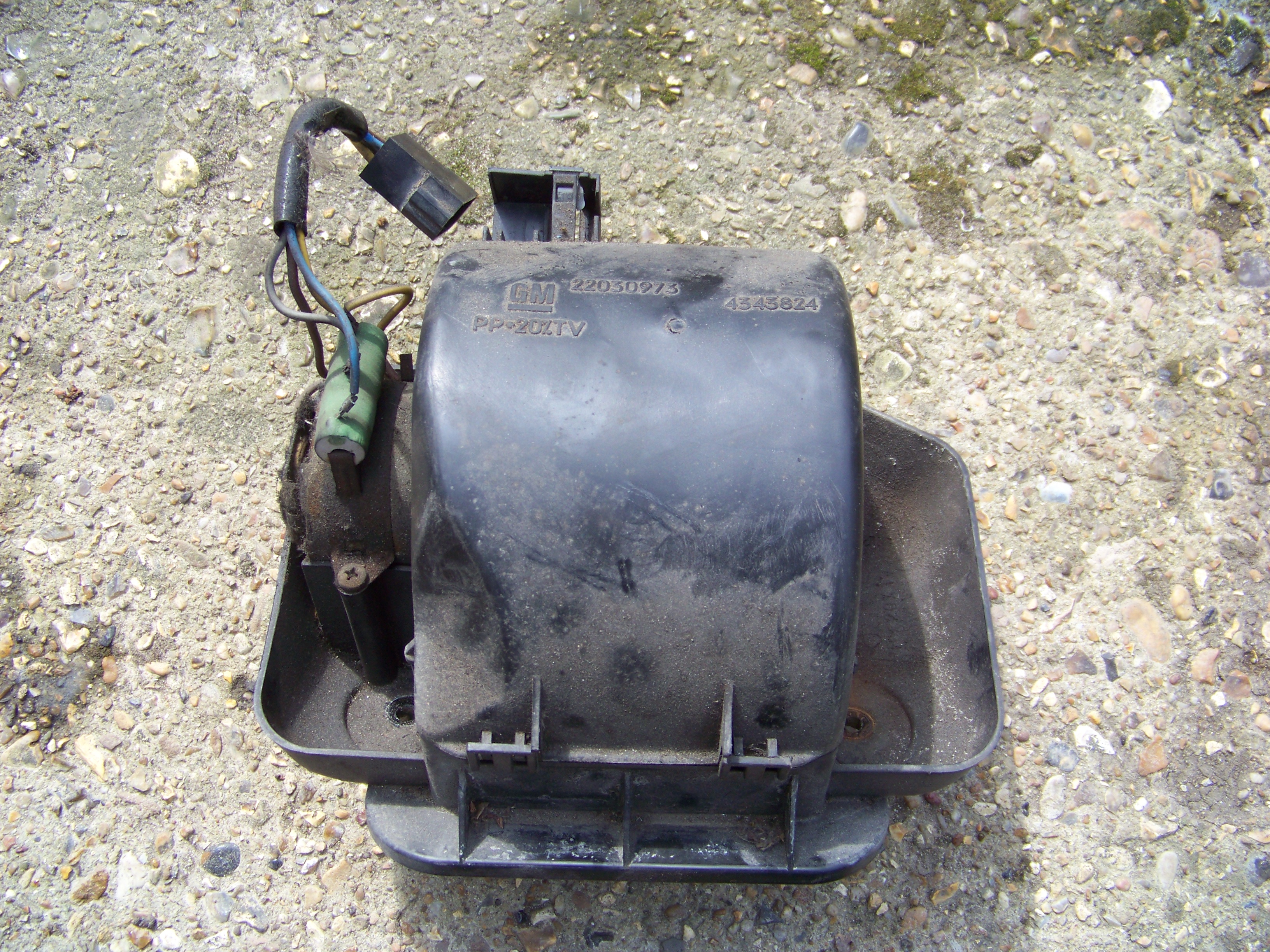

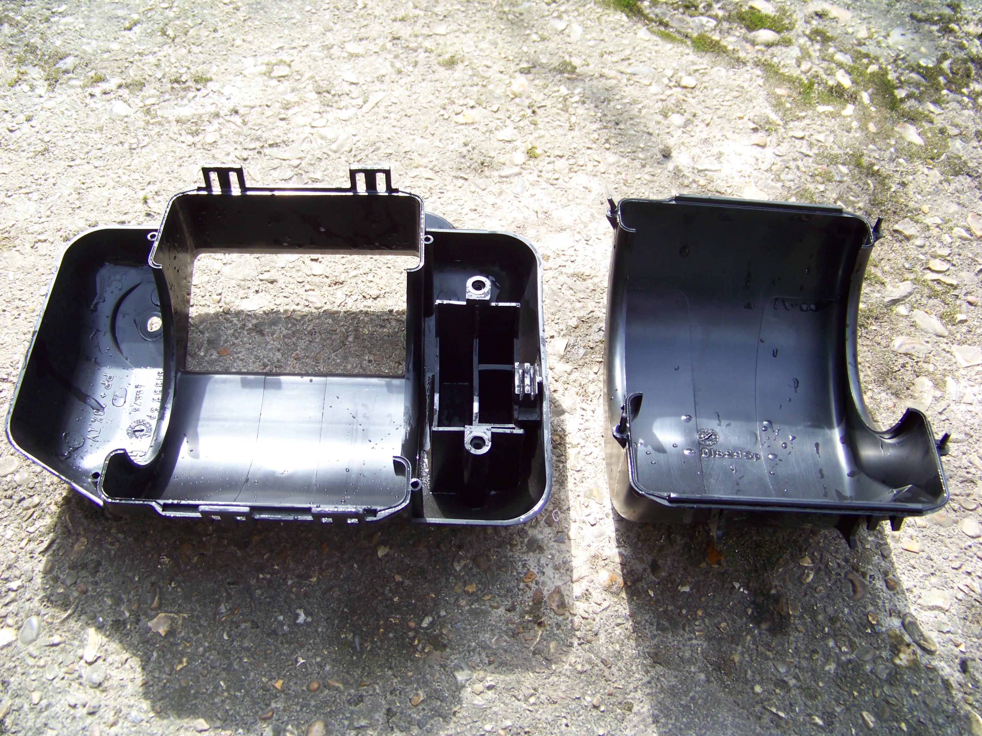

First up was the grubby blower motor... As it came out the bay
https://images2.imgbox.com/1d/1f/W0EnTSdS_o.jpg
https://images2.imgbox.com/fe/6a/hkfNGXjJ_o.jpg

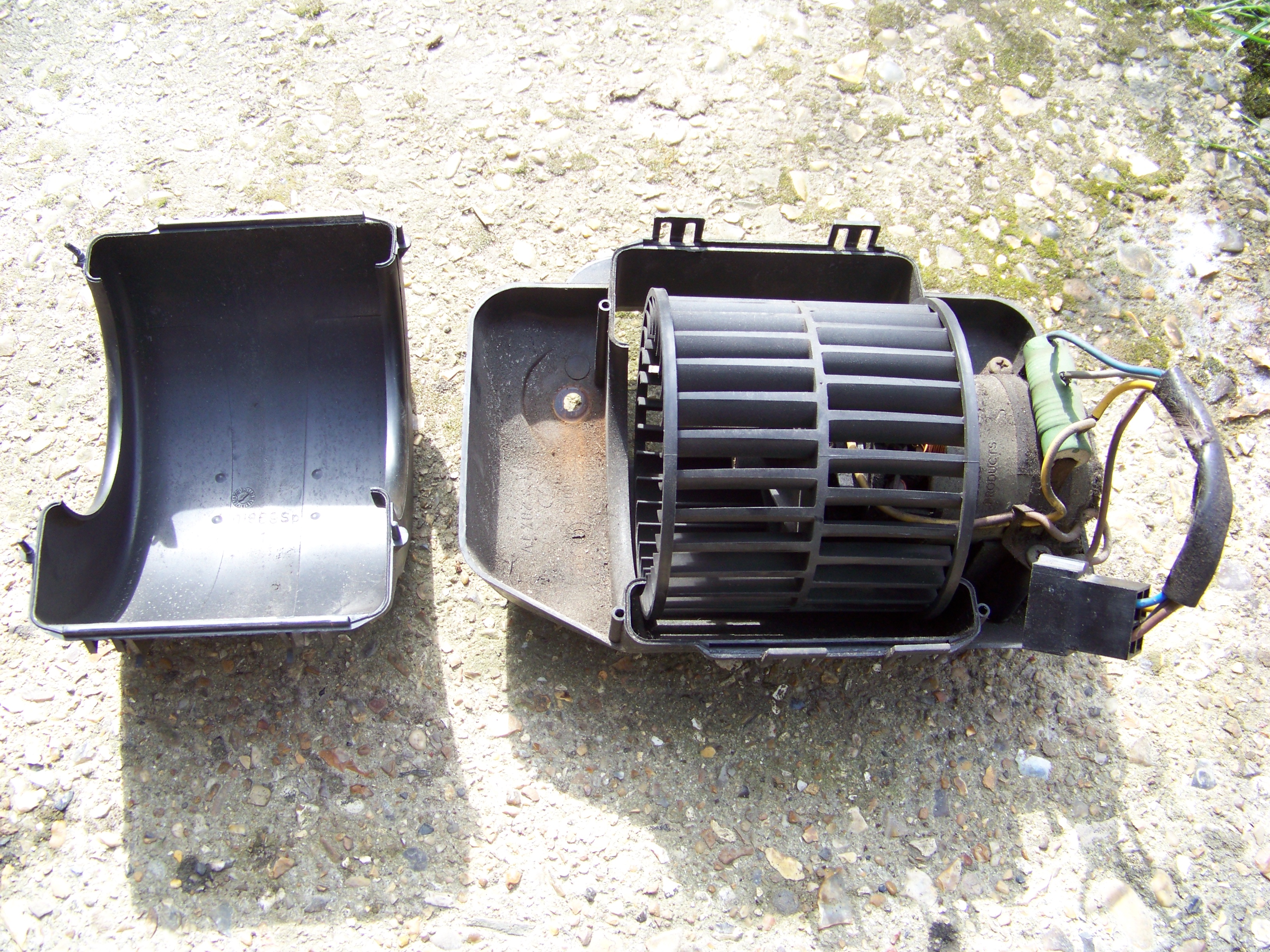

Started taking it apart
https://images2.imgbox.com/3a/d1/uqoGetYc_o.jpg
https://images2.imgbox.com/7f/74/Jtm0uH53_o.jpg
https://images2.imgbox.com/7d/a6/RoM2PAmN_o.jpg
https://images2.imgbox.com/96/b3/0evgSZL0_o.jpg
^ You don't see that often
Then gave the plastic covers a clean up in hot soapy water
https://images2.imgbox.com/a8/fc/iycand8N_o.jpg

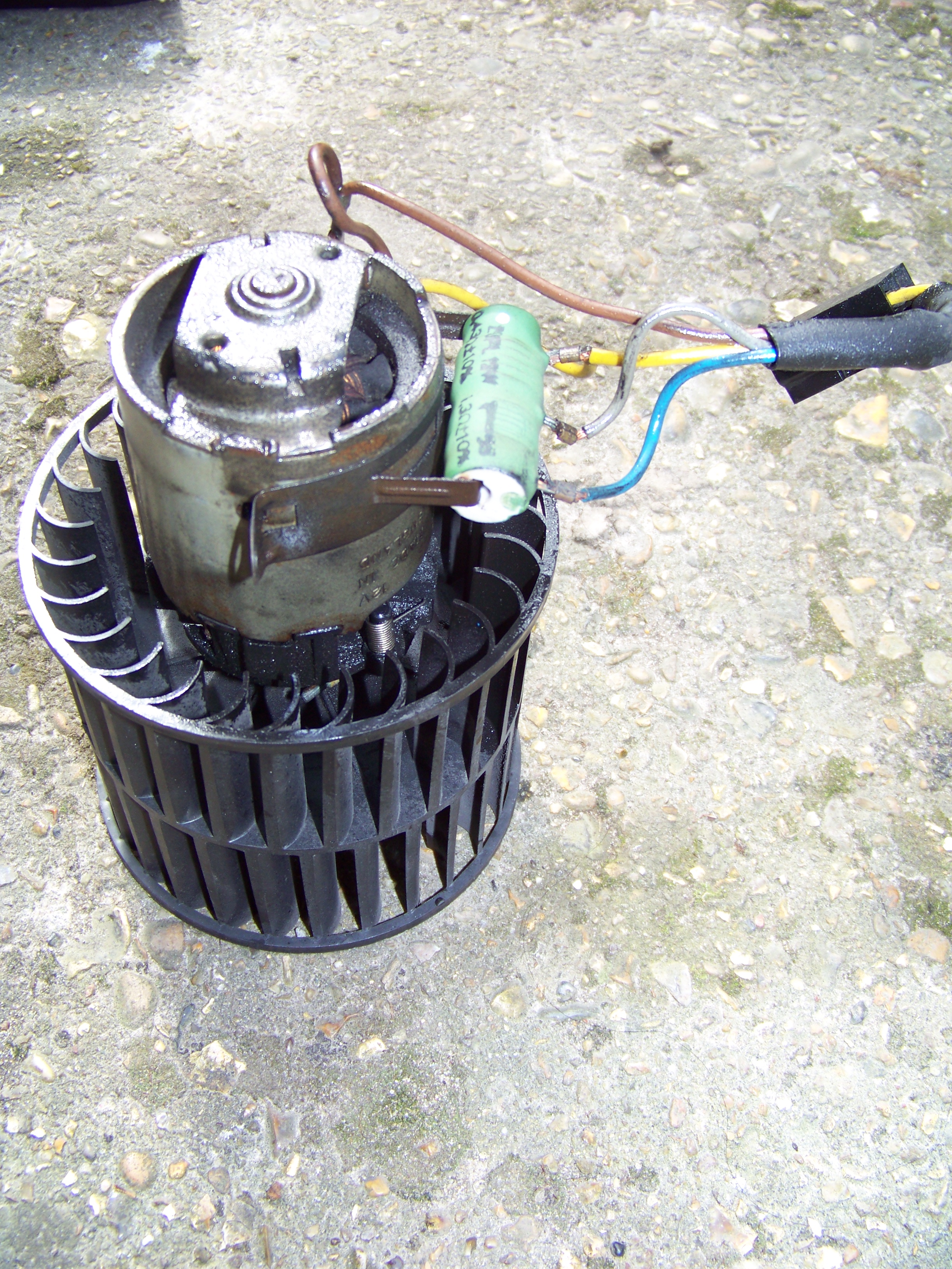

I cleaned up the motor as there was some dirt and fluff that had wrapped around the motor spindle. Also cleaned up the blower fan. I left the bits to dry.

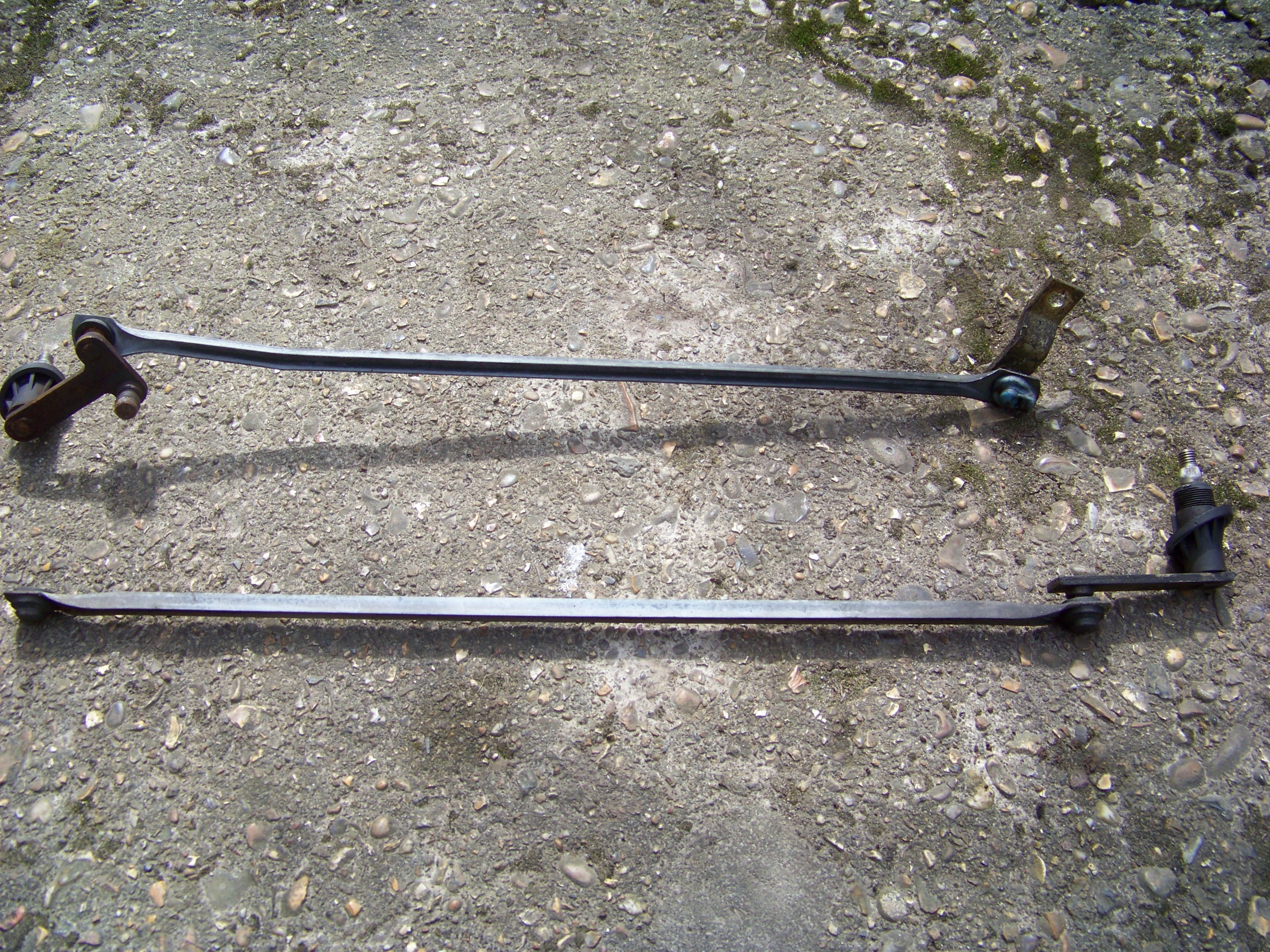

Meanwhile, I moved onto the wiper linakages. As they came off the car
https://images2.imgbox.com/2d/c8/Ij2TDLQM_o.jpg
Cleaned them up with some spirit and WD40 and rubbed down the arms with fine wet n dry.
https://images2.imgbox.com/34/05/KTvGmnRg_o.jpg
https://images2.imgbox.com/9e/e2/obhC3Pol_o.jpg

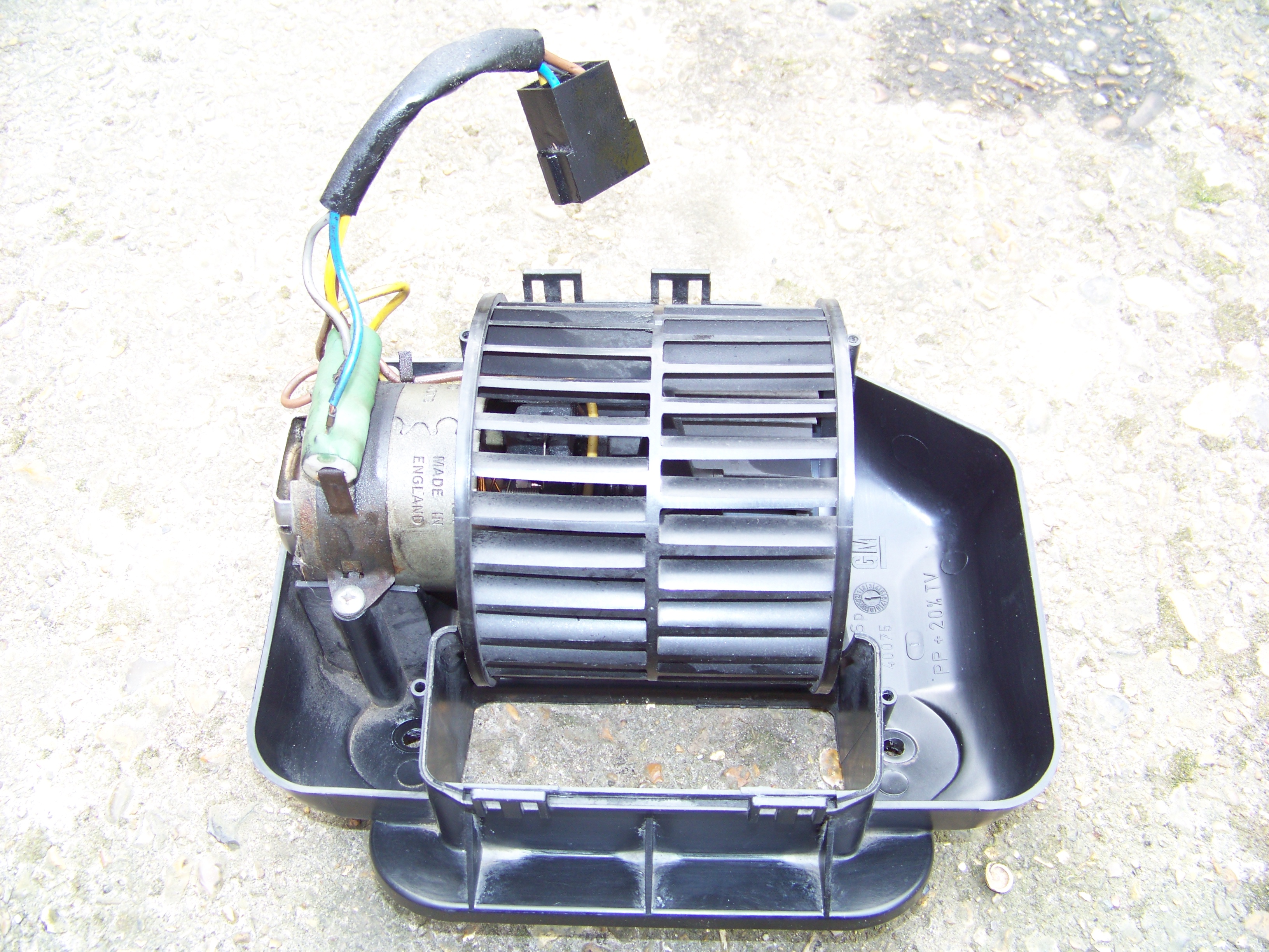

The blower bits dried so I reassembled it
https://images2.imgbox.com/22/d5/nrAESfhE_o.jpg
https://images2.imgbox.com/2e/c8/0svp4LPr_o.jpg

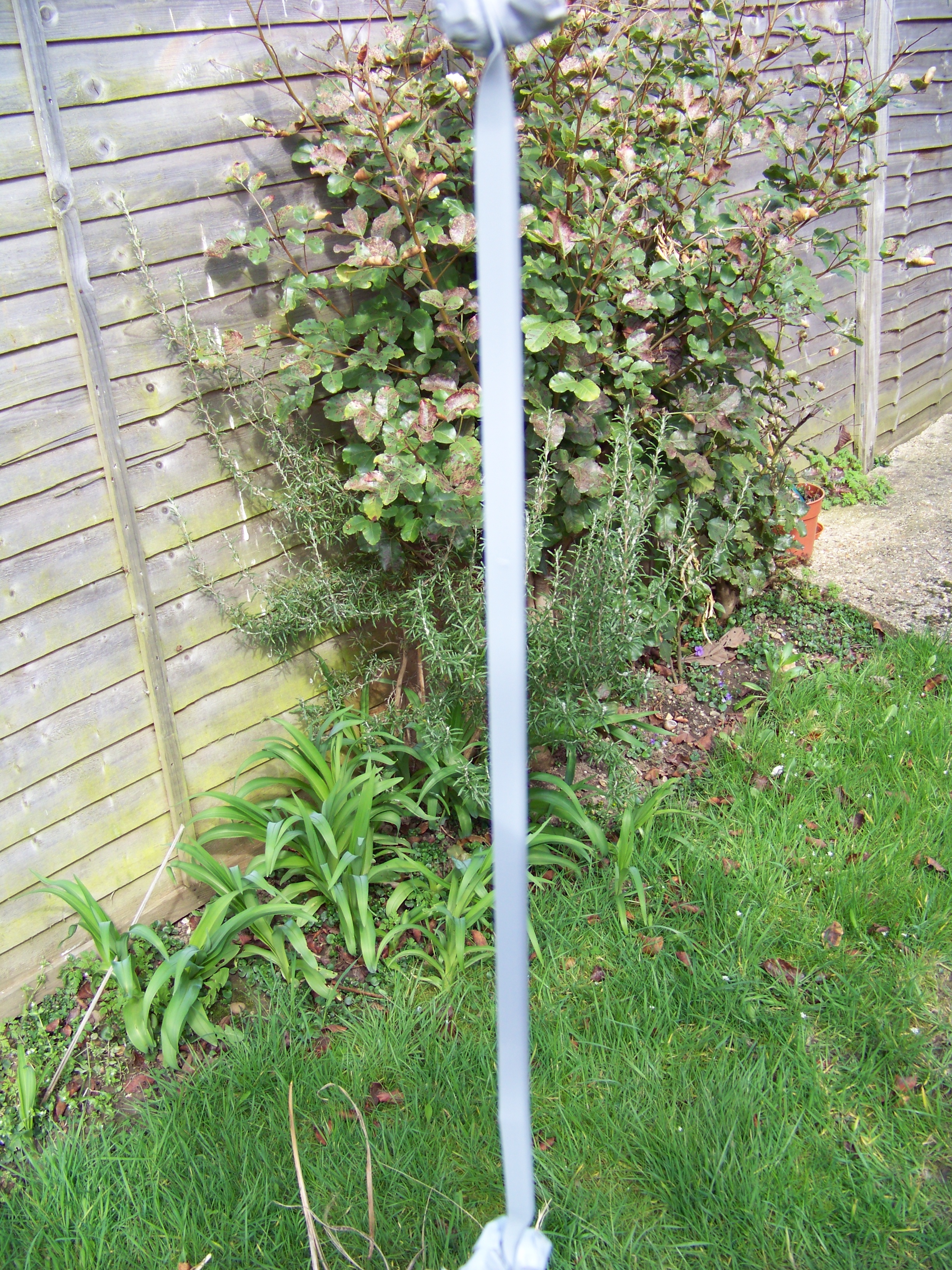

Started off by coating the arms in a bit of etch primer.
https://images2.imgbox.com/c6/d7/cRRxB8DB_o.jpg
https://images2.imgbox.com/62/bb/oocspKqE_o.jpg

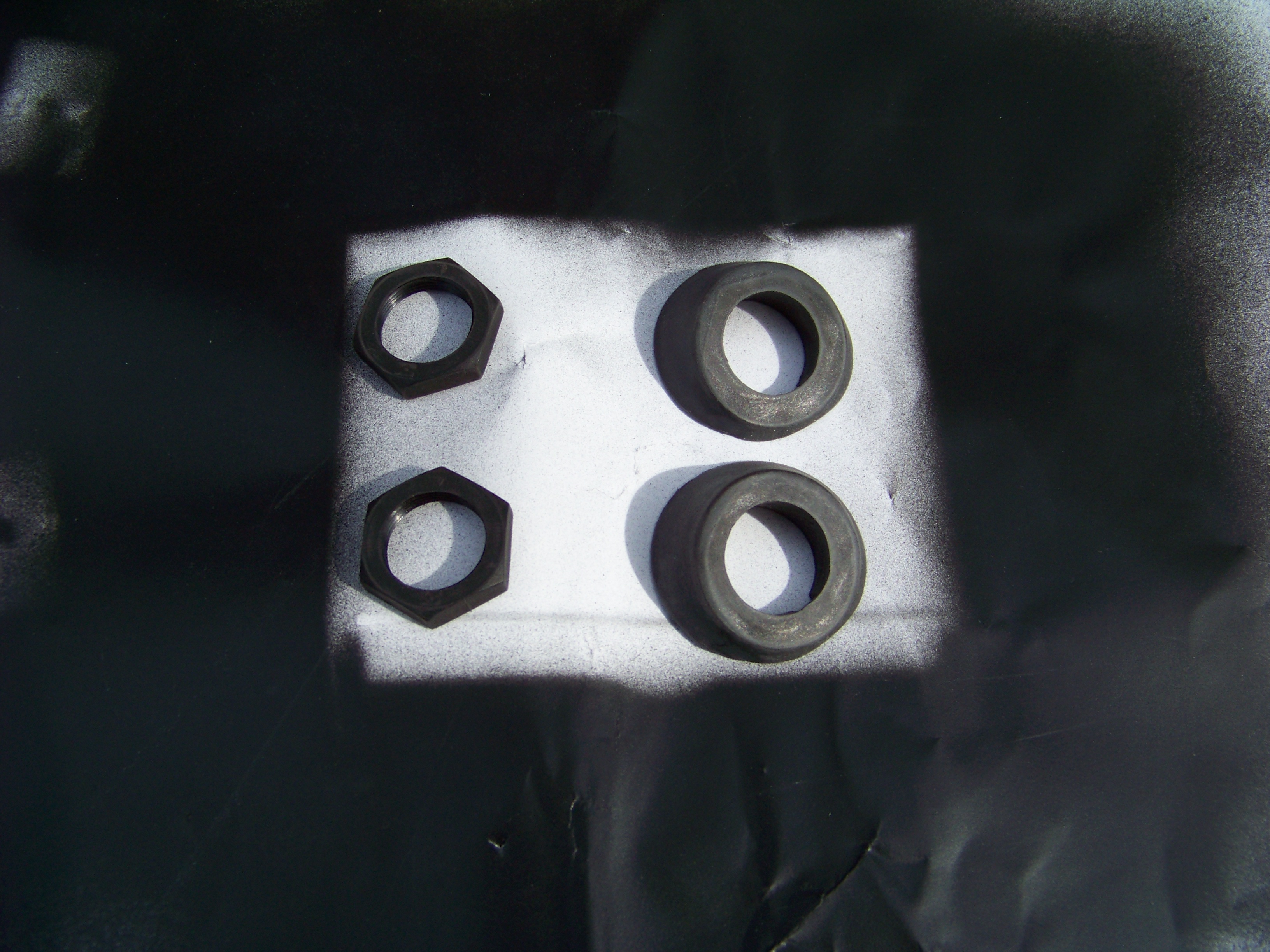

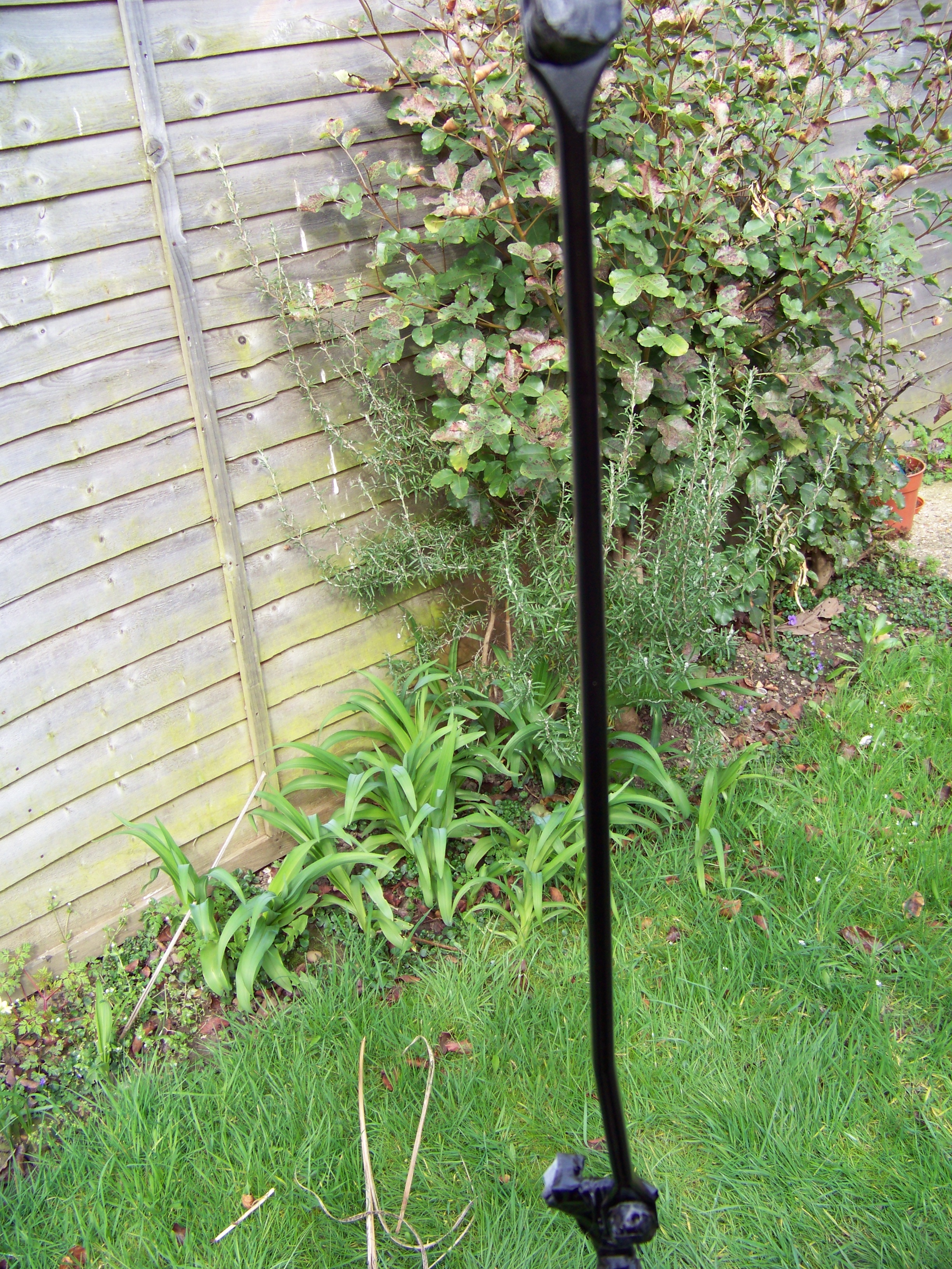

As they were drying off, I went back to the wiper linkages and gave them a few coats of whatever I found almost empty in the paint cupboard, in this case gloss black.
https://images2.imgbox.com/8c/ef/3C7vxkxe_o.jpg
https://images2.imgbox.com/e1/5c/LmYzFHDw_o.jpg

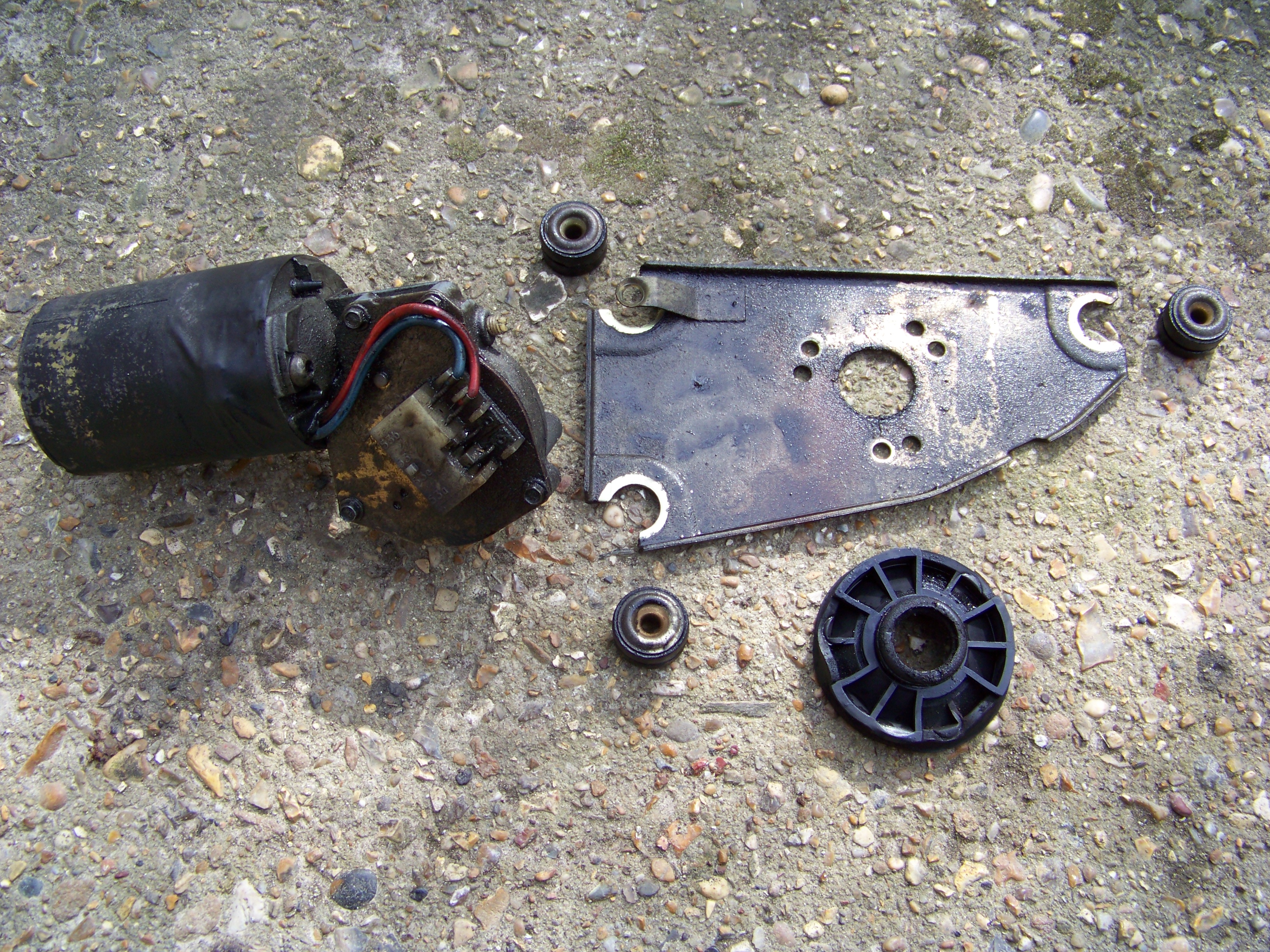

Left them to harden and moved on to the wiper motor. Didn't bother with the rear wiper motor as that is as new.
As it came off (far too mucky for my liking, couldn't have this go back like this)
https://images2.imgbox.com/b6/96/bZ9NnAsA_o.jpg

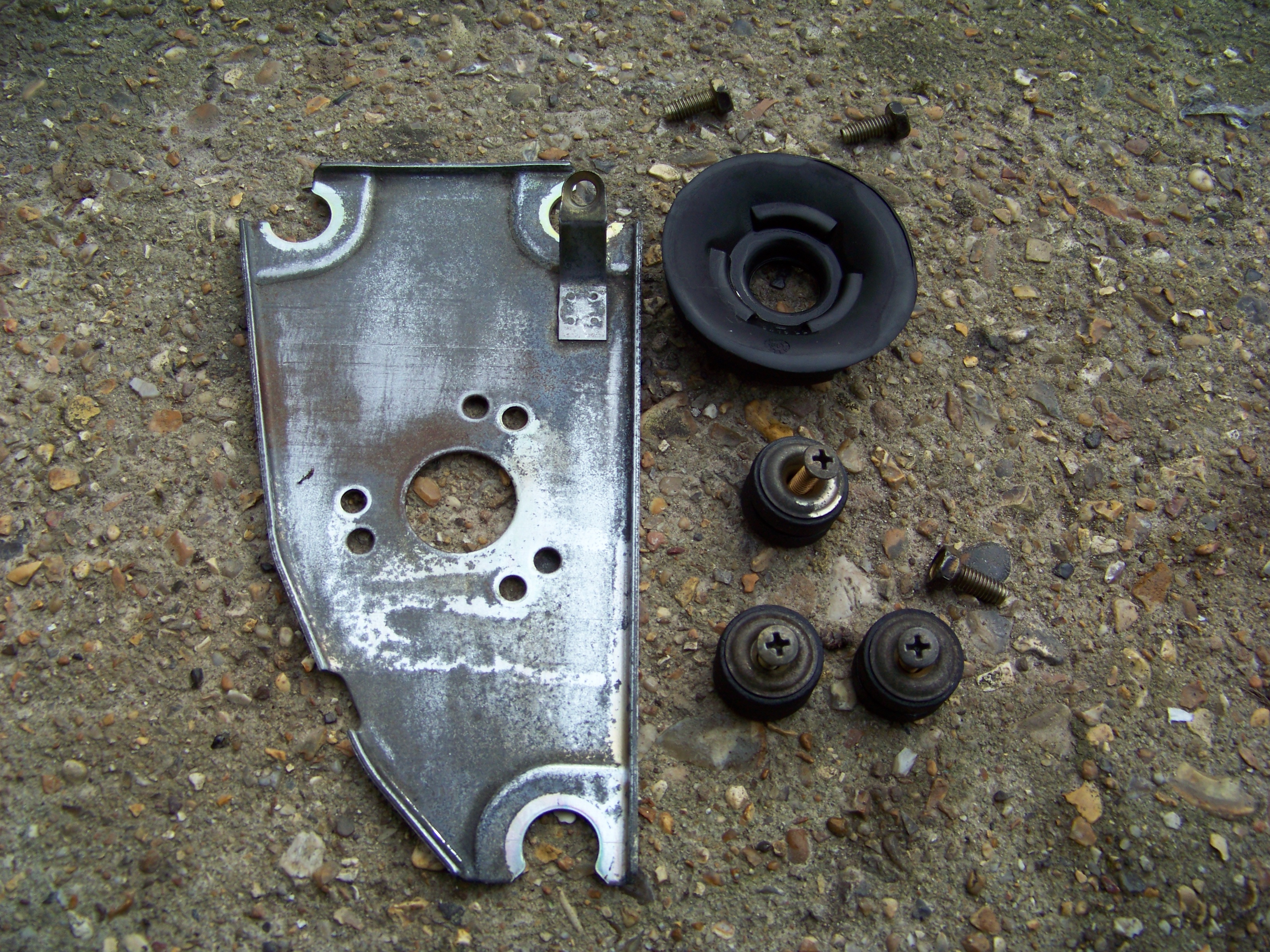

Took it apart
https://images2.imgbox.com/78/d1/0Cr3iHCG_o.jpg

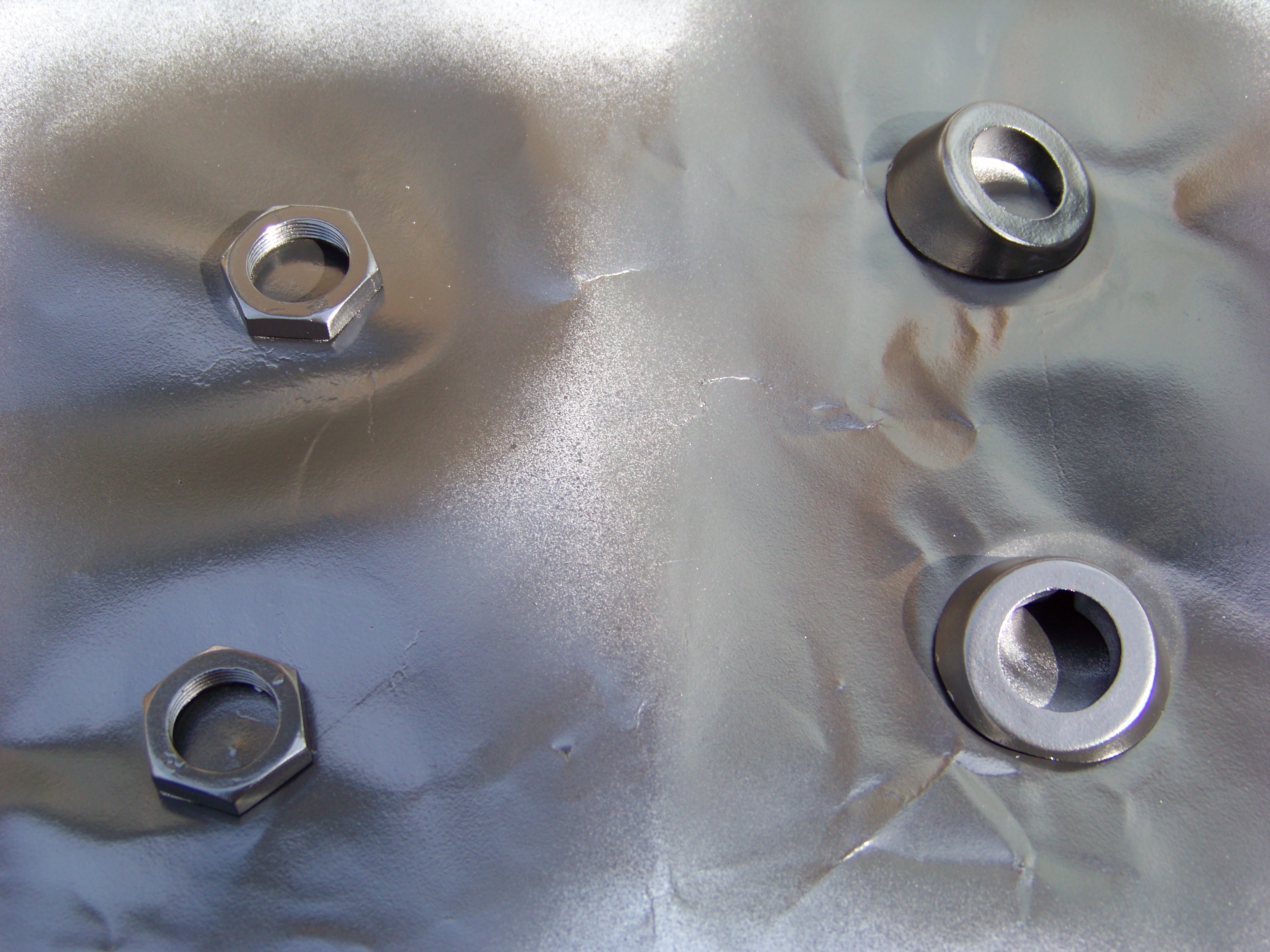

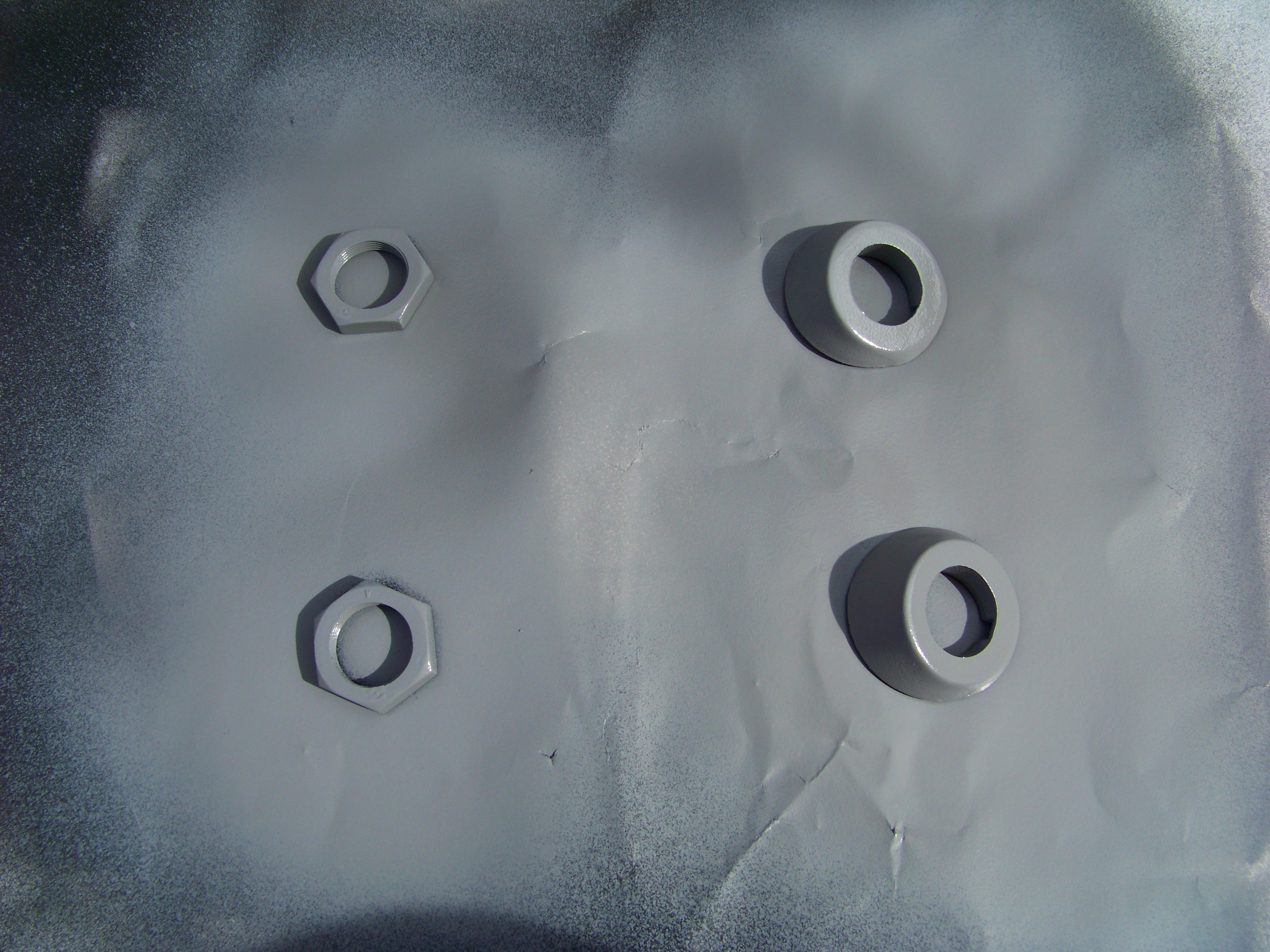

Cleaned up all the bits using good old hot soapy water, 400-800 wet n dry and some spirits.
https://images2.imgbox.com/20/37/xByQSW9r_o.jpg

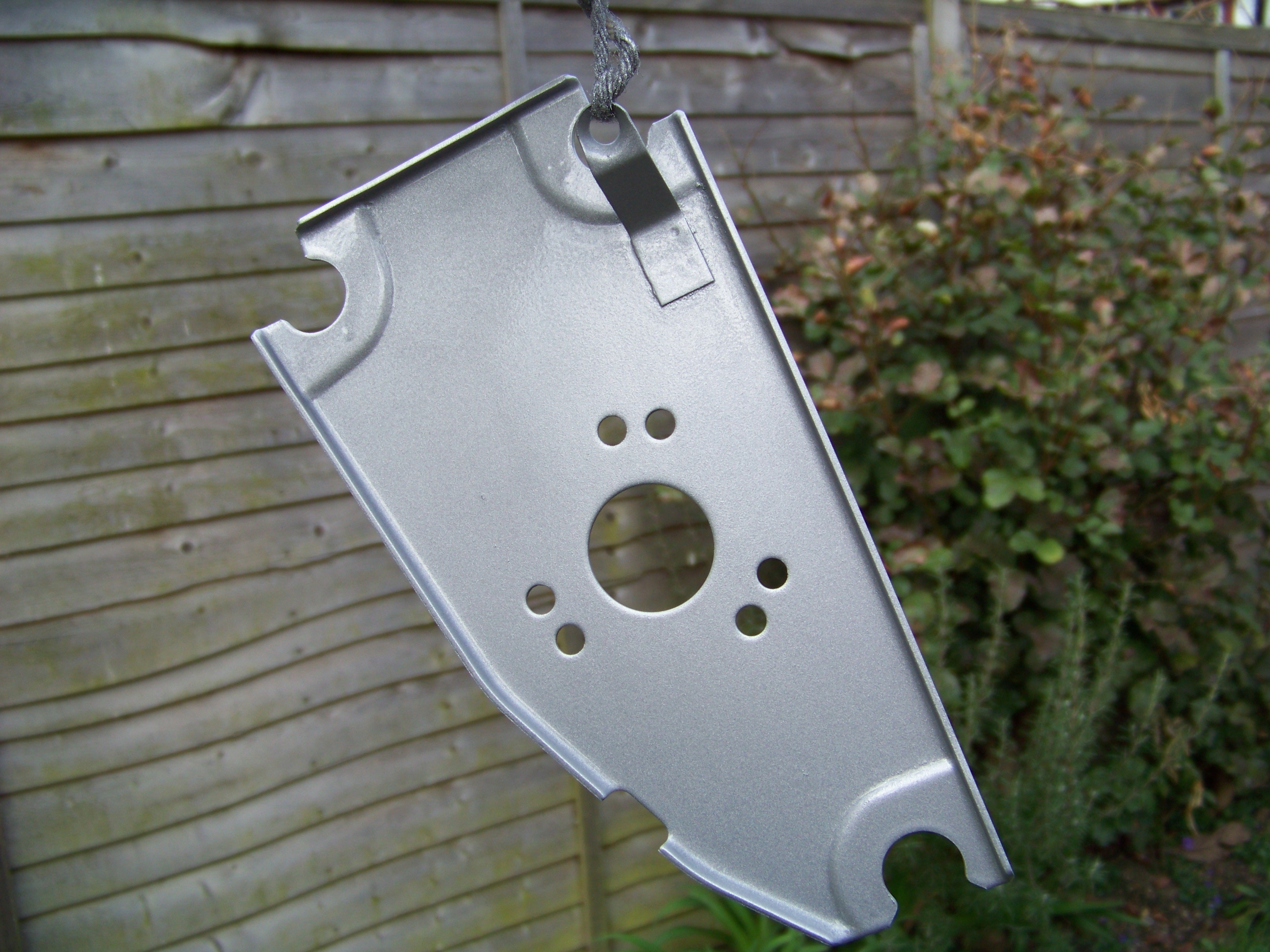

Decided to give the wiper motor plate a coat of Hammerite
https://images2.imgbox.com/d5/dc/cOZQIWfF_o.jpg
https://images2.imgbox.com/ea/28/NpCTUtGG_o.jpg

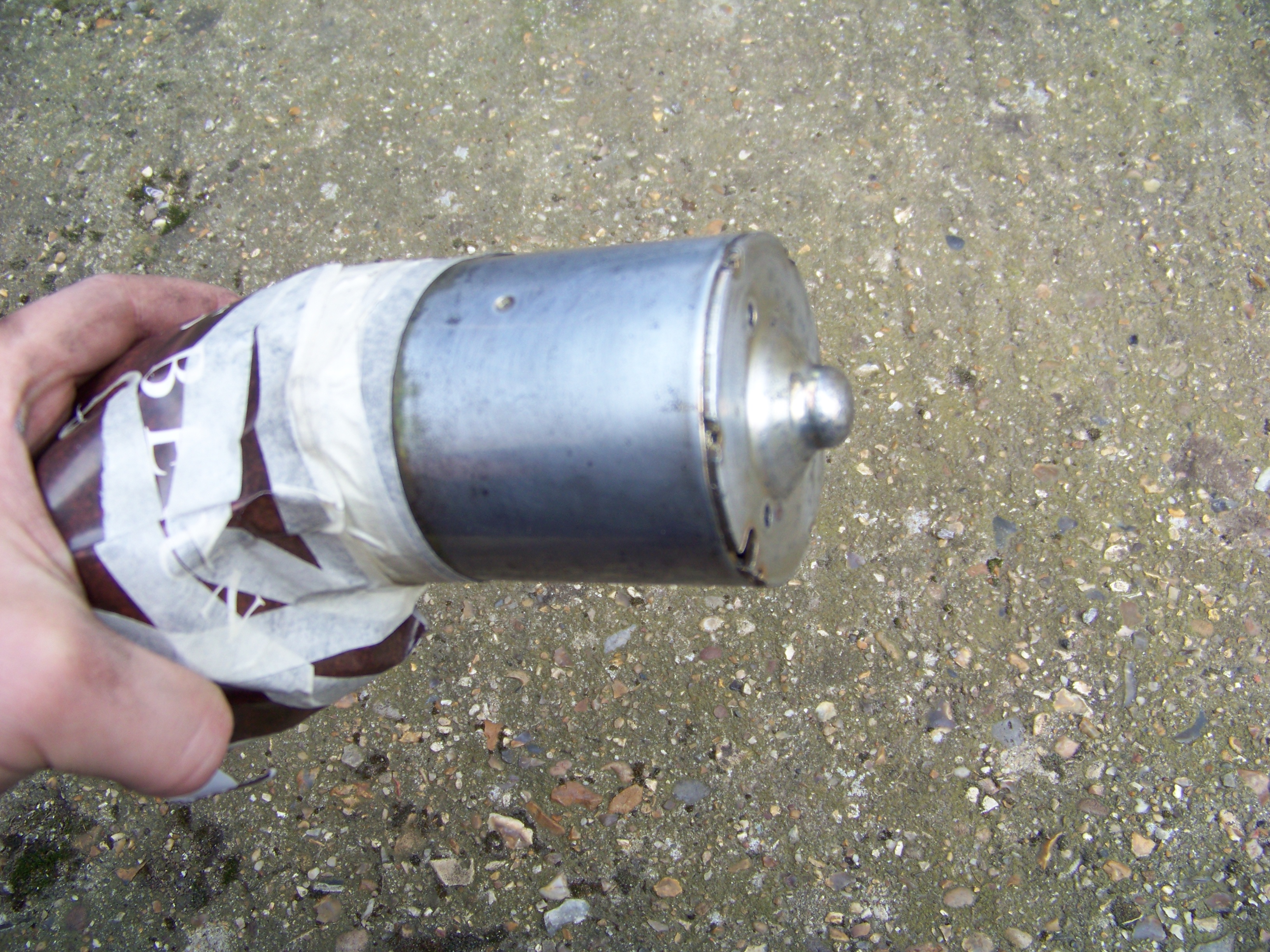

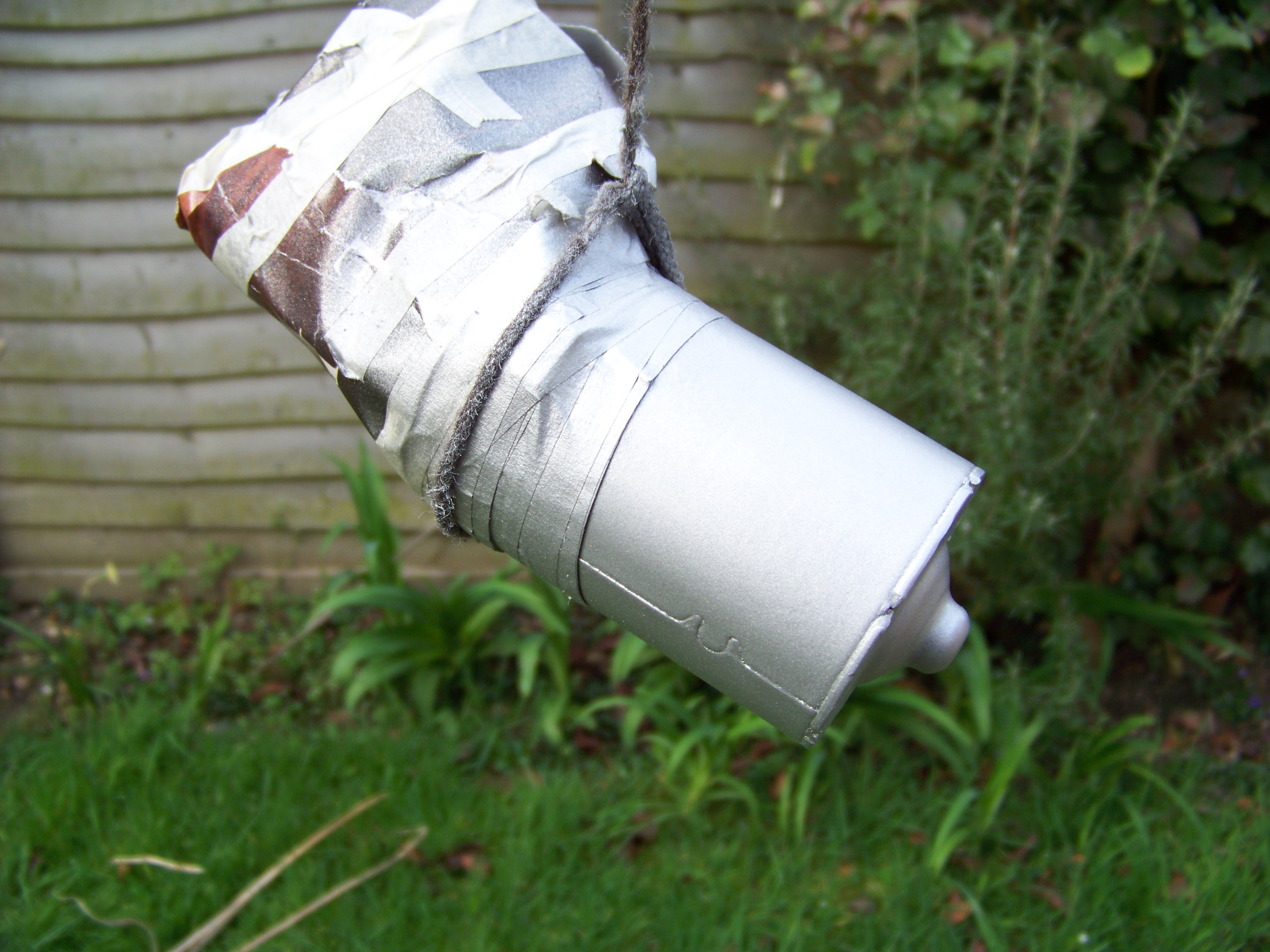

Then gave the exposed part of the motor housing a good clean and a matching coat. First, rub down with wet n dry and a wipe with panel wipe.
https://images2.imgbox.com/83/38/pPhiZLMS_o.jpg
Hung it on the washing line and gave it a few coats of silver Hammerite smooth
https://images2.imgbox.com/4c/8d/Ua8ffiZi_o.jpg

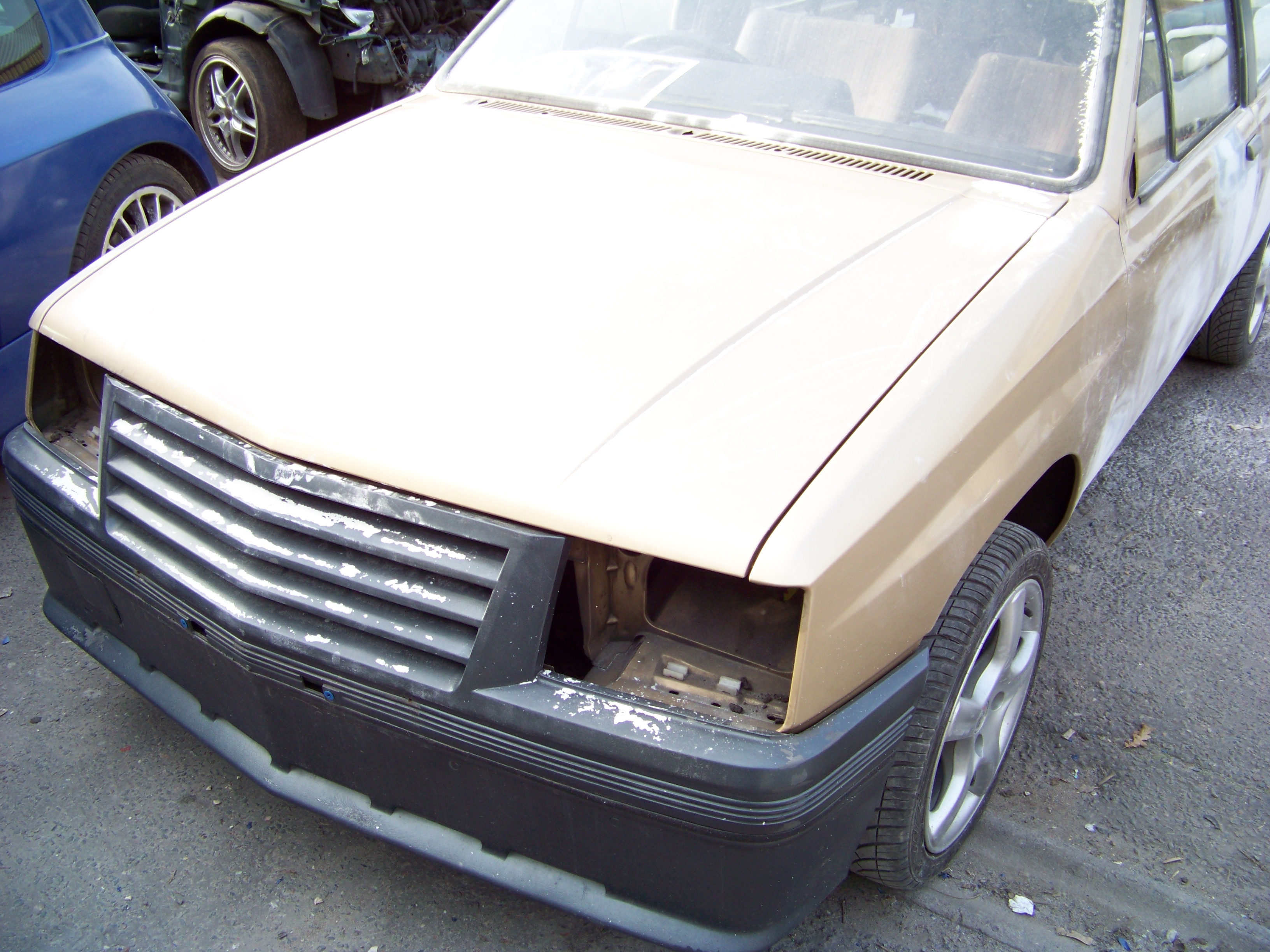

Left all the bits to properly dry, then went to visit the bodyshop. The Nova was outside being blocked.

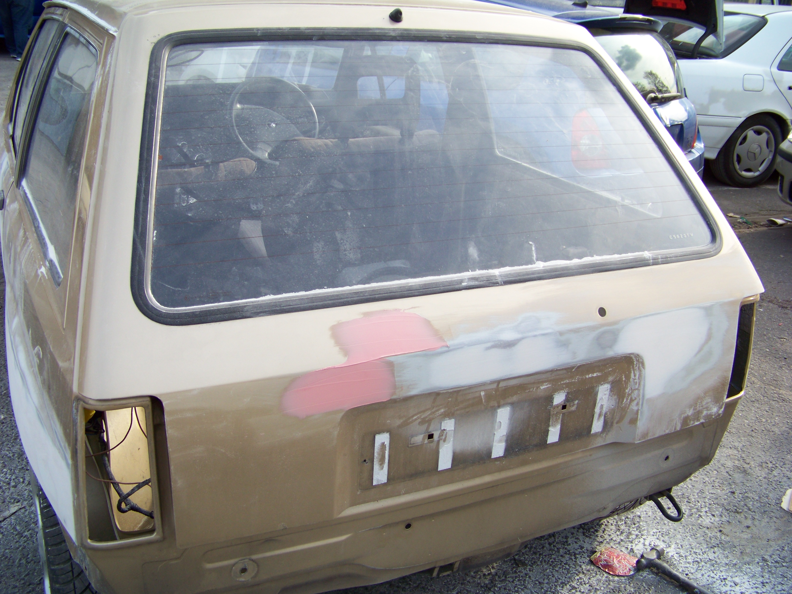

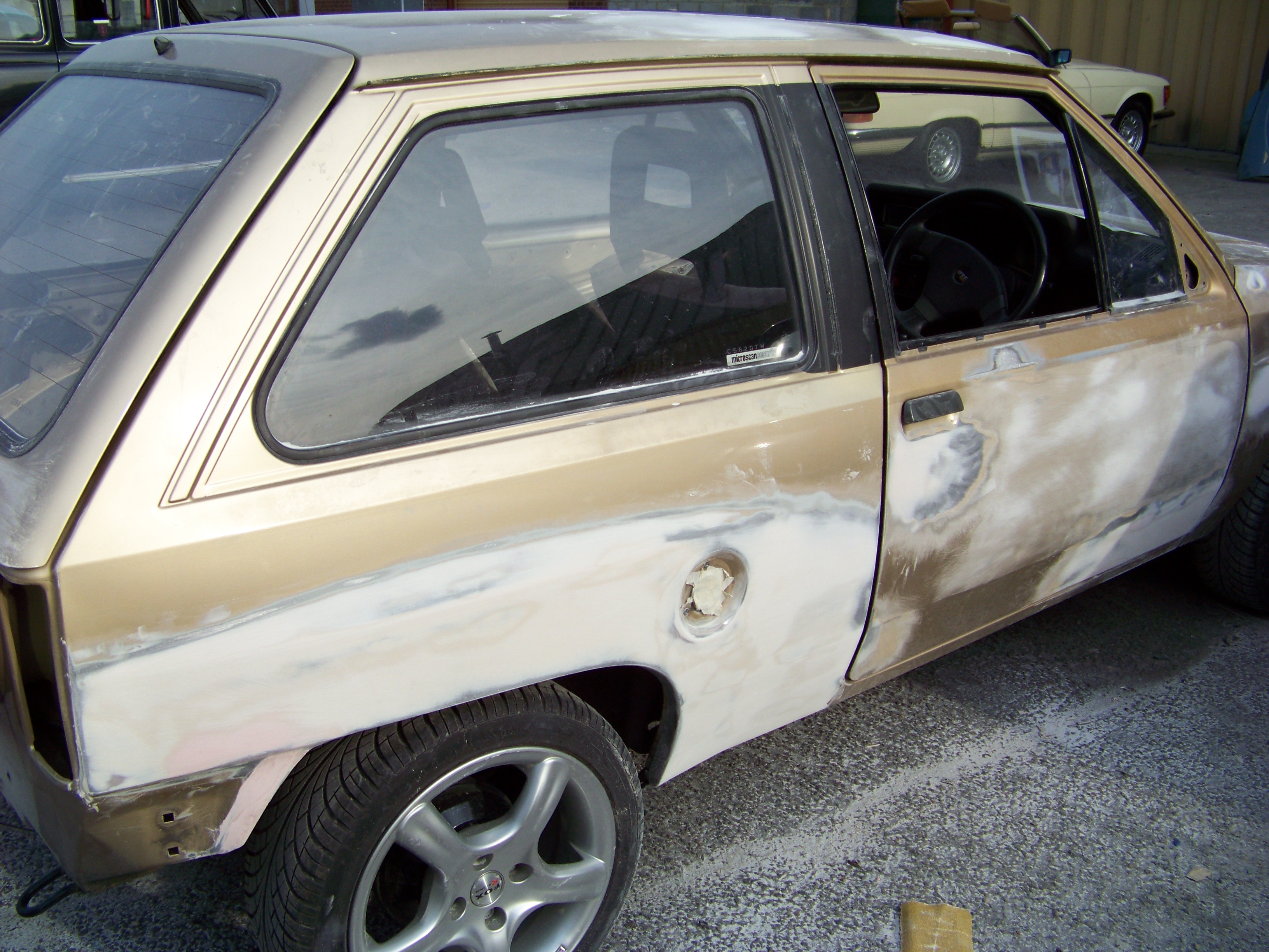

Back end with some more filled in bits.
https://images2.imgbox.com/e4/68/ld8cm5gu_o.jpg

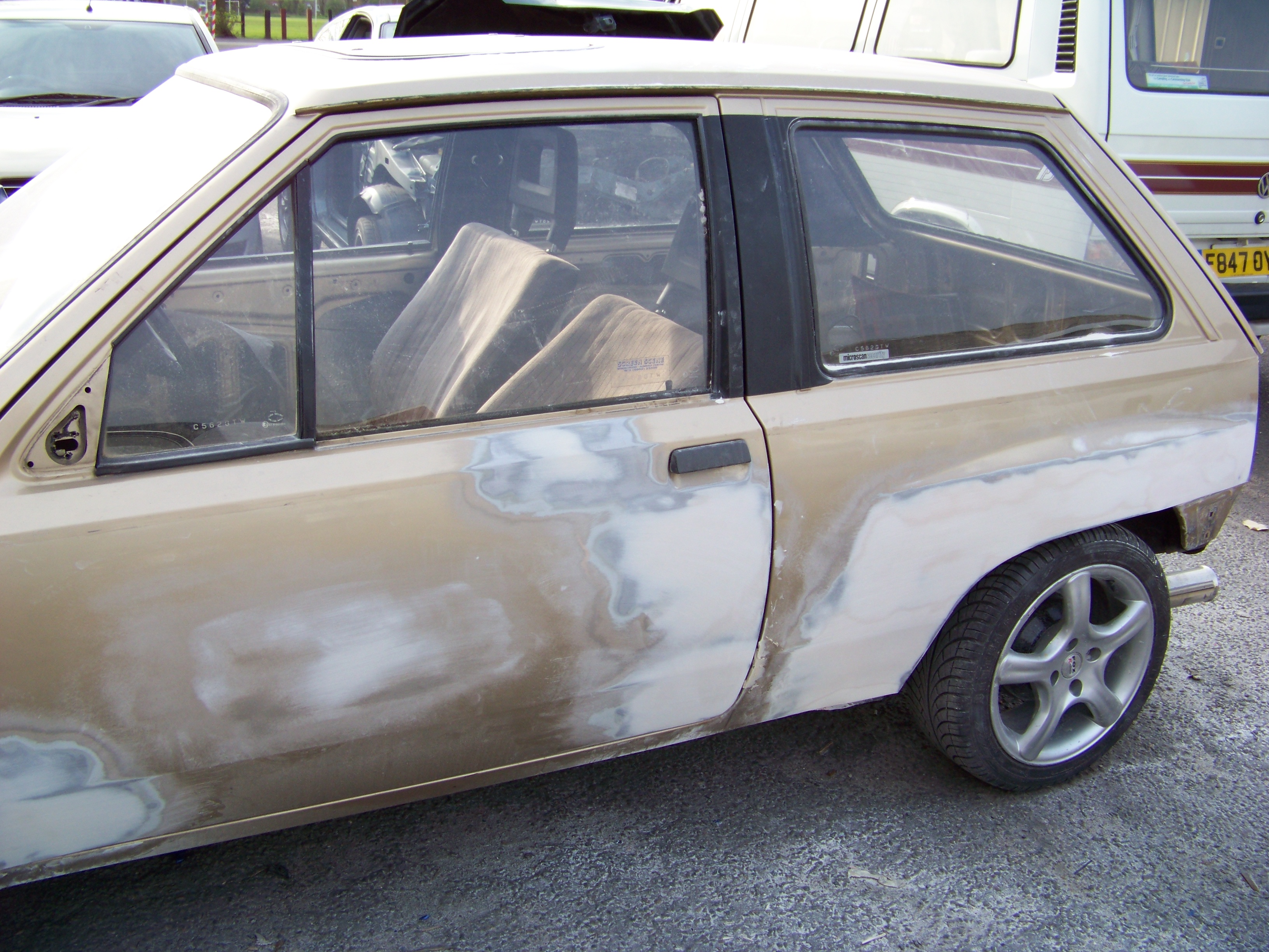

Offside - some more finer filler work on the rear arch and door
https://images2.imgbox.com/2a/37/3xmp4u04_o.jpg

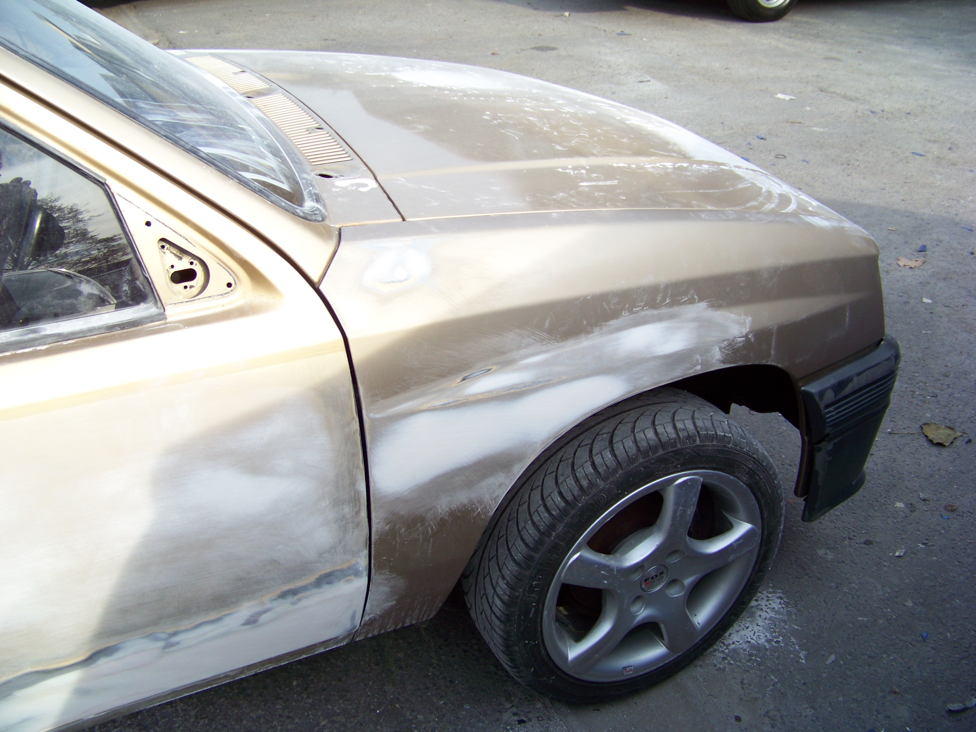

Offside front wing, some more filer work
https://images2.imgbox.com/97/19/27IFX1uK_o.jpg
More work on the passenger side
https://images2.imgbox.com/d2/8e/0l3YThjV_o.jpg
http://img706.imageshack.us/img706/4056/1000682.jpg
And the bonnet
https://images2.imgbox.com/35/83/arCidQQC_o.jpg
http://img706.imageshack.us/img706/6422/1000683q.jpg
Had a chat with the lads there and they said the major filler work was pretty much over with most of the little dings and dents filled in. They were gonna get it checked in the booth as the lighting there helps to bring up imperfections better than natural light. Then tomorrow/Monday should see them getting the bodywork skinned over with with some stopper and blocked down as smooth as possible.
nice work now you have the linkage out you should dismantle the bits the wiper arms bolt onto and copper grease the spindles and the wiper will sweep the screen like new :thumb:also why dont you remove the front bumper and save them sanding it by mistake.
Yeah will be greasing them up mate once the paint properly hardens. Already cleaned quite a bit of crap off the linkages, joints and splines.
