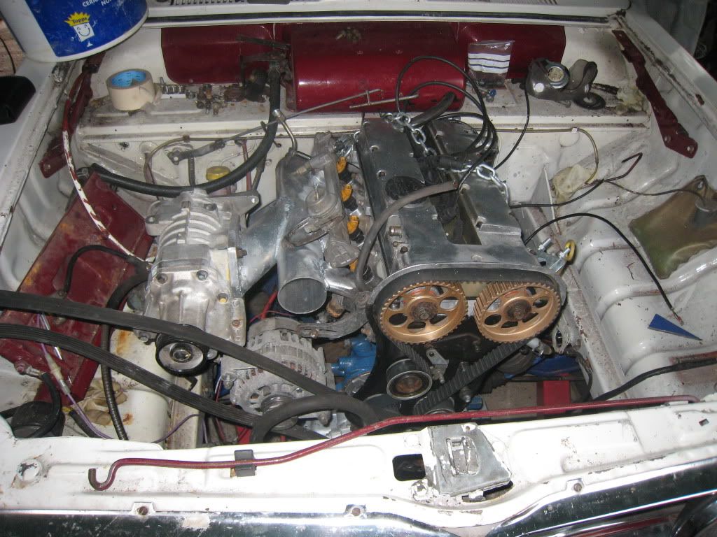

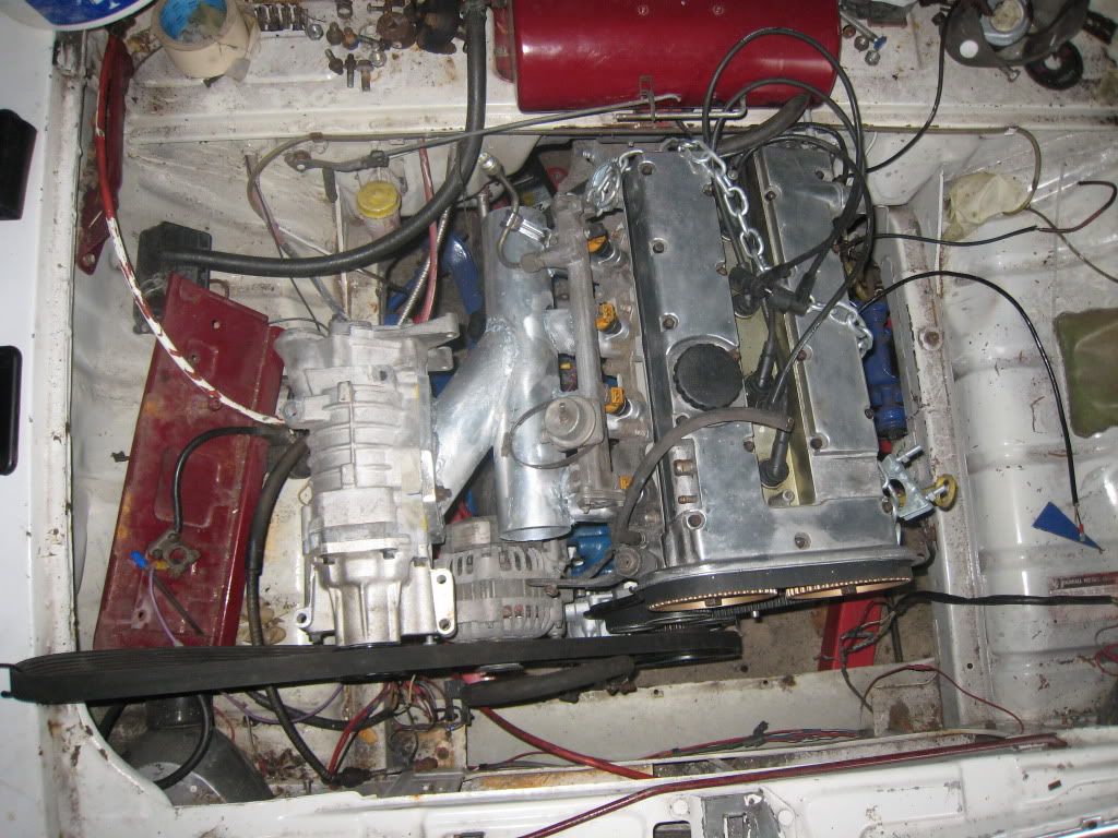

mmmm not sure it will because going by a underside pic of a eaton it would appear that he need the plate and pipe work coming out of there as well so will foul the exhaust manifoldQuote:
http://www.alfa145.com/upload/Eaton%20M45_1.jpg
i posted these in another thread.
but i think if the OP was to do it, it should be done like this
http://i651.photobucket.com/albums/u...otdave/198.jpg
http://i651.photobucket.com/albums/u...otdave/202.jpg
