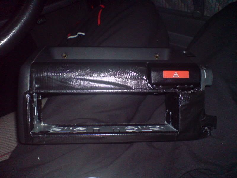

well ihave created a dash pod for a flip out dvd player for where the center vents usually are, its been fibreglassed.. had many skims of filler, and is currently at my work experience work getting sprayed for me :thumb:
will upload pics of it and a step by step guide too.. think its going to look awsome :thumb:
well.. here goes..

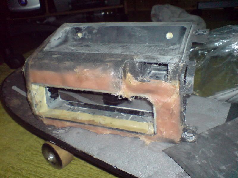

it srated off as this, got the basic shape with some tape
http://i61.photobucket.com/albums/h8...m/DSC00855.jpg

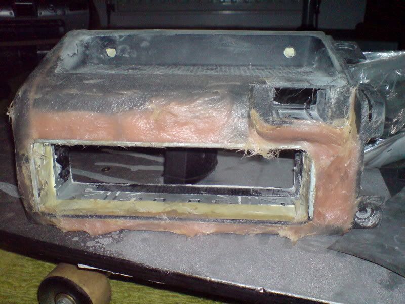

skim of fibreglass..
http://i61.photobucket.com/albums/h8...m/DSC00875.jpg

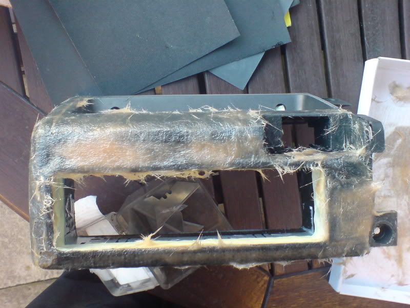

then took it to work.. found out that it wouldnt stick to tape atall.. ripped it off and did it properly..
http://i61.photobucket.com/albums/h8...m/DSC00876.jpg
http://i61.photobucket.com/albums/h8...m/DSC00877.jpg

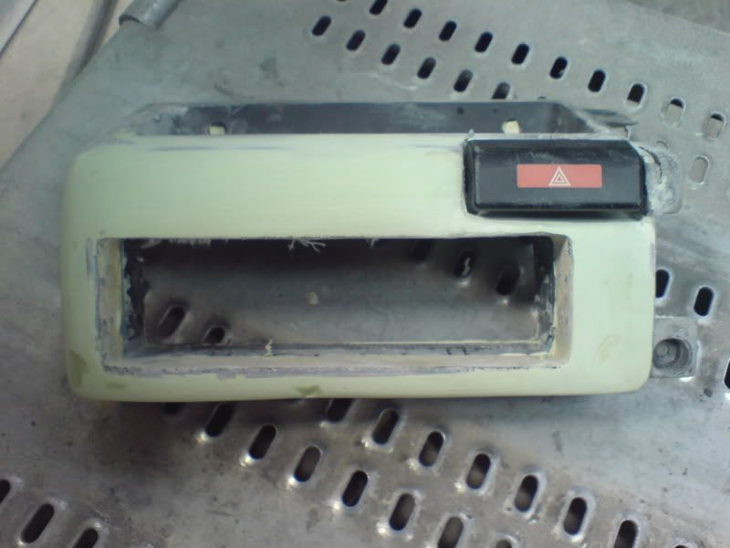

after the first skim of filler..
http://i61.photobucket.com/albums/h8...m/DSC00878.jpg

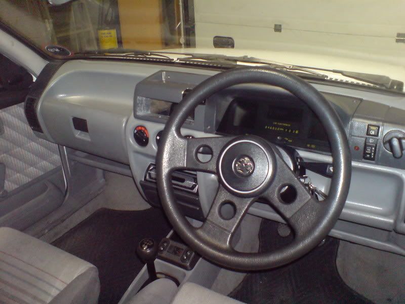

gave it 1 more skim.. and then fileld some pinholes..painted it rover hurricane grey.. and this is the finished result..
you wont see that little uneven bit on the bottom left once the dvd players fitted btw.. :thumb:

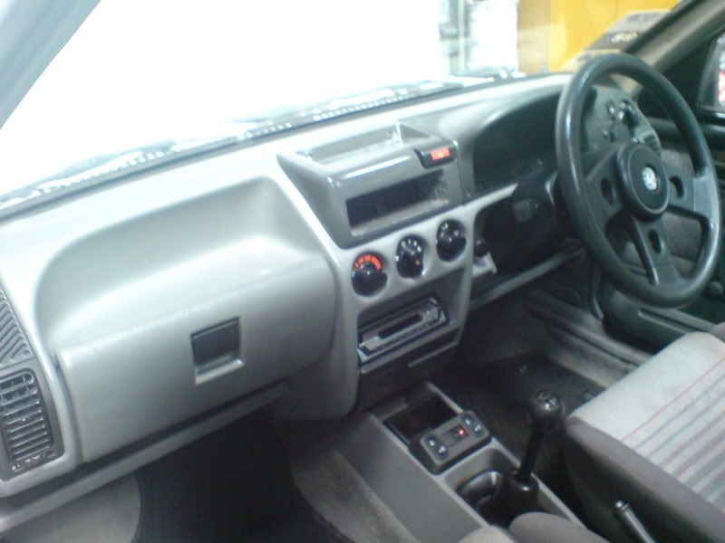

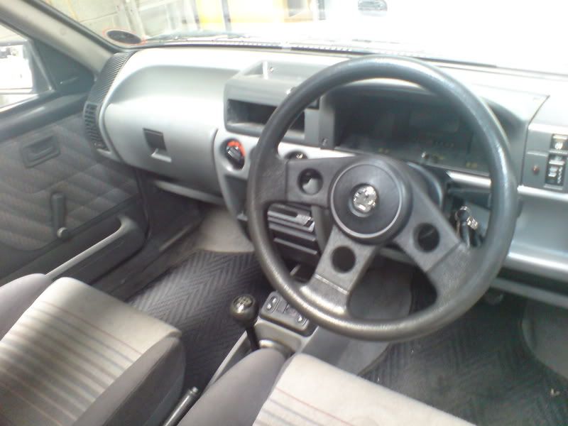

think the colour is the closest im going to get.. it does look awsome.. i need to chop the vent pipes at the beck abit and remove a big un-nessecary buldge of cardboard backing on the dash.. doesnt do anything.. its not even part of the dash haha
anyway.. she went out in the rain!!!
http://i61.photobucket.com/albums/h8...m/DSC00881.jpg
Good skills, I'd be tempted to paint the rest of the top dash cowling to match though. Maybe give it a matt coat to stop any reflections off the sun too.
nice work dave im impressed mate;) do agree with jack as to painting the rest of the dashcowling etc,matt paint is a very good point as in glare of the sun,headlights etc:thumb:
I'm liking that mate.
What you doing about the other hole left behind by your other cd player?
He's keeping it as well :)
You went up in my book then with the skills on that DVD player thing but then finding out your going to just leave anothr cd player in the other hole has made you drop a level.
I would do something creative with that other hole like get a cd player cage smooth it with filler and fibre glass on inside then use it to store a cd wallet in.
