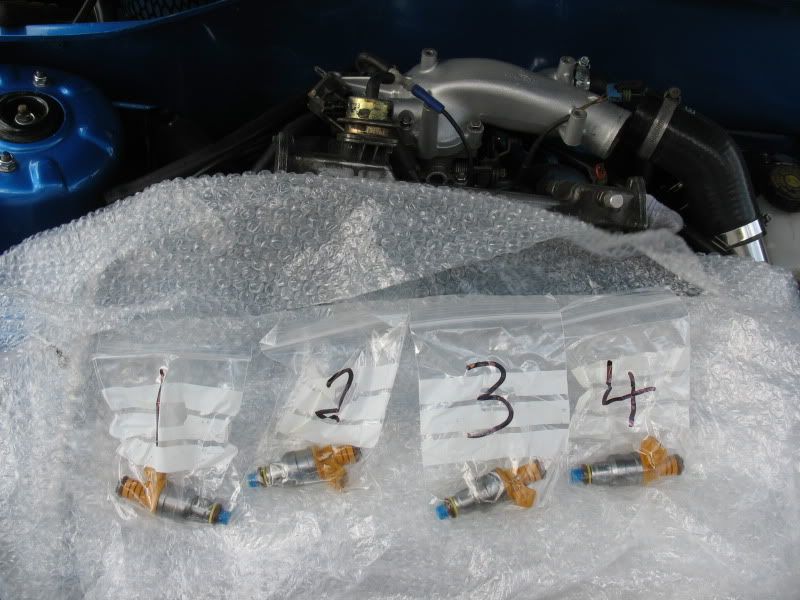

I also spoted Rich was selling some ultrasonicley cleaned with all new seal, spray end cap injectors. Reading the print out that came with them..
Before,
1=85
2=86
3=12 :eek
4=86
After,
1=88
2=88
3=89
4=89
Number 3 wasnt happy at all, but its now got a 641.66% increase...
http://img.photobucket.com/albums/v3...iperstuff4.jpg
http://img.photobucket.com/albums/v3...iperstuff5.jpg
Mmm new stuff.
http://img.photobucket.com/albums/v3...iperstuff6.jpg
Now when i started the car it took a while to start, was never sure what this was. After i fitted the new injectors it seems to have sorted it. Started on the button now. :) Very happy.

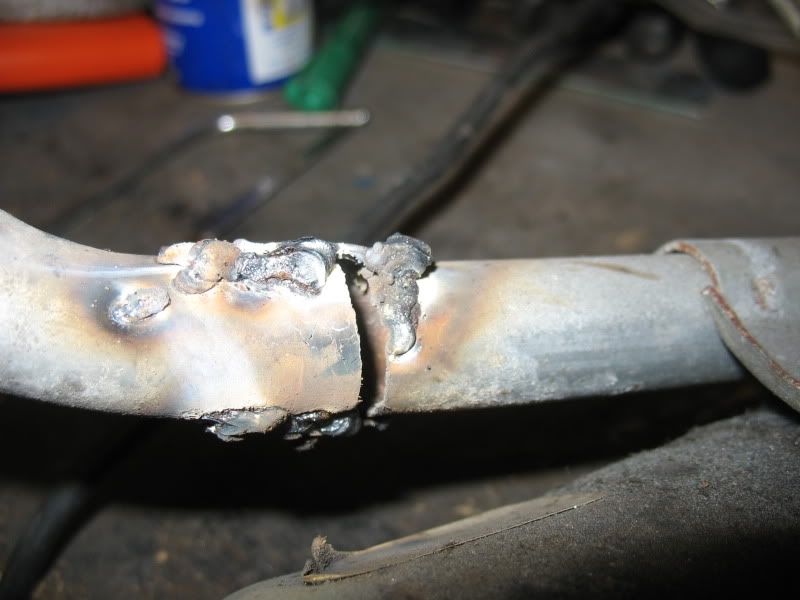

I then tacked in a bit of metal to act as a joiner (abit very badly) take to do this a few times to get the width right
http://img.photobucket.com/albums/v3...perstuff10.jpg
After about 4times it was correct, so i wrapped the bar with metal, welded it in fully. Then did the same with the other end.

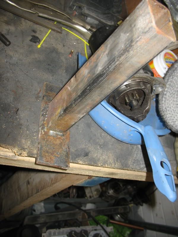

Now it works on just being held up by the spindles, but i wanted to support the motor better, so i made this.
http://img.photobucket.com/albums/v3...perstuff12.jpg

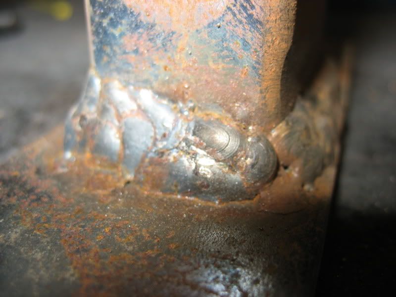

Welding much better with the bodyshops welder,
http://img.photobucket.com/albums/v3...perstuff14.jpg

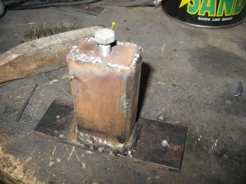

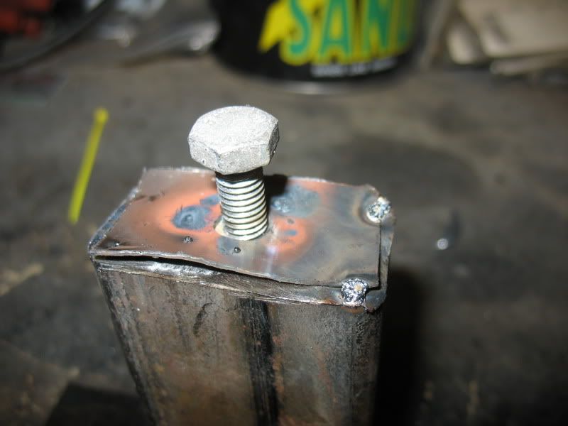

Wanting to use the front most bolt hole on the linkage, i thought simply bolt down, so made up a captive nut on a plate..
http://img.photobucket.com/albums/v3...perstuff19.jpg
Then after cutting the leg to shape, i sat it on like so.. Tacking the corners on,
http://img.photobucket.com/albums/v3...perstuff20.jpg
Then welded it on fully,
http://img.photobucket.com/albums/v3...perstuff22.jpg
Finished kinda,
http://img.photobucket.com/albums/v3...perstuff23.jpg

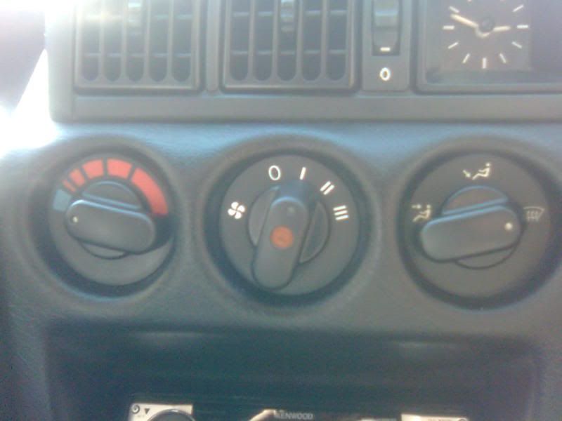

I got all the heater dials out for mine from it, as at the top i only have coloured ones i had painted a blur set in met black, but in doing this the holes that the direction light comes up for a bit knacked, so Dan got all the minty ones from the Spin for me..
Mine at the top..
http://img.photobucket.com/albums/v3...s/Image021.jpg
You can see the holes here better..
http://img.photobucket.com/albums/v3...Image097-1.jpg
And the fan speed one of course does the heated rear screen in a Nova, well the little sticker had come off, so that was swaped too.
Mine..
http://img.photobucket.com/albums/v3...s/Image106.jpg
New one.
http://img.photobucket.com/albums/v3...s/Image107.jpg
Fitted.
http://img.photobucket.com/albums/v3...Image108-1.jpg
