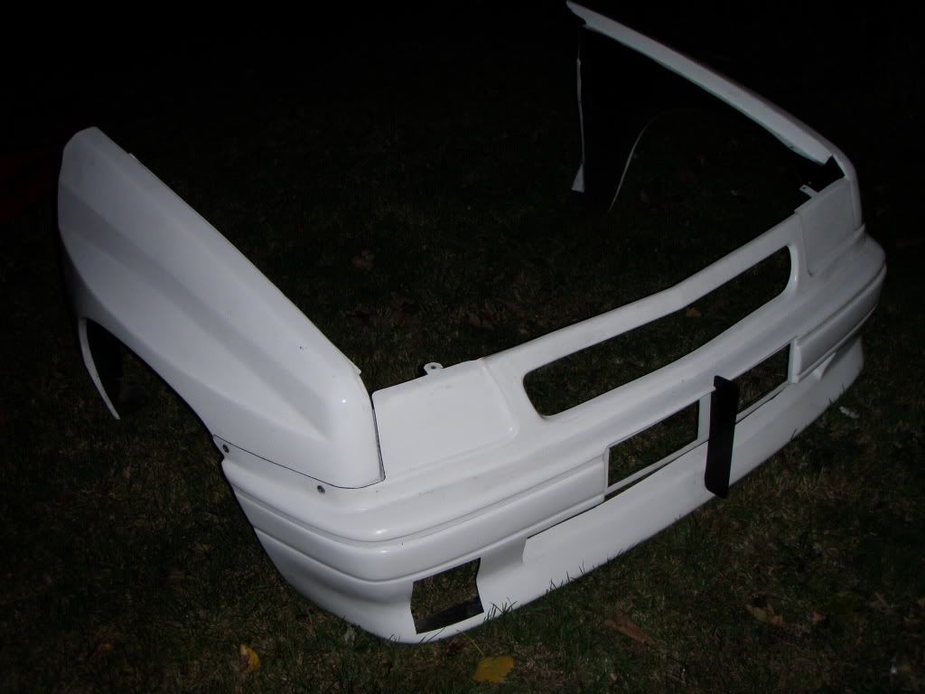

Carbon fibre front end removed (not very tricky!);
http://i285.photobucket.com/albums/l...ort/002-57.jpg
http://i285.photobucket.com/albums/l...ort/003-59.jpg

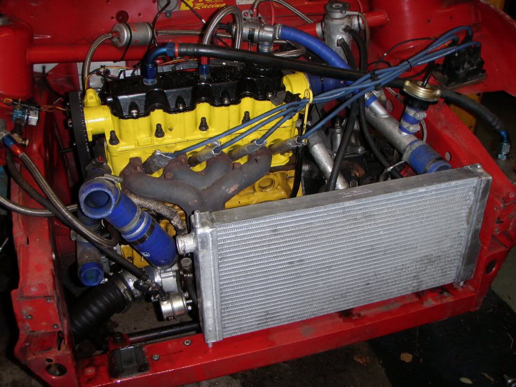

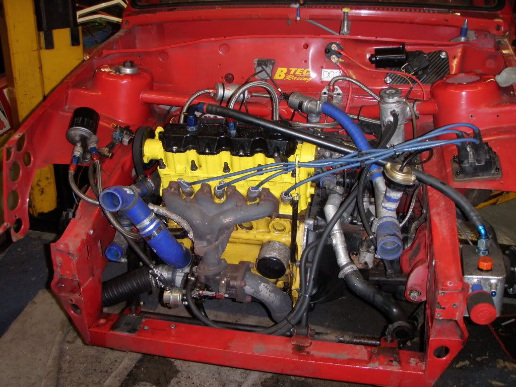

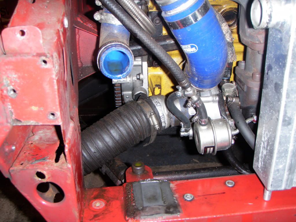

Bit of messing about with a slightly smaller width radiator, which would allow me to get a more direct airflow into the turbocharger;
http://i285.photobucket.com/albums/l...ort/004-48.jpg
http://i285.photobucket.com/albums/l...ort/011-27.jpg
http://i285.photobucket.com/albums/l...ort/006-41.jpg
Unfortunately the alternative radiator is slightly taller than the old one, and there's not enough room under the slam panel for it, with the intercooler on top as well. The only way I'm going to be able to accommodate it will be to slant the radiator forward to get some clearance.

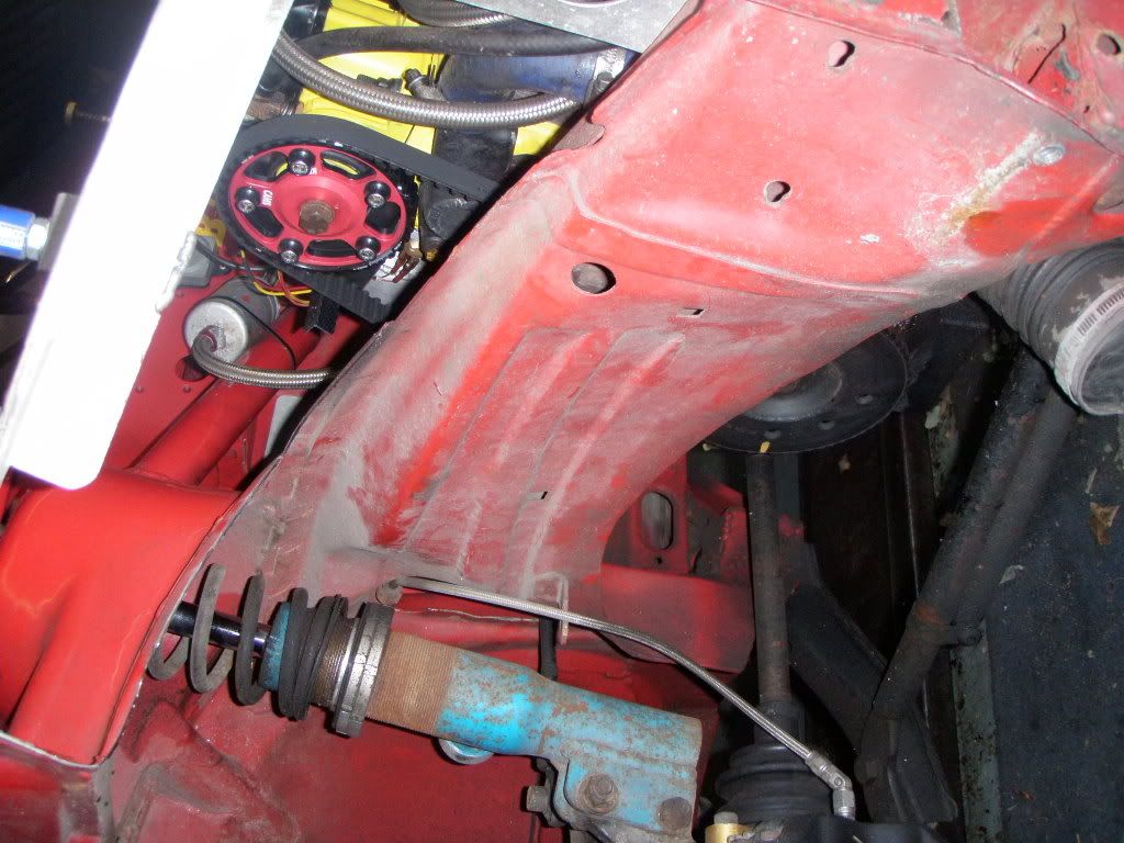

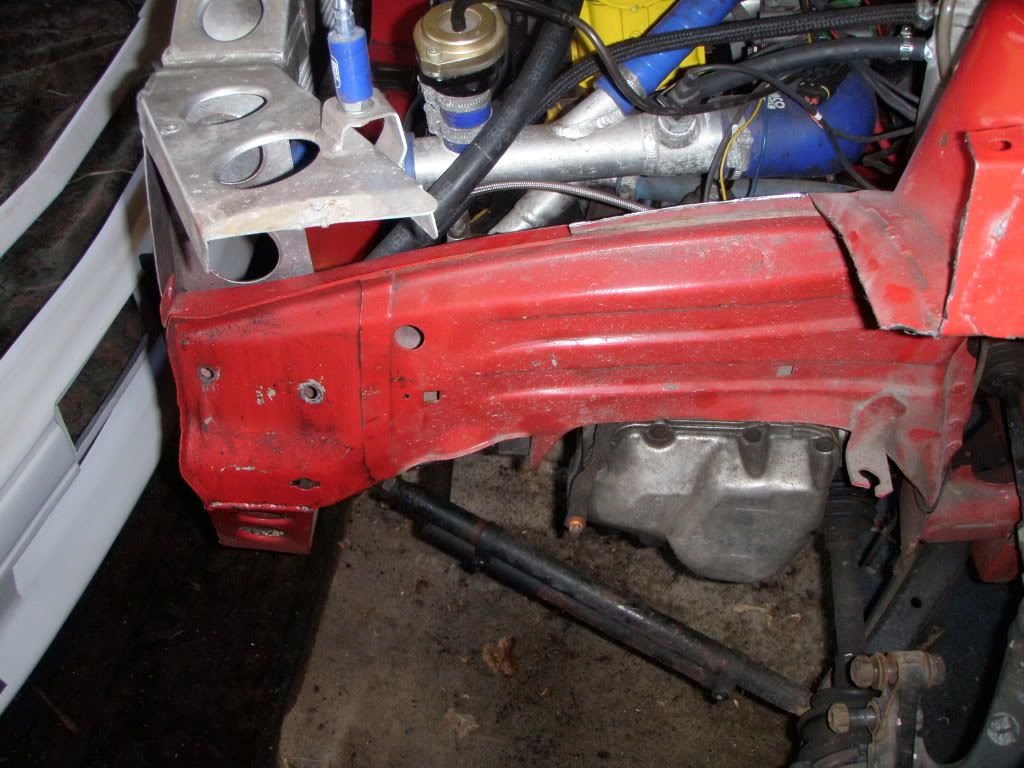

I've chopped the rest of the front inner wings out to save a bit more weight (about 1.5kg);
http://i285.photobucket.com/albums/l...ort/010-31.jpg
http://i285.photobucket.com/albums/l...ort/009-32.jpg
The gaps will be filled in with carbon fibre sheet eventually.

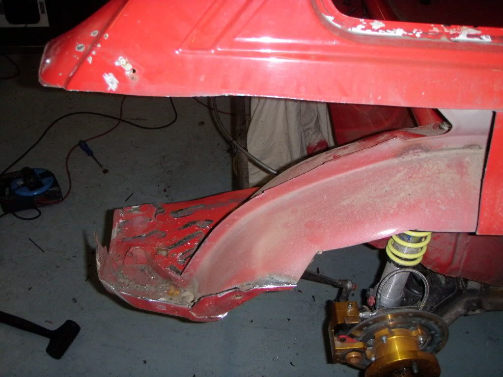

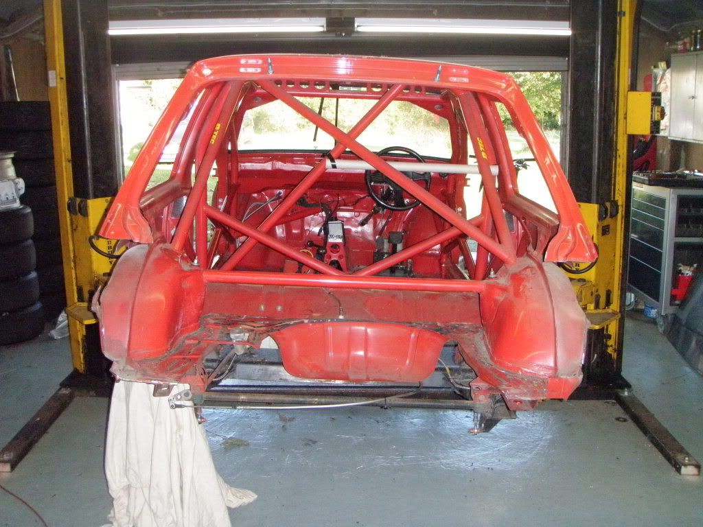

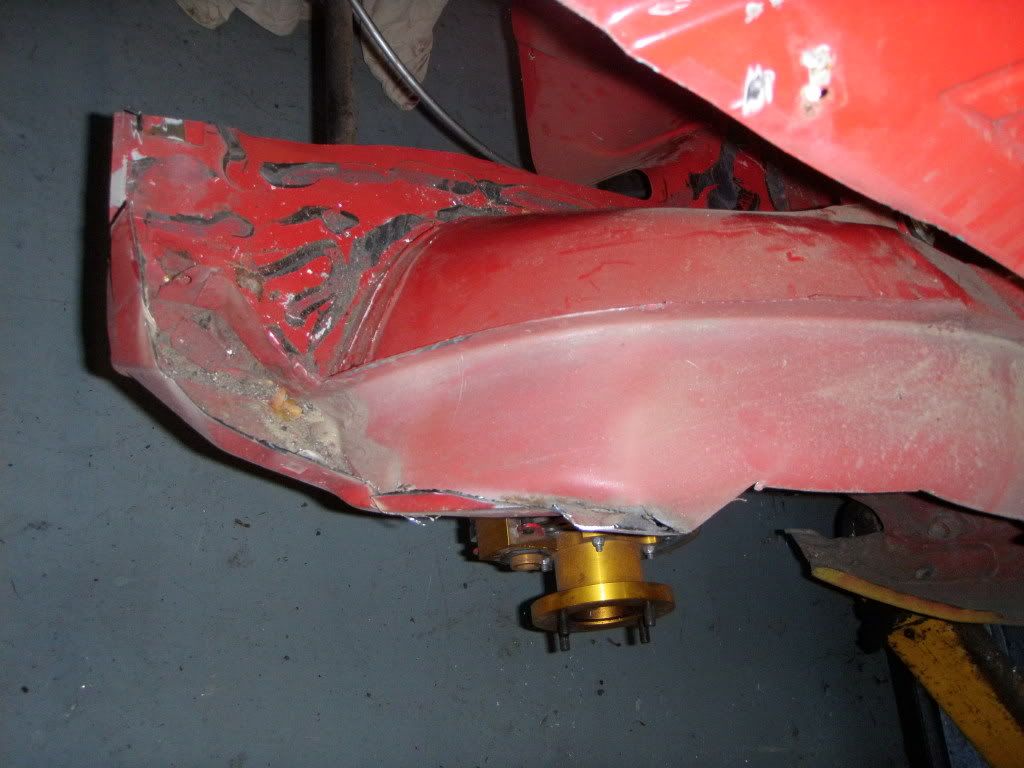

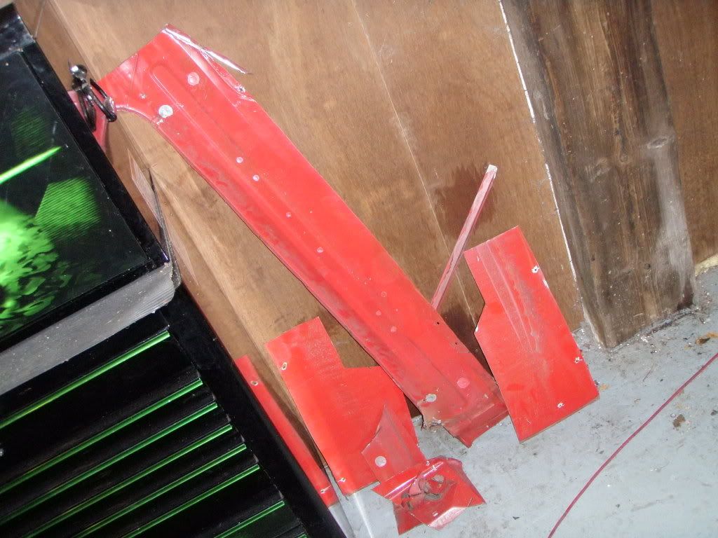

I'm also carrying out major metalwork at the back end, removing all the metal I can get away with in accordance with the Regulations;
http://i285.photobucket.com/albums/l...ort/012-28.jpg
http://i285.photobucket.com/albums/l...ort/013-21.jpg
http://i285.photobucket.com/albums/l...ort/014-24.jpg
http://i285.photobucket.com/albums/l...ort/017-33.jpg
http://i285.photobucket.com/albums/l...ort/018-29.jpg
The pile of rear metalwork so far (nearly 4kg);
http://i285.photobucket.com/albums/l...ort/019-25.jpg

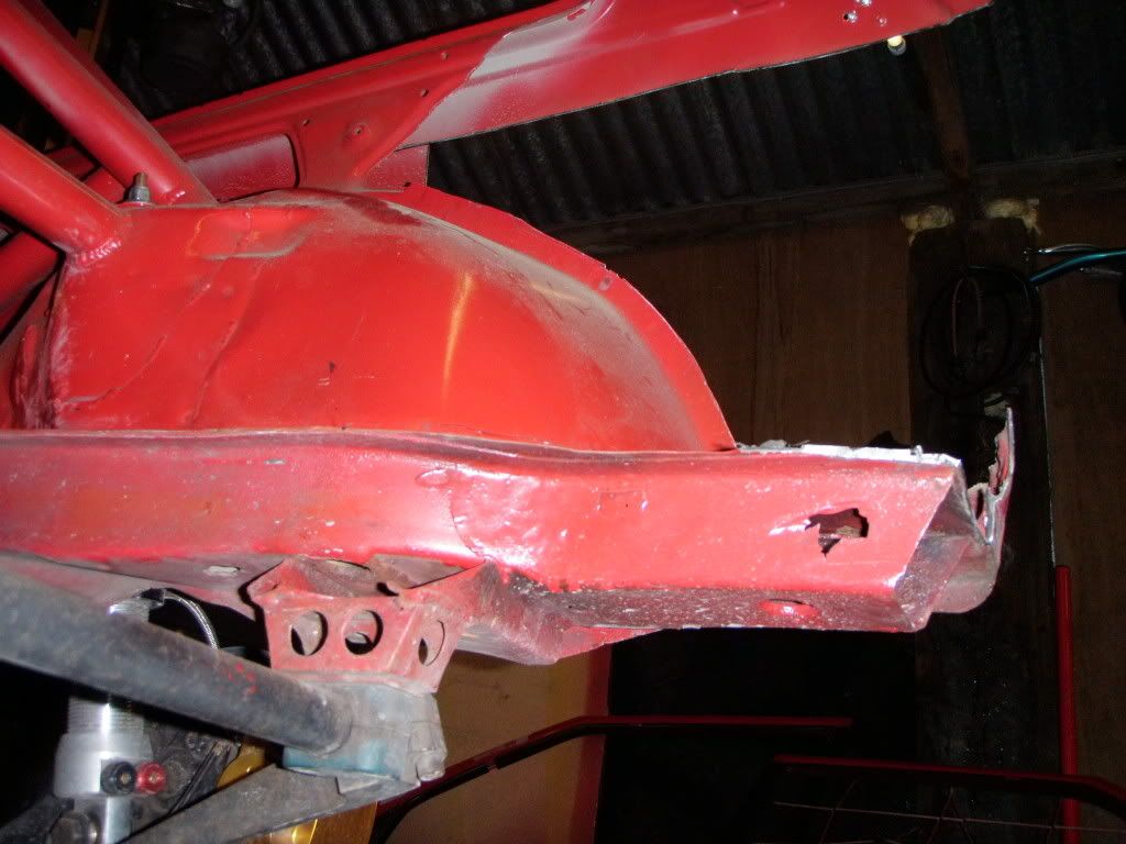

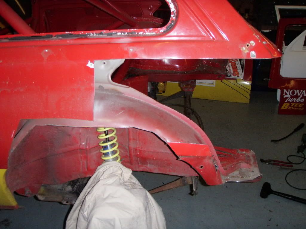

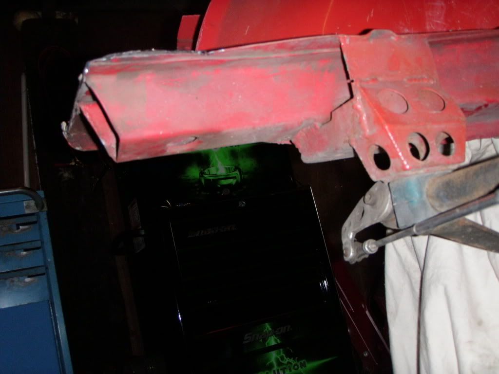

I shall take expert advice before I do it, but I plan to also remove the rearmost sections of chassis rail behind the mountings for the anti roll bar, along with the outer sections of the wheel arches;
http://i285.photobucket.com/albums/l...ort/015-26.jpg
http://i285.photobucket.com/albums/l...ort/016-32.jpg

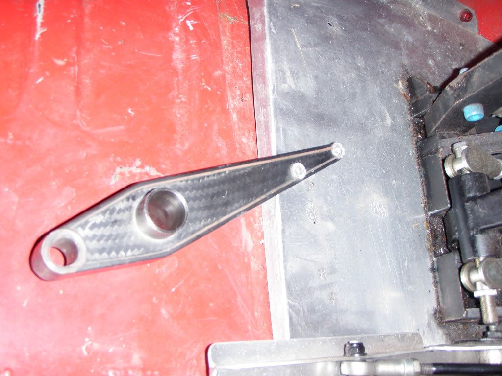

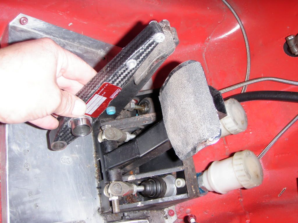

I've also acquired a rather nice carbon fibre brake pedal, which previously did service in a 1992 Formula 1 Arrows Footwork car;
http://i285.photobucket.com/albums/l...ort/002-59.jpg
http://i285.photobucket.com/albums/l...ort/001-24.jpg
I have serious doubts about whether it can be made to fit my pedal box, but it looks nice.........

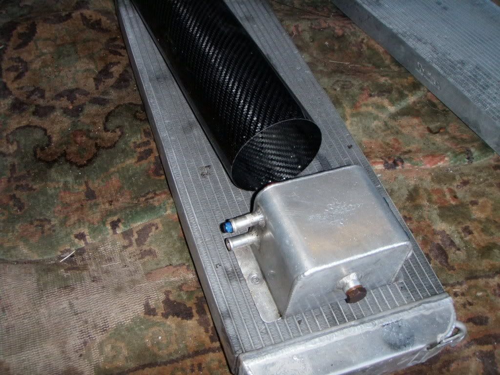

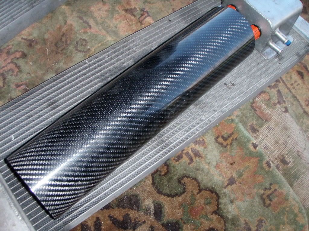

And my existing alloy oil catch tank is too heavy, so I'm going to make my own out of carbon fibre, using some of this tubing I got hold of;
http://i285.photobucket.com/albums/l...ort/021-19.jpg
http://i285.photobucket.com/albums/l...ort/020-21.jpg

As for the rear sections since you've cut out all they attach to you'll lose nothing by trimming them down, in fact trimming them down and then capping them off may well be stiffer if anything, at the moment though they're just flapping in free air so not doing anything at all. I would leave your wheelarches as is as they're actually probably the strongest thing on a nova, and your ARB attaches to them.
Edit: although anything behind the ARB or the outer part of the arches or actually 'inner arch' as you'd call them if doing bodywork like an arch repair if that makes sense?... could go, as they're only .5mm stuff and not really structural.
