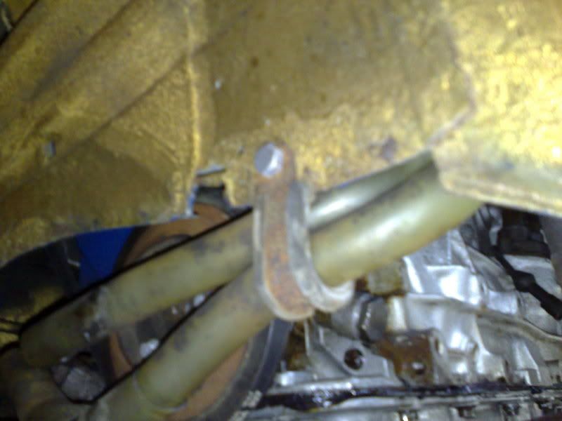

> Stop exhaust from knocking, and check for any blowing as we put it on with no paste
... done this today at local garage who gave me access to a ramp for a couple of hours, used oxygen and acetylene to heat up manifold and bend it away from tunnel, checked for blowing and was only blowing on 1 joint out of 3, so was pleased about that

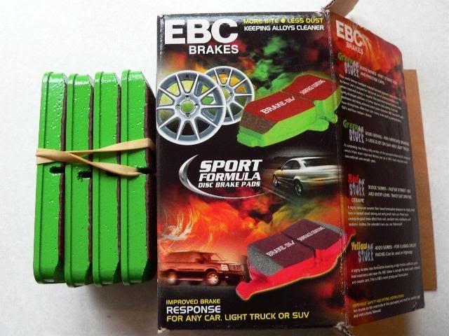

was around silverstone area today, so I dropped by Mardi Gras Motorsport to buy some Ferodo DS2500s, they had them on the shelf for Dynalite II calipers, and a bargain price of ?42
wanted them in for trackday at Bedford, but obviously needed them bedding in, so i fitted them tonight intime for the journey daaan saaafff, so that'll be 300miles worth at least.

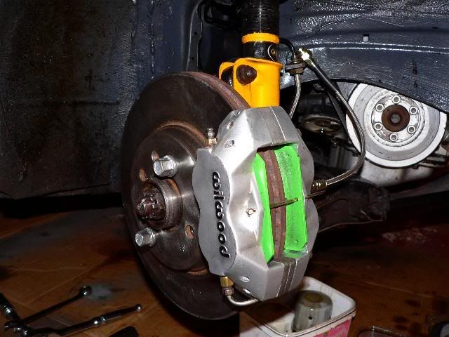

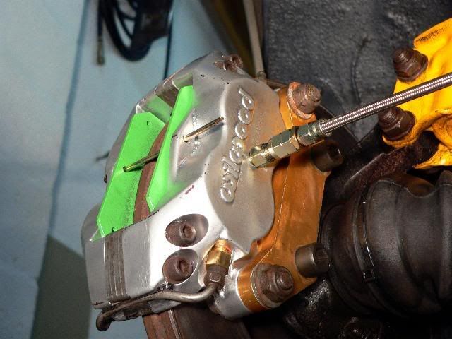

pics of new pads i've decided to try out
http://i136.photobucket.com/albums/q...ure/nc0613.jpg
very pleasing to see that the apparent rubbish EBC greenstuff have held out very well considering alot of road mileage, along with a wet trackday
