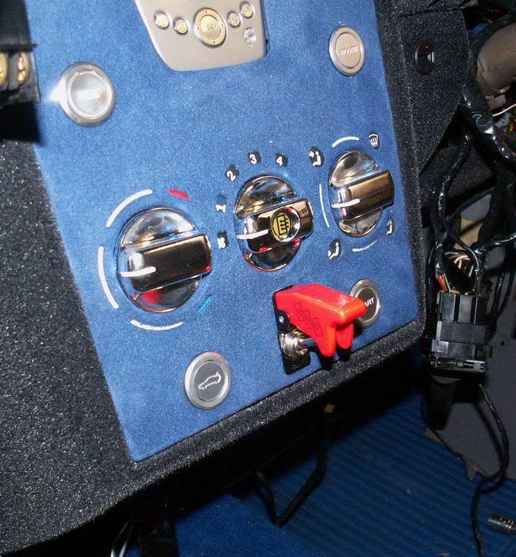

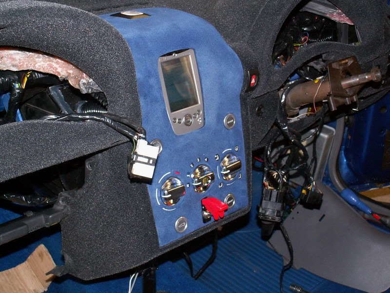

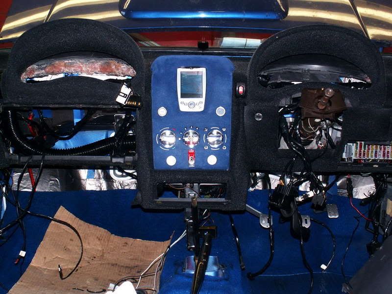

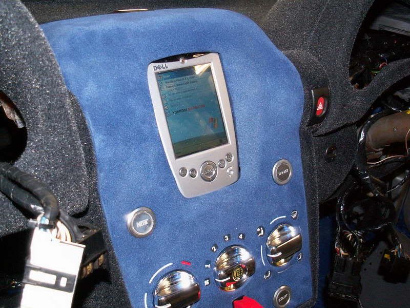

Bit more work done today ....
Got the central console sorted and all wired up . Put in the wires for the fan and all the switches and satnav. Even sorted a cable which will adjust the air temp!!! The blue flock looks better in person bit these give you an idea.

cant beleive how professional the dash looks joff!!
totaly amazing mate!! top job!!
