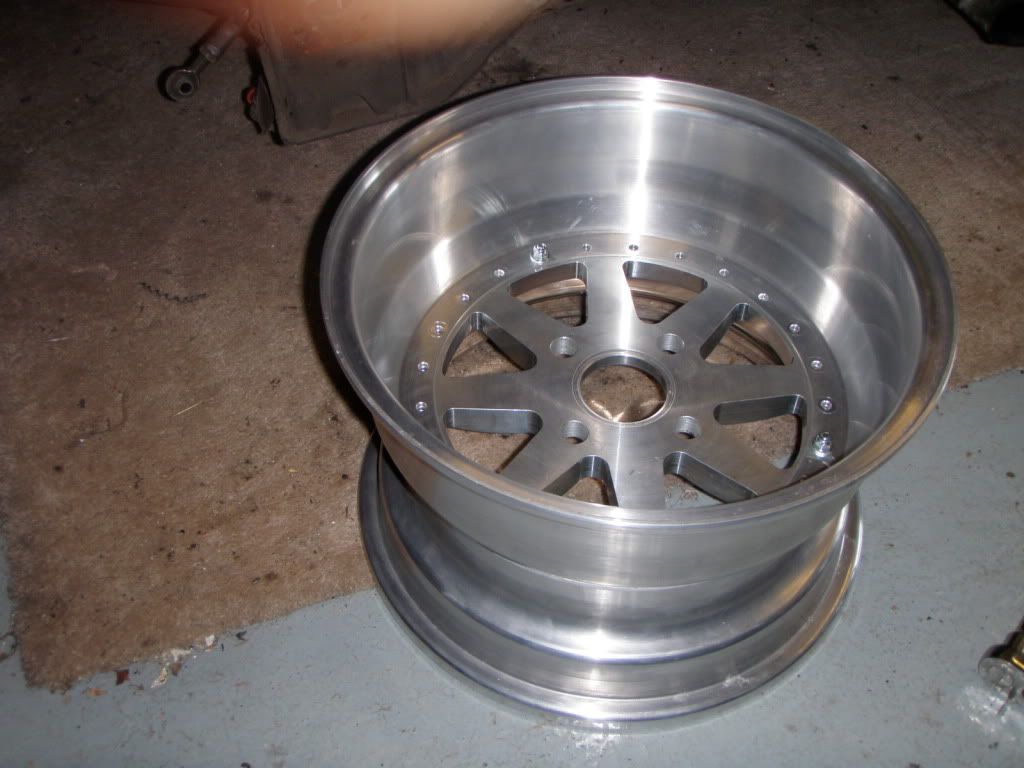

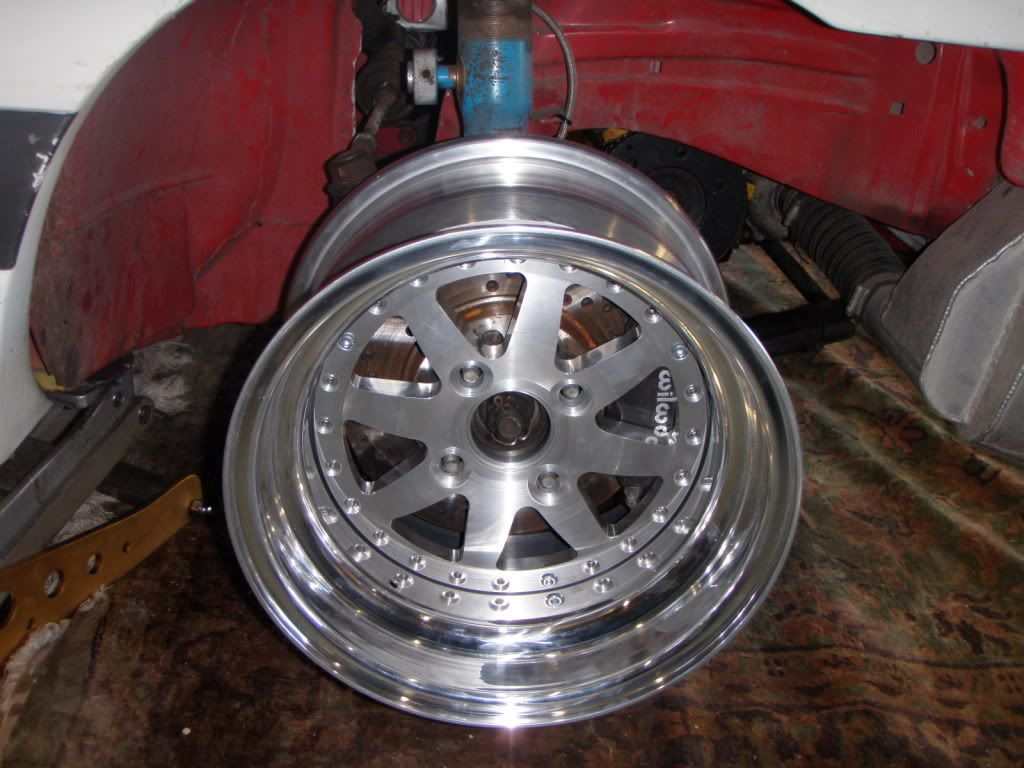

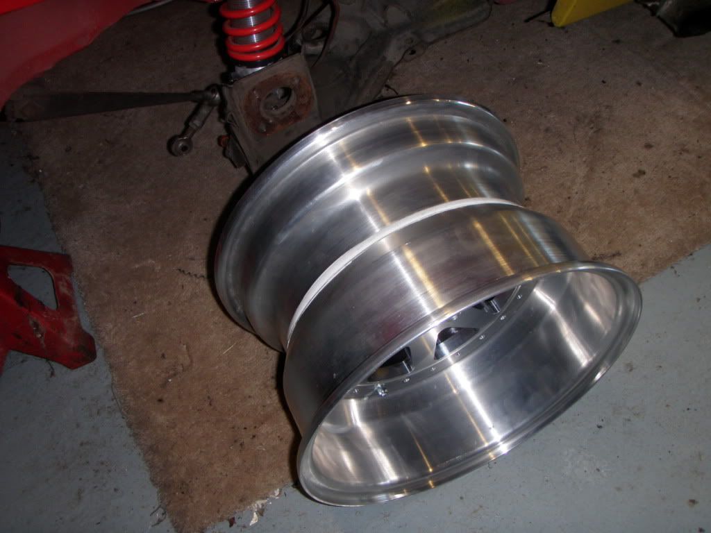

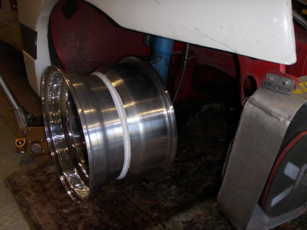

Borrowed a split rim from the man who is going to make my new set of wheels so I can do some experimenting with size, fitting and offset.
This is an 8" x 13" wheel, ET -3;
http://i285.photobucket.com/albums/l...ort/003-22.jpg
http://i285.photobucket.com/albums/l...ort/004-17.jpg
It doesn't fit on the front as the caliper protrudes past the hub mounting face, and the wheel has a flat centre. So that will need addressing;
http://i285.photobucket.com/albums/l...ort/005-17.jpg
http://i285.photobucket.com/albums/l...ort/006-17.jpg

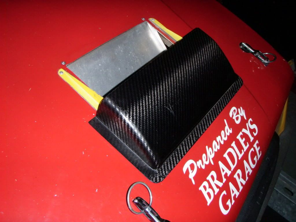

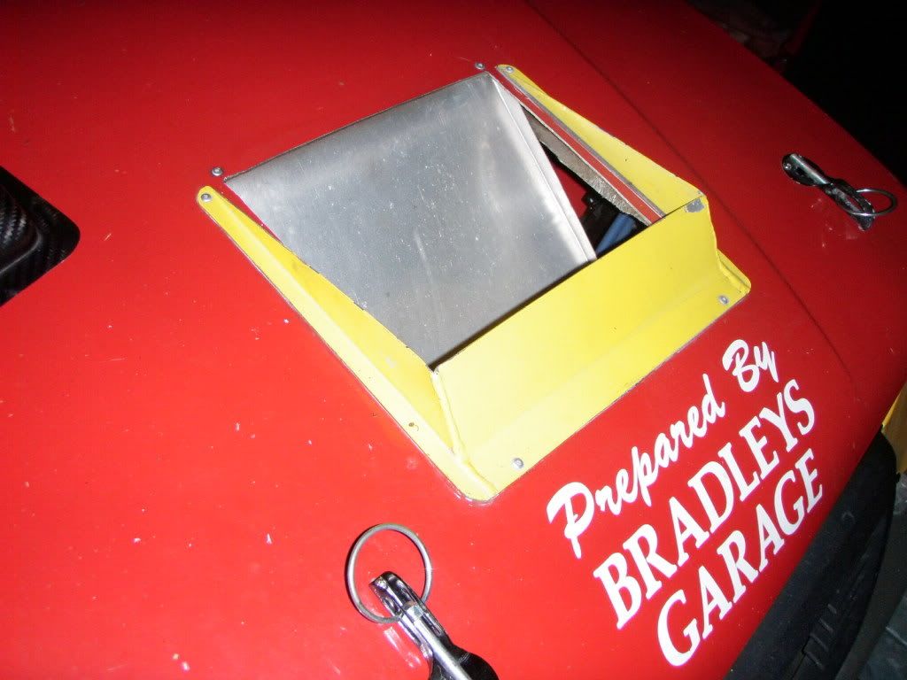

And I may replace the current aluminium bonnet vent with a carbon one;
http://i285.photobucket.com/albums/l...ort/002-20.jpg
http://i285.photobucket.com/albums/l...ort/003-23.jpg
