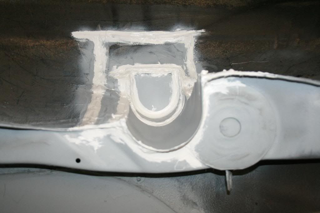

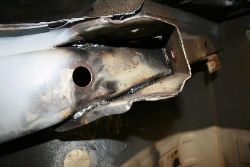

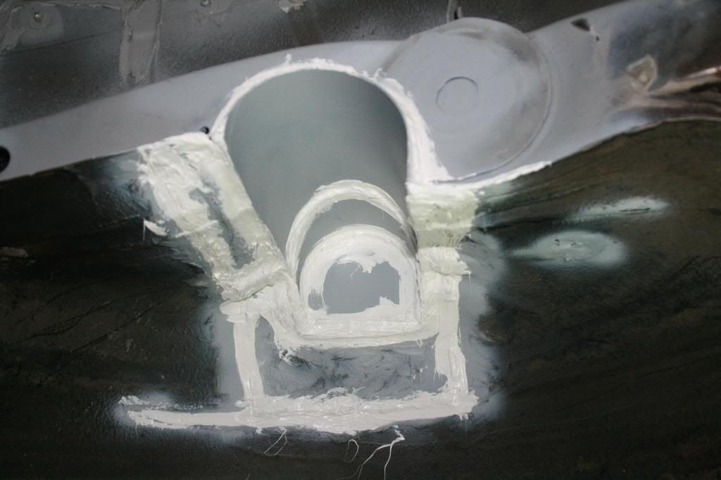

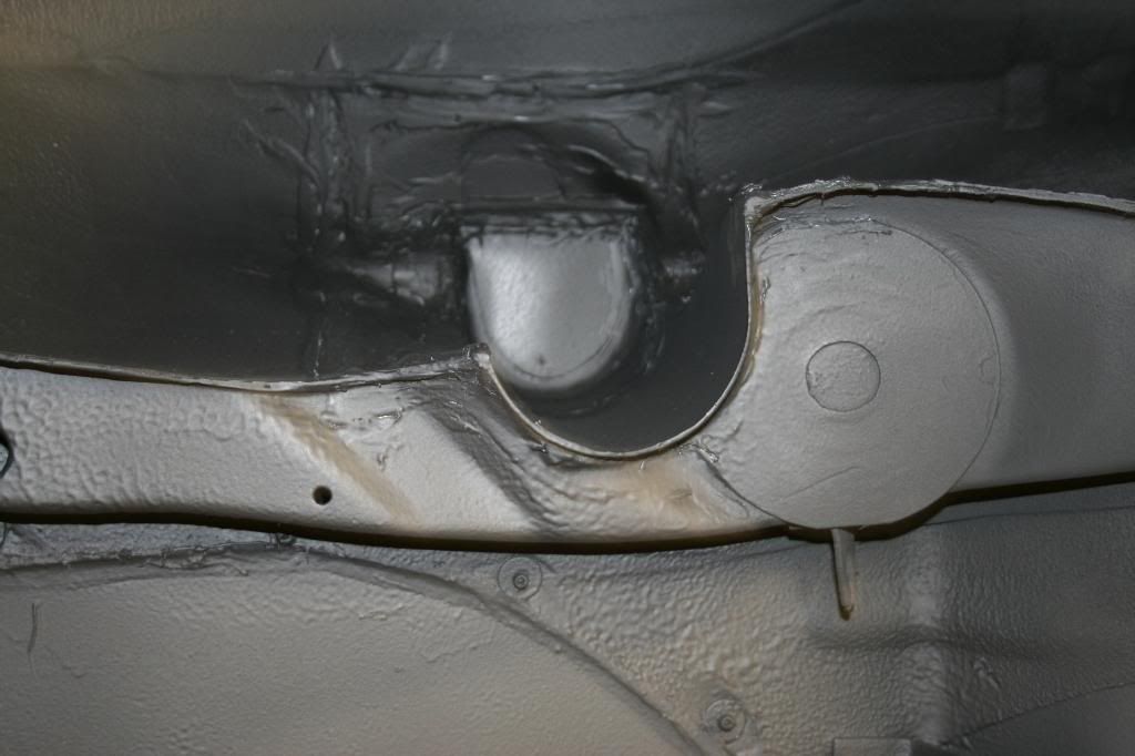

Seam sealed the turrets inner arch side
http://i248.photobucket.com/albums/g...urrets1159.jpg
http://i248.photobucket.com/albums/g...urrets1160.jpg

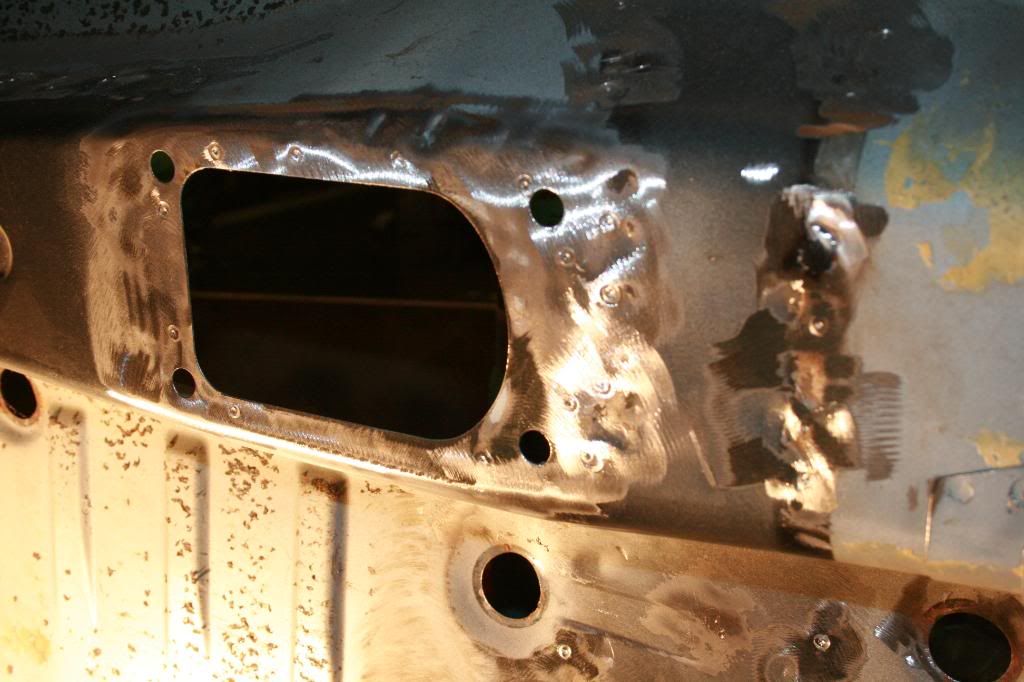

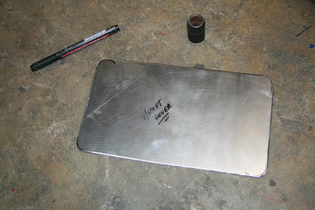

Questions questions...
Any know the significance of the socket???
http://i248.photobucket.com/albums/g...urrets1158.jpg
I'll tell you....round edges lol
http://i248.photobucket.com/albums/g...urrets1161.jpg

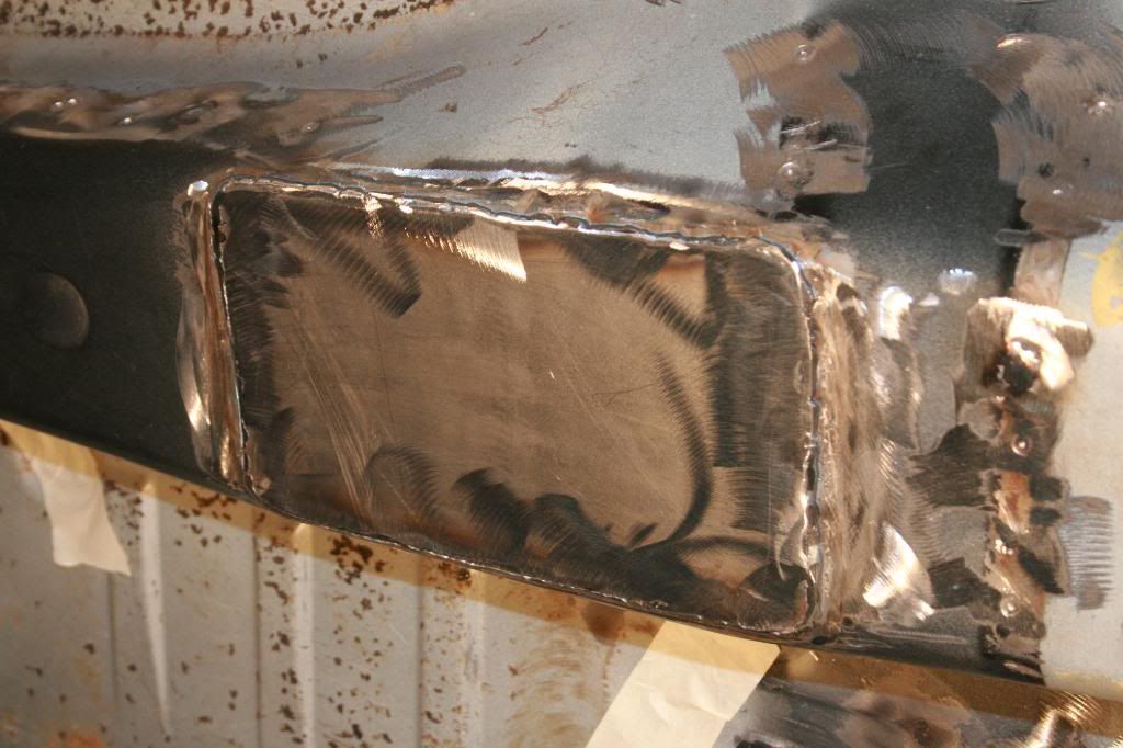

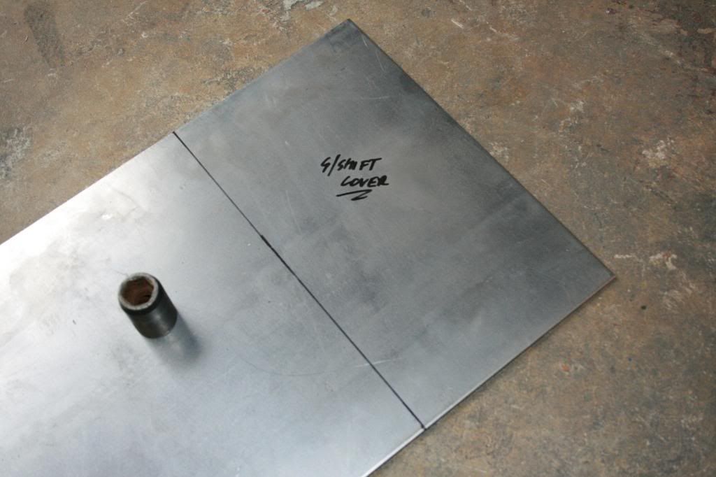

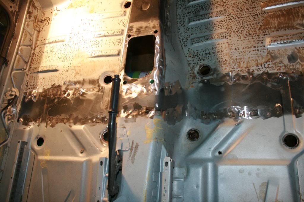

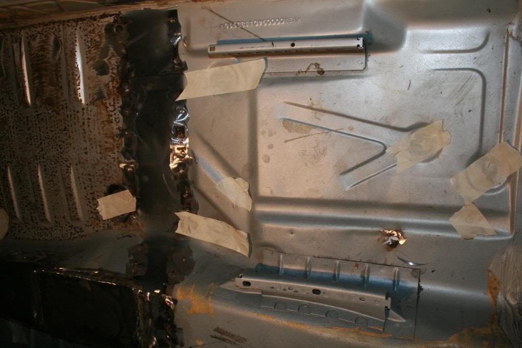

And one gear shift hole cover
http://i248.photobucket.com/albums/g...urrets1164.jpg

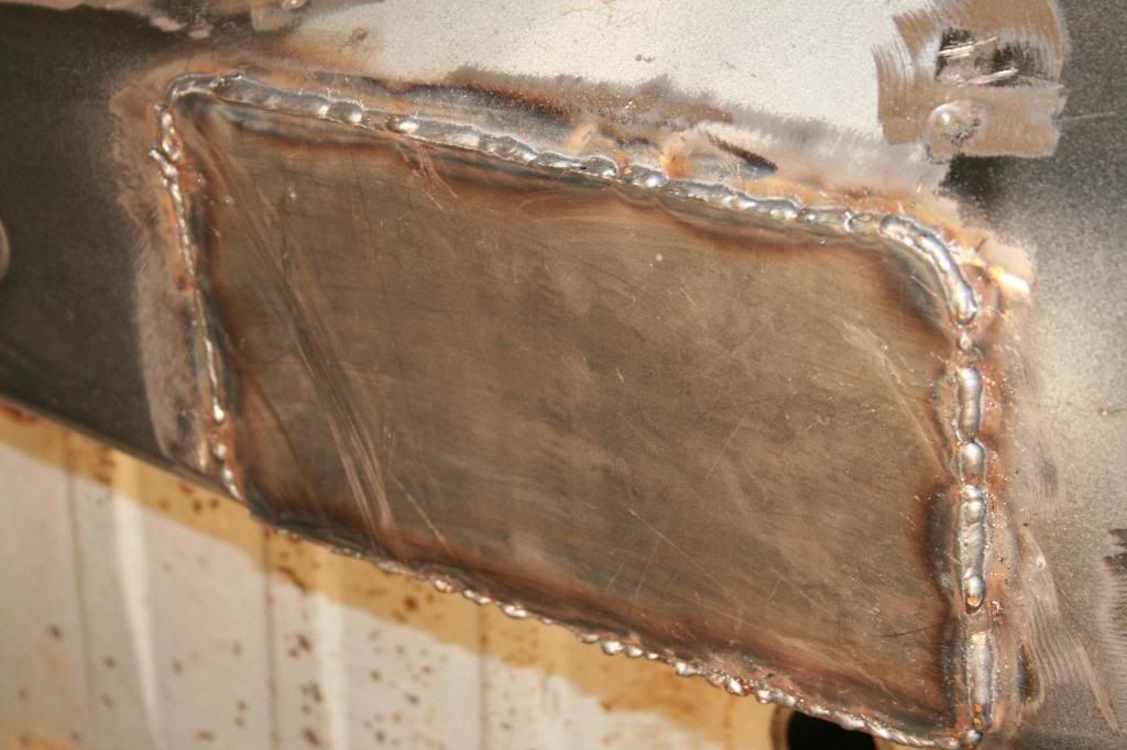

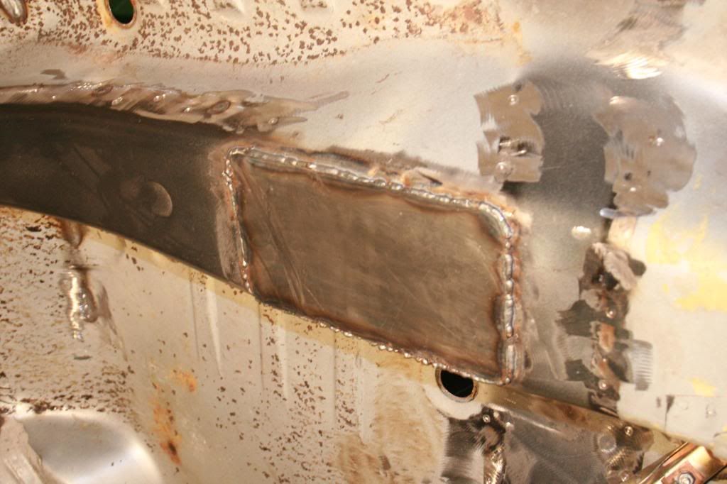

Cleaned the area up and got rid of the sharp edges from the spot welds
http://i248.photobucket.com/albums/g...urrets1162.jpg
http://i248.photobucket.com/albums/g...urrets1163.jpg
And welded it in
http://i248.photobucket.com/albums/g...urrets1165.jpg
http://i248.photobucket.com/albums/g...urrets1166.jpg
Then cleaned it up
http://i248.photobucket.com/albums/g...urrets1167.jpg

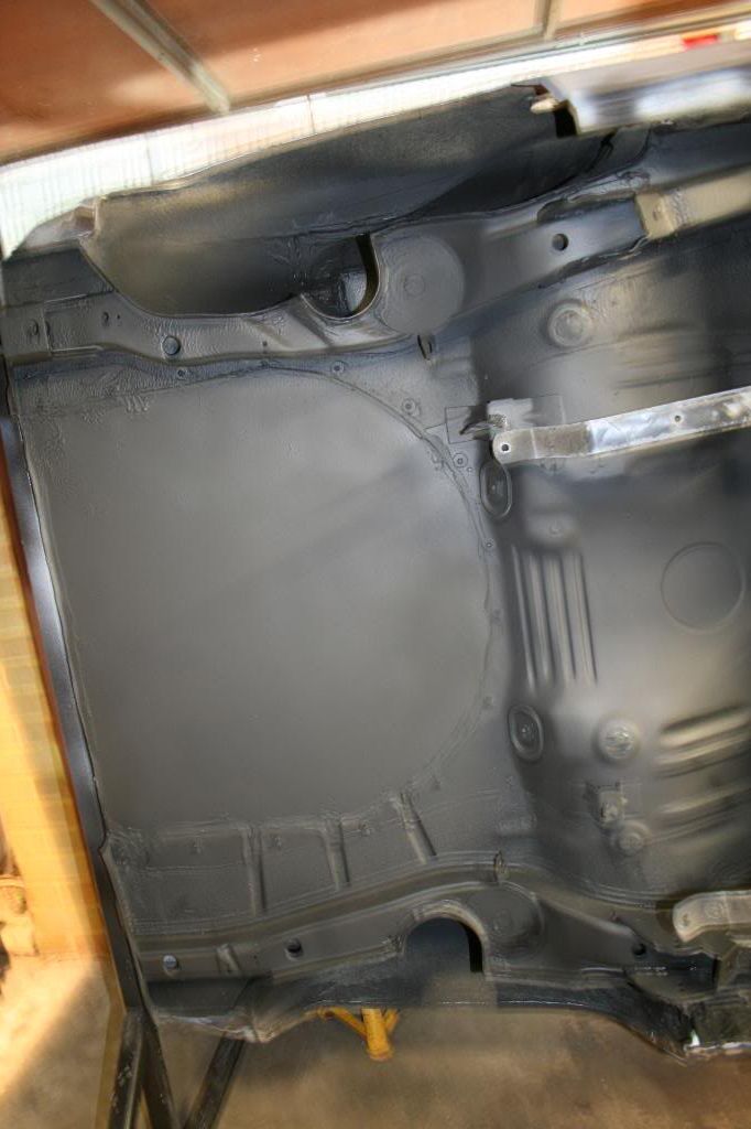

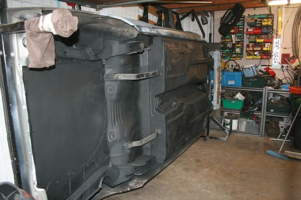

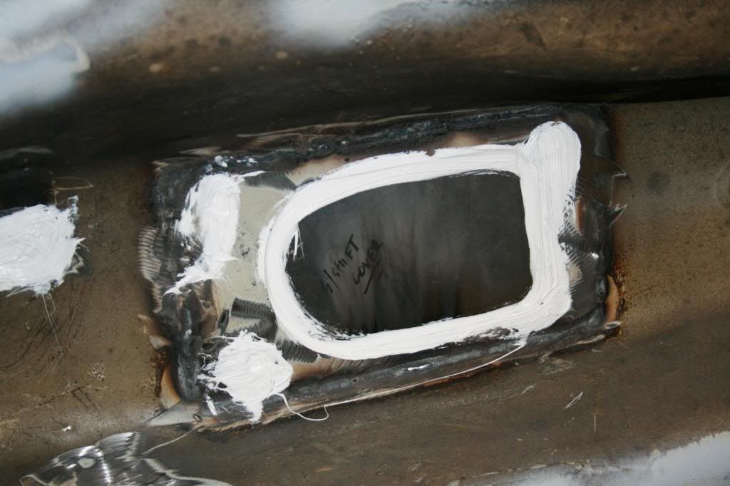

And sealed the under side
http://i248.photobucket.com/albums/g...urrets1169.jpg

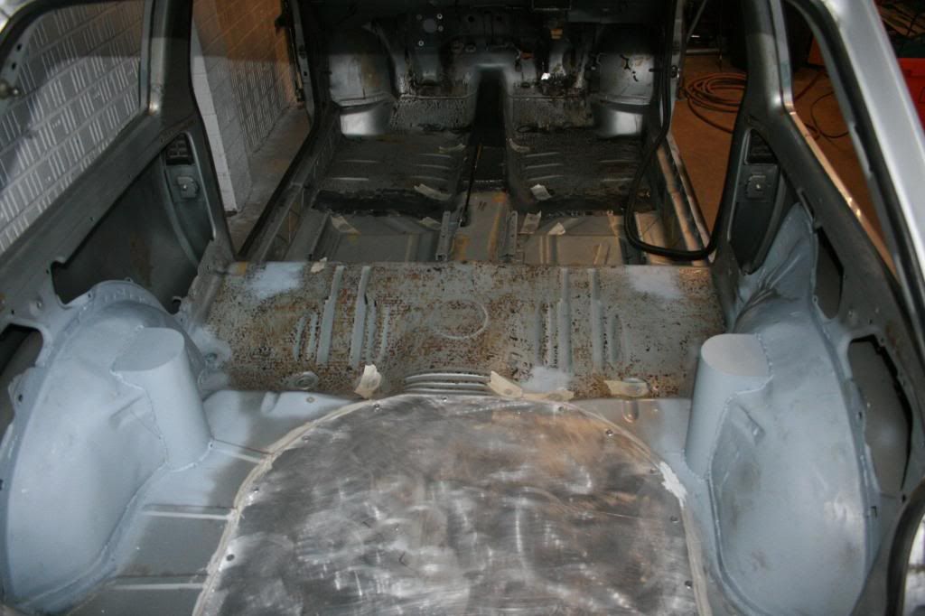

Then i covered up the rest of the holes in the under side of the car
http://i248.photobucket.com/albums/g...urrets1168.jpg
http://i248.photobucket.com/albums/g...urrets1170.jpg
And stuck a few more stitches in
http://i248.photobucket.com/albums/g...urrets1171.jpg
And gave it a good blacking with some stone chip! :D
http://i248.photobucket.com/albums/g...urrets1172.jpg
http://i248.photobucket.com/albums/g...urrets1173.jpg
http://i248.photobucket.com/albums/g...urrets1174.jpg
http://i248.photobucket.com/albums/g...urrets1175.jpg

How many coats of that did you/are you going to give it ? :)
Yes i have a girl friend, yes i have spent a lot of time on the car, yes she is very understanding and i am very grateful.Quote:
Two or as many as you think it needs it can be applied thickly :thumb:Quote:
Cheers Chris :D here come some more for ya xQuote:
Originally Posted by Ernie
Nice one fella :thumb:Quote:
Get it caked on! :)

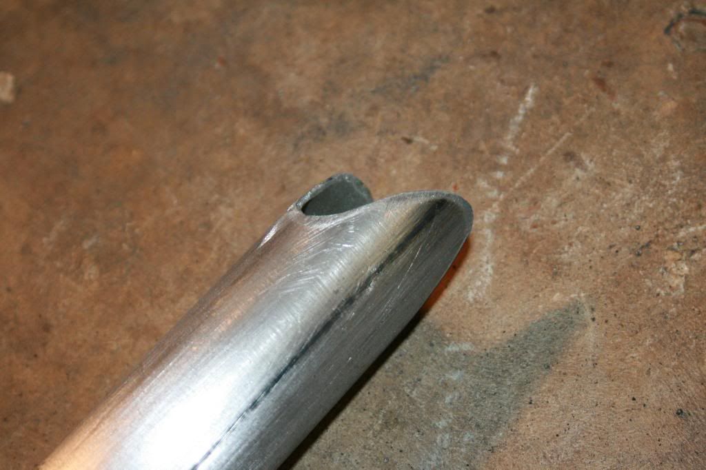

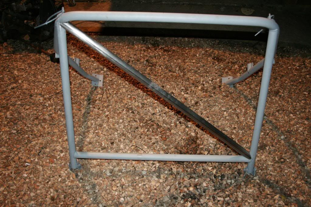

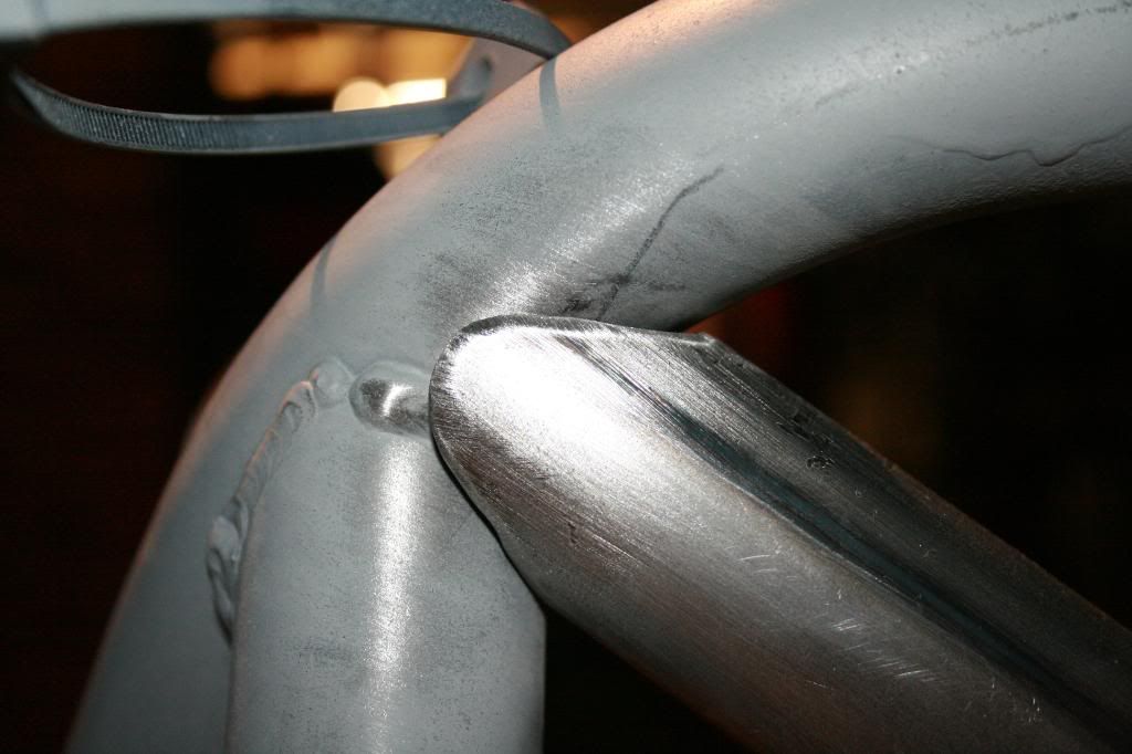

I started thinking about the cage as the car was nearly ready to go horizontal again so i profiled up my rear diagonal
http://i248.photobucket.com/albums/g...urrets1176.jpg
http://i248.photobucket.com/albums/g...urrets1178.jpg
And slipped her in - oh er
http://i248.photobucket.com/albums/g...urrets1179.jpg
http://i248.photobucket.com/albums/g...urrets1181.jpg
http://i248.photobucket.com/albums/g...urrets1182.jpg
http://i248.photobucket.com/albums/g...urrets1183.jpg
Snug as a bug
http://i248.photobucket.com/albums/g...urrets1184.jpg

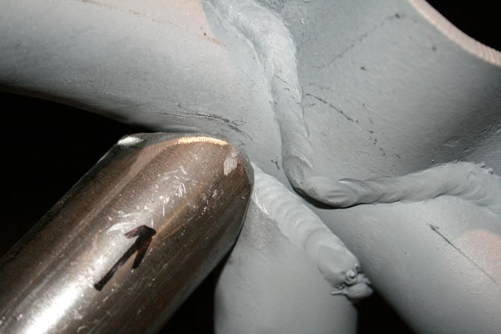

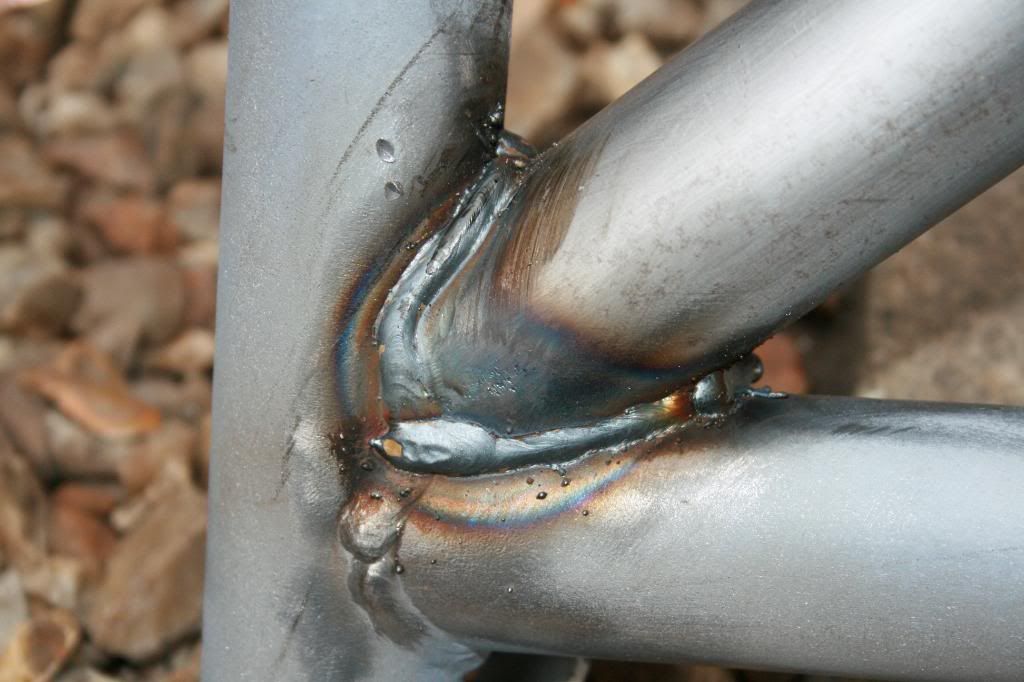

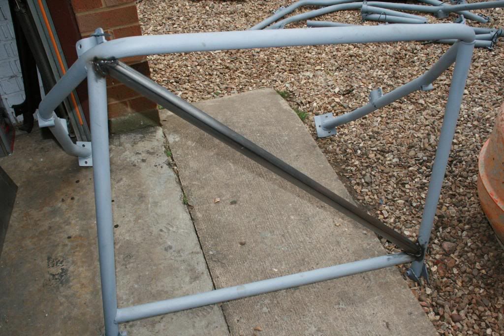

So today after work and repairing a cement mixer drum (don't ask!) i welded the diagonal in place.
http://i248.photobucket.com/albums/g...urrets1185.jpg
http://i248.photobucket.com/albums/g...urrets1186.jpg
http://i248.photobucket.com/albums/g...urrets1187.jpg

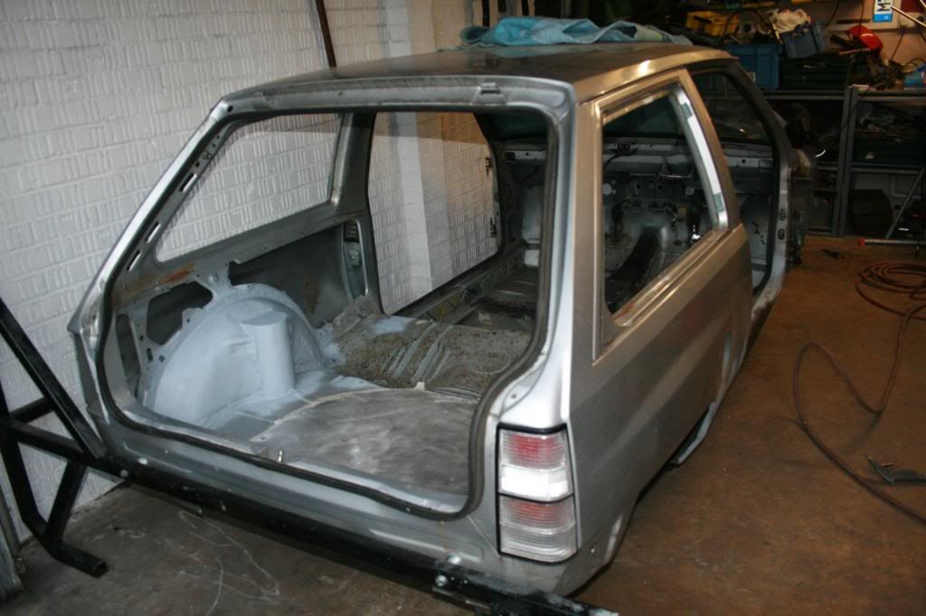

With a clean up going on (and the fact the car was now taking up more space) i shifted the engine from behind the car to the engine stand so i could start tidying it up
http://i248.photobucket.com/albums/g...urrets1194.jpg
http://i248.photobucket.com/albums/g...urrets1195.jpg
http://i248.photobucket.com/albums/g...urrets1196.jpg

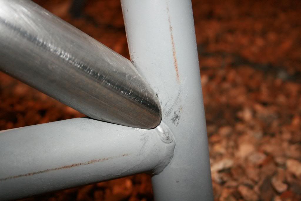

Once the primer had dried on the cage i had a play with it in the car ready to make up some spreader plates
http://i248.photobucket.com/albums/g...urrets1197.jpg
http://i248.photobucket.com/albums/g...urrets1200.jpg
This pretty much funked my turret top plans - rethink needed as they don't meet the turret were i expected they would....:mad:

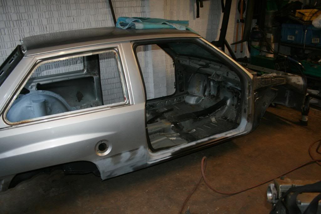

And some more messing around just because - the sill repair looks ok from this angle so i'm happy!
http://i248.photobucket.com/albums/g...urrets1209.jpg
nice workfella, love propper stonechip, used it on my inner arches, wish id of done what you have with the underside, but too far gone now lol,

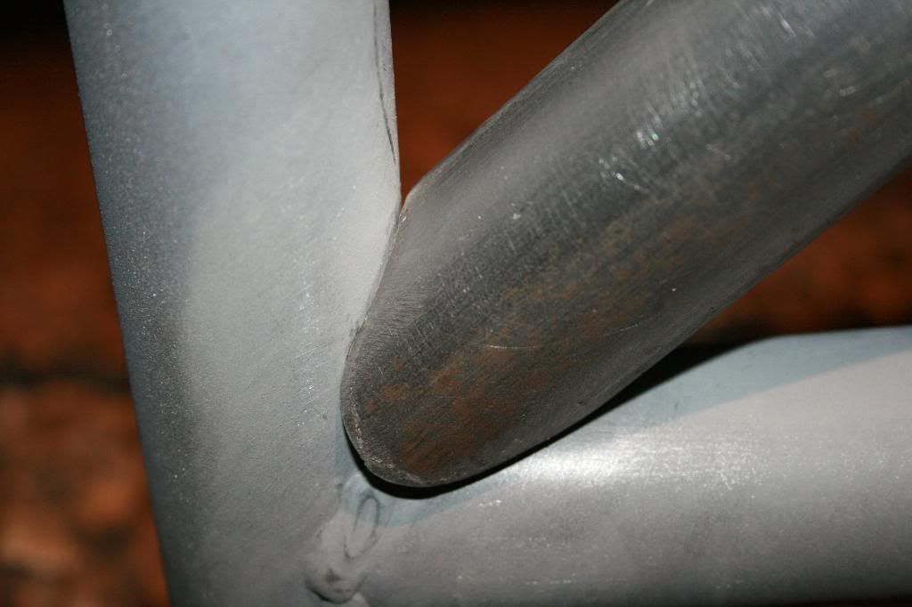

putting another diagonal in the cage?
Stone chip is really good stuff and worth doing imo. Not sure what you mean another diagonal? :confused:Quote:
Originally Posted by novashed
ie a cross so it intersects the one youve just put in, i never did but asthetically more pleasing lol
I thought thats what you meant (a cross diagonal lol) i think i will leave it as it is i don't need any more weight!!! :eek:Quote:

As for the cage, is it an SD one? And in the pics it look as if the legs fall short of the rear arch/turrets? not sure though as you have them coverd up, if they do you could make a small box type mount to bridge the gap (think Lee had to do something like this)

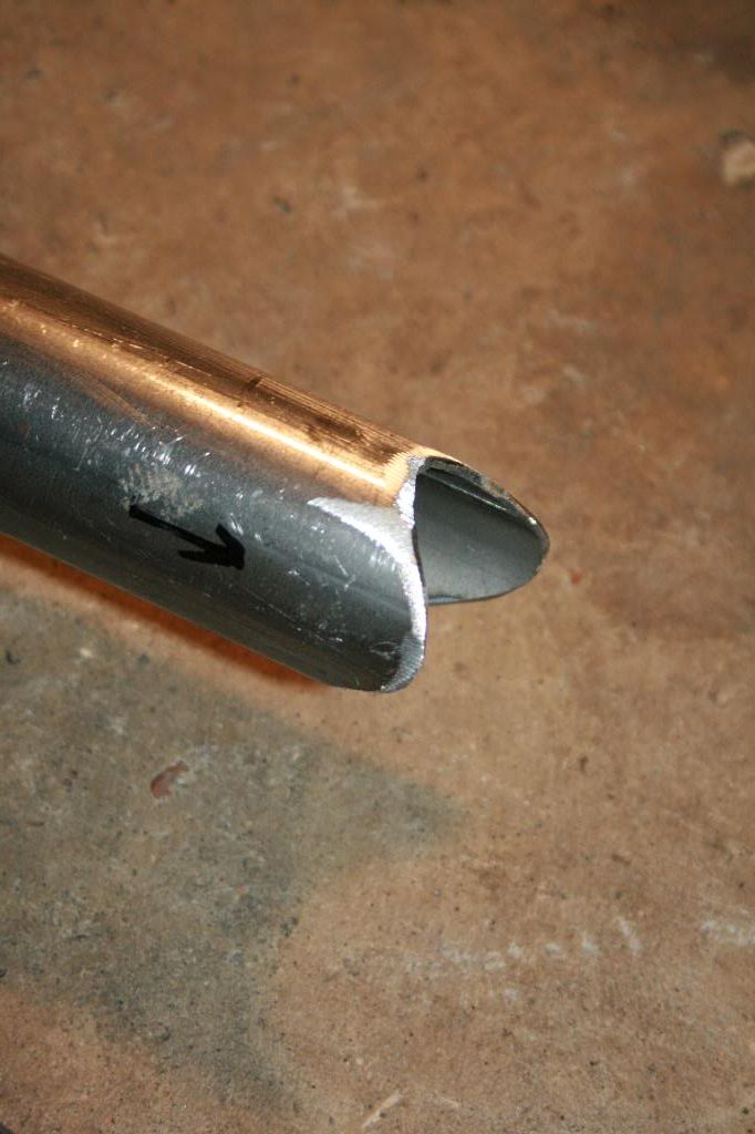

Then to solve the mystery it was time to use one of the strips of steel i went for a comfortable 45mm
I started by profiling it roughly to shape
http://i248.photobucket.com/albums/g...urrets1222.jpg
http://i248.photobucket.com/albums/g...urrets1223.jpg
Then began taking it in after i had cleaned up the seams

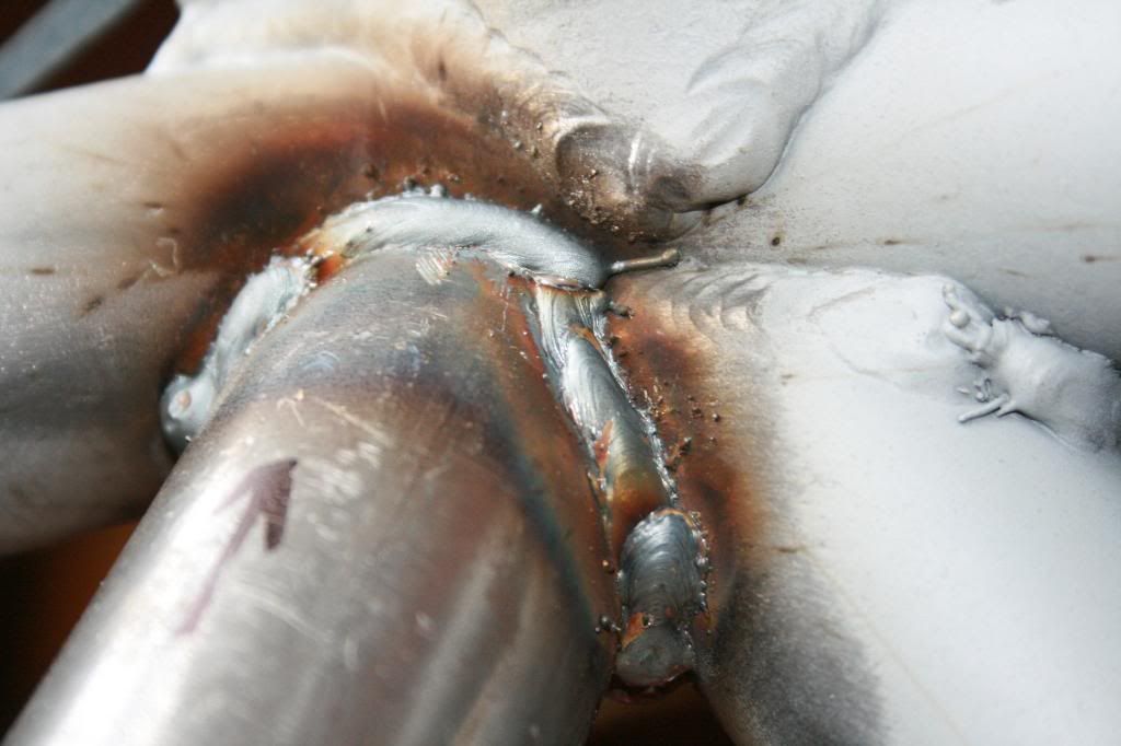

And started to weld it all in until the welded decided it was hot as funk again
http://i248.photobucket.com/albums/g...urrets1232.jpg
So while i was waiting for the welder to cool i decided to make up some supports for the new extension.
I gave the turret a clean up and removed all the excess weld (weight) once i had finished the welding that is.

All welded in
http://i248.photobucket.com/albums/g...urrets1243.jpg
http://i248.photobucket.com/albums/g...urrets1244.jpg
http://i248.photobucket.com/albums/g...urrets1246.jpg
http://i248.photobucket.com/albums/g...urrets1245.jpg
Gave it a good clean up and a prime for tonight
