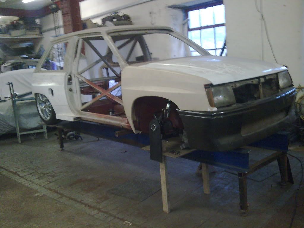

Heres a few update pics:

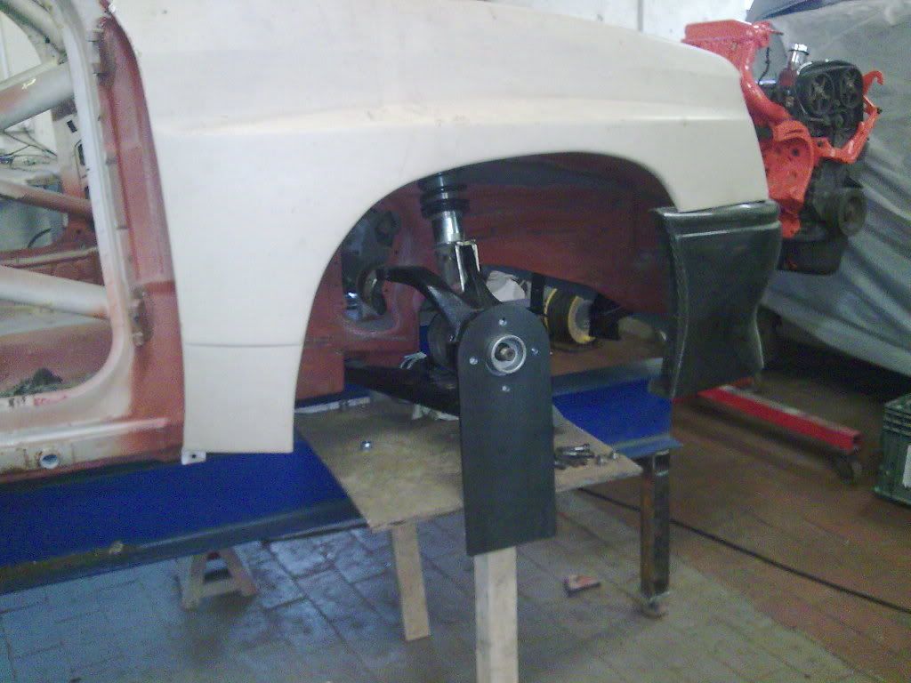

Car sat on frame, hub carriers have yet to be welded to the frame:
http://i227.photobucket.com/albums/d...d/Image026.jpg
Lazer cut hub carriers are to hold the hubs in position whilst the cars are build around them:
http://i227.photobucket.com/albums/d...d/Image025.jpg

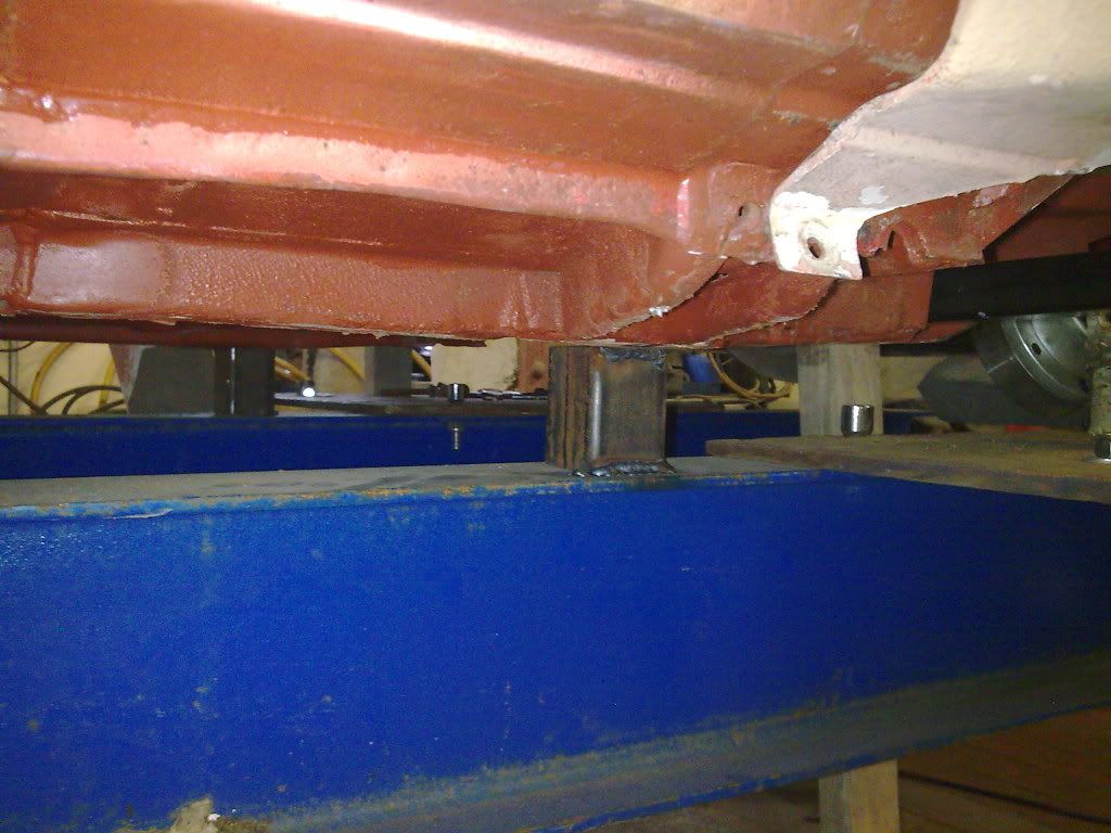

The cars welded to the frame on 3" blocks. This will be the cars ride height but will be able to adjust another 2" down:
http://i227.photobucket.com/albums/d...d/Image027.jpg

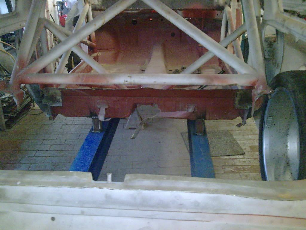

The rears been cut out to make way for the rest of the cage and the double wishbones:
http://i227.photobucket.com/albums/d...Image023-2.jpg
Thats it for the shell for now.........

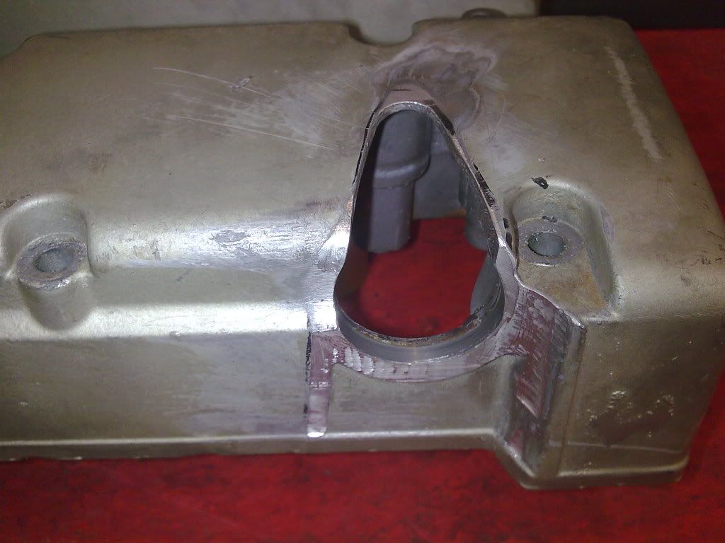

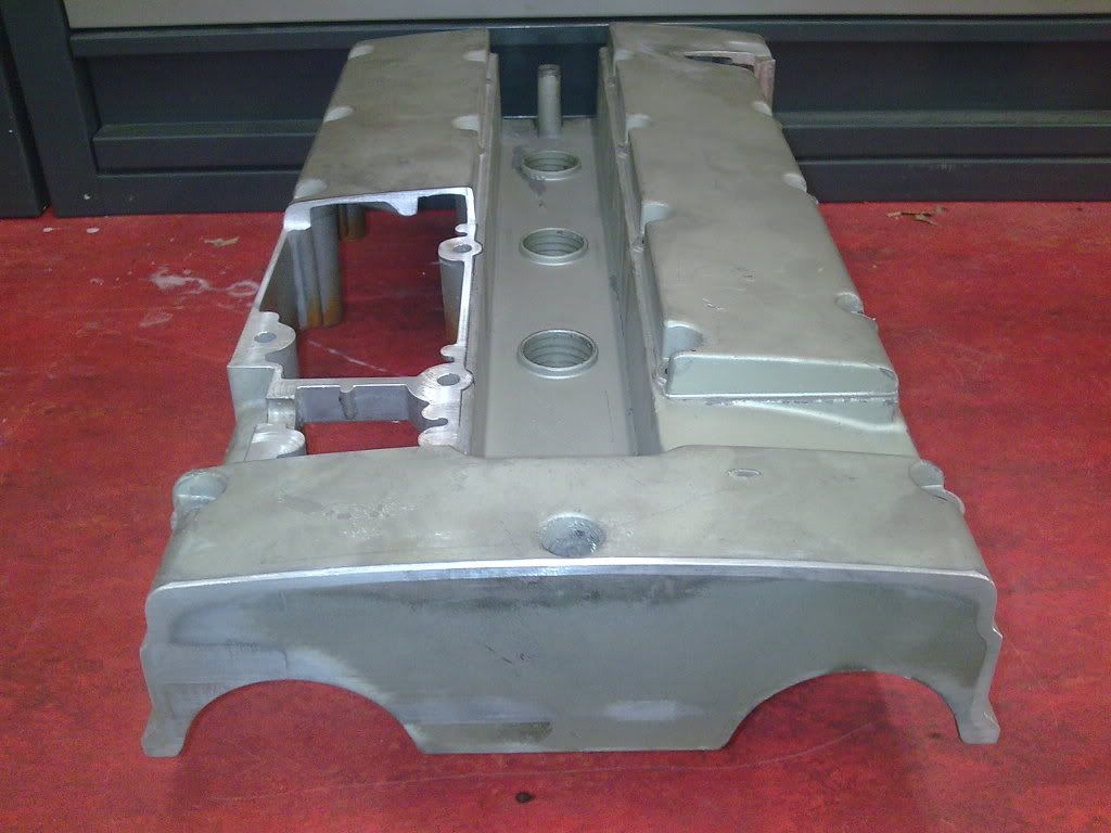

Also machined my cam cover so i can plate all the breathers off etc:
http://i227.photobucket.com/albums/d...Image007-2.jpg
http://i227.photobucket.com/albums/d...Image011-1.jpg

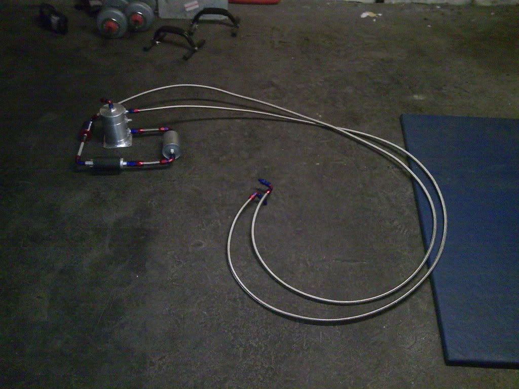

Heres a pic of part of the fuel system, just waiting for lift pump and tank:
http://i227.photobucket.com/albums/d...d/Image029.jpg

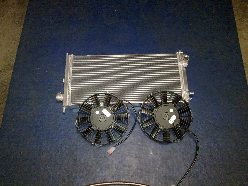

Alloy rad and twin SPAL fans:
http://i227.photobucket.com/albums/d...Image031-1.jpg

I'm running a very similar ride height on my saloon. Because I'm running turrets at the rear I've moved the top mount higher to get plenty of shock travel but fronts obviously I can't! What are you planning on doing - running much shorter shocks so they don't bottom out? What are you doing regarding driveshaft angles?
Cheers.
Im going to be running custom length shocks on the front. As for shaft angles i can position the engine /box whever i want due to space framing the frot :)
