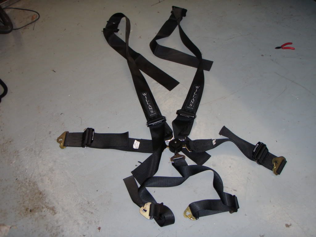

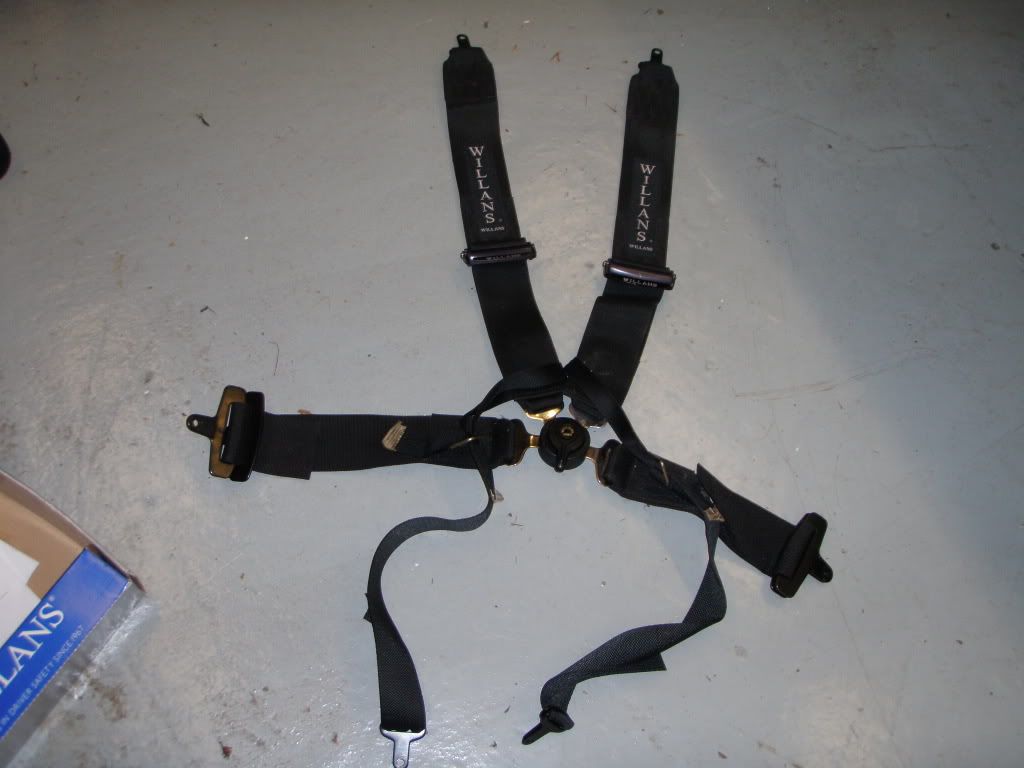

After doing some work on my Westfield yesterday, I noticed that the 6 point race harness in it seemed to be considerably lighter than the one in my Nova (both Willans Silverstone with the alloy adjusters). The Westfield uses the 'single seater' style harness with the short rear straps.
Putting them on the scales, the single seater harness is well over 1kg lighter than the 'saloon' version.
The main reasons for this are that the single seater harnesses bolt into place, rather than having the quick release clips that saloon harnesses have which attach to the eye bolts, and the design of the crutch strap differs.

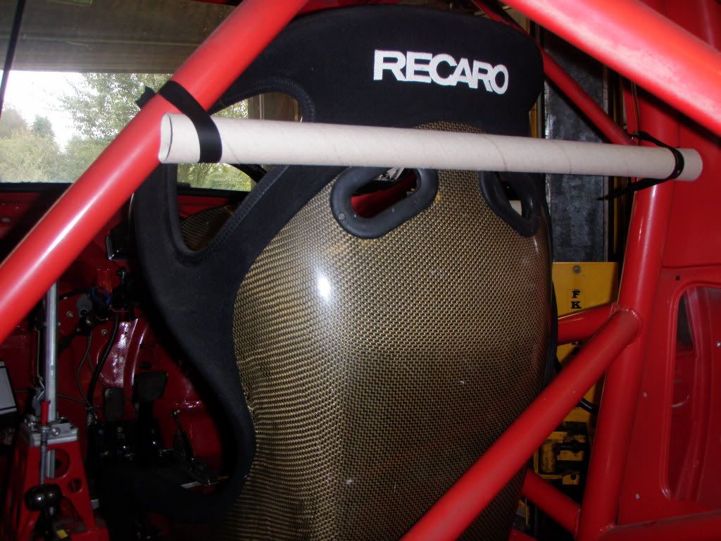

So now I'm considering whether to weld in an extra bar on the roll cage to attach a single seater type harness. The extra bar will obviously add a bit of weight, but not as much as I'd be saving (the tube would be T45 steel).
See photos to explain things more clearly;
The current 'saloon' type harness I use;
http://i285.photobucket.com/albums/l...ort/004-47.jpg
And the single seater type;
http://i285.photobucket.com/albums/l...ort/003-57.jpg
To use the single seater harness I'd need to add an extra bar to the roll cage, something like this;
http://i285.photobucket.com/albums/l...ort/002-55.jpg

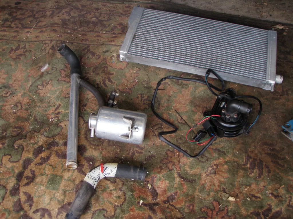

A slightly smaller alloy radiator, and a Davies Craig electric water pump which I acquired from a Mini;
http://i285.photobucket.com/albums/l...ort/001-22.jpg
I'm still debating whether or not to fit the radiator into the back of the car. But I do want to fit the electric water pump so it can be left circulating coolant even when the engine's switched off.

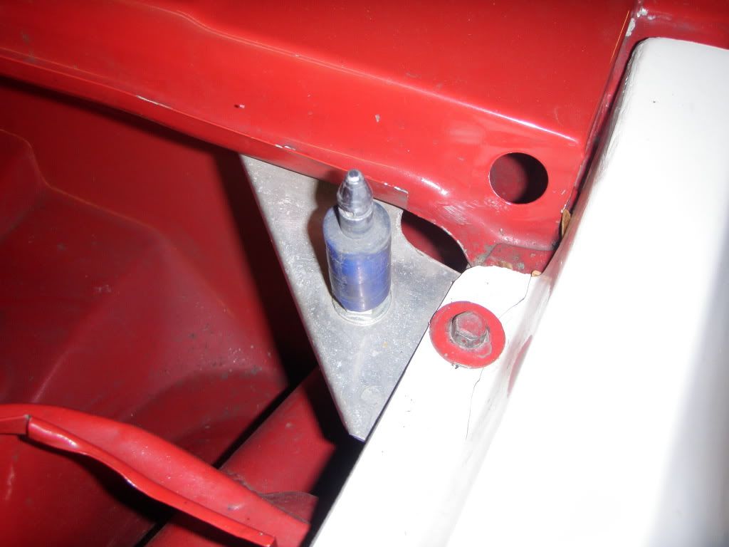

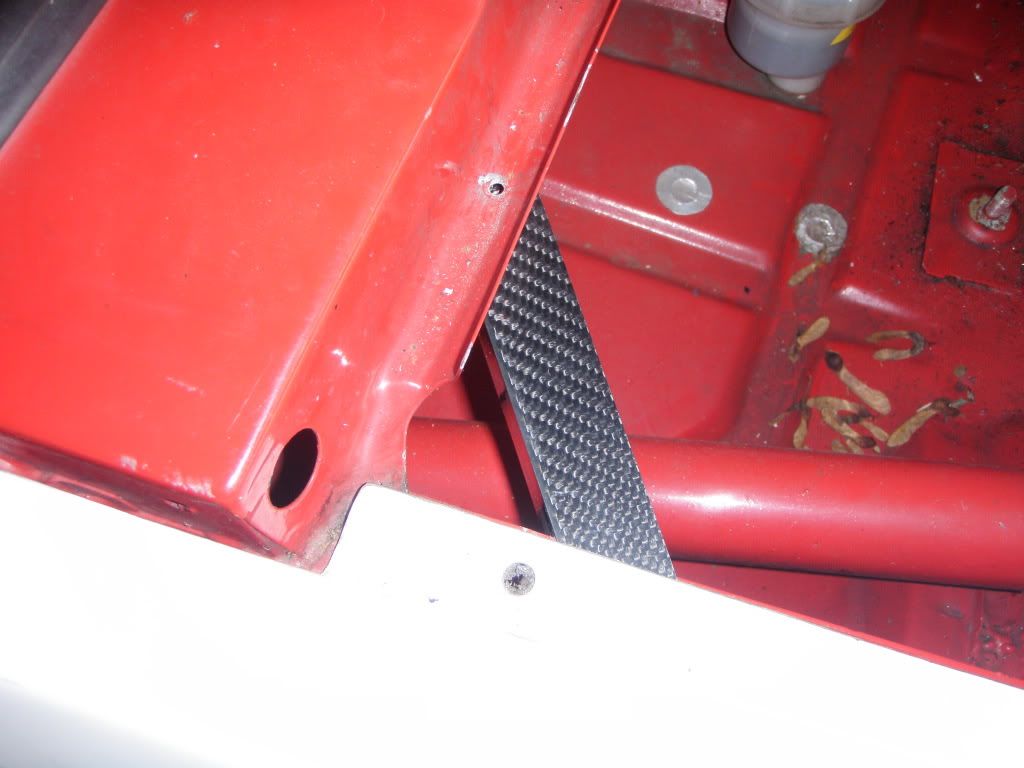

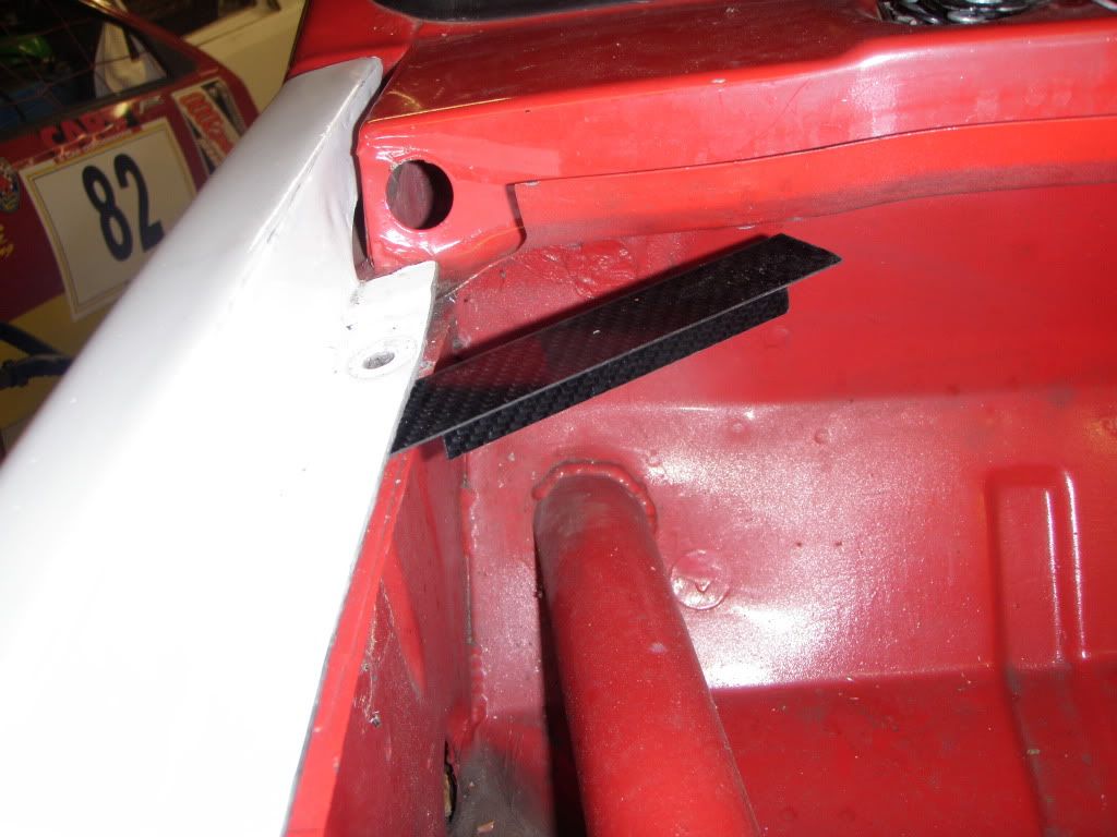

I'm re-making the rear bonnet pin mountings, just to save a few more grammes;
http://i285.photobucket.com/albums/l...ort/005-39.jpg
http://i285.photobucket.com/albums/l...ort/006-40.jpg
http://i285.photobucket.com/albums/l...ort/007-36.jpg

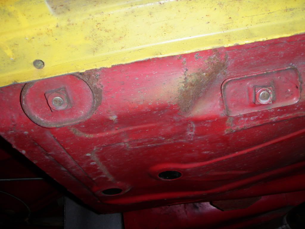

The current mountings for the harness eye bolts are very heavy duty;
http://i285.photobucket.com/albums/l...ort/008-33.jpg
I have plans to cut these strengthening plates out, and revise the mountings, saving weight but without compromising strength.

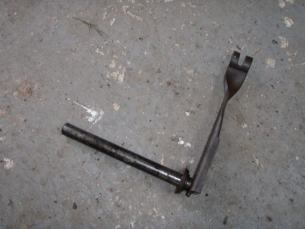

The clutch actuation lever looks a prime candidate for being made out of something lighter, either alloy or titanium;
http://i285.photobucket.com/albums/l...ort/017-32.jpg

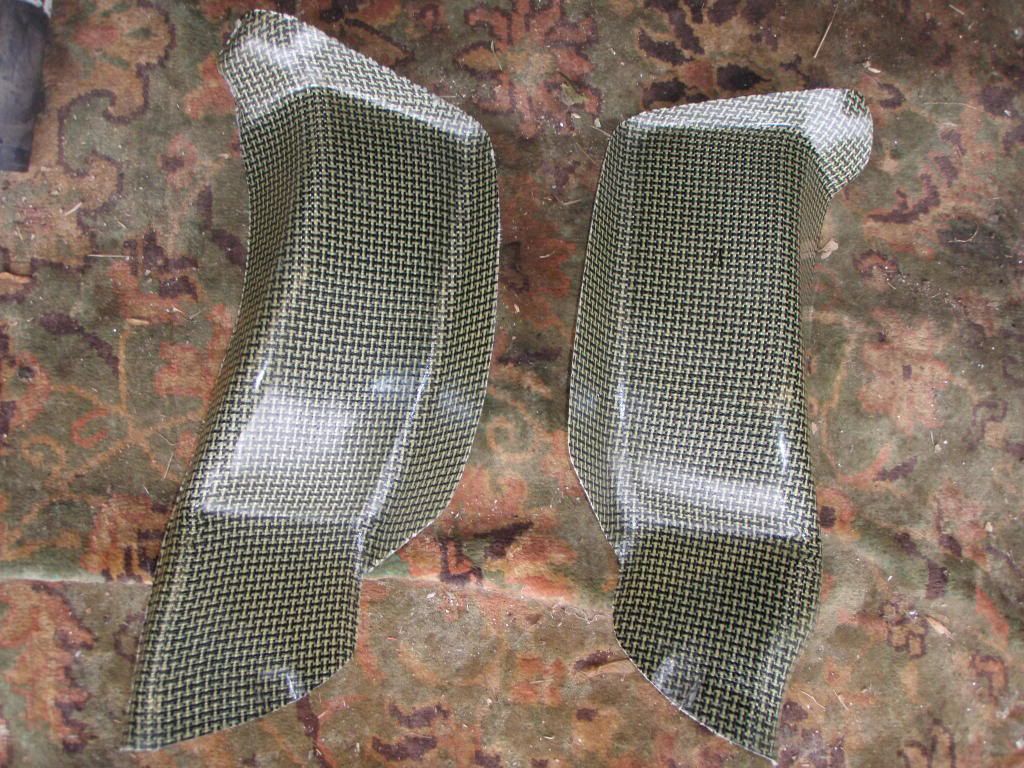

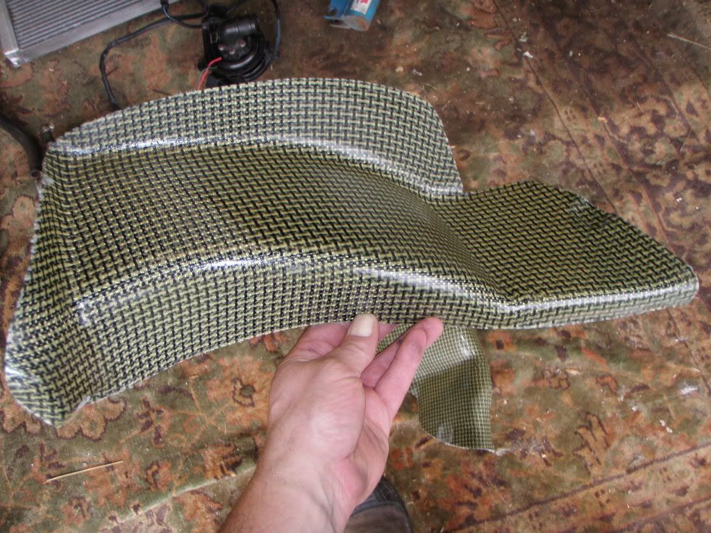

Also acquired these rather natty Kevlar inner arch liners from a Corsa B kit car, which I'm hoping can be made to fit the Nova;
http://i285.photobucket.com/albums/l...ort/021-18.jpg
http://i285.photobucket.com/albums/l...ort/022-15.jpg
Surely adding the harness bar will negate the weight saved on the harness?

colin, i reckon you might want to leave the gear lever alone.. the force put thru it will be quite big, even on a std clutch.
I think it would need to be done in titanium for that reason, but it's a heavy item, so cannot avoid my attentions. Also don't forget that on my car it's hydraulically activated, so it probably has less stress on it?
Force Racing (who are making my split rim wheels) have done a similar clutch lever in titanium for the Minis and had no issues with it.
