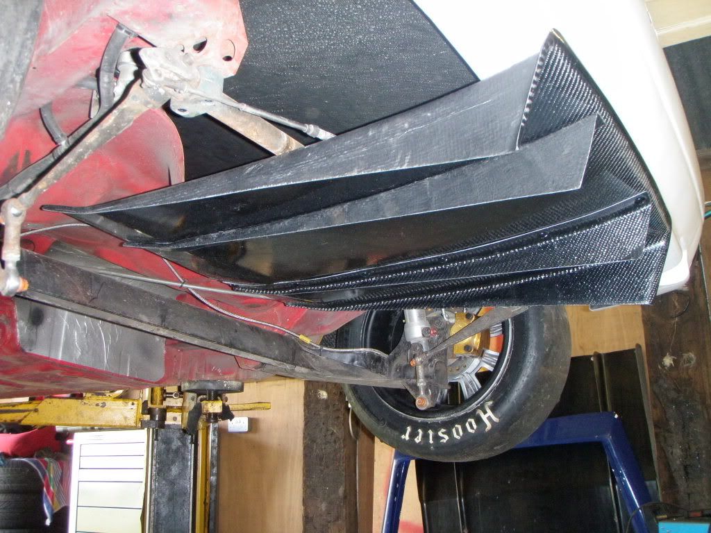

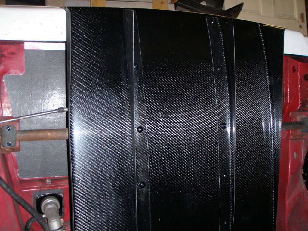

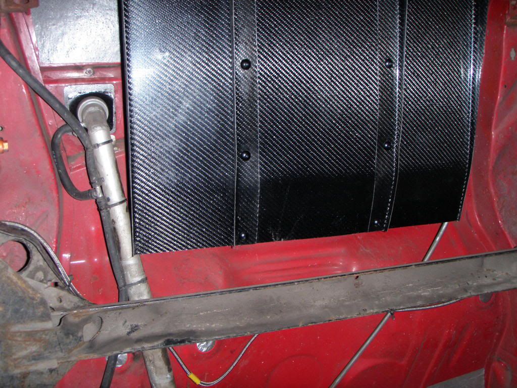

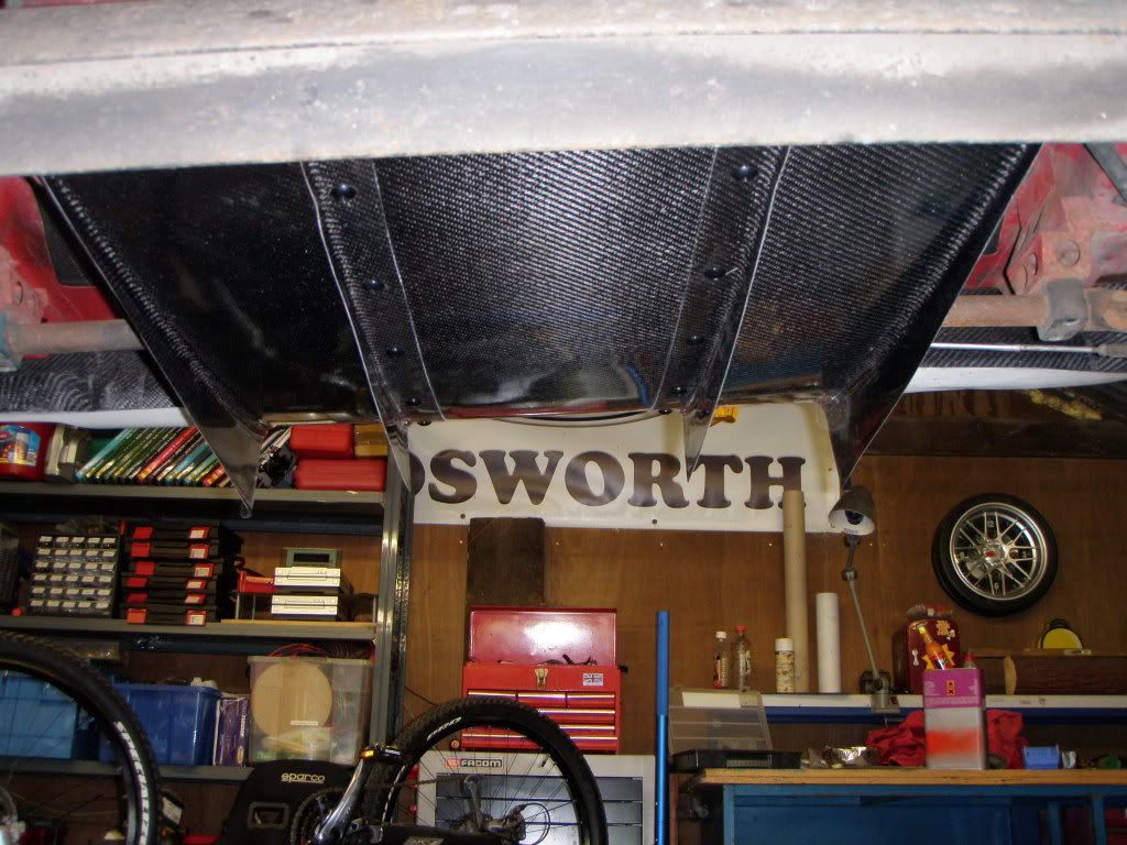

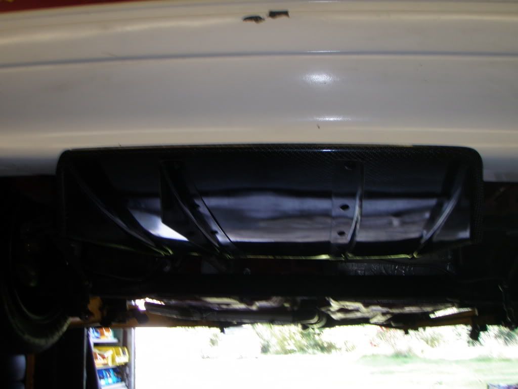

A few more photos of the diffuser, now fully installed;

looking good Colin, is that a varis universal diffuser ?
i have just emailed you about doors.
Might just be the angle but it looks like the front of it is pointed up? You want it flat, so it then curves away upwards. Besides that it looks rather sexy :d
You'd have to go a lot lower for a flat floor etc to be worth the weight imo, carbon diffuser is pretty light and easy to bolt up etc so fair enough, but to spend the time/money/weight on the whole hog you'd need to be able to get the best out of it (i.e be double figure mm off the floor rather than double figure cm.)
