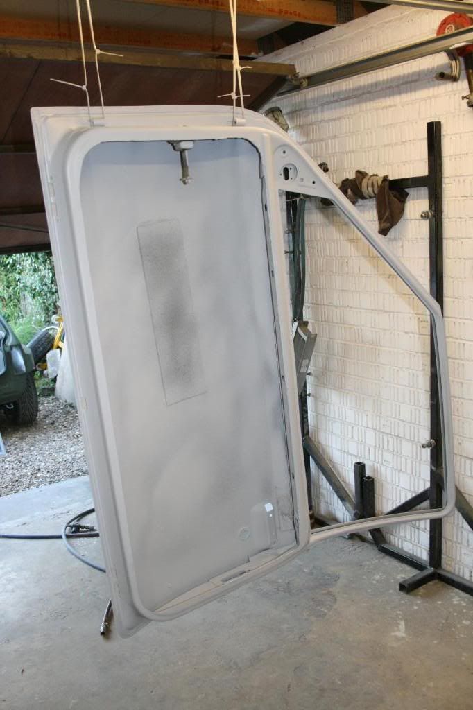

I got the drivers door all primed up
http://i248.photobucket.com/albums/g...painted070.jpg
http://i248.photobucket.com/albums/g...painted071.jpg

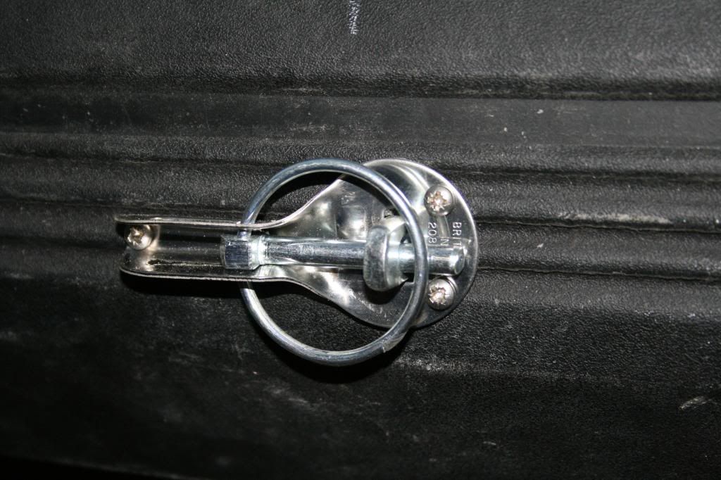

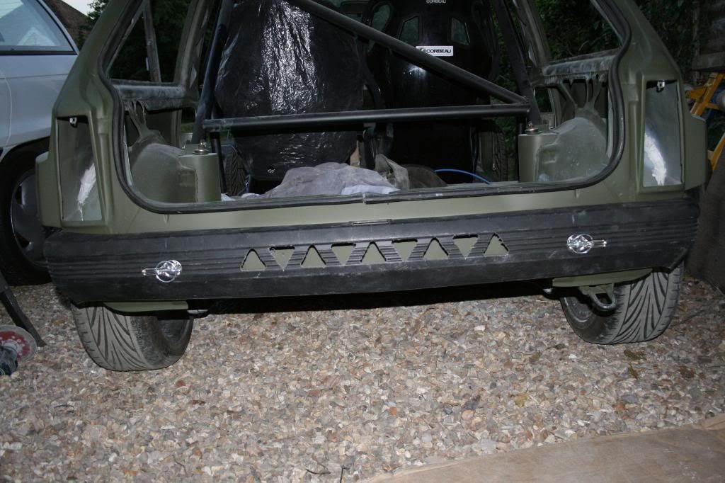

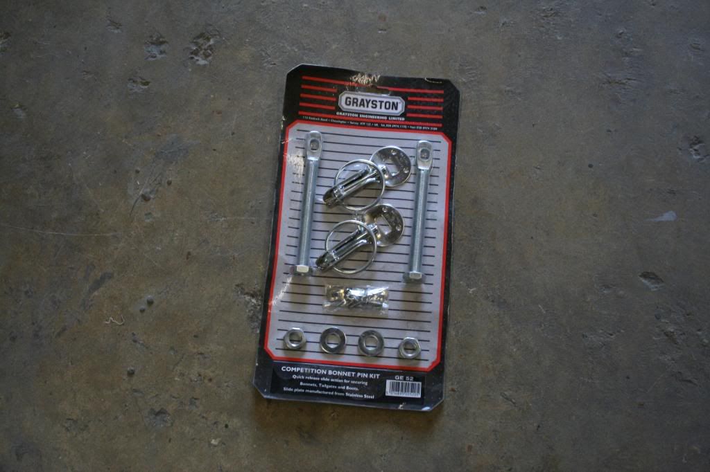

Then while that was drying i decided to try fitting the rear bumper with some bonnet pins before i paint it black
Bonnet pins
http://i248.photobucket.com/albums/g...painted073.jpg
This is the bumper iron up against the rear bumper showing how much i cut it down
http://i248.photobucket.com/albums/g...painted072.jpg
i whipped these out and cleaned them up a bit then fitted them to the car
http://i248.photobucket.com/albums/g...painted074.jpg

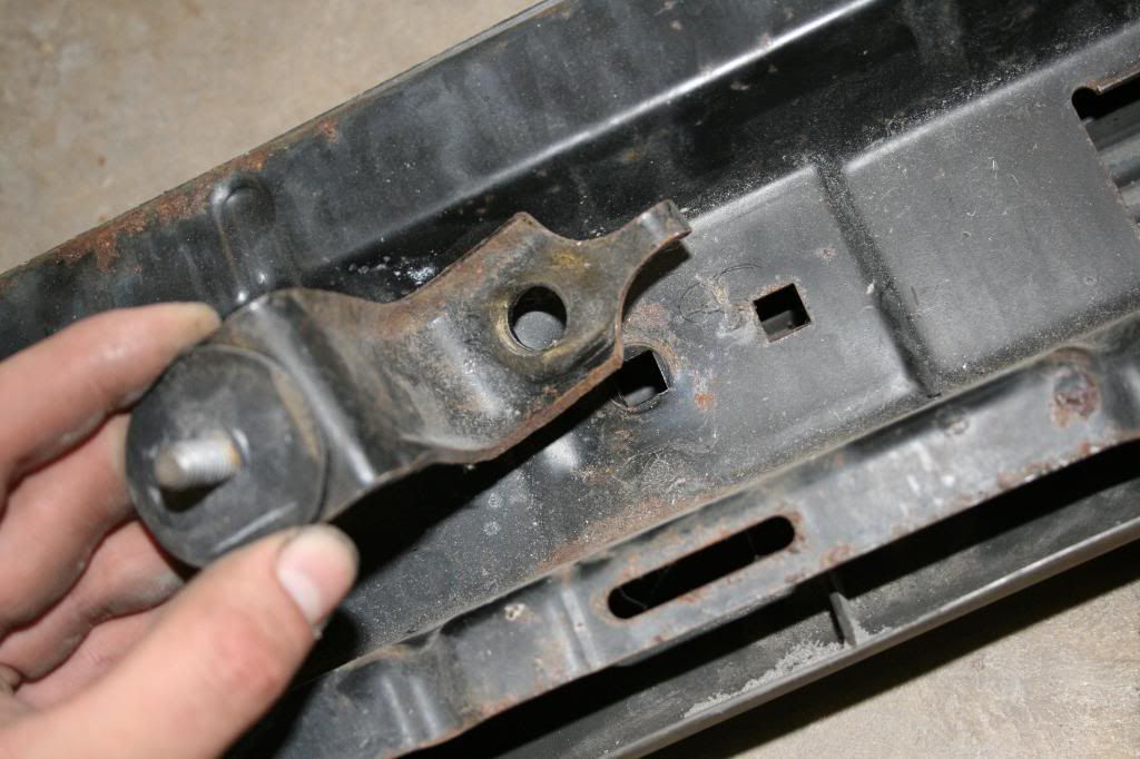

I removed this bracket from the bumper iron as i'm going to use it to mount the bonnet pins
http://i248.photobucket.com/albums/g...painted075.jpg

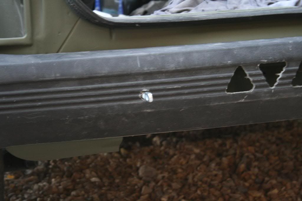

Then using the holes in the bumper iron that the brackets were mounted through i drilled the bumper
http://i248.photobucket.com/albums/g...painted077.jpg
Trial fitted
http://i248.photobucket.com/albums/g...painted080.jpg
http://i248.photobucket.com/albums/g...painted079.jpg
http://i248.photobucket.com/albums/g...painted081.jpg
http://i248.photobucket.com/albums/g...painted083.jpg

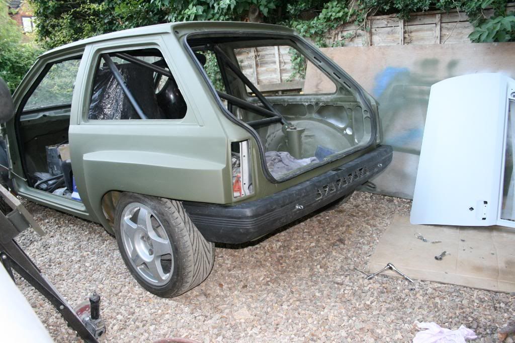

And complete
http://i248.photobucket.com/albums/g...painted085.jpg
http://i248.photobucket.com/albums/g...painted086.jpg
http://i248.photobucket.com/albums/g...painted087.jpg

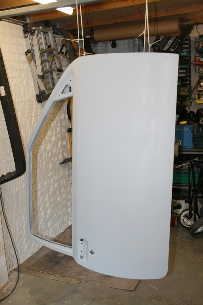

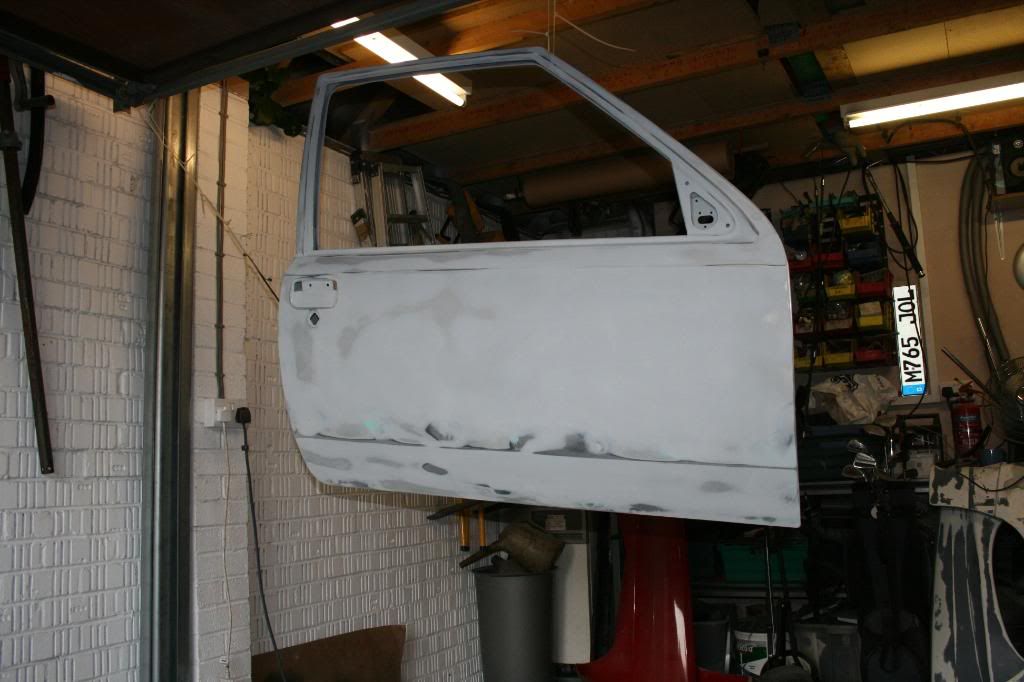

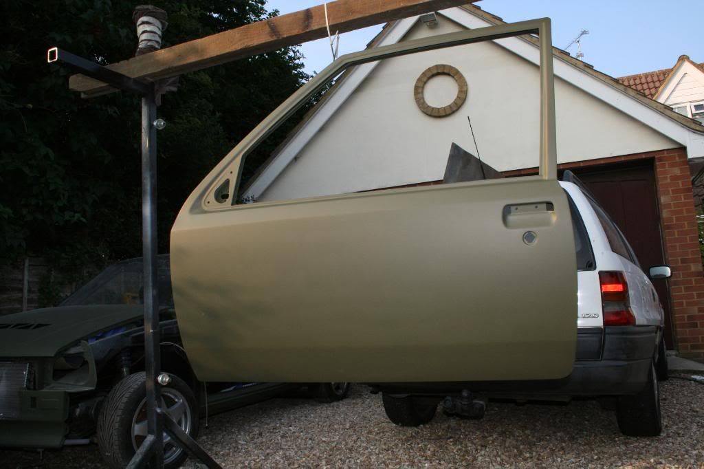

I then proceeded to rub down the high build primer on the N/S door
http://i248.photobucket.com/albums/g...painted090.jpg

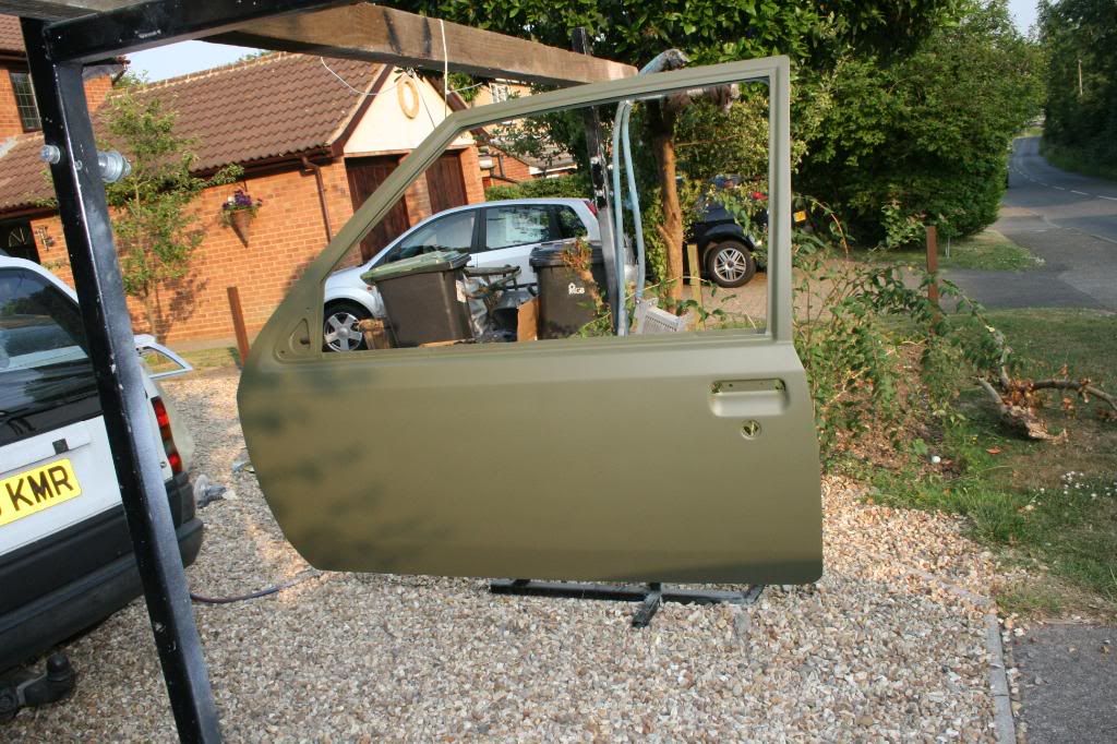

Wiped it all down and shot it in the green, then hung it out to dry
http://i248.photobucket.com/albums/g...painted091.jpg
http://i248.photobucket.com/albums/g...painted092.jpg

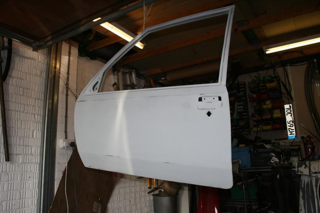

And moved on to the second door, all rubbed down and cleaned off ready to paint
http://i248.photobucket.com/albums/g...painted093.jpg
This was the point were disaster struck i w a n k e d the first coat on like a cu nt and it ran like forest gump (i think i mixed in a little too much thinners what a c ock) so that will need addressing tomorrow :mad:
T oss
http://i248.photobucket.com/albums/g...painted094.jpg

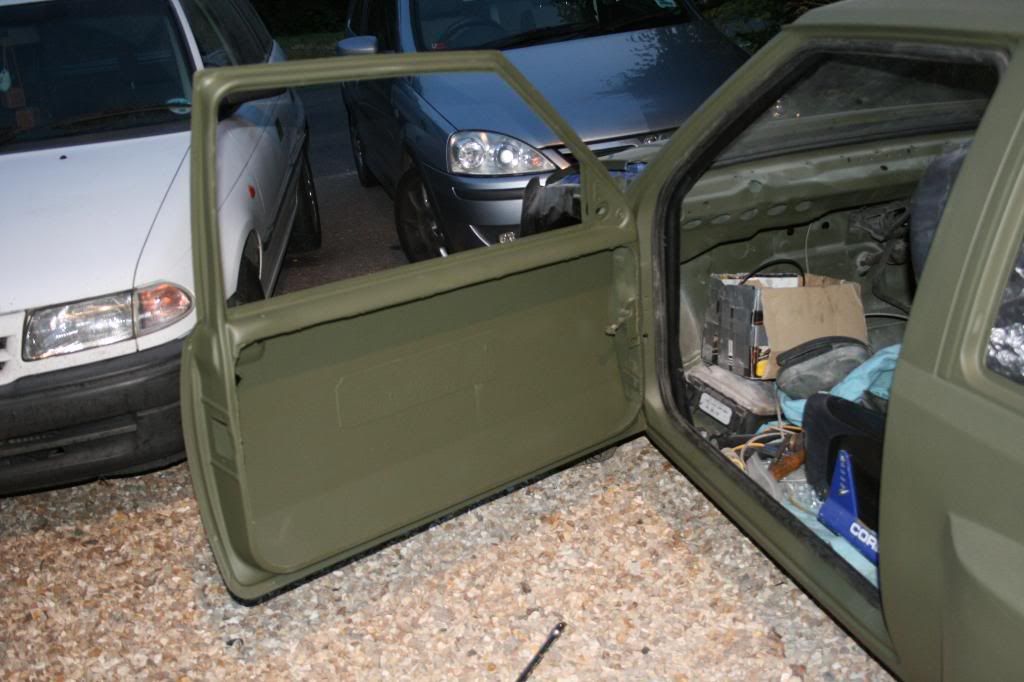

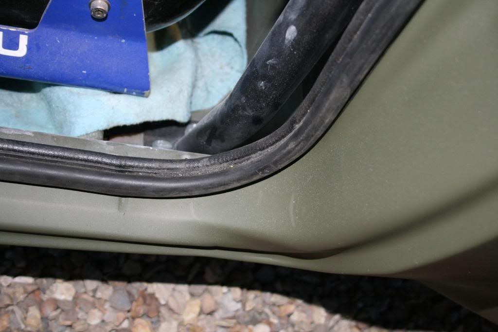

So given that the drivers door now didn't need another two coats as it was funked i decided to fit the passengers door rubber
http://i248.photobucket.com/albums/g...painted095.jpg
And refitted the door
http://i248.photobucket.com/albums/g...painted096.jpg
http://i248.photobucket.com/albums/g...painted097.jpg
It nearly looks like a nova again - woop woop
