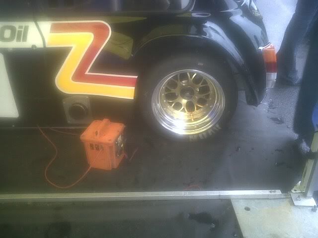

Not a great photo, but these are the wheels I am planning to order;
http://i285.photobucket.com/albums/l...untitled-4.jpg
I'm going up to see the chap who makes them next week, so he can take some measurements and start on machining.
If I sell all the other wheels I own I can just about afford a set!
Nice "Nova" tyres on them wheels! lol
