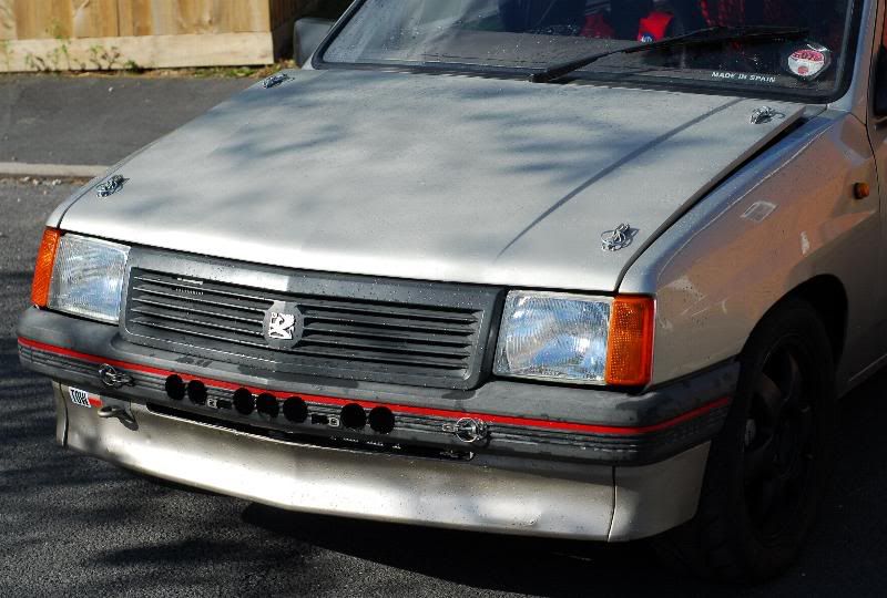

Colour match looks good on bonnet and boot, and the weight saving from removing hinges etc is definately worth having :) Keep up the good work! i should be at TOTB to cheer on the lightweight under-powered car :thumb:
Seeing as we were talking about your car...What actually is happening to the champagne supernova today? Will you run it single seat on the day?
Well worth taking the passenger seat and belts out. Looking good Olly.
Good work once again:thumb:

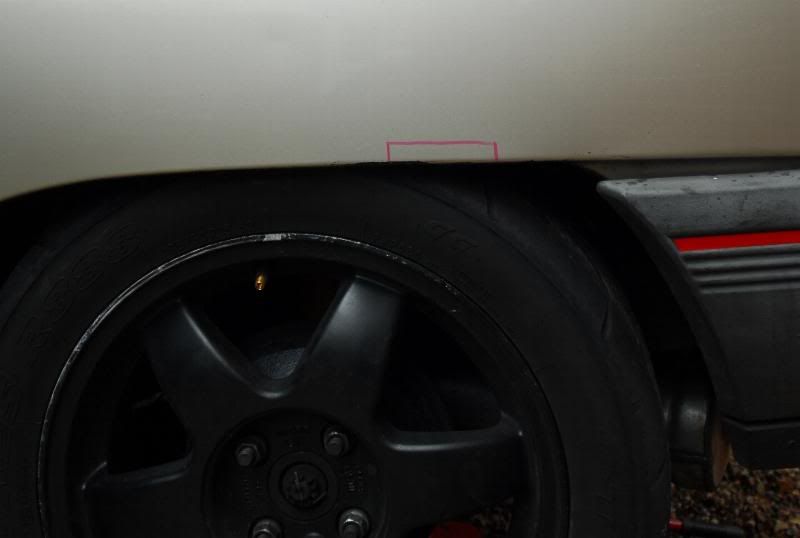

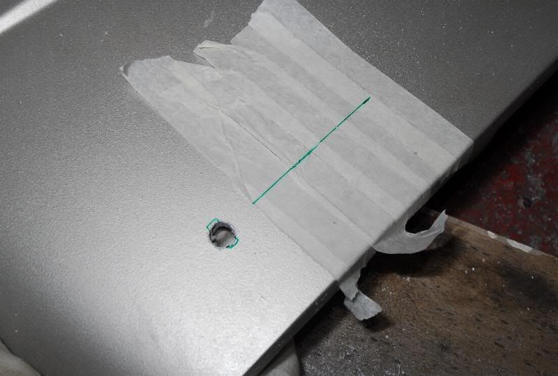

Jobs to be done were to fit cut out and rear quarter polycarbs, measure up and drill bonnet for the four pins, measure up and drill tailgate for pins, adjust hinges, set camber to -2°, set castor to +4°, bottle jack rear arches and space rear wheels out by 3mm, although these sound like small jobs, they're all time consuming and can't be rushed
Now for some pics, firstly to mark out the closest part of the rear arch to the wheel, which set circa 3mm from the tyrewall
http://i136.photobucket.com/albums/q...ure/nc0951.jpg

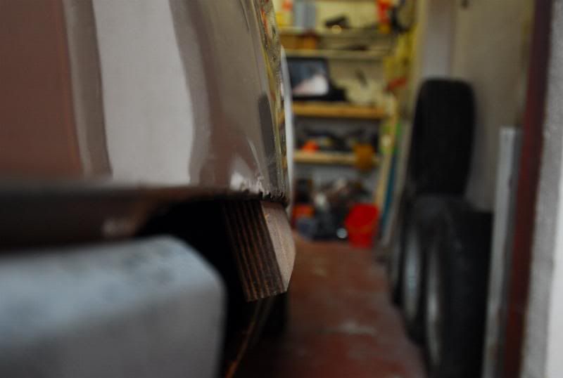

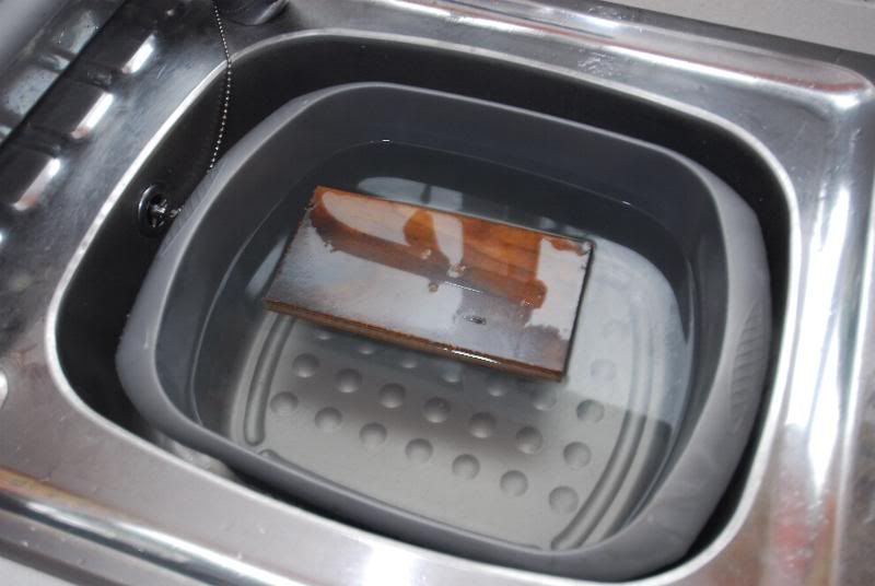

Soak plywood in boiling water, until all bubbles disperse from wood, so its full soaked up
http://i136.photobucket.com/albums/q...ure/nc0952.jpg
Get thick alloy, or steel to brace across the car so it's not pressing against shock absorber, put bottle jack horizontally, then plywood against arch and gentle jack out
http://i136.photobucket.com/albums/q...ure/nc0953.jpg

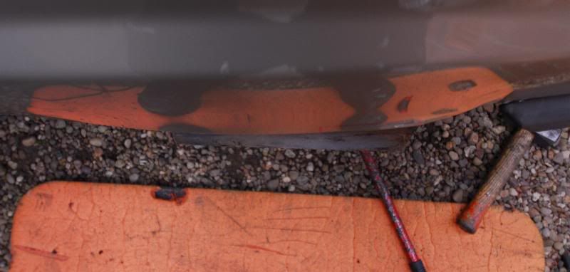

Start to see the gains, use heat gun to heat the paint and metal so they flex instead of crack, then leave for both to go cold whilst arch is in final position
http://i136.photobucket.com/albums/q...ure/nc0954.jpg

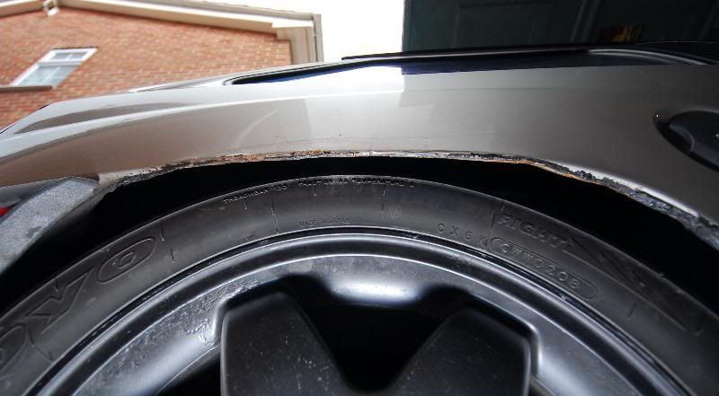

Relax jack, and admire lots of clearence, a damn site easier, nicer than I expected it to be, this clearence is with a 3mm spacer fitted, which didn't fit at all prior to this, I can now run fingers all the way down the tyre wall, without touching the arch
http://i136.photobucket.com/albums/q...ure/nc0955.jpg

Whilst I was doing the above, Ian was measuring up for the pin fitting, must say - his attention to detail is amazing, much more effort than I would have gone to!

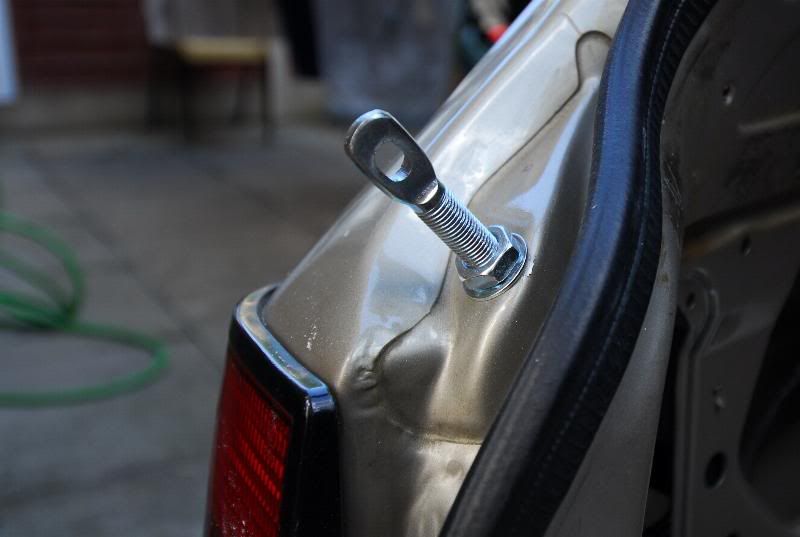

http://i136.photobucket.com/albums/q...ure/nc0957.jpg
Hole drilled, then he offered up the pin upside down to see where they needed filing too
http://i136.photobucket.com/albums/q...ure/nc0958.jpg

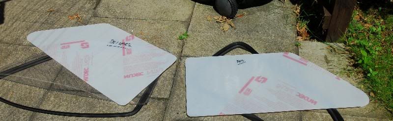

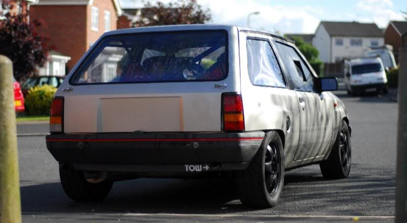

Then cut the new rear quarter windows out, each 3mm item weighed 0.8kg (1.6kg pair), and each new 2mm item weighed 0.5kg (1kg pair), so another 0.5kg saving
http://i136.photobucket.com/albums/q...ure/nc0964.jpg

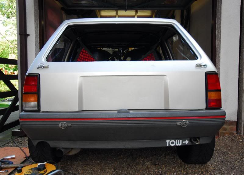

On with the tailgate, alot of fiddling with the top hinges to get the panel gaps right, which we got in the end, then fitted the bottom pins the same position as Lee
http://i136.photobucket.com/albums/q...ure/nc0960.jpg
Panel gaps look spot on for a fibreglass panel
http://i136.photobucket.com/albums/q...ure/nc0961.jpg

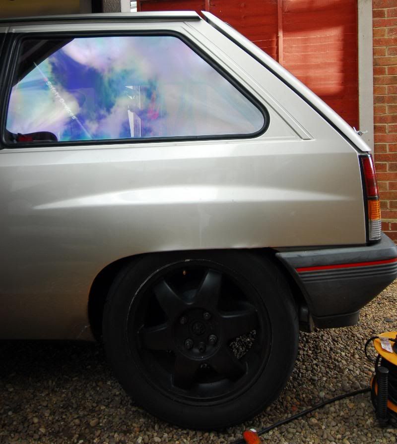

Then side gaps fine, and new rear polycarb with no stickers
http://i136.photobucket.com/albums/q...ure/nc0962.jpg

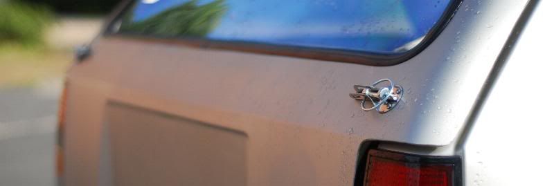

Used alloy tabs at the rear of the bay to mount the back pins
http://i136.photobucket.com/albums/q...ure/nc0965.jpg

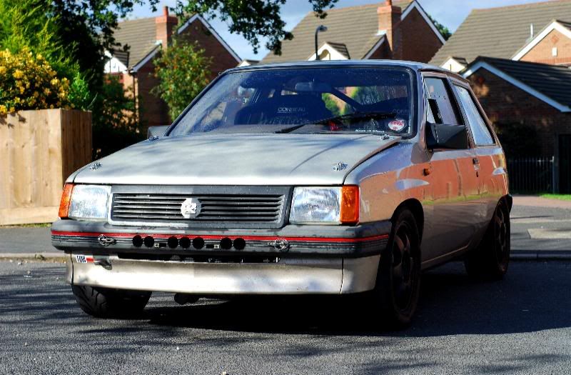

Final outcome, and new stickerless look
http://i136.photobucket.com/albums/q...ure/nc0966.jpg
http://i136.photobucket.com/albums/q...ure/nc0967.jpg
