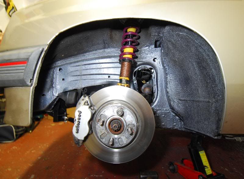

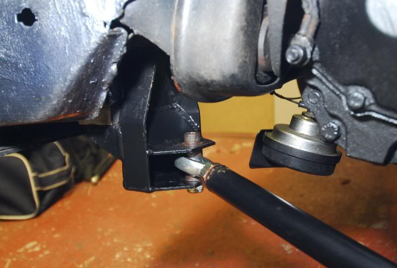

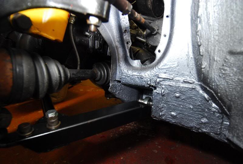

First off, just a couple of piccies of the bottom arms fitted, and setup. I now have the full 4° positive castor which is what the groupA Nova tarmac rally cars ran, so I'm mega happy with that, and the fact they clear the front valance/ wings is even better - albeit by only about 4mm, but it clears
http://i136.photobucket.com/albums/q...ure/nc0938.jpg
http://i136.photobucket.com/albums/q...ure/nc0939.jpg
This emphasises just how much castor we have managed to gain with the new rosejointed setup
http://i136.photobucket.com/albums/q...ure/nc0940.jpg

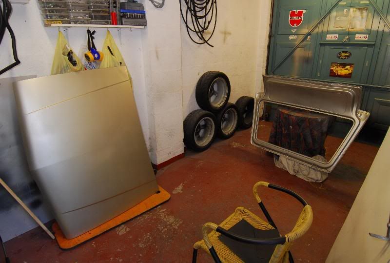

Next up - welcome to our spraybooth lol
http://i136.photobucket.com/albums/q...ure/nc0941.jpg

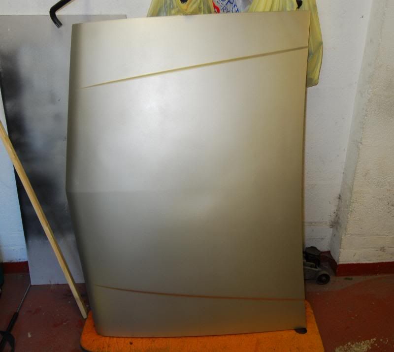

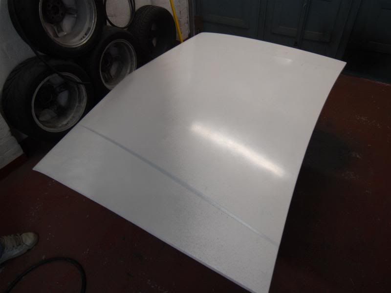

Bonnet semi-primered
http://i136.photobucket.com/albums/q...ure/nc0942.jpg

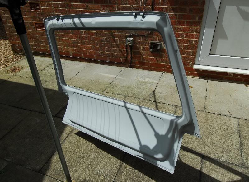

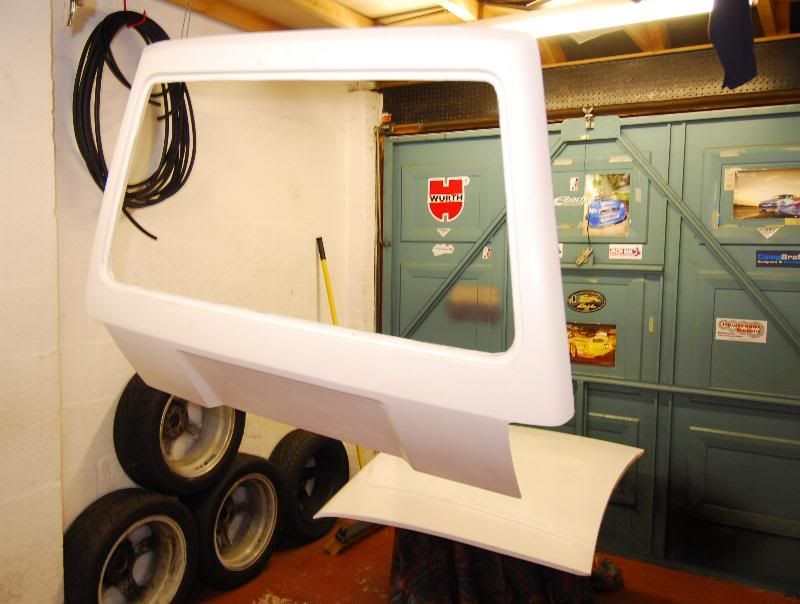

Tailgate drying in the sun whilst hanging off the washing line
http://i136.photobucket.com/albums/q...ure/nc0943.jpg

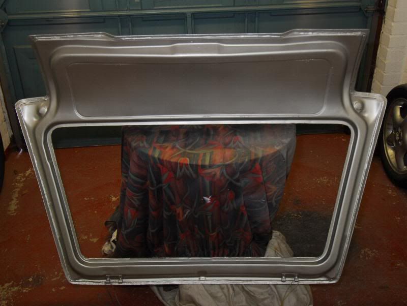

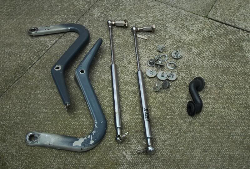

Again, negliable but more weight saving done
http://i136.photobucket.com/albums/q...ure/nc0944.jpg

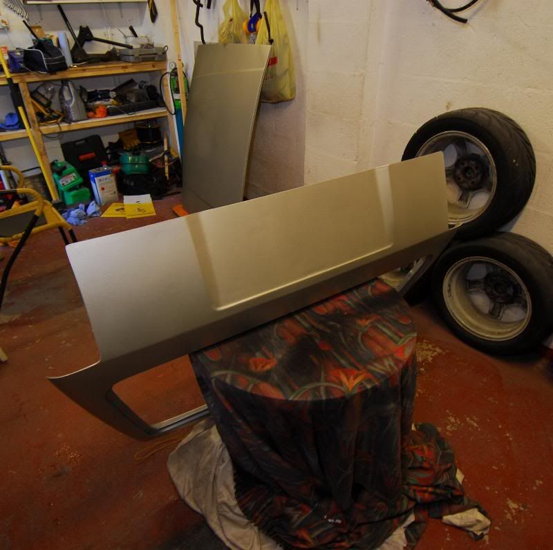

All primered, sprayed up in colour, flatted down, and laquered (yes, slight postage dent in bonnet... grrr), thanks to Ians persistance with the laquering
http://i136.photobucket.com/albums/q...ure/nc0945.jpg
http://i136.photobucket.com/albums/q...ure/nc0946.jpg
Tailgate
http://i136.photobucket.com/albums/q...ure/nc0947.jpg
http://i136.photobucket.com/albums/q...ure/nc0948.jpg

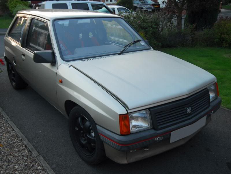

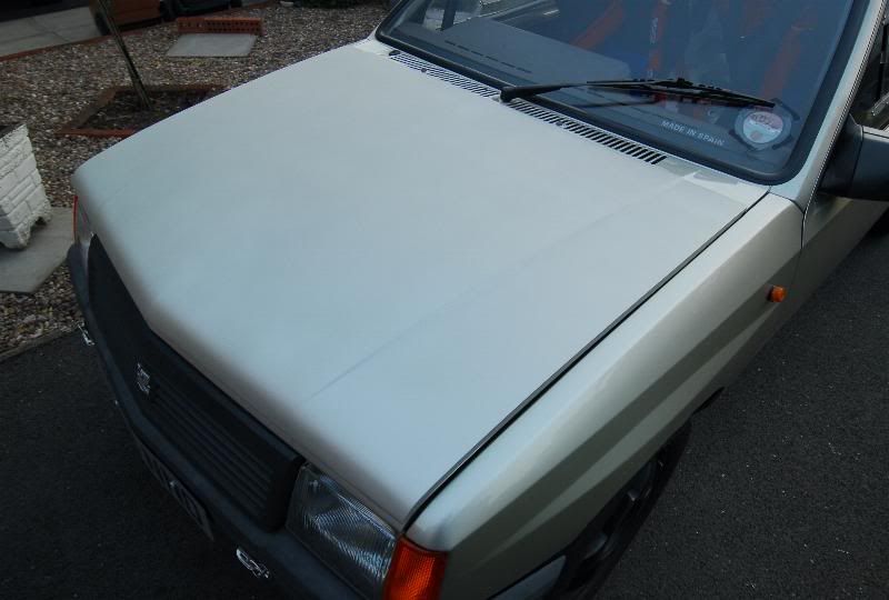

Bonnet just resting on the car to see the colour match, was quite pleased with how it came out
http://i136.photobucket.com/albums/q...ure/nc0949.jpg
http://i136.photobucket.com/albums/q...ure/nc0950.jpg

Who needs a heated oven boothe when youve got a washing line :cool: lol

Colour match looks well too :)
Paint job looks not too bad :)
When will the weight saving actually stop lol
Is there anything else that can be stripped out ?
Yeah, I'm pleased with it, would have liked the finished product a little shinier though, should I be honest, but it's good enough for TOTB, and the car, as a track weapon!
Oh - notice I'm at the top of my threads on my coilovers like I was explaining to you... coppergrease on the lower threads btw lol not rust :)
Yup, just noticed now, wound right the way up.
