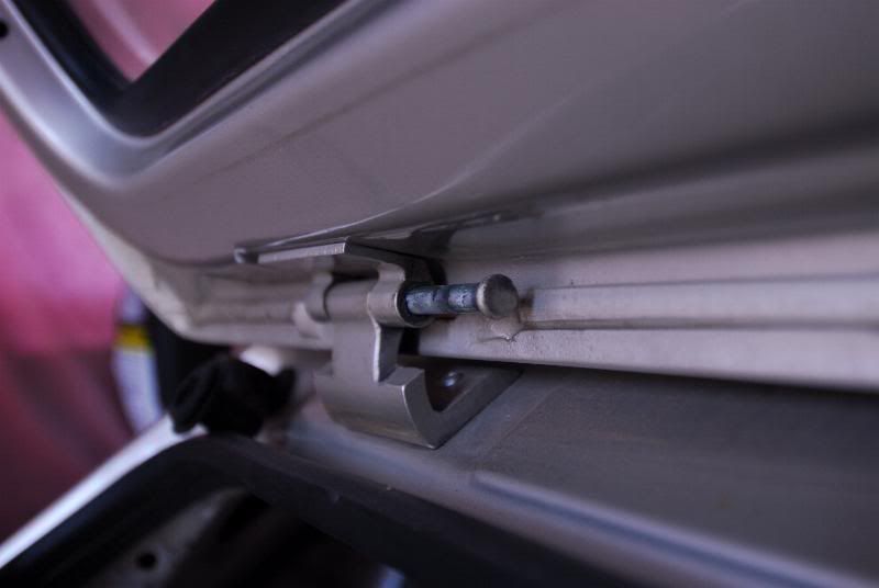

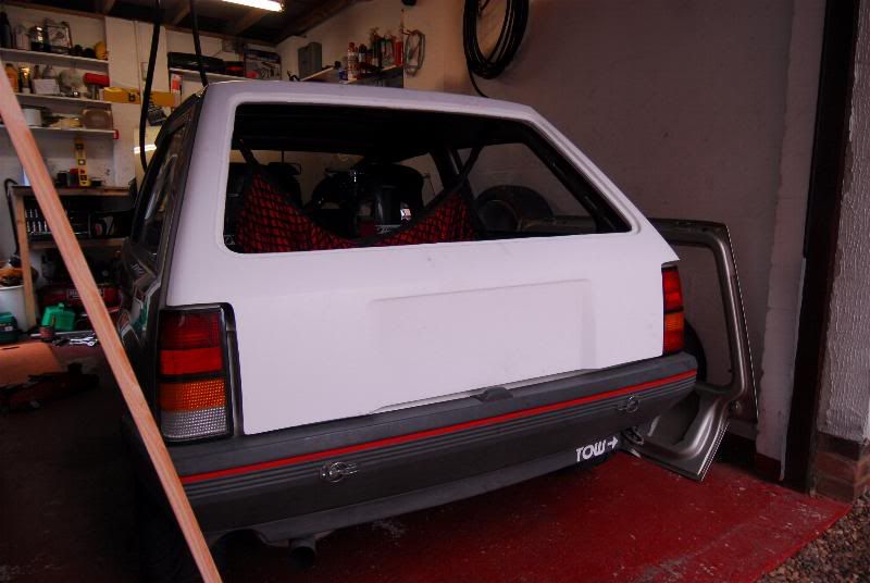

Out with the pins, came out very easy

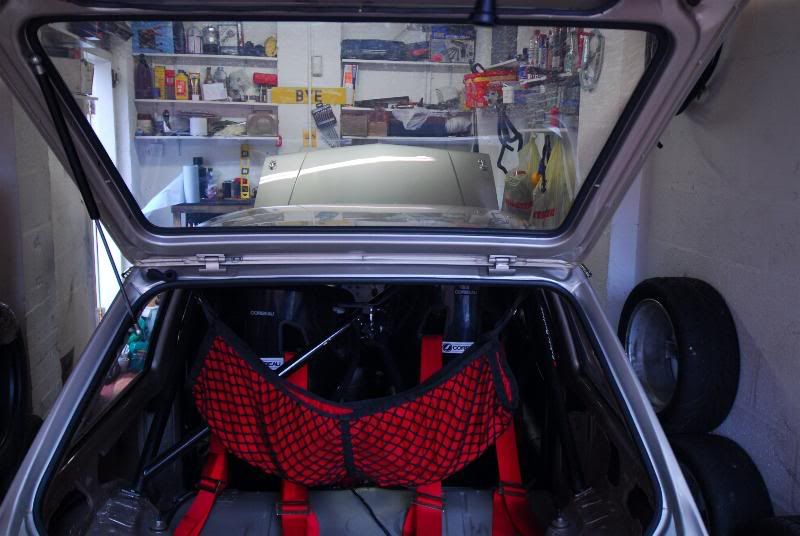

One metal standard but lightened tailgate with 3mm polycarb

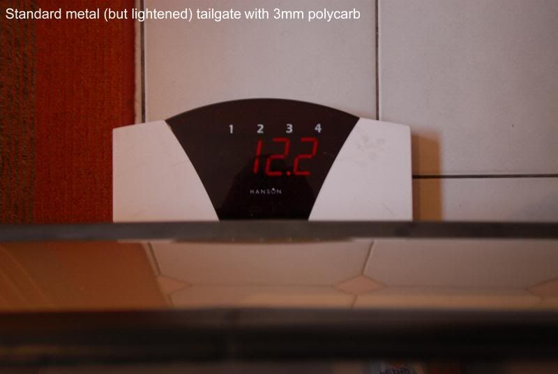

http://i136.photobucket.com/albums/q...ure/nc0931.jpg
12.2kg, yiiiiiiikes

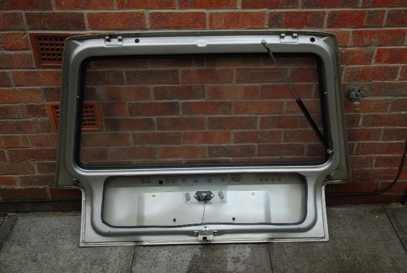

Offered up FG item, played about with the hinges
http://i136.photobucket.com/albums/q...ure/nc0933.jpg

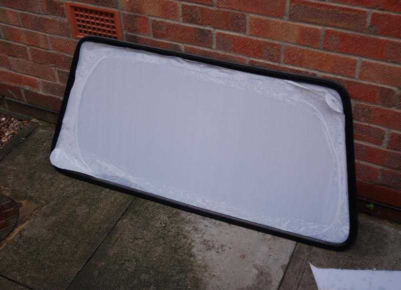

2mm polycarb cut to shape and weighed alone, 1.2kg, old 3mm item weighed 1.7kg - so 0.5kg/ half a kilo saved on changing from 3-2mm alone

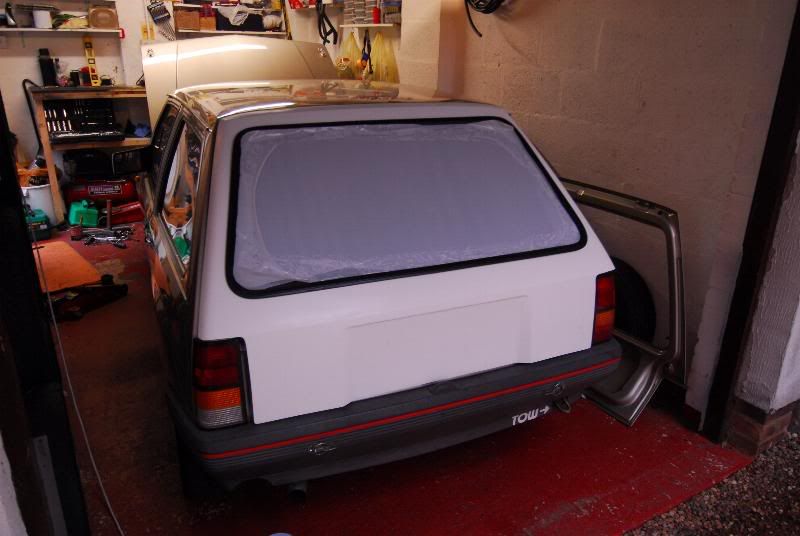

Rubber put on, getting a dab hand at that now lol
http://i136.photobucket.com/albums/q...ure/nc0934.jpg
Laid ontop for now, as tailgate is being sprayed tomorrow
http://i136.photobucket.com/albums/q...ure/nc0935.jpg

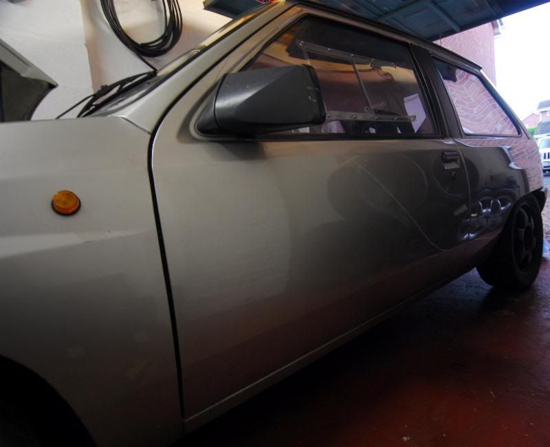

Removed door squares and names on windows, smooothie
http://i136.photobucket.com/albums/q...ure/nc0936.jpg

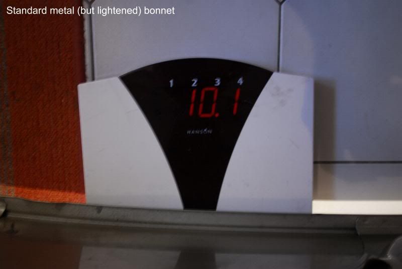

Whipped off my standard metal, but lightened bonnet, 10.1kg
http://i136.photobucket.com/albums/q...ure/nc0937.jpg

My tailgate, complete was 12.2kg, my new tailgate is 4kg, plus the 1.2kg for the new 2mm poly carb, so now a complete new tailgate is 5.2kg, so thats a 7kg saving.
New weight: 760kg
My bonnet as it was fitted was 10.1kg, and my new one being 5.3kg, being a 4.8kg loss.
New weight: 755kg (for now)
