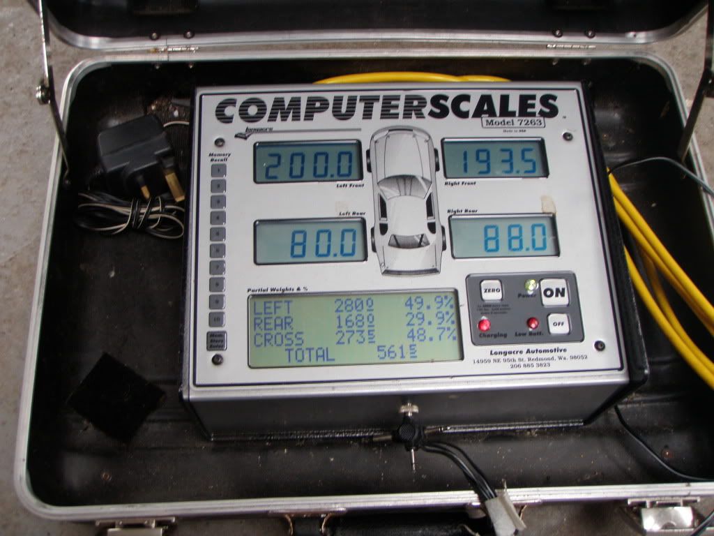

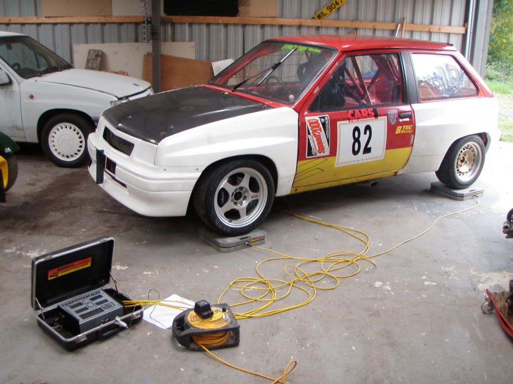

Just getting the car ready to go off for another hillclimb at the weekend, and with the new wheels now fitted, I thought it high time it went back on the corner weight scales to see where we are with it...........
http://i285.photobucket.com/albums/l...ort/016-27.jpg
http://i285.photobucket.com/albums/l...ort/017-29.jpg
And the results........
http://i285.photobucket.com/albums/l...ort/018-26.jpg
562kg (or 561.5kg if you want to be pedantic).
That's with a full tank of fuel, and all fluids on board, so ready to race (without the driver, obviously!!).
I'm pleased enough with that, and it means I'm still on target for close to 550kg with the next phase of weight saving tweaks.

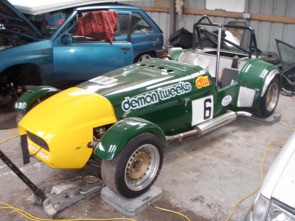

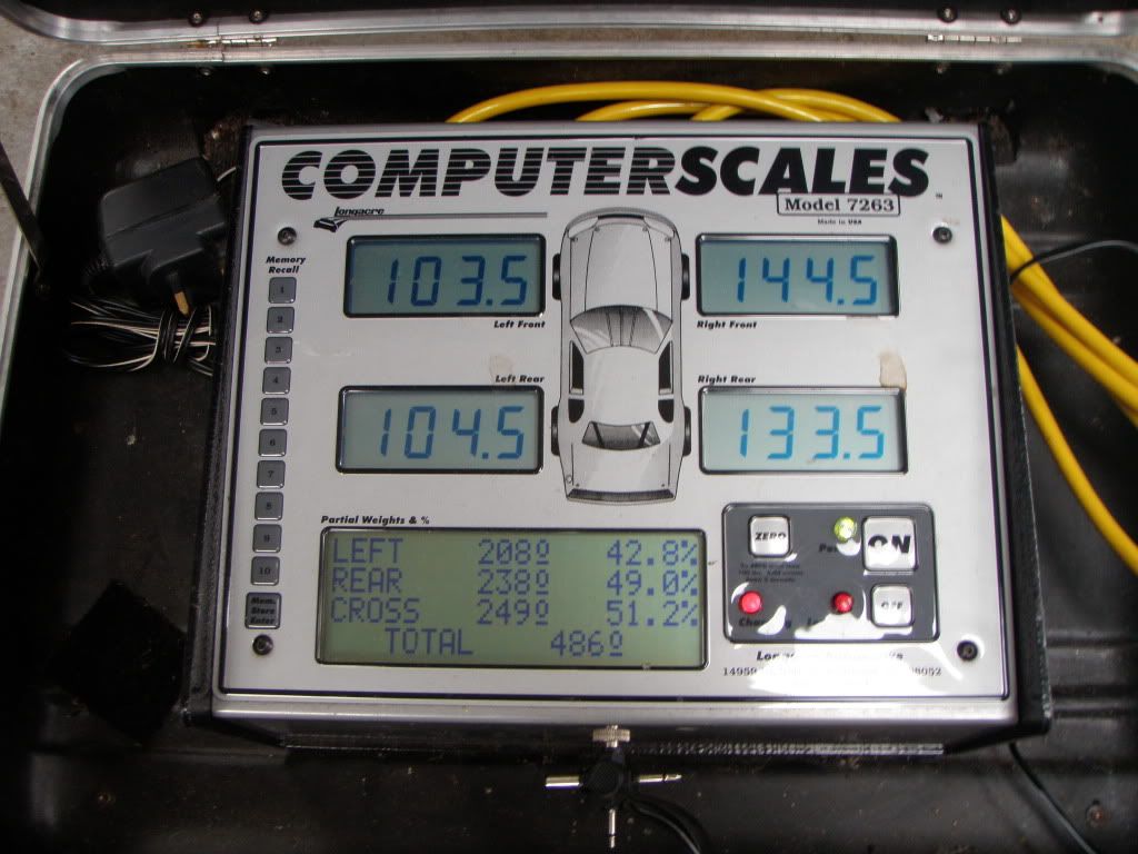

As a useful comparison, and whilst I still have it, I put my Westfield on the scales as well;
http://i285.photobucket.com/albums/l...ort/019-23.jpg
http://i285.photobucket.com/albums/l...ort/020-19.jpg
Not bad at all at 486kg, although whoever built it has paid scant regard to weight saving, so there would be loads to come out of that figure if I was keeping it.
Cool that the Nova has much better matching weight distribution between the wheels than the Westfield. I'd never have thought looking at the car that theres 41 kilos difference between the two front wheels! Any ideas what the cage in the Nova weighs? And are you going to give any clues on whats going to make the next 10 kilos of savings? :)
Indeed, the Westfield needs some proper setting up, it's a worry that people race cars that are so far out. The Nova was actually slightly better than this (within 1kg) before I changed the springs, so I can get that a bit better as well.

plus when a driver gets in the westfield there is even more weight on that side,

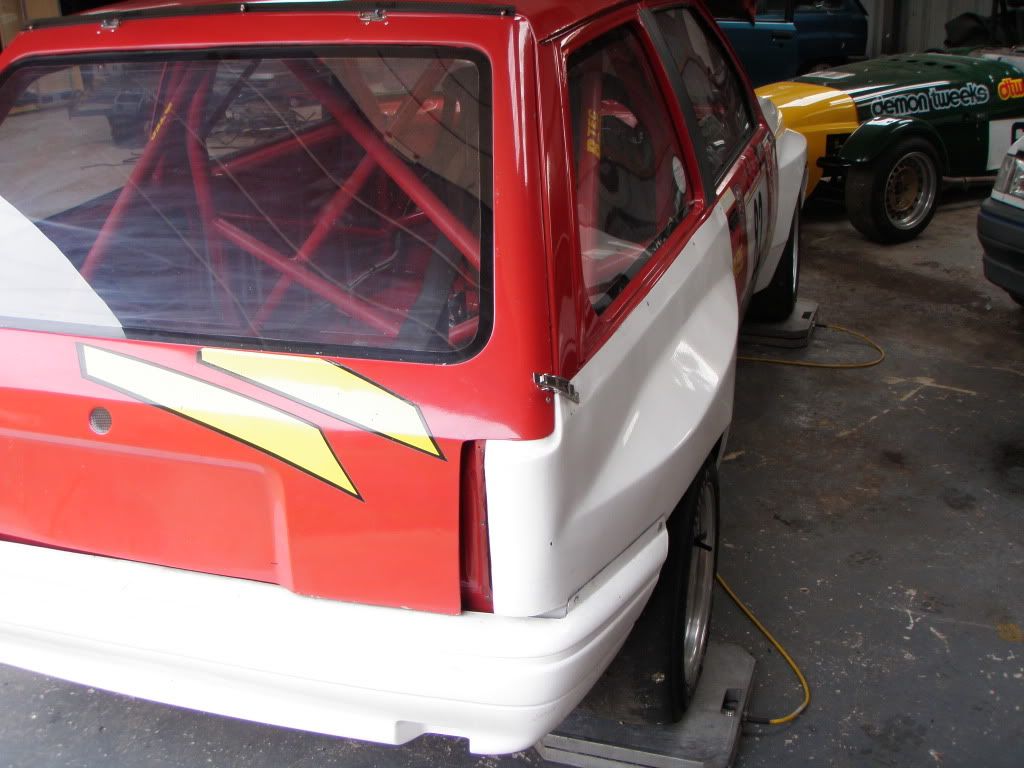

http://i285.photobucket.com/albums/l...cort/030-8.jpg
Is that an oil catch tank/breather in the passenger arch? and is it still there? perhaps a weight saving to be made if it is, you can get little light weight motorbike ones.
Well surprised about the difference in weight distribution on the Westfield, and love the nova's new mk2 front end, quite like the white look to.. new color maybe?
