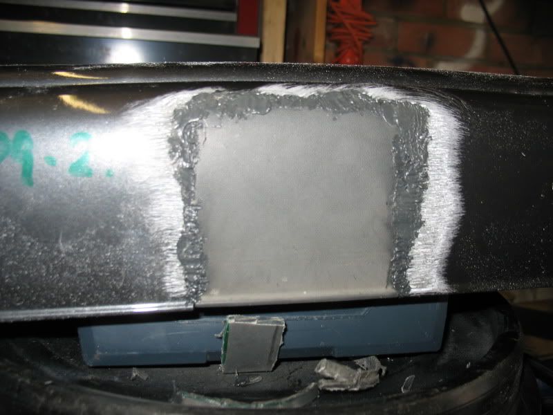

Here's 1 reason i've got the engine out, this was a temp cover, that due to time i had to have on longer than i wanted.
http://img.photobucket.com/albums/v3...psfhpiyrht.jpg
Under it, plus the old brake line hole and T piece bolt hole. That can all go...
http://img.photobucket.com/albums/v3...ps6kpauk7c.jpg
http://img.photobucket.com/albums/v3...psesideki5.jpg

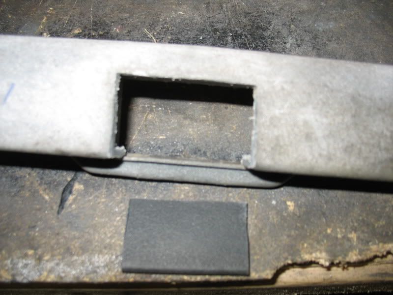

Marked up the cover, so i could make a plate up...
http://img.photobucket.com/albums/v3...psjadwiunl.jpg
Copy that on to metal, i wanted to fill the hole flush, for easy and better finish.
http://img.photobucket.com/albums/v3...psiph9ykmf.jpg
Then to this..
http://img.photobucket.com/albums/v3...psn8jp0hh1.jpg
Then this, backing plate, with hole plated welded on, ready to flush the front off...
http://img.photobucket.com/albums/v3...psah1zwbmh.jpg
Back.
http://img.photobucket.com/albums/v3...psko4pfuuj.jpg
Welded in.
http://img.photobucket.com/albums/v3...psicx9s19m.jpg

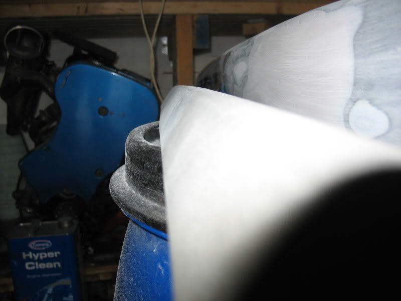

Due to not being able to get my grinder in there i've not done the brake line hole. Waiting the new bits for my belt sanding then i can get in there and get that done too.
Ground off and sanded back to flush.
http://img.photobucket.com/albums/v3...psndtnhldd.jpg
Light skim of black fiber glass.
http://img.photobucket.com/albums/v3...pspqgumiv0.jpg
That's it for now... More soon.

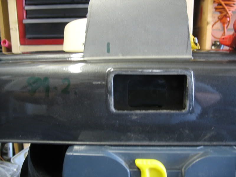

Fiber glass sanded off, gave the holes next to it a gentle tap to recess then in so plates could be welded in. As one of them i can't get to the other side...
http://img.photobucket.com/albums/v3...pslcaonx1l.jpg
Holes welded up.
http://img.photobucket.com/albums/v3...psdczjpgol.jpg

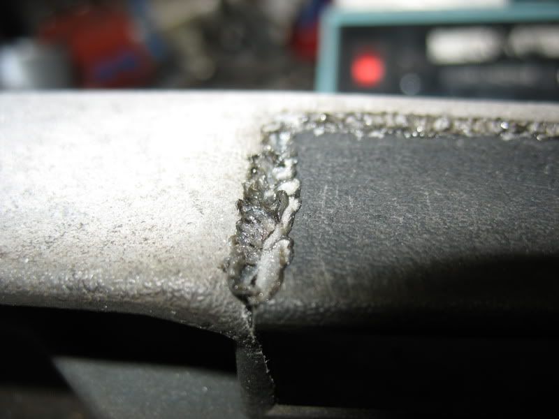

Started welding the small holes in the steering arm hole up.... As they are very untidy.
http://img.photobucket.com/albums/v3...ps1mcqq2df.jpg
Bit of sanding left me.... haha
http://img.photobucket.com/albums/v3...pswu9axkja.jpg
