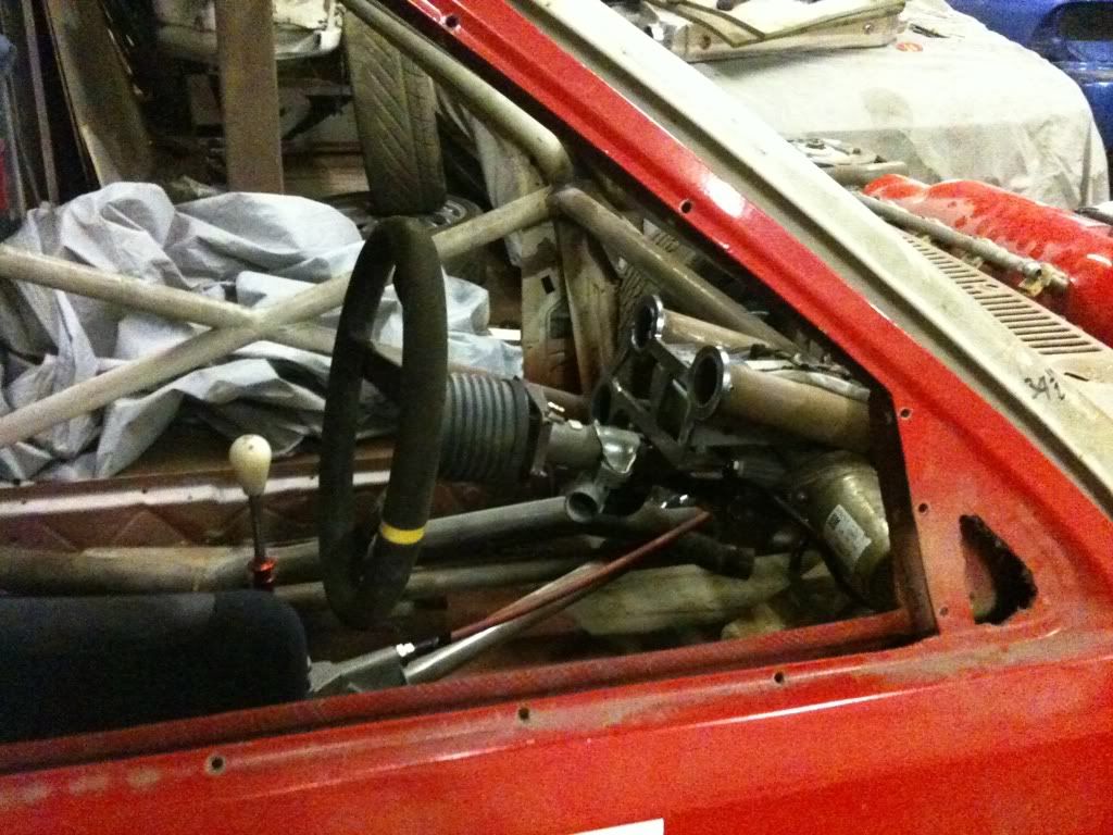

Not really got many photos. Floors been cut out, tie bars are fixed in. Floor plates been made for the ap floor mounted pedals. Brackets been made for steering column. Brackets been laser cut for dry sump tank.

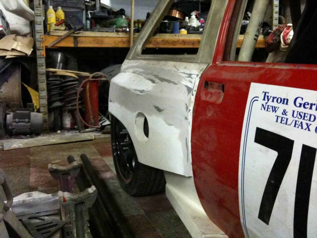

Tonys made a start on making the arches ready to take moulds off. These have to be taken up a few inch and widened trying to keep some of the lines.

Those arches are somethine else :cool: :) :) :)

What's going to be done with the front arches to cover the rubber?

Another pic of the arch in progress. This is from tonys photobucket accont.

As for the arches they will be taken out to the same width as the rears and up to follow the lines. Hes making the front end one piece, wings, bonnet and bumper.
I need to get hold of some slicks though to make sure they fit in the arches.

with the arches been extra extra wide will you be doing them so they still come back in at the ends or will you just vent the difference at the doors and rear or car ?
They will be taken back in. One of the photos shows the rear coming back to meet the rear of the car. They have had to have a few inch taken out the midle due to it being so low. Moulds will then be taken and them laid up in carbon.
