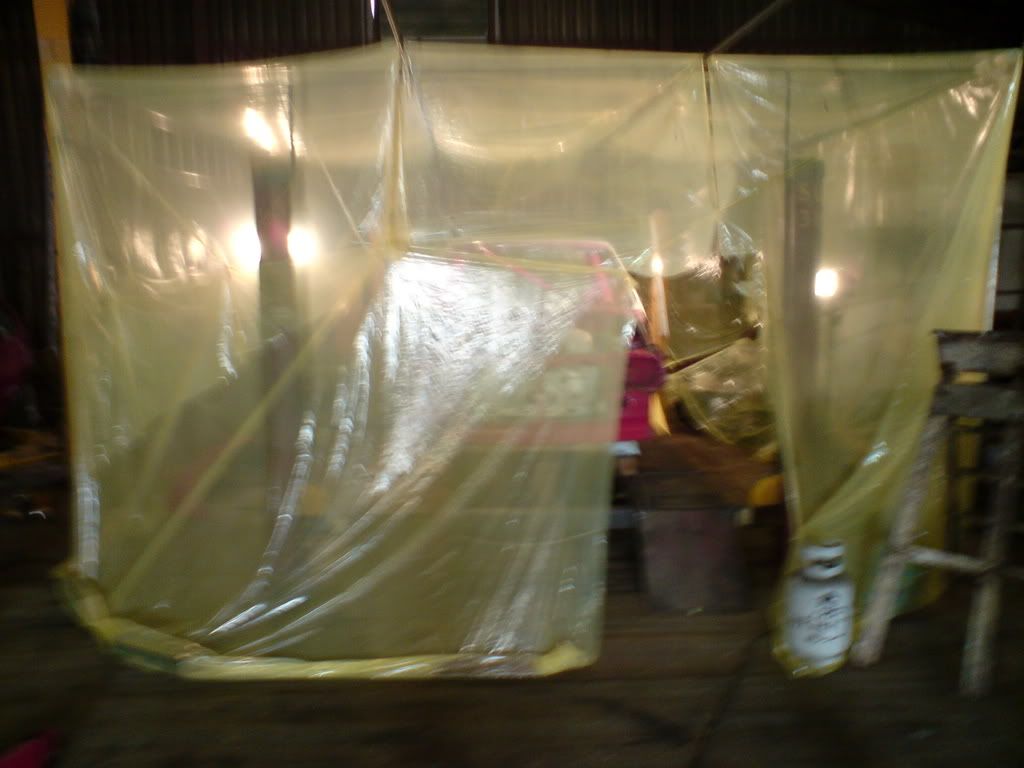

having completed all welding it was time to clean up, make a spray booth and prep for painting
http://i205.photobucket.com/albums/b...ay3rd08006.jpg
I bought some decent lights since good light is about the most important thing when painting.

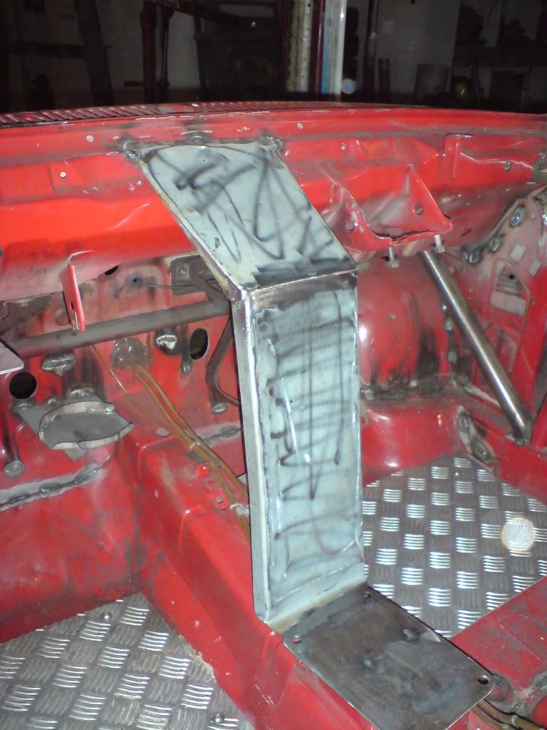

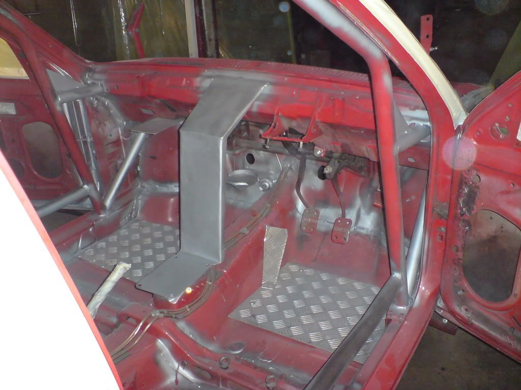

I finished off some stuff inside the cabin namely a centre "console" that can be reached by the short **** who also drives the carlol
http://i205.photobucket.com/albums/b...ay3rd08005.jpg

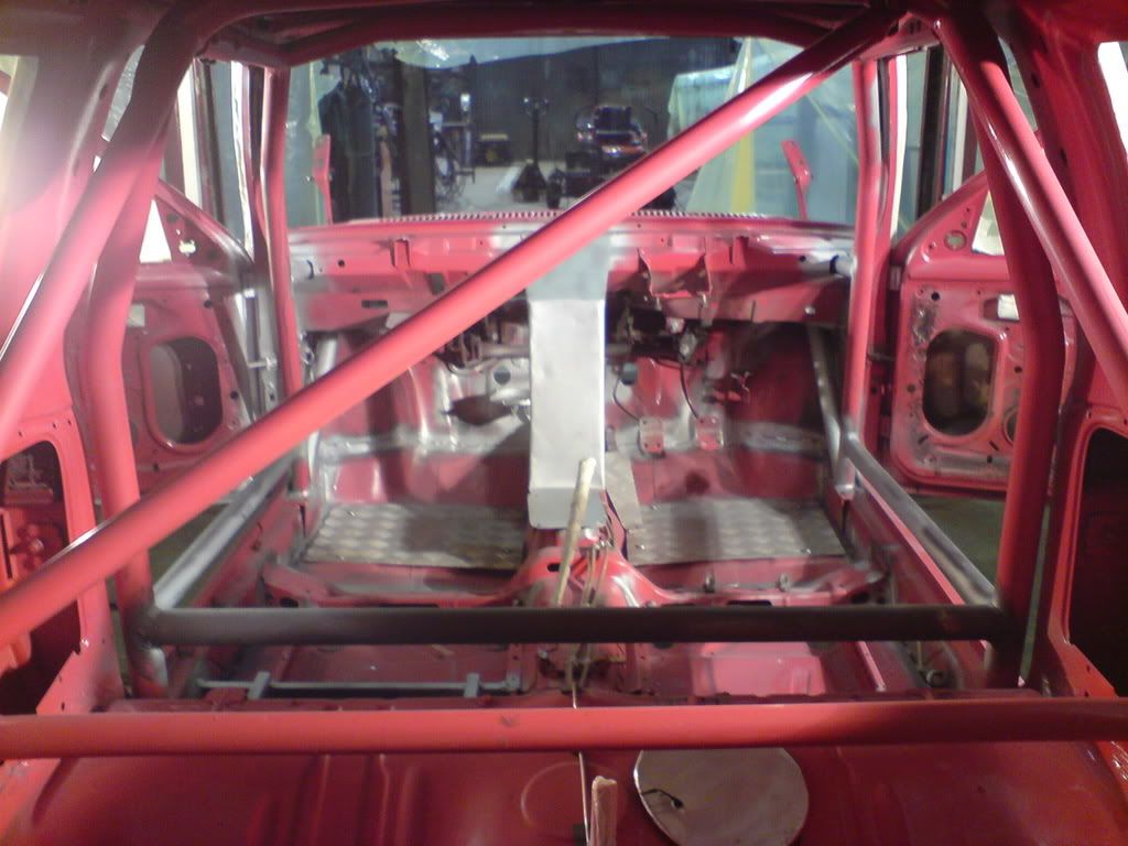

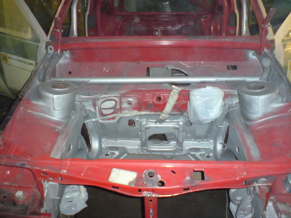

Next I went round all bare metal with Ferust 40 rust eater and then when this was dry oversprayed with silver hi zinc galvafroid in all the places that needed a good dollop of rust preventer or were gonna be difficult to get the spray gun to
http://i205.photobucket.com/albums/b...ay3rd08007.jpg
http://i205.photobucket.com/albums/b...ay3rd08008.jpg
http://i205.photobucket.com/albums/b...ay3rd08009.jpg

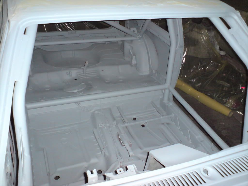

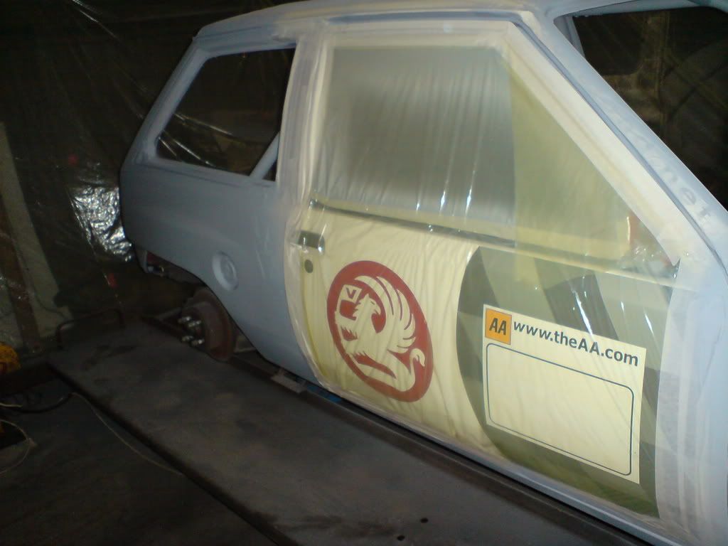

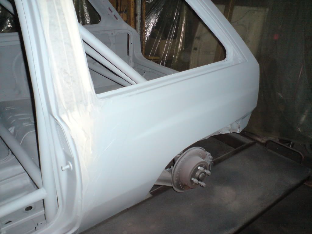

The rest of the time was spent prepping i.e masking up and rubbing down with scotchbrite to give the new paint a decent key to adhere to
With nice warm condtions prevailing it was time to get the undercoat on
http://i205.photobucket.com/albums/b...ay6th08007.jpg
http://i205.photobucket.com/albums/b...ay6th08004.jpg
http://i205.photobucket.com/albums/b...ay6th08005.jpg
