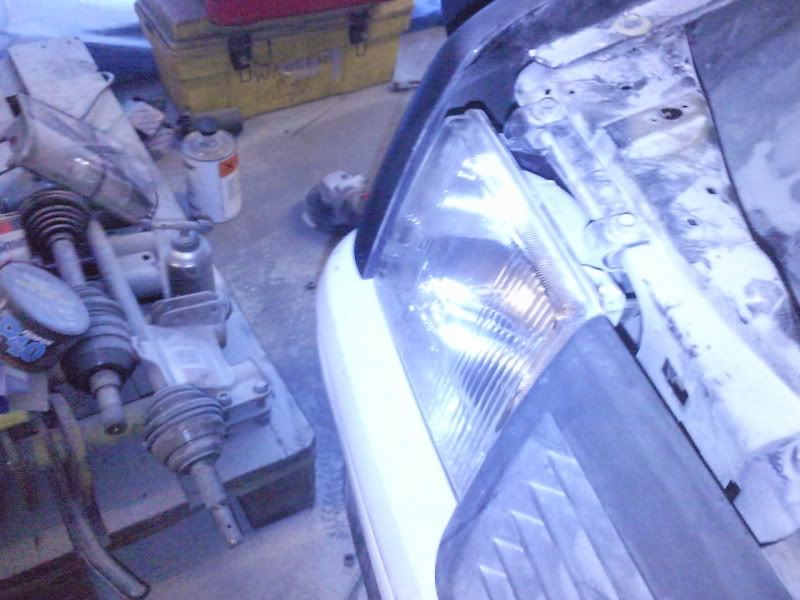

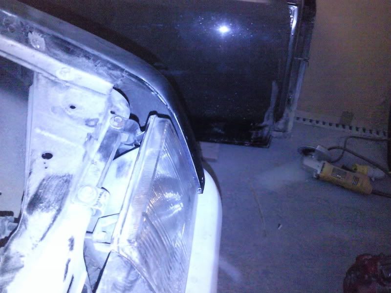

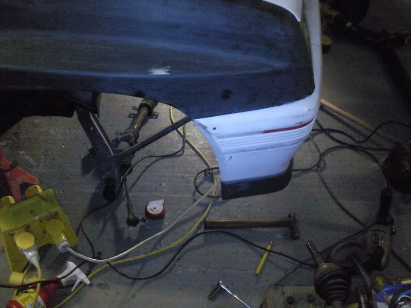

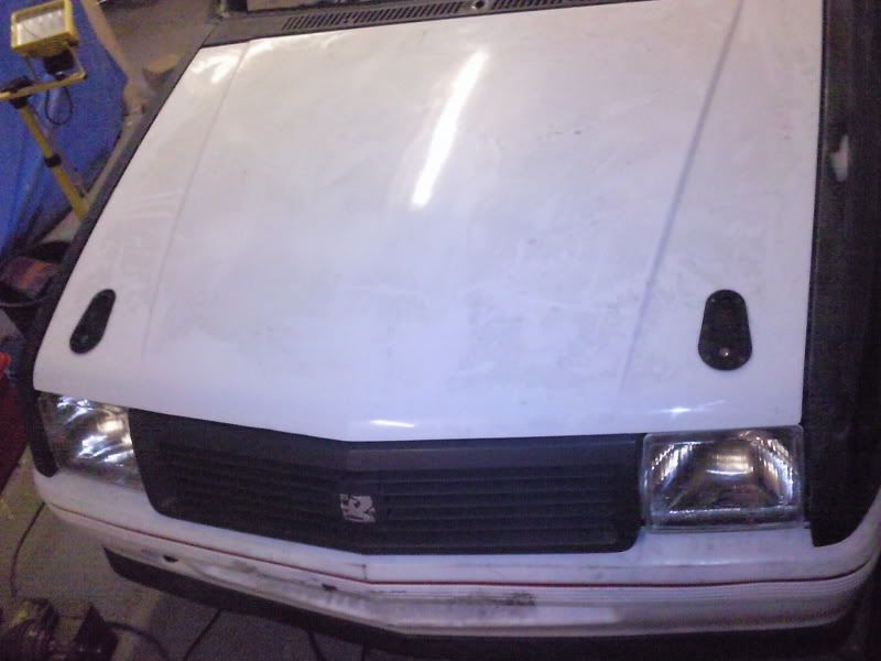

Heres the trial fit of the front bumper/lights/bonnet (and also when i realised the wings had been extended forwards past the lights)

And after i had attacked the wings to drag them in line with the lights once again
http://i237.photobucket.com/albums/f.../Photo0211.jpg
http://i237.photobucket.com/albums/f.../Photo0209.jpg
Obviously there is still loads to do, for starters double check and fine tune all of my blending before i even get onto the main jobs, but atleast it is getting somewhere now and i am fairly pleased with how things are going considering it a different angle for me to take work wise compared to normal when i let someone else do the fiddly bits

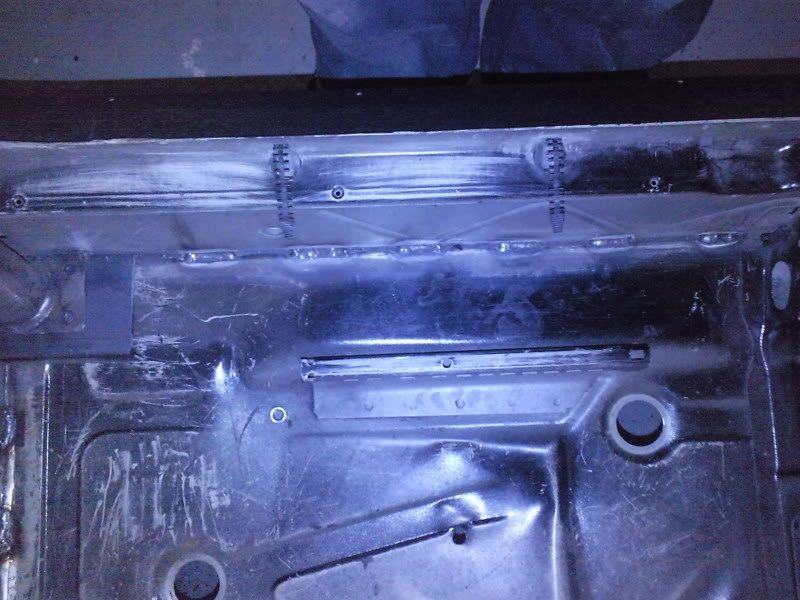

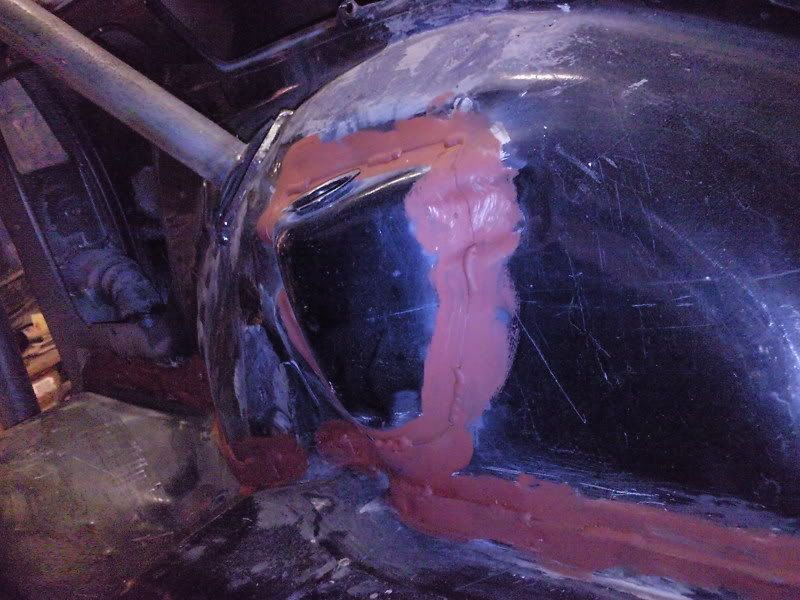

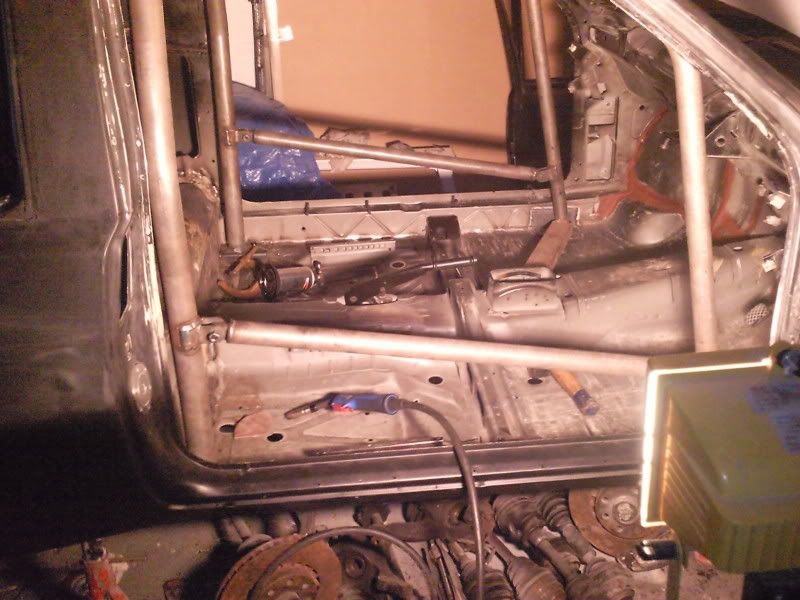

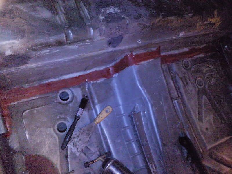

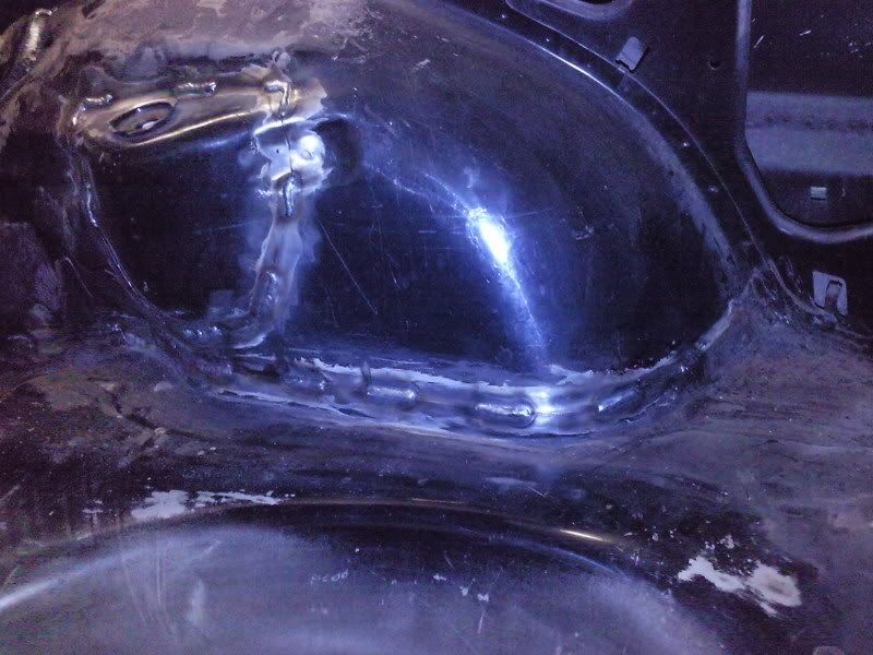

Following the last update of me working straight through friday night prepping the seams for charles i finally got finished about 5am (an hour after my last update) so decided to tinker with some other parts as charles was due circa 7am. Sure enough he arrived on time so after a banter and some well deserved coffe we cracked on with the welding and setting the cage up etc. (The welded area's were the usual internal area's, some parts of the engine bay stoo had some of this partially done previously) This carried on for most of the day adjusting and sorting bits along the way aka fitting door bars blah blah blah.
finally I had chance to run around all the welds with a nice thick layer of red oxide primer. I chose this route for a change as with previous efforts as many others can confirm with thier cars the welding can sometimes allow water to pass through the joints on wet day and form a pond in the rear boot well lol. By brushing on the thick oxide primer it enabled me to blob it into the normal suspect area's to minimise this ten fold.
Here's a few pics of what we got up to (i didnt take to many pics as obviously we were busy 90% of the time)
