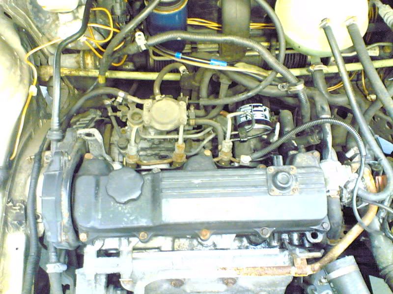

i decided to modify my pump today so thought i would take a few pics :d
i prefere to take the inlet manifold off to access the pump easier
http://i12.photobucket.com/albums/a2...s/05022010.jpg
this is the part you are concentrating on

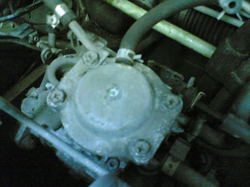

undo the four bolts to remove this
http://i12.photobucket.com/albums/a2...5022010004.jpg

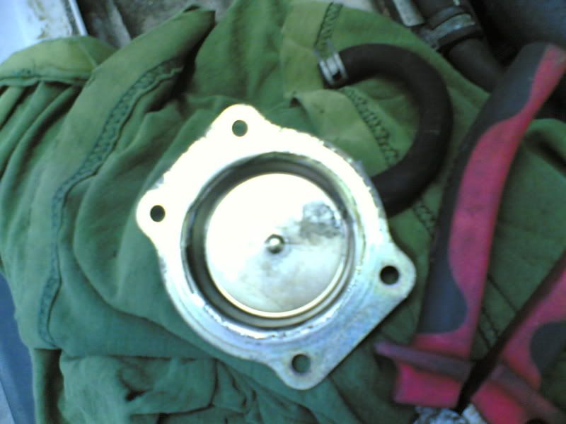

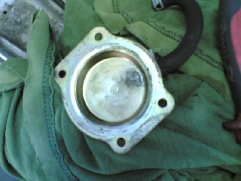

whilst it is off you want to hit the nipple in the middle flat, like so
http://i12.photobucket.com/albums/a2...5022010005.jpg

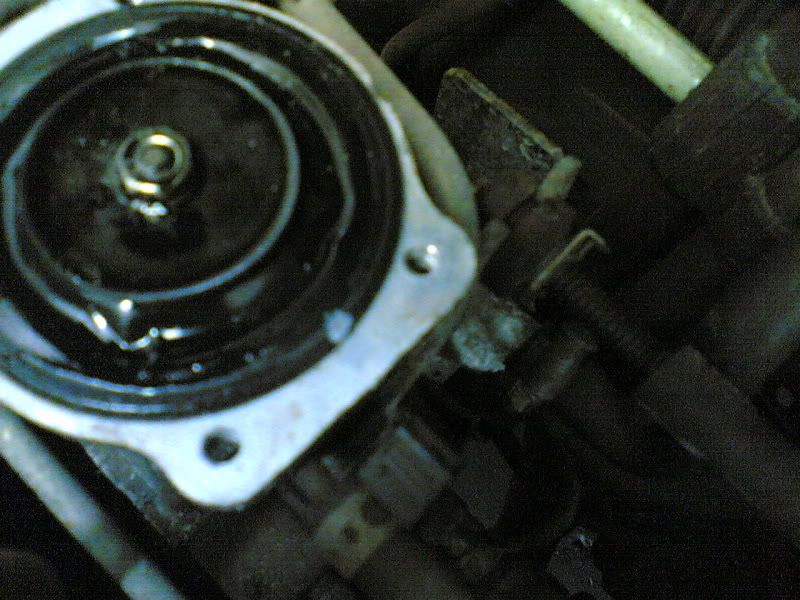

now for the "white ring mod" first off it has to go in the same way it came out. so i marked mine with a ickle dab of primer :d
http://i12.photobucket.com/albums/a2...5022010002.jpg

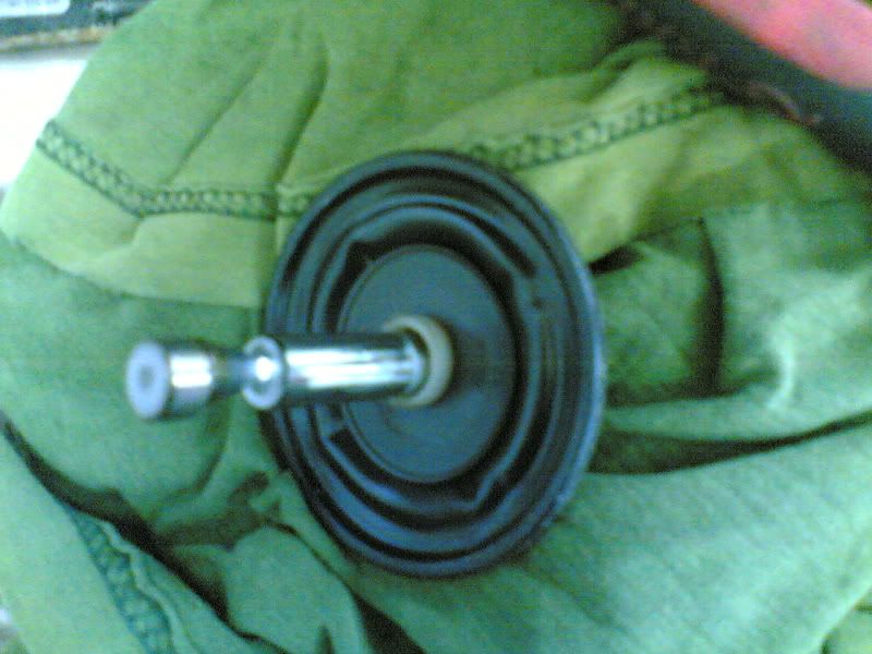

with that done it just slides out to reveal this
http://i12.photobucket.com/albums/a2...5022010003.jpg
that be the white ring that needs removing
hopes thats cleared it up abit
