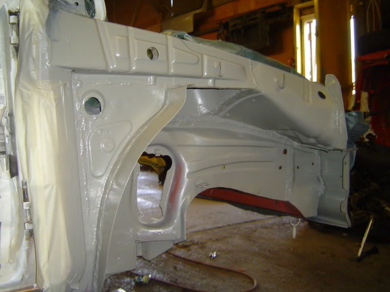

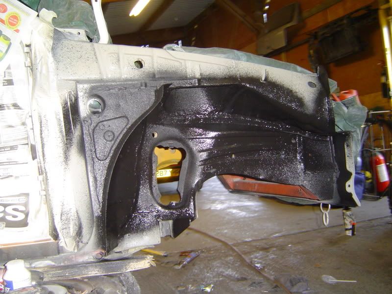

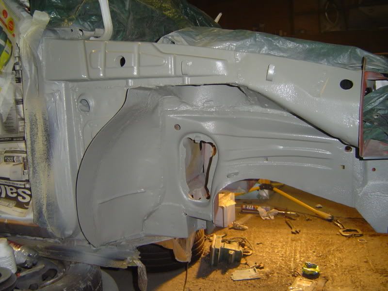

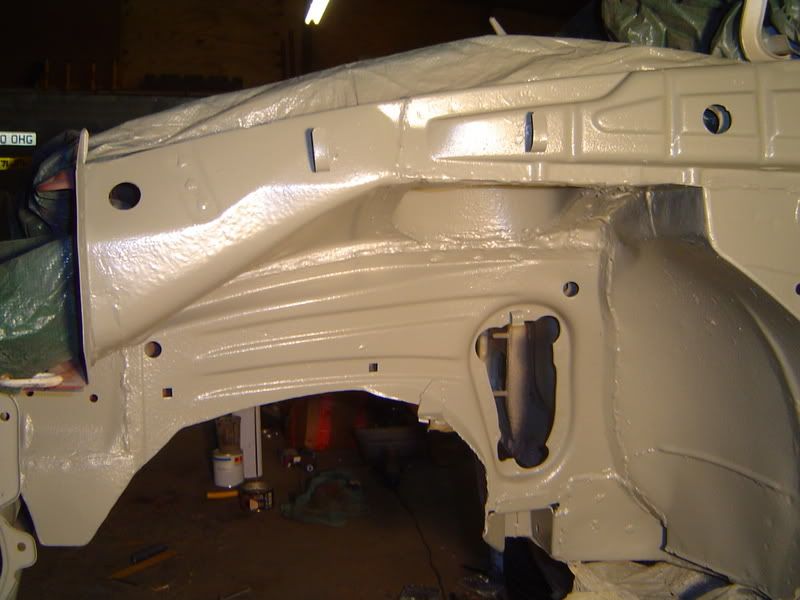

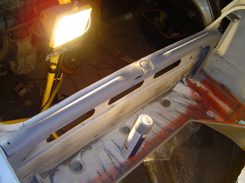

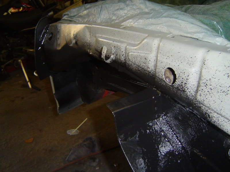

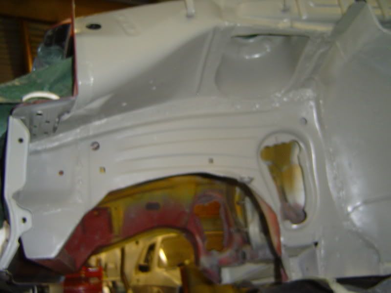

Got on with the front inner arches so far this week.
Gave them a good rub down, bit of zinc primer on the seams, then seam sealer. Then gave the whole lot some primer
Then some stone chip..
http://img.photobucket.com/albums/v1...3.jpg~original

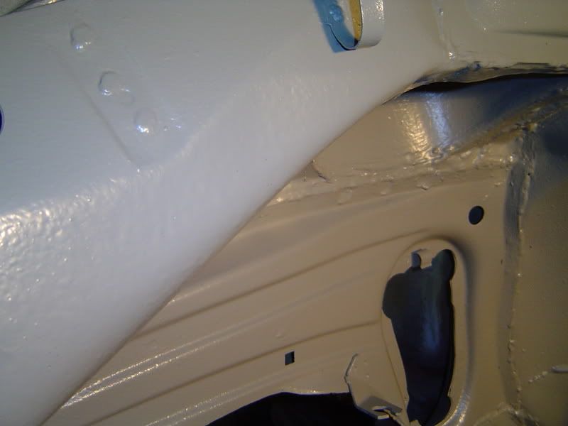

Then another coat of primer.
http://img.photobucket.com/albums/v1...5.jpg~original
http://img.photobucket.com/albums/v1...6.jpg~original
http://img.photobucket.com/albums/v1...7.jpg~original
Now ready to finally sort the bay, and get that and these inner arches in paint.

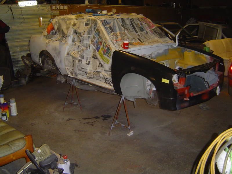

Onwards with some updates...its been a while..

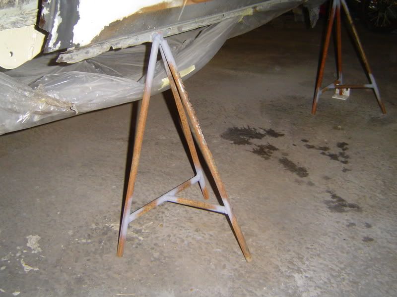

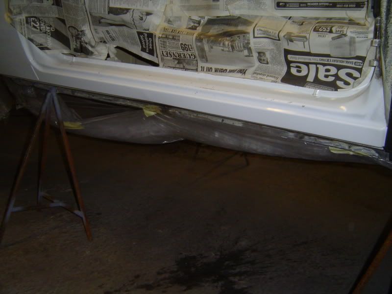

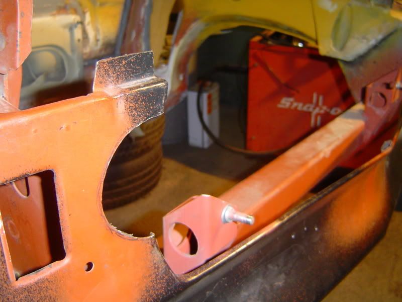

Decided to get the tyres out from underheath the car and utalise the jacking points I had welede in when the car was on its side.
Made up four sill stands like this:
much better

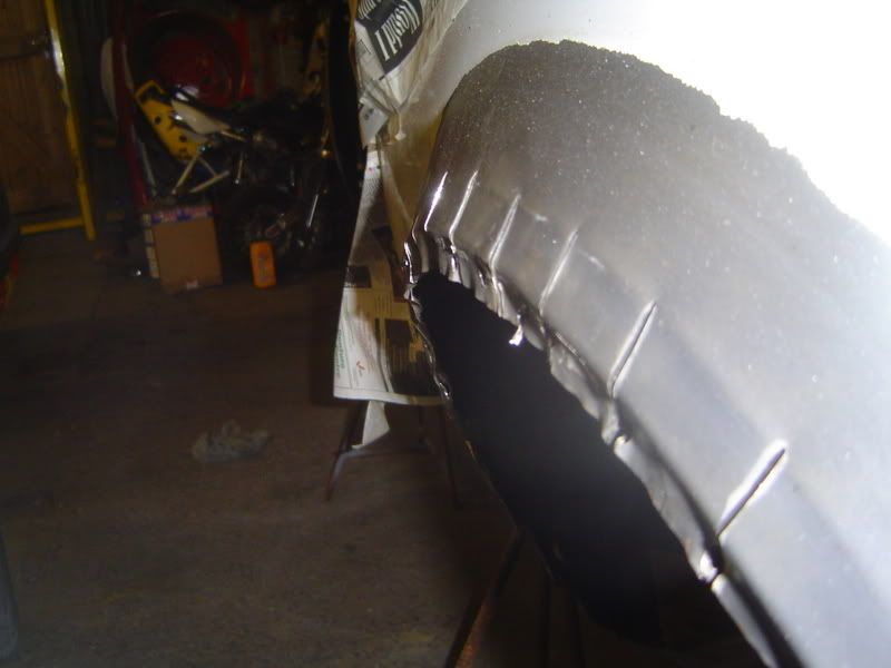

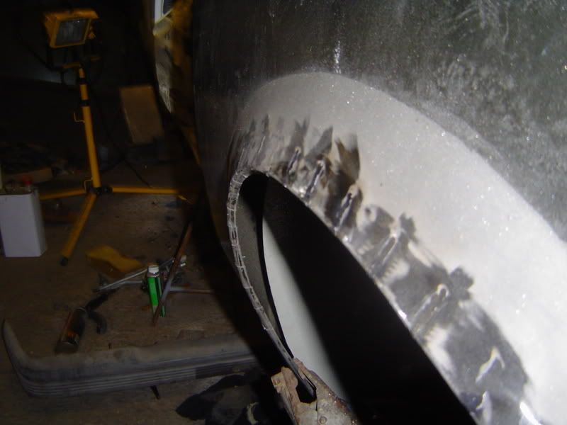

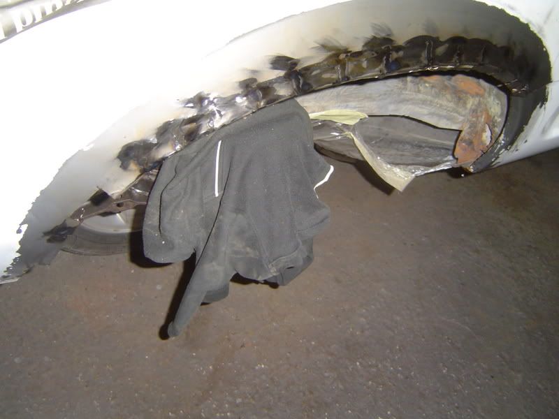

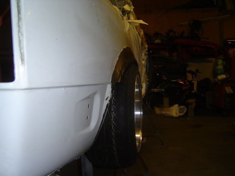

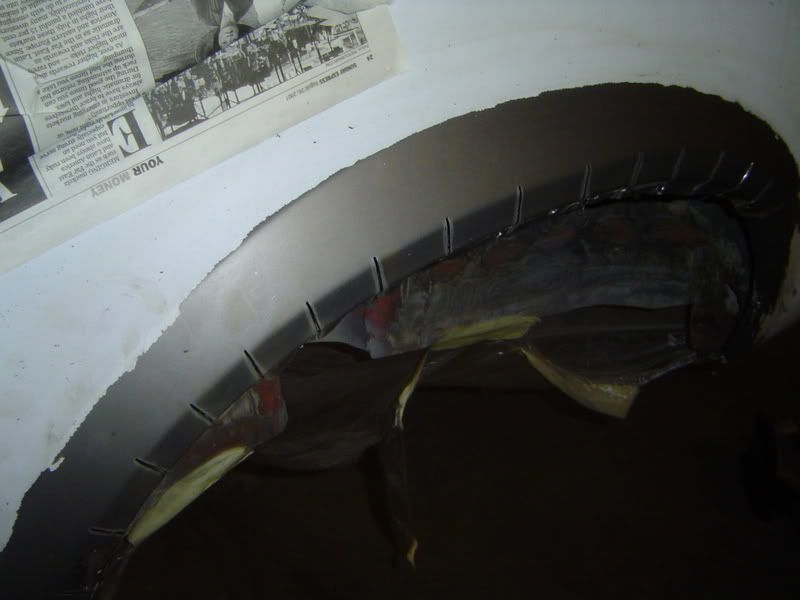

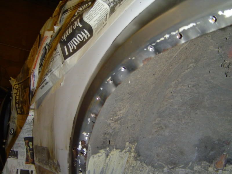

Have now started the long task of flairing out the arches.

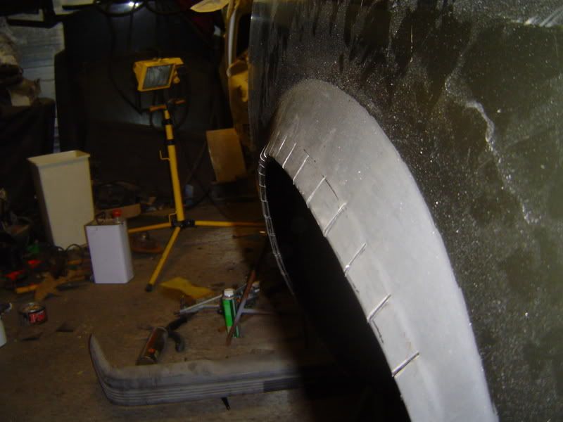

Strated with the rears and paint stripped the matalwork
Then drilled out all of the spot welds around the arches
Then cut the atch with the grinder to make a load of tans which I could then beat out..
http://img.photobucket.com/albums/v1...9.jpg~original
Then welded the lines up...leaving the last cm or so, so that I can fold the lip back under and then weld to finish.
The arches fit the wheels just nicely now, although this pic is a bit dark..

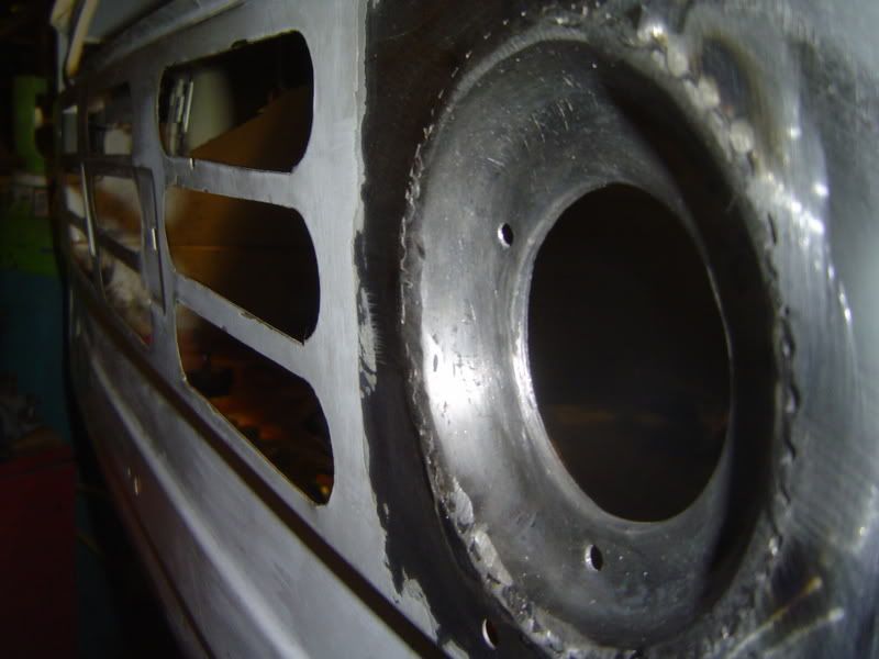

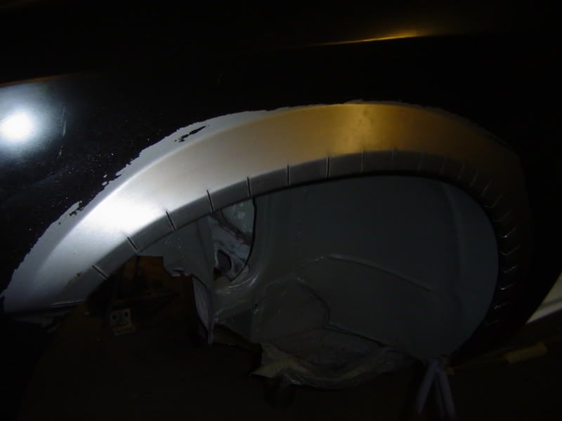

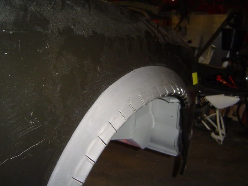

Then started the fronts...
I've left these now. Just waiting for some more body solder so I can finish then off..

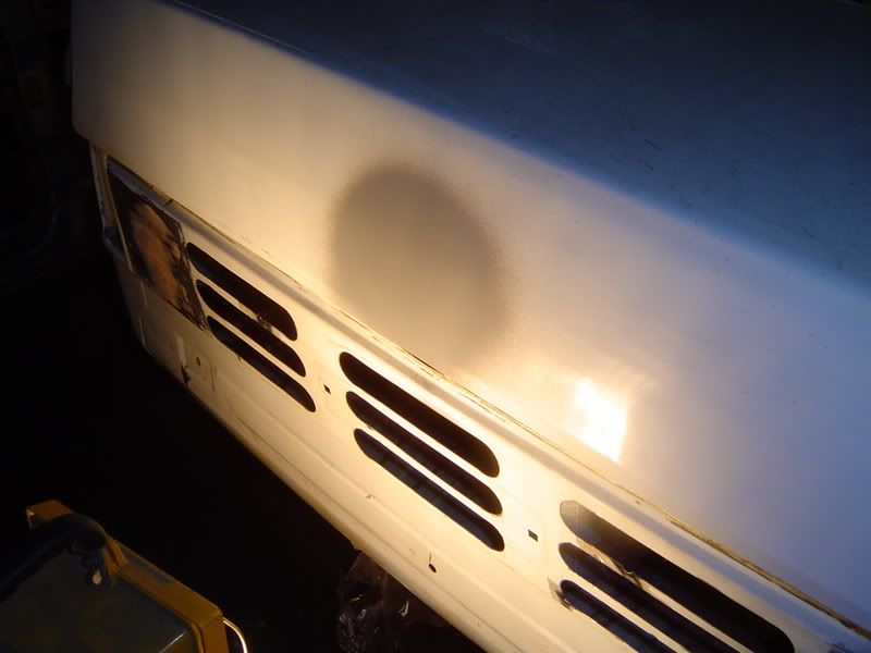

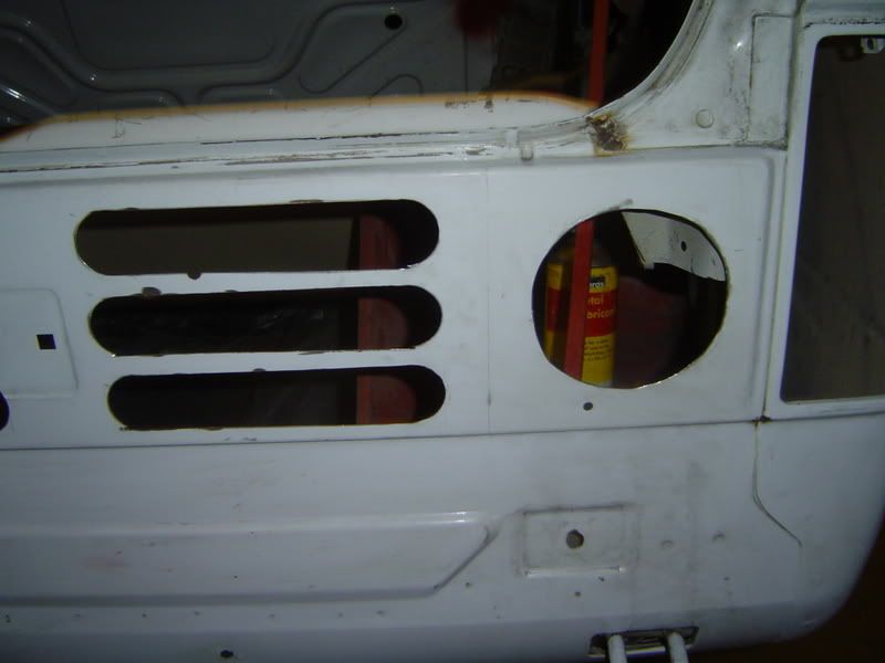

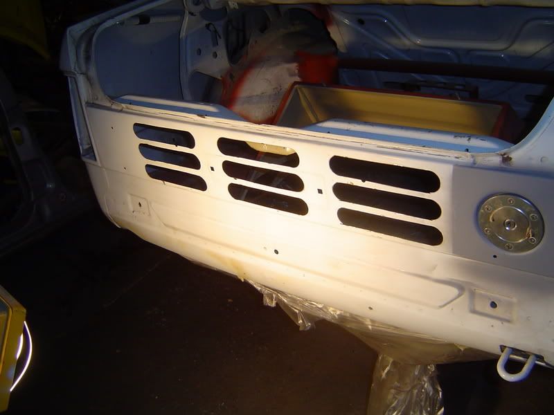

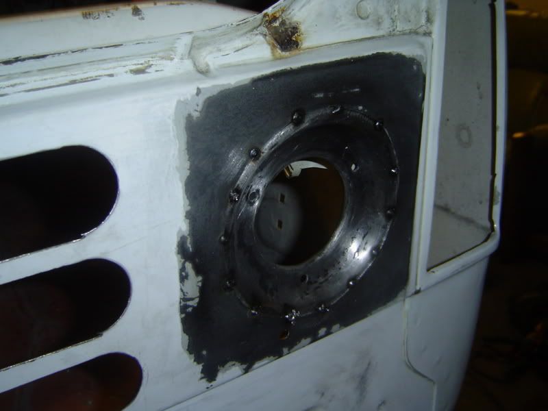

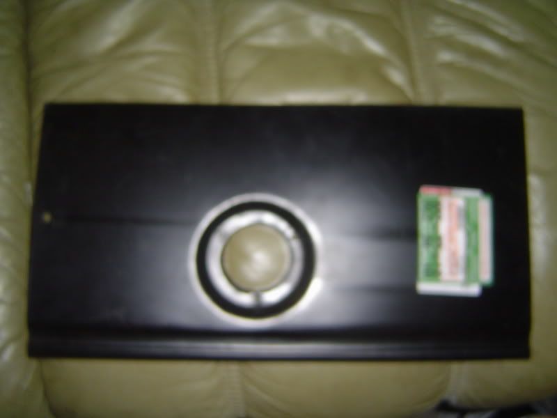

Then moved onto the petrol cap location.
Got a mk1 golf repair panel off ebay
Cut panel to shape and cut the hole in the rear panel
Tack welded in the recess and then continued until the whole perimeter was welded...had to take time so that there was no distorsion in the panel
http://img.photobucket.com/albums/v1...2.jpg~original
Ground back..
Cap fitted up. The other holes in the panel have now been welede up aswell..

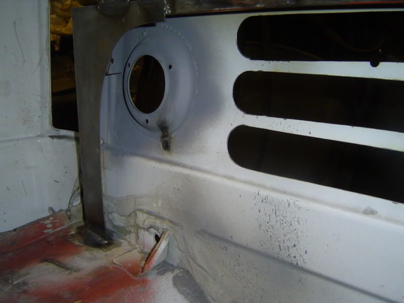

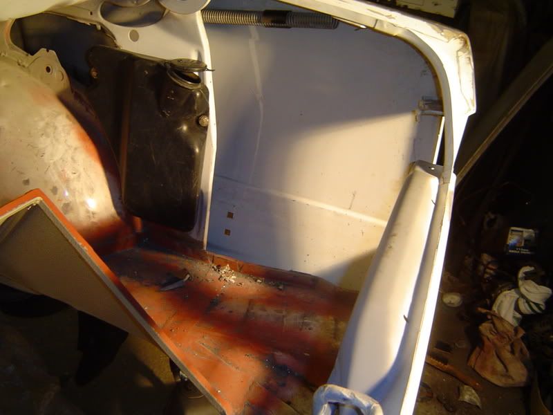

View from the inside after strengthening the rear pannle (as I've gut half of it away, and most of the top section.
I have welded a bit of 10mmbox along the edge of the top of the rear boot panel to strengthen it, and welded the latch to this..
Boot shot

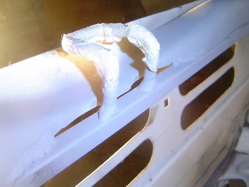

Put in some brackets for the washer tank.

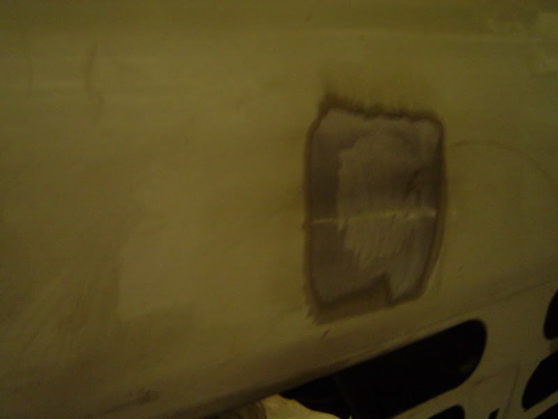

Welded a plate in the lock recess, then lead filled and sanded back:

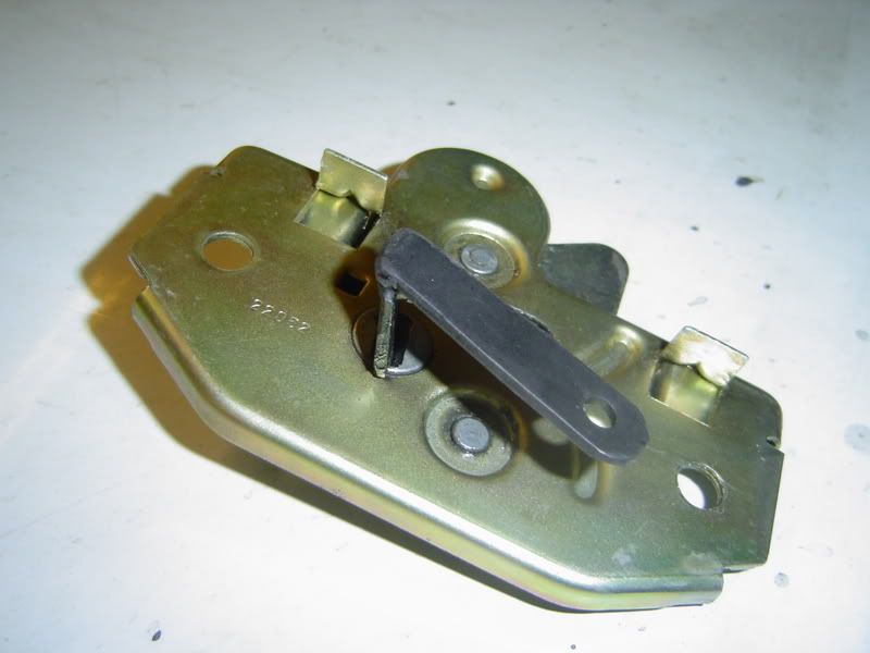

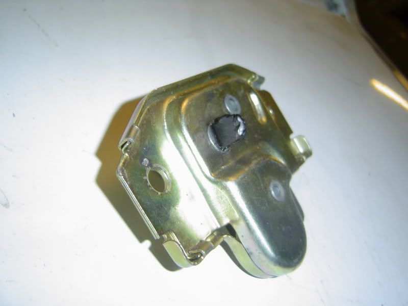

Moded the lock part to allow use of a central locking door motor.
I've also weled in a bracket to hold the motor and connected in up, but no pics of that..
Have cleaned up the sills with thinners which came up well, and are priytty mint

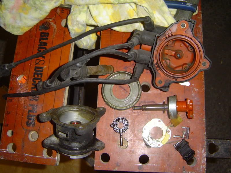

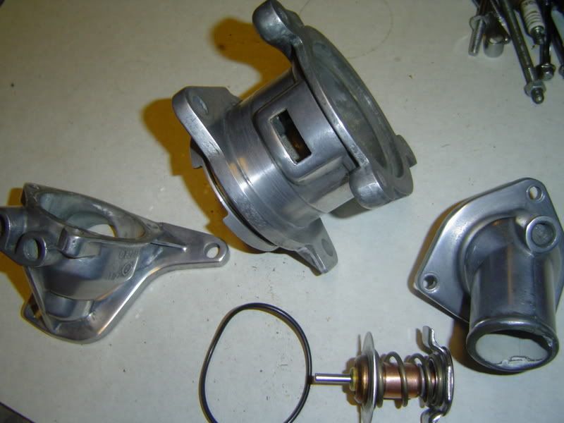

Whilst waing for the lead to turn up, I got on with cleaning a few engine bits:
dizzy stripped:
A few bits cleaned up

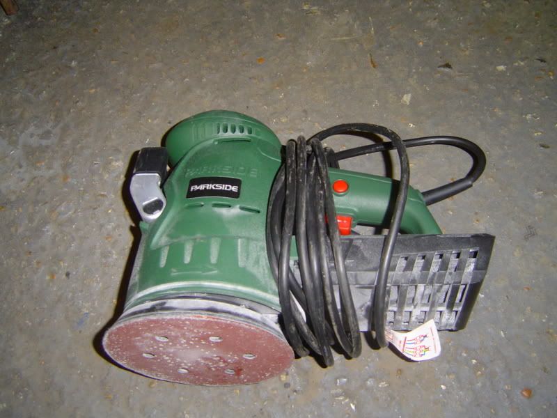

Also got hold of this orbital sander last week, which should make the prepping for paint a lot easier.
