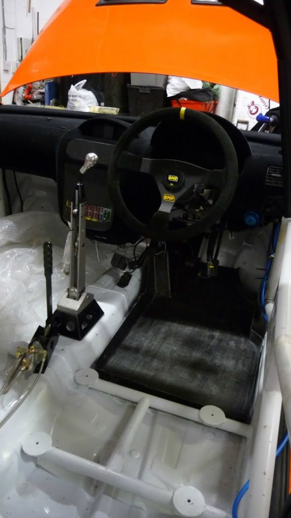

it is wow. shifter looks awesome. sequential?
Running a Sadev ST75 6 speed sequential gearbox with a shift lever - will probably end up being paddle shift when we get it all up and running
Dude that looks awesome, love the dash.
I like the use of the B loom and how good its come out.

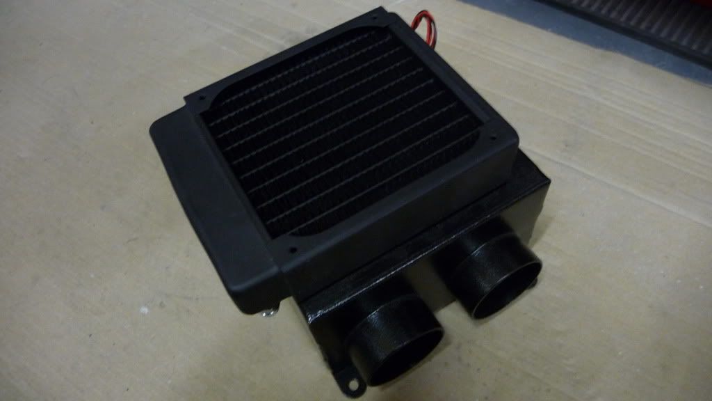

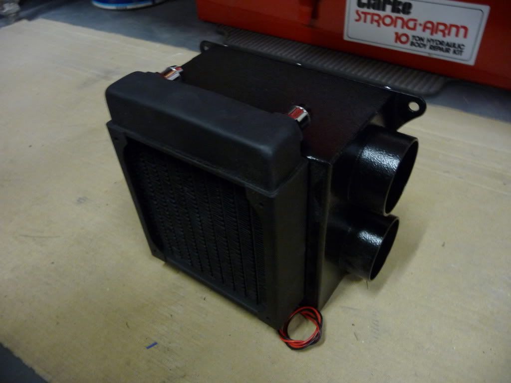

In an attempt to save weight we scrapped the original heater/air distribtion housing as it's very heavy - to be replace by this little heater/blower
http://img.photobucket.com/albums/v5...ot_tray005.jpg
http://img.photobucket.com/albums/v5...ot_tray002.jpg
It's tiny and will supply warm air to the Heated screen we have on order - best to be safe than sorry - It no good having all this fancy equipement if you cant see where your going !!!

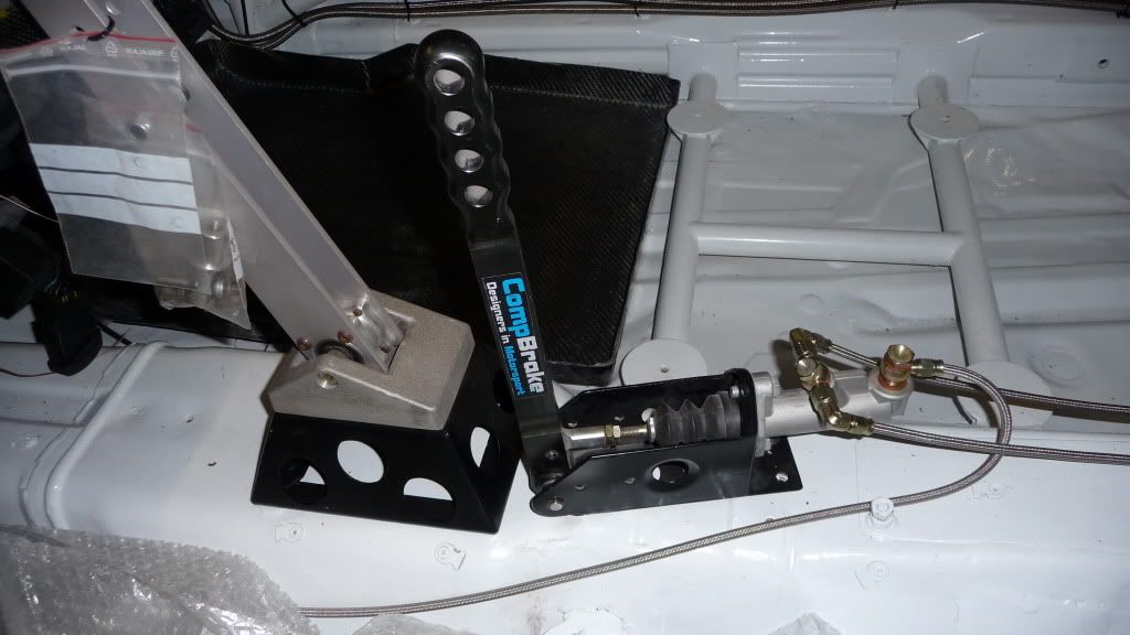

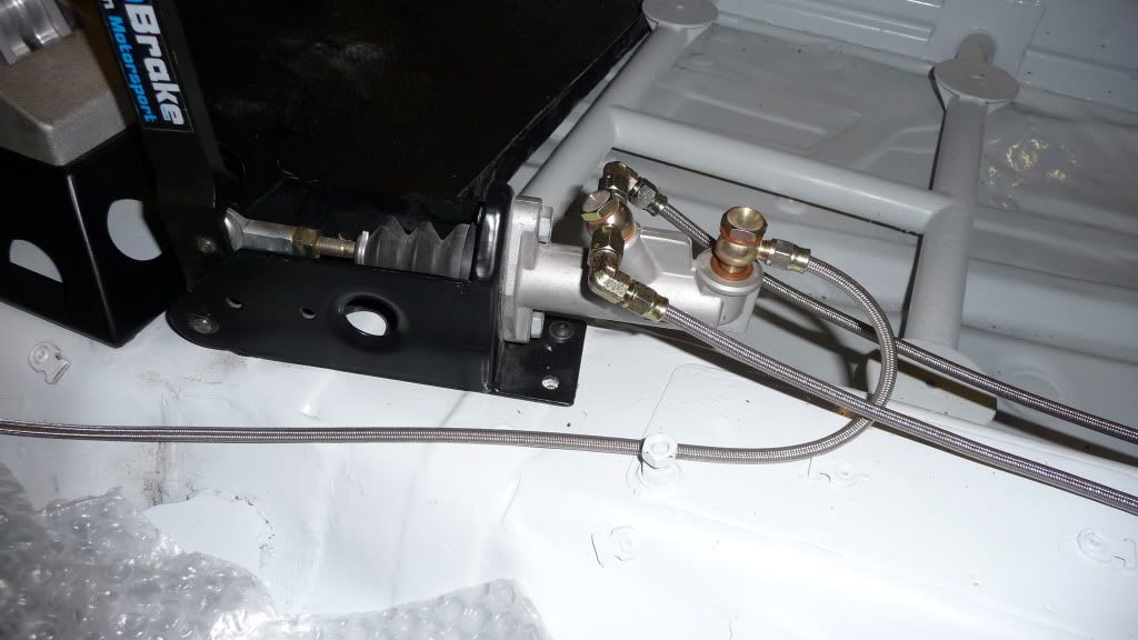

Hydraulic handbrake plumbed in - Just need to extend the lever to be in easy reach

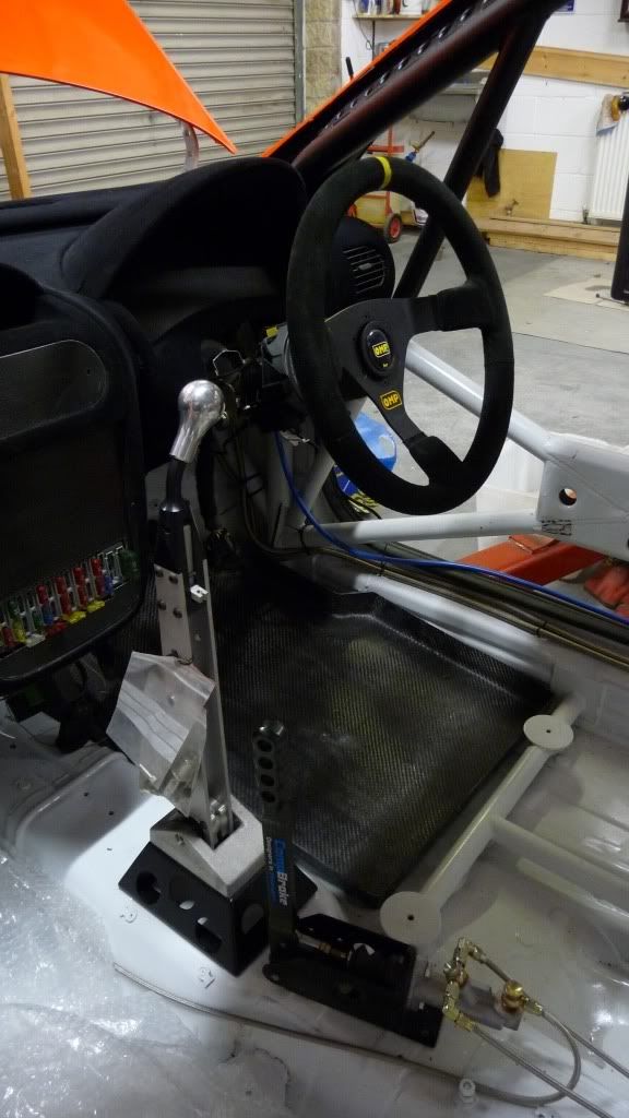

Drivers carbon fibre foot tray in positition - just need a liittle tweeking to fit snug
