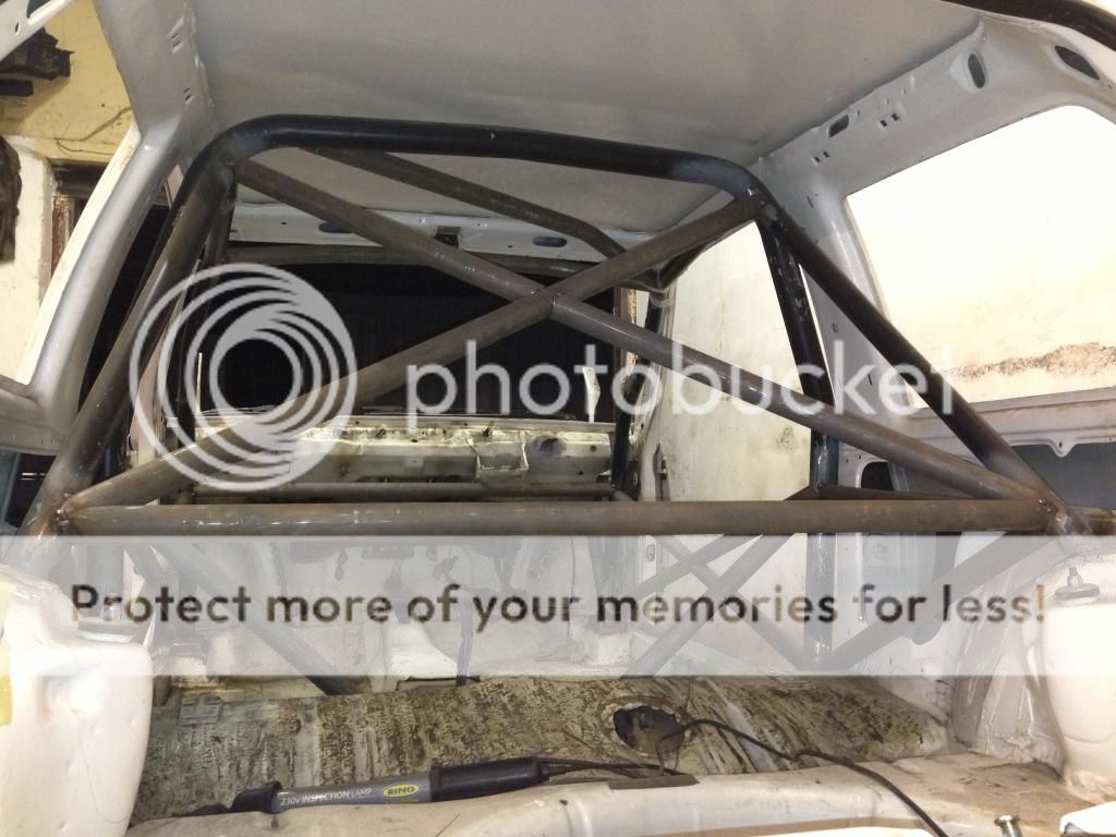

I have thought long and hard about it, But i really dont like the ones in the "X" as they ruin the lines of the cage, plus the inside harness sometimes doesnt quite pull straight.
Also dont like the main hoop brace, as it reminds me too much of a stock car (plus the back of the seat is level with the hoop anyway).
I think im going to go right back to the rear brace. My Sabelt's are long enough, and its just a prefference of mine.
Fair enough you don't like how they look, but you wouldn't have problem with them "pulling straight".

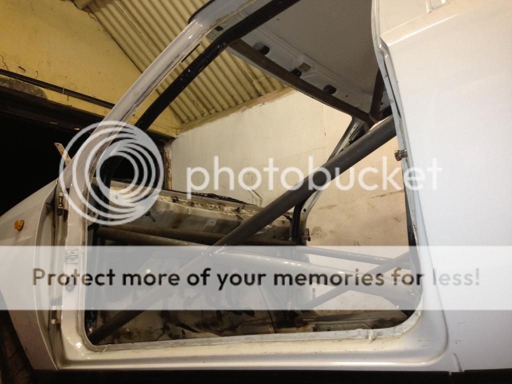

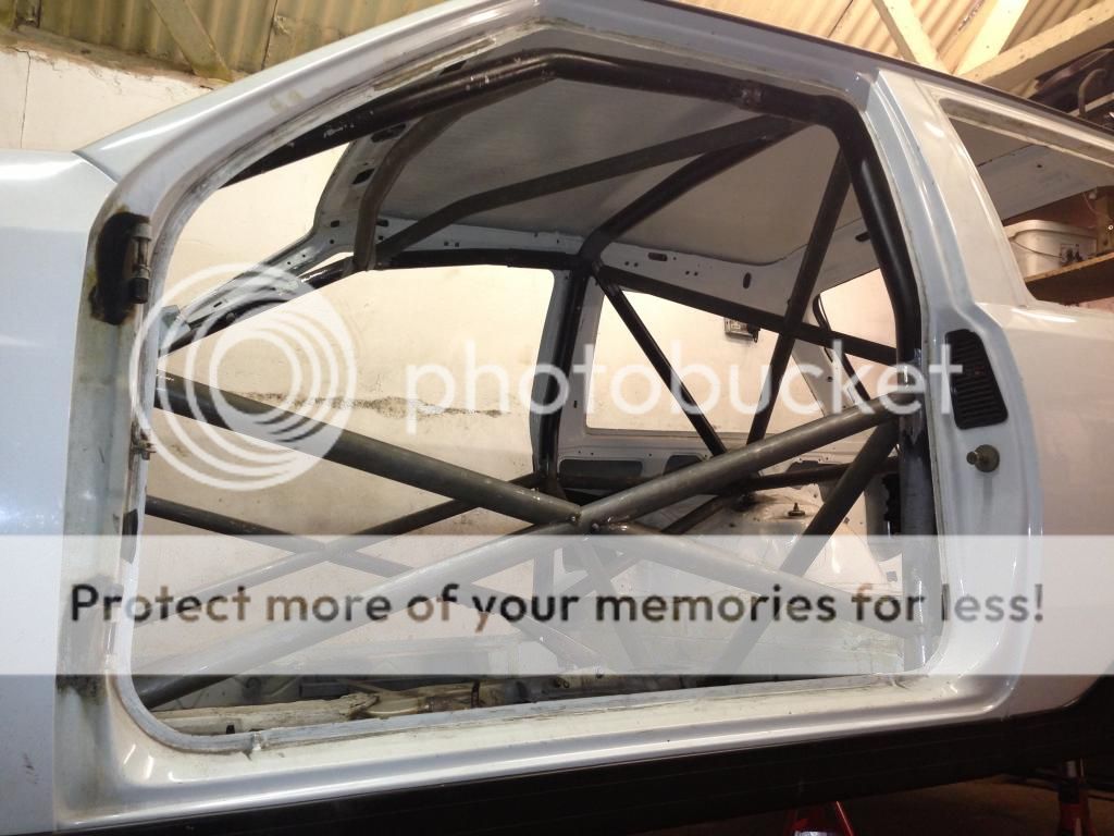

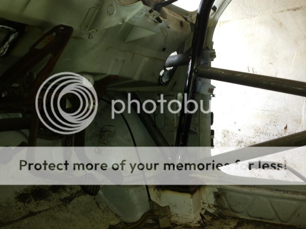

Did a bit more this afternoon. Only because i had to work next to it and something was bugging the hell out of me though.
Moved the rear stay up about 2", as i wanted the door bars higher, so chopped that one out on both sides and made alterations.
http://i995.photobucket.com/albums/a...ps1b28da3e.jpg
Some nice upgrades your making should make a difference on track.i use to have my belts going to the rear brace on my old cage.

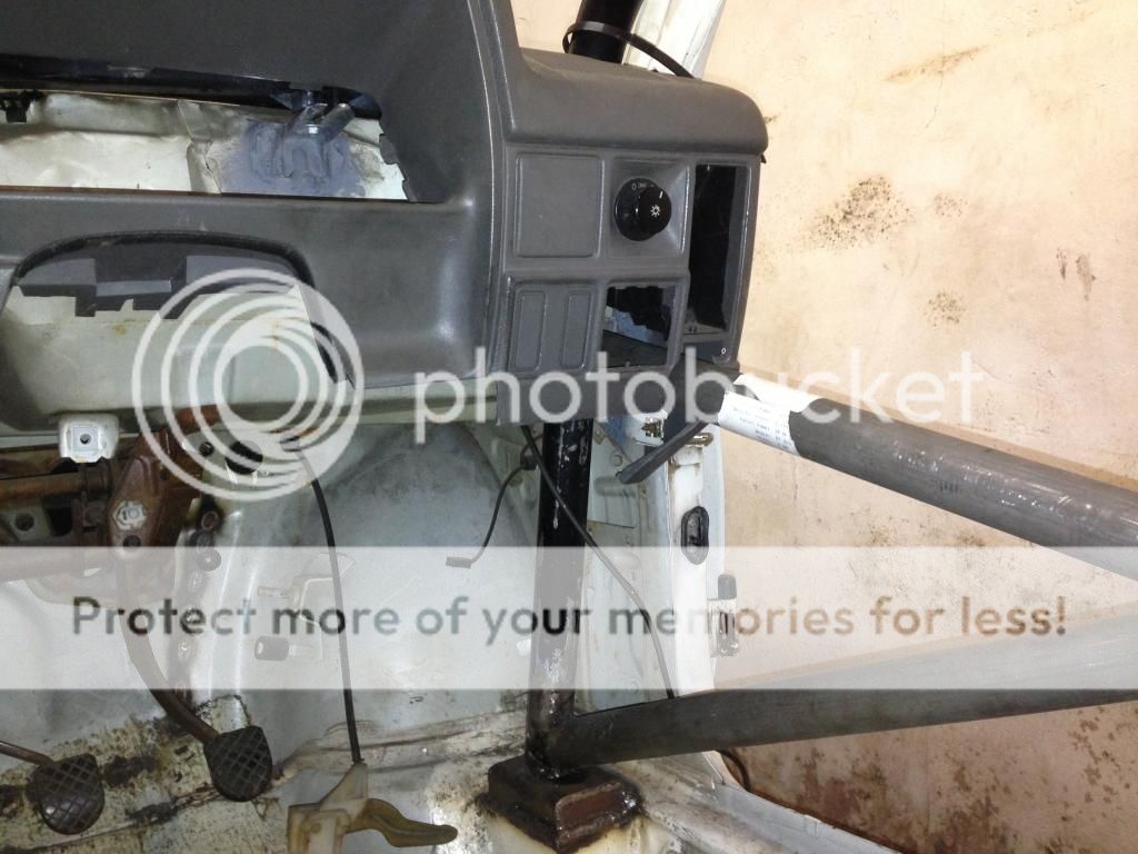

Did a bit of work on it today, Managed to get the drivers door bars finished, which sadly meant loosing the standard fuse box position.
http://i995.photobucket.com/albums/a...psa27d0aa1.jpg
http://i995.photobucket.com/albums/a...ps7be245b1.jpg
http://i995.photobucket.com/albums/a...ps7d16335f.jpg

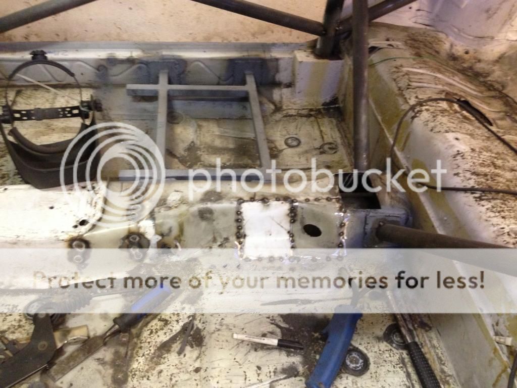

Then i realised that i couldnt really do any more on the cage until the passenger seat rails were fitted, as otherwise it would be a right mission getting in and out to measure, cut and weld.

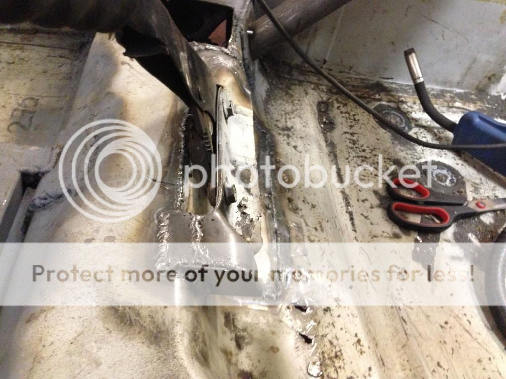

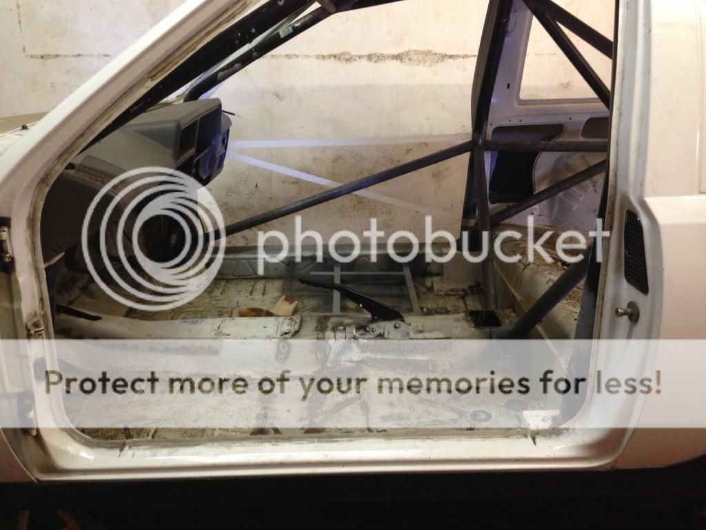

Then...... realised the passenger seat rails couldnt be done until the handbrake was moved back, So started on that. Decided it needed to move 110mm, so hatched a plan to re-use the old hole, which would also give me a mounting point.
http://i995.photobucket.com/albums/a...pse19b67b7.jpg
So cut out the first square, then measured up a hole to re-weld it in further back
http://i995.photobucket.com/albums/a...psddef005c.jpg
http://i995.photobucket.com/albums/a...ps43d4f645.jpg
In an ideal world i could have just swapped the 2 squares over, but unfortunately that didnt work out, so had to fashion a new piece for the front hole.
http://i995.photobucket.com/albums/a...pse4318dab.jpg
Once happy, seam welded it all in.
http://i995.photobucket.com/albums/a...ps84f55f32.jpg

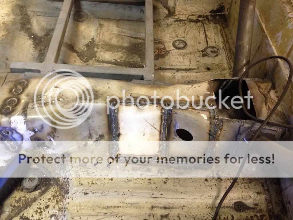

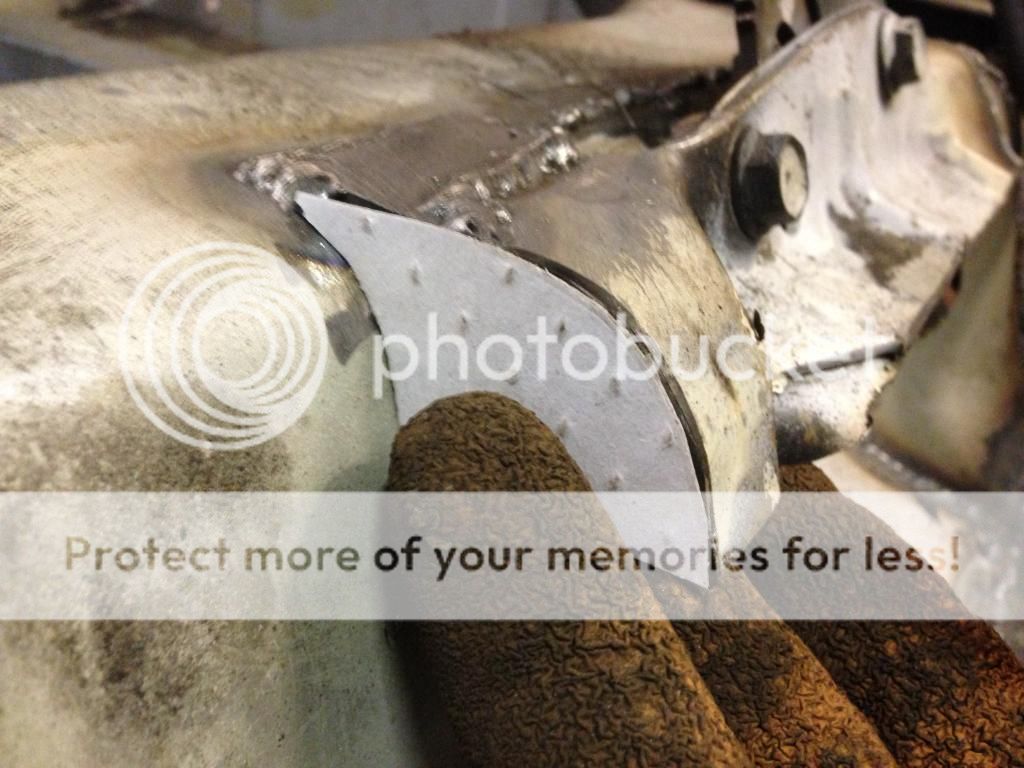

Then started cutting tabs to hang the old handbrake mount in place, as usually it sits on the side of the original seat rail, which has now been binned.
http://i995.photobucket.com/albums/a...ps57ee8076.jpg
Made a fillet for the end, which did stiffen the handbrake mounting up, but it was still a little bit flimsy.
http://i995.photobucket.com/albums/a...ps7c9500ec.jpg
http://i995.photobucket.com/albums/a...ps592fe8f8.jpg

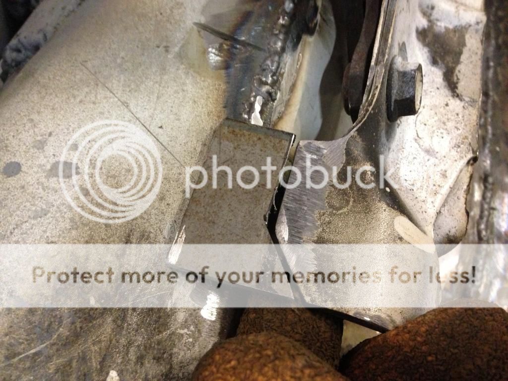

With that done i started measuring up for the seat rails, but instantly hit a stumbling block, as the rear passenger rail would have been in the way of the handbrake mechanism.
It needed a spreader plate anyway, which would have been an asshole to fully weld, so instead i boxed the new handbrake bracket in with 2mm. which worked a treat, and in my opinion looks neater anyway.
http://i995.photobucket.com/albums/a...ps8b4b6d35.jpg
The handbrake works fine now, as i cut the same amount out of the metal linkage bar just before it joins the cable, then re-welded that too. The guide didnt need moving and it still sits nicely on the beam, so was quite a result.

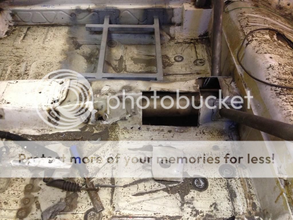

I did then get one of the seat rails in, but called it a day around 7pm.
http://i995.photobucket.com/albums/a...psd3419e5b.jpg

Spending this morning welding all of the metal discs into the floor, as that too would be a mission to do once the passenger door bar goes in.

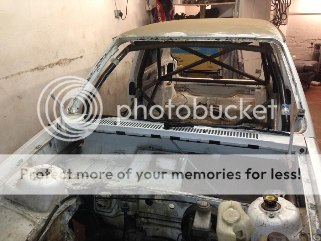

Cage is done. Right on schedule, (If Feb was a normal month). Finished the passenger seat rails, then welded in all of them discs to replace the rubber bungs.
http://i995.photobucket.com/albums/a...ps0fa7eee6.jpg

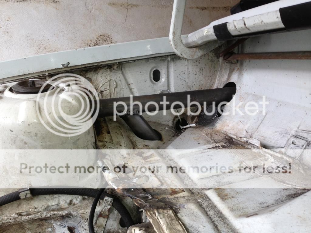

Cut out the upper firewall, drilled the holes and plated the turrets, Then started on the forward triangulation.
http://i995.photobucket.com/albums/a...psb5b14cbd.jpg
http://i995.photobucket.com/albums/a...ps1bfe8234.jpg
Measuring the angles was a bit of a pain, but got there in the end,
http://i995.photobucket.com/albums/a...ps8259154e.jpg
http://i995.photobucket.com/albums/a...ps55e923e1.jpg
http://i995.photobucket.com/albums/a...ps6667c40f.jpg
Did the same for the other side, and managed to re-use the angle guides which made it a little quicker.
http://i995.photobucket.com/albums/a...psaabce9a5.jpg
Then as access with the tools was no longer required went on to finish the straight bars.
http://i995.photobucket.com/albums/a...ps291c32e1.jpg
http://i995.photobucket.com/albums/a...psaaedbde1.jpg
http://i995.photobucket.com/albums/a...ps4cdfbdce.jpg
http://i995.photobucket.com/albums/a...ps83315f1f.jpg
http://i995.photobucket.com/albums/a...ps5c7e90dd.jpg
Very happy with it all. My OCD is satisfied, as everything is straight, everything is symmetrical, and im happy with all of the joints.
Hopefully getting fully welded on Weds by a proffesional (Adam Dewis). Mines ok, but from a safety point of view i will be much happier knowing it is welded properly.
