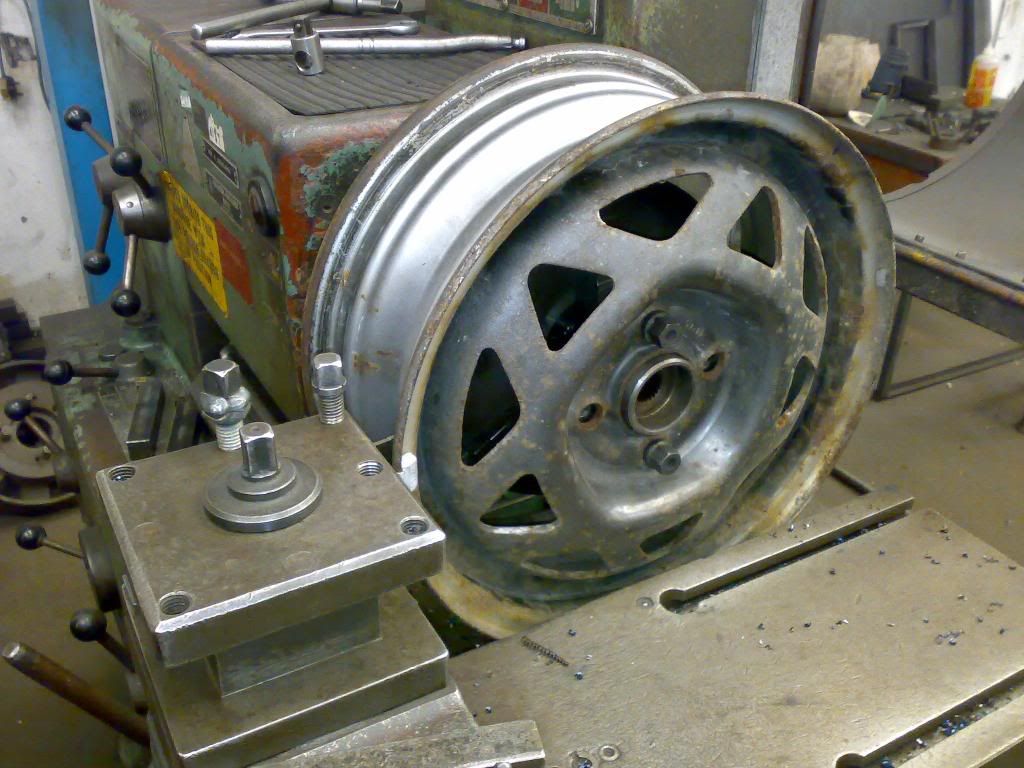

When you did the wheels, obv clamp them up and use a parting tool to remove the outr rim, then bolt up another wheel the other way around and use the parting tool to remove the inner rim. How did you ensure it was all true before welding it together? Or are you accepting a small vibration on the strip if theyre a little out of balance?
Im quite interested in doing similar for some track wheels but id need them to balance up perfectly and Im not sure what can be achieved.
Also, it must have been a ******* huge lathe!
Looking good James.Cant wait to see it once all done.
The wheels balance up quite well you are only cutting it in half at the end of the day and as long as the two cuts are clean then they should slot back together neatly. Then you make sure all the measurements line up and weld it up.Quote:
Originally Posted by alistairolsen
You would be surprised how out of shape most steel wheels are in the first place lol
Here is the lathe it is 'quite large'
