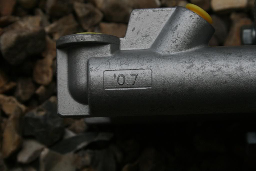

Originally Posted by Mint FRST

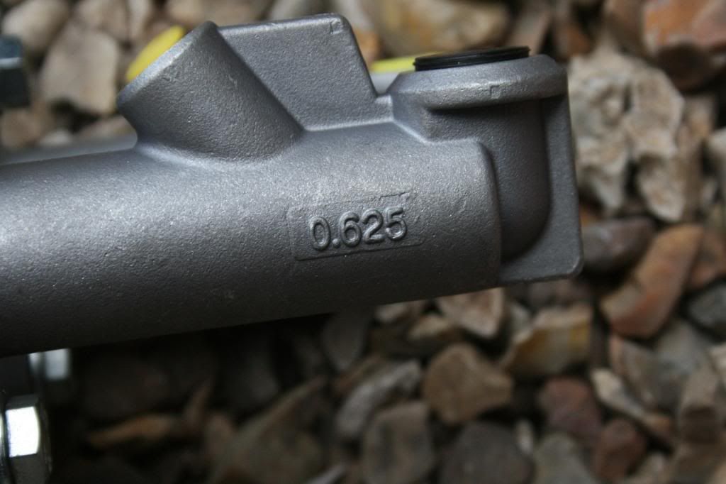

Small update for to nights tinkering - i received the MC's (0.625 for the Wilwoods at the front and 0.7 for the rear drums as recomended by comp brake)
http://i248.photobucket.com/albums/g...dcooler016.jpg
http://i248.photobucket.com/albums/g...dcooler017.jpg

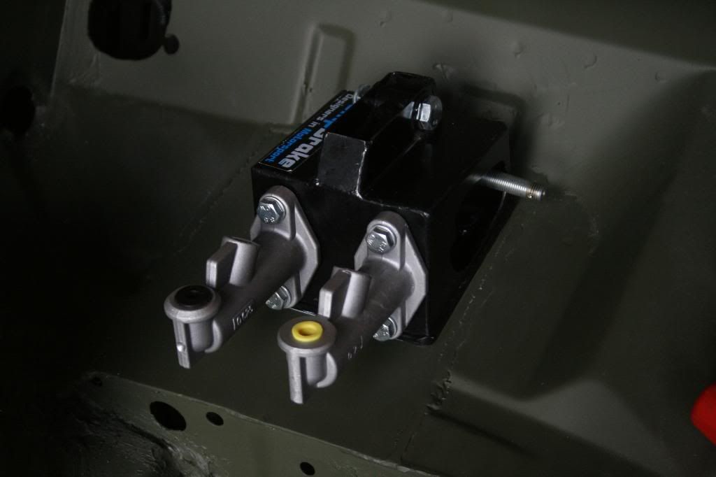

Then fitted them up to the pedal box (adjustment will be needed once the brakes are bled etc)
http://i248.photobucket.com/albums/g...dcooler015.jpg
And made the pedal box a permanent feature with the help of some super slim bolts (less weight lol)
http://i248.photobucket.com/albums/g...dcooler019.jpg
http://i248.photobucket.com/albums/g...dcooler018.jpg

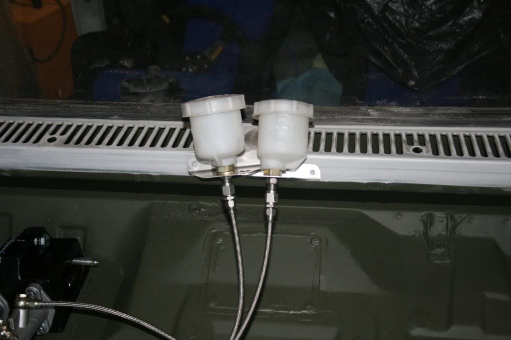

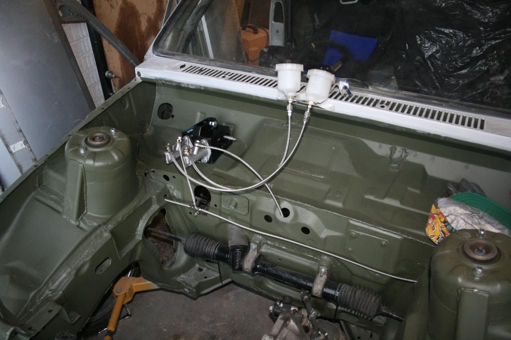

Once the pedal boxs was secure in place i decided to see how much the braided hoses needed 'altering' to fit, the answer was quite a lot.
A rough fit
http://i248.photobucket.com/albums/g...dcooler020.jpg
Not sure were the best place to put the reservoirs is?? Some were around here but lowere and with shorter lines obviously
http://i248.photobucket.com/albums/g...dcooler026.jpg

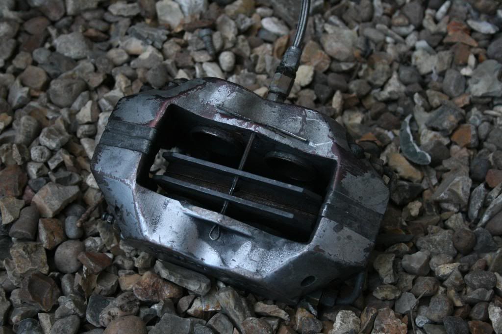

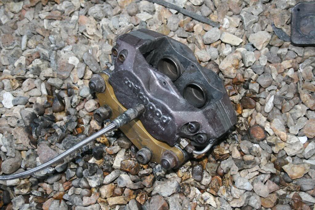

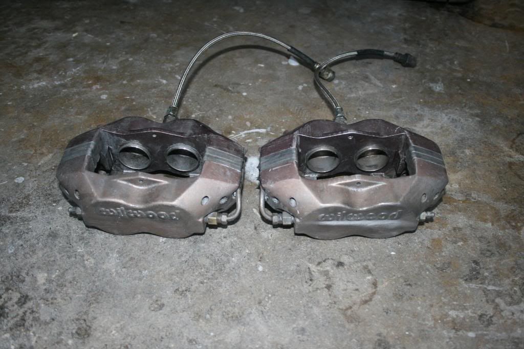

Getting a bit ahead of myself i grabbed my front callipers from the parts storage facility (the loft) to see if they had the correct fittings in (they do) this is when i realised they were in need of a dam good clean
This is how i found them
http://i248.photobucket.com/albums/g...dcooler021.jpg
http://i248.photobucket.com/albums/g...dcooler022.jpg

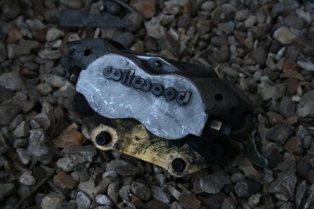

I gave them a squirt of brake cleaner and the dirt along with the paint (at least i think it was paint) began to remove its self
http://i248.photobucket.com/albums/g...dcooler023.jpg
They ended up like this nearly ready for a repaint
http://i248.photobucket.com/albums/g...dcooler024.jpg
http://i248.photobucket.com/albums/g...dcooler025.jpg
