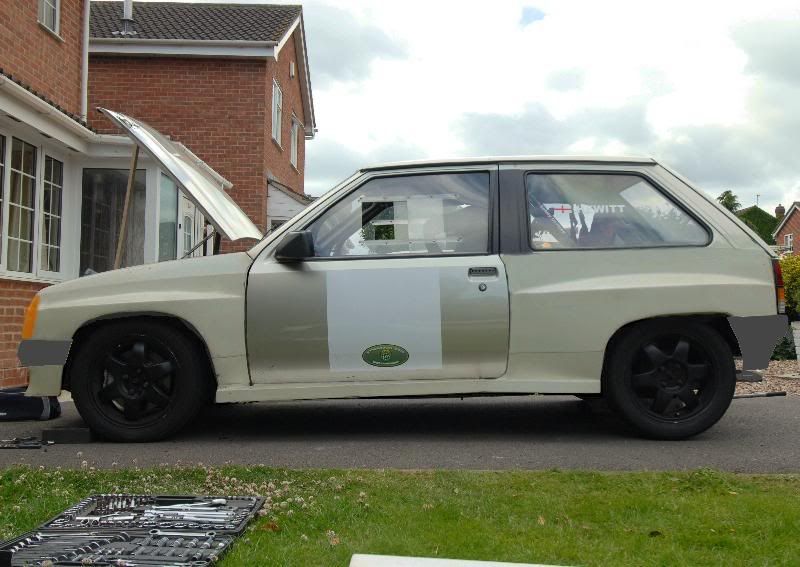

i'm ridiculously poor on photoshop, so please excuse this... but I just wanted to see what it'd look like, poor colour match I know - anyone else whose better (or even, professional *ahem* nova ian *ahem*) if you wouldn't mind...
http://i136.photobucket.com/albums/q...ure/nc0902.jpg
Lmao^ looks like grout(sp) for stickin bricks together :P

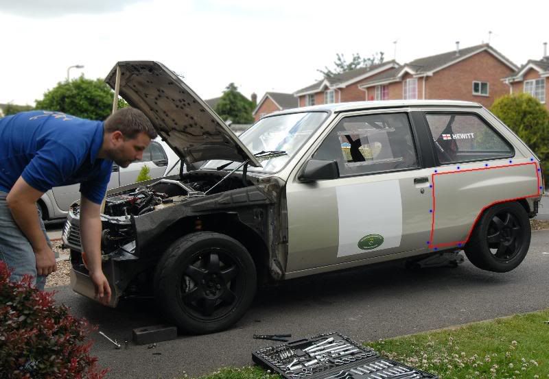

How does it fix on? Rivets/Bolts? (have to cut out some of the rear 1/4 arch?)
You cut out the complete rear quarter, but leave a 1" lip just to rivet the FG onto the metal.
Two options are to spray the panels, rivet them on, and job done :thumb:
or
Rivet them on, and smooth the edges in with more f*breglass or f*ller :gay:
such like this Ad, red line is the cut of the metal, blue is the rivet where the FG panel would overlap
http://i136.photobucket.com/albums/q...ure/nc0903.jpg
Ah right, i get ya.
Meh, fook smoothing them in, get them on lol
