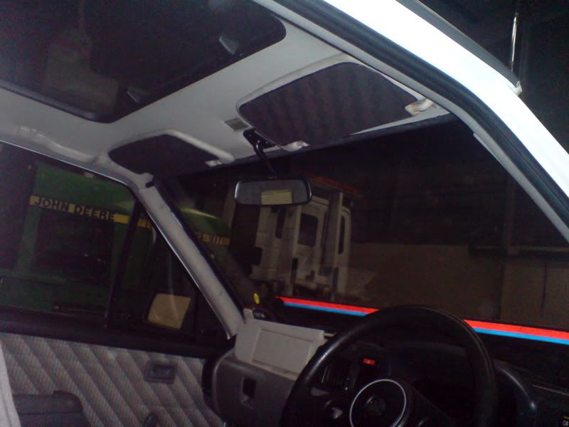

		got bored today, so fitted the visors
one on

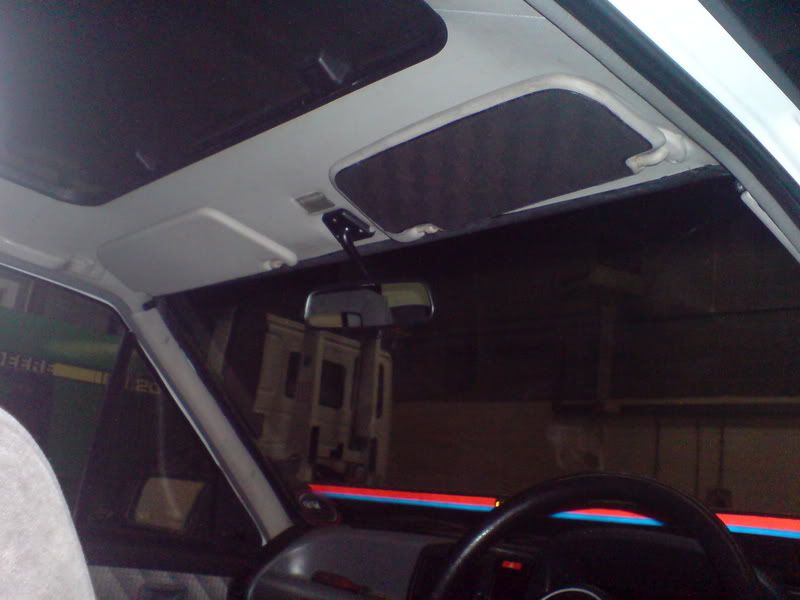

both on

big improvement imo, look factory too, and still has the zig zag pattern :thumb:
