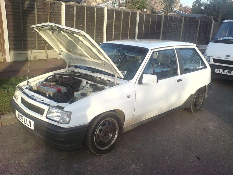

Recently I have, blown the headgasket, fixed it, had a ZLET Oil Pump fitted, welded on a hockley plating kit, painted bottom half of the bay, and painted some other bits and bobs, made some solid engine mounts, done Snetterton, destroyed my inlet manifold, had the inlet manifold fixed.

Got the engine back:
http://sphotos.ak.fbcdn.net/hphotos-..._3608888_n.jpg
Put it back in the hole, you can see the finished drivers side mount here, and my bling painted painted bits lol:
http://sphotos.ak.fbcdn.net/hphotos-..._2398229_n.jpg
