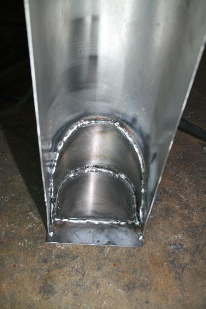

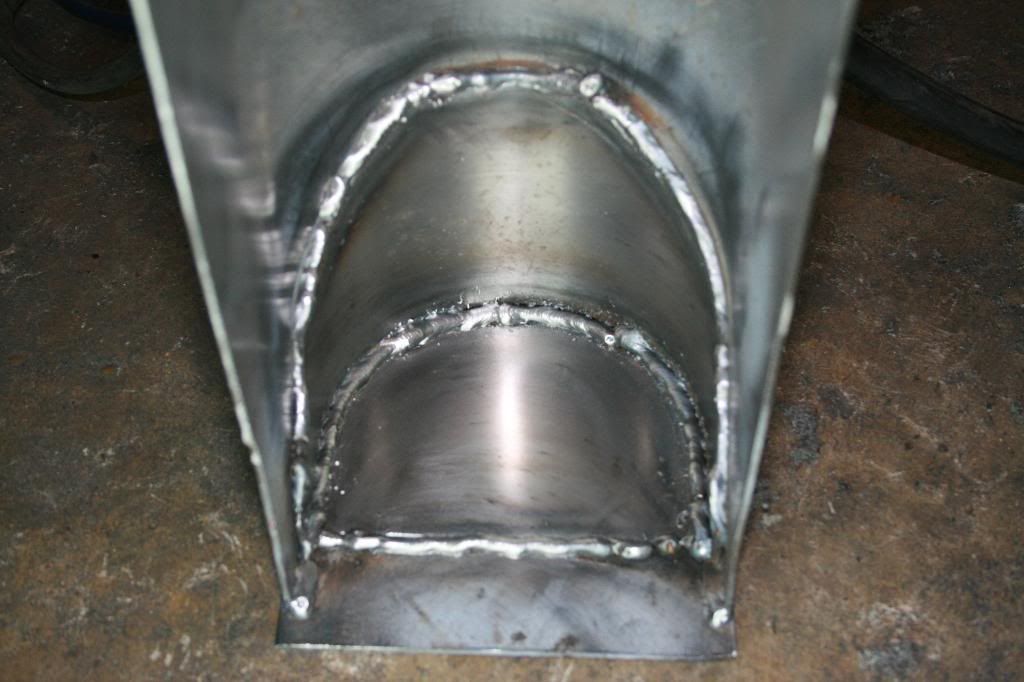

Looking good. Had a look at my Rally design escort turrets earlier and they use a similar gauge of steel to yours but have a double skinned top which is what you have done now.
Thanks for pointing that out Rick :thumb:Quote:
It further confirms my thoughts that the turrets needed something more unfortunately i don't have anything to compare mine to so had to just suck it and see before coming to an end result. I'll probably have to change them again but they don't call it a work in progress for nothing.
:thumb:Quote:
Perfect ;)
Glad you agree! Cheers again :thumb:Quote:
I will get you some decent close up pics of my rally design turret tops tomorrow if you want?
That would be spot on matey thanks!

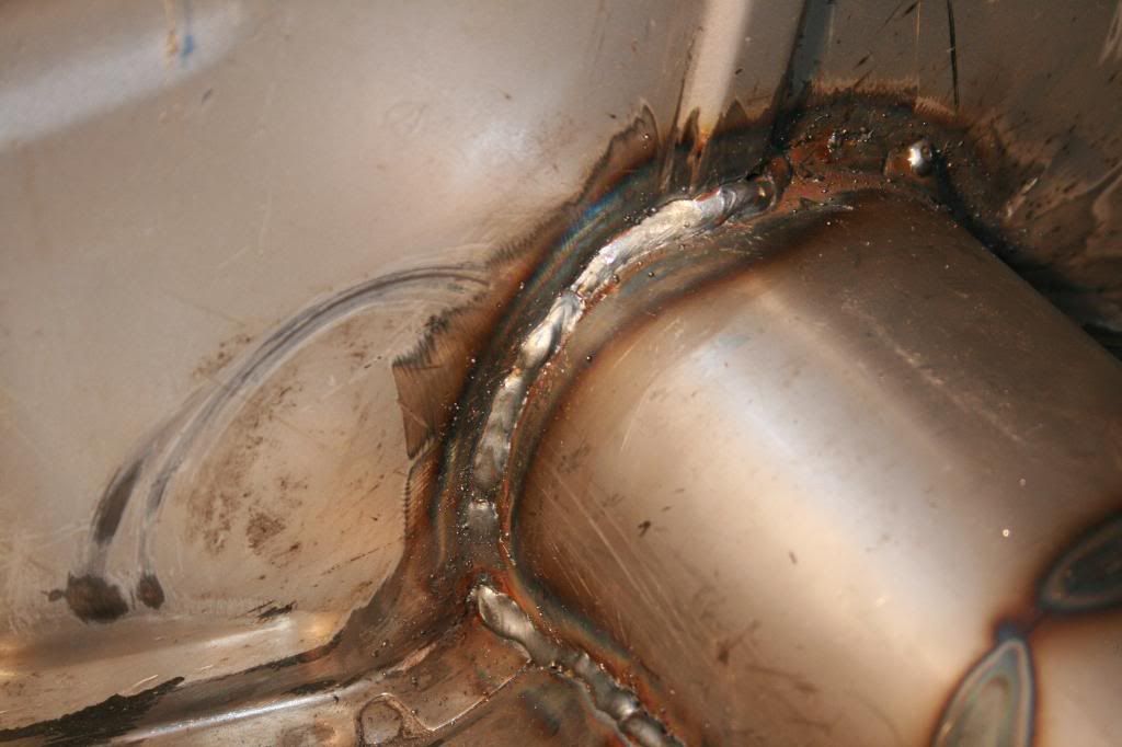

Anyway, some top progress, and some prefection welding pictureed there!!!
Cheers Mike :thumb:
whats stronger.
4mm plate or 2x2mm double skinned?
Depends which way you load/hit it I'd say, in the case of those turret tops you're gonna get a little more flex with 2x2mm, which means it'll hold up to a higher load for short lengths of time generally (you can probably stand on a riot shield and not be filled with confidence, but the way it flexes means bricks don't go straight through it) but if you loaded it up on a stress tester you'd probably get a lower break point compared to 4mm.
I'd say the 2x2 is more likely to bend/deform under use, but less likely to fail, unless the welds go from the flexing of the material around them, but they're probably stronger than the material itself lol
Here are some pics:
http://img.photobucket.com/albums/v4...r/CIMG3829.jpg
http://img.photobucket.com/albums/v4...r/CIMG3830.jpg
http://img.photobucket.com/albums/v4...r/CIMG3831.jpg
http://img.photobucket.com/albums/v4...r/CIMG3832.jpg
On second look the top plates welded in are twice the thickness of the first plate welded in to the top.
As said its a toss up depending on how you look at it....Quote:
Thanks for those Rick I'm satisfied that mine will be strong enough as they are esp once i have the cage etc mounted to the turrets.Quote:

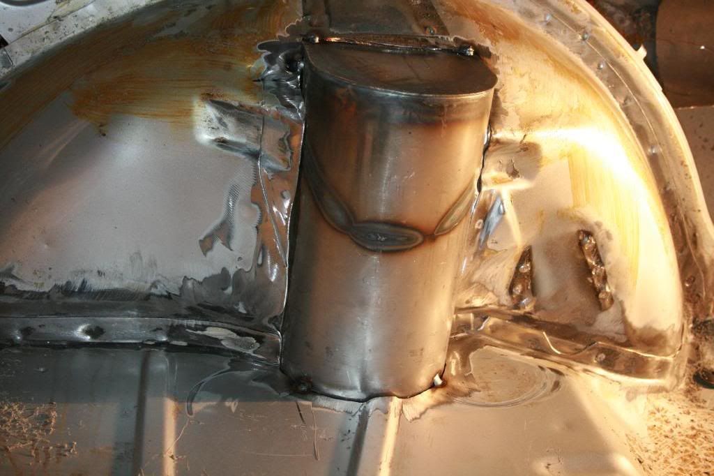

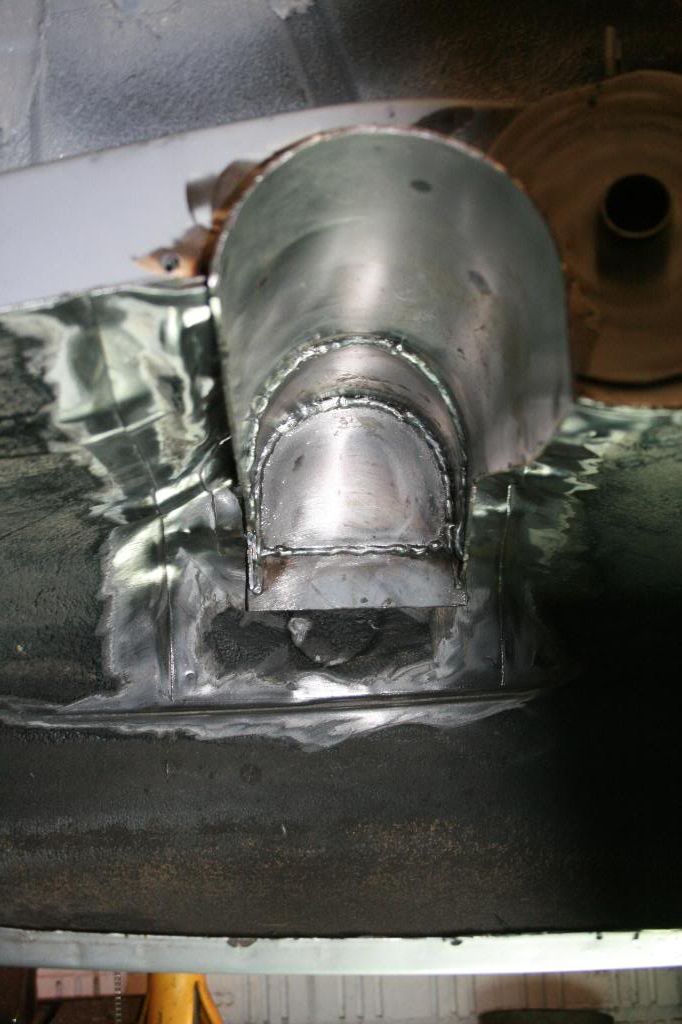

Evening peeps i've been on it again dealing with these turrets and after tonight's mincing i'm nearly there with only some tidying up left to do!!
I started out cleaning up the N/S turret ready to be made a permanent fixture of the shell
http://i248.photobucket.com/albums/g...urrets1082.jpg
http://i248.photobucket.com/albums/g...urrets1083.jpg

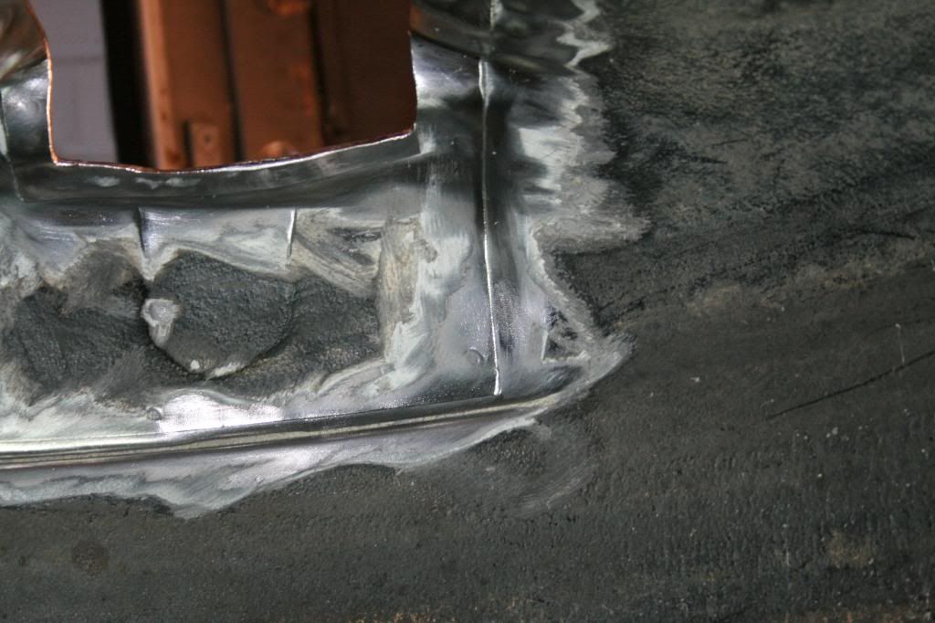

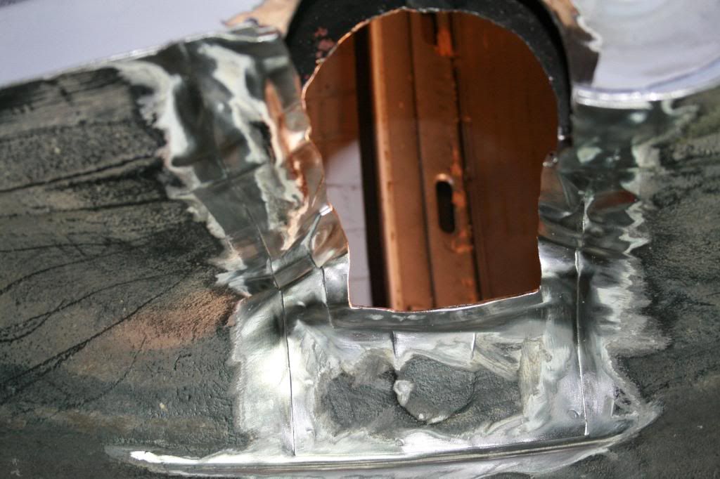

Then went on and cleaned off the funking under seal around the turret hole what a c u n t of a job that is
http://i248.photobucket.com/albums/g...urrets1086.jpg
http://i248.photobucket.com/albums/g...urrets1087.jpg

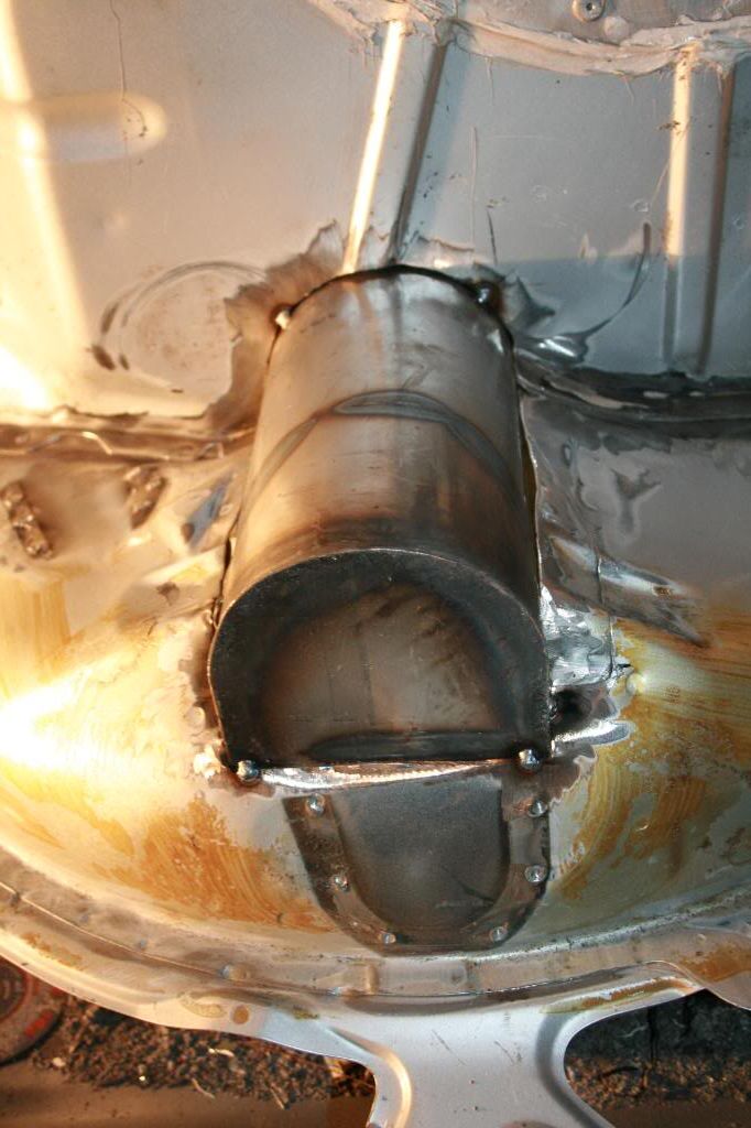

I cut the turret to size and fitted it up for the first time - some alterations to the hole were needed...
http://i248.photobucket.com/albums/g...urrets1088.jpg
Then after even more fettling (at least a hour!) i finally tacked the turret in
http://i248.photobucket.com/albums/g...urrets1091.jpg
http://i248.photobucket.com/albums/g...urrets1092.jpg

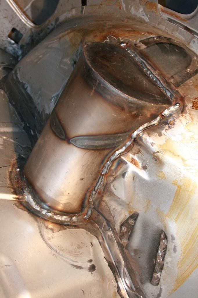

And welded it home for good - drop the bomb!
http://i248.photobucket.com/albums/g...urrets1102.jpg
http://i248.photobucket.com/albums/g...urrets1103.jpg
http://i248.photobucket.com/albums/g...urrets1104.jpg
http://i248.photobucket.com/albums/g...urrets1106.jpg
http://i248.photobucket.com/albums/g...urrets1107.jpg

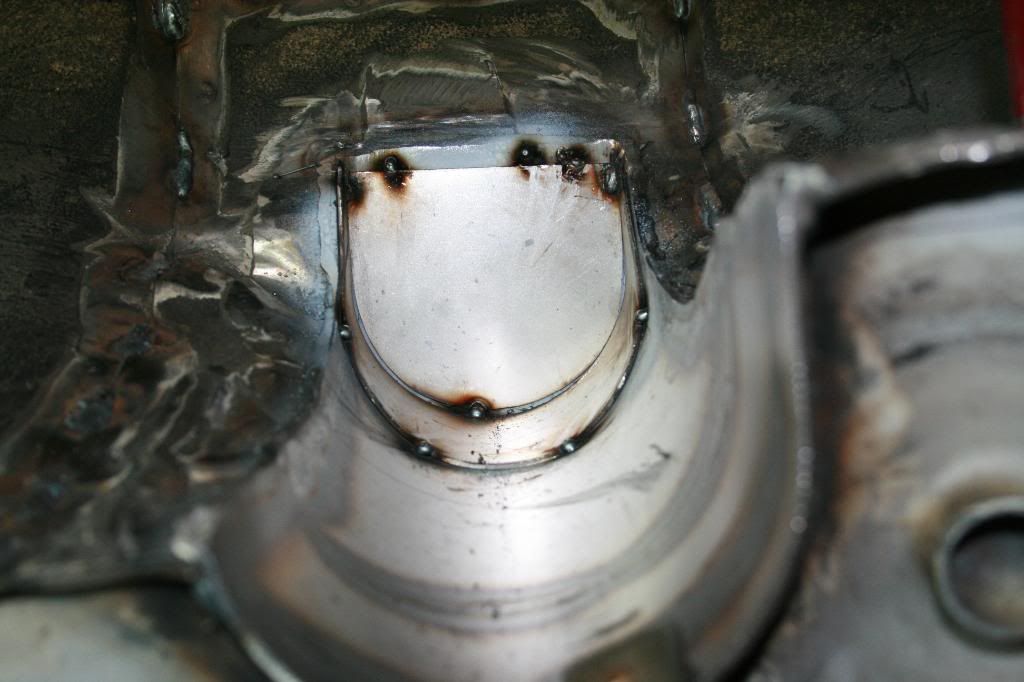

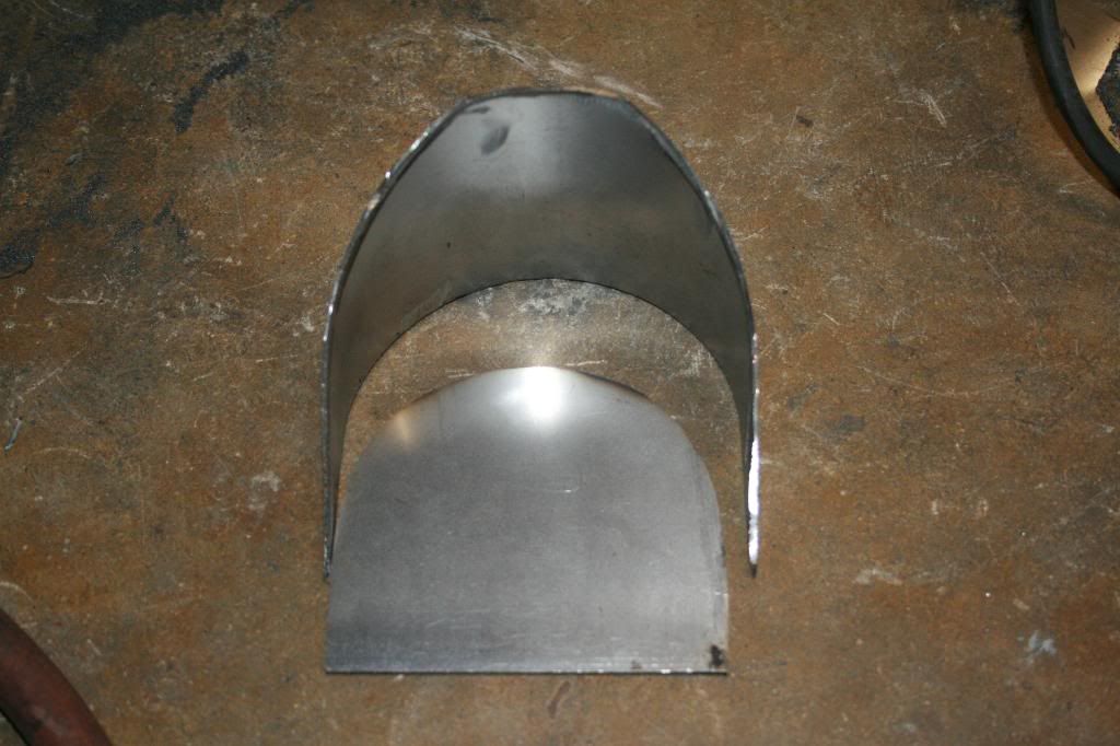

While i was waiting for the poor welded to cool off i decided i would make up the strengthening plates for the other turrets in the same way as before
http://i248.photobucket.com/albums/g...urrets1093.jpg

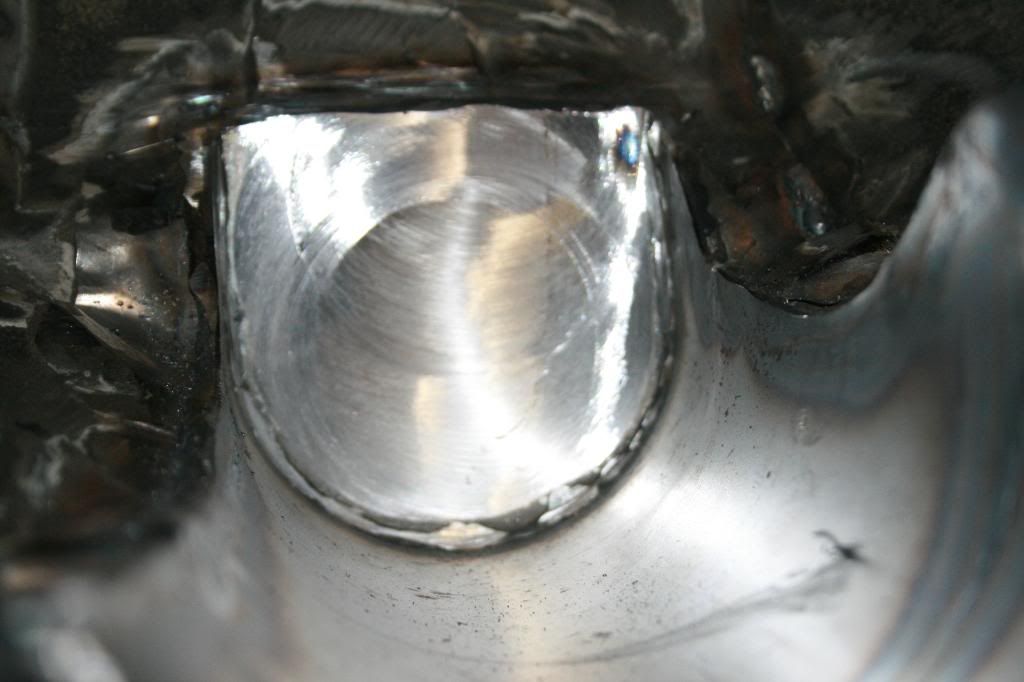

Then i cleaned up the inside of the first turret on the O/S ready for the plates
http://i248.photobucket.com/albums/g...urrets1094.jpg
Primed, fitted and tacked the plated in to position
http://i248.photobucket.com/albums/g...urrets1097.jpg
Wow some cracking workmenship going into this now :thumb:
Looks soild welding on the struts. How many hours did it take to get all aligned up and tacted into place? Between the welder nearly on melt down :D

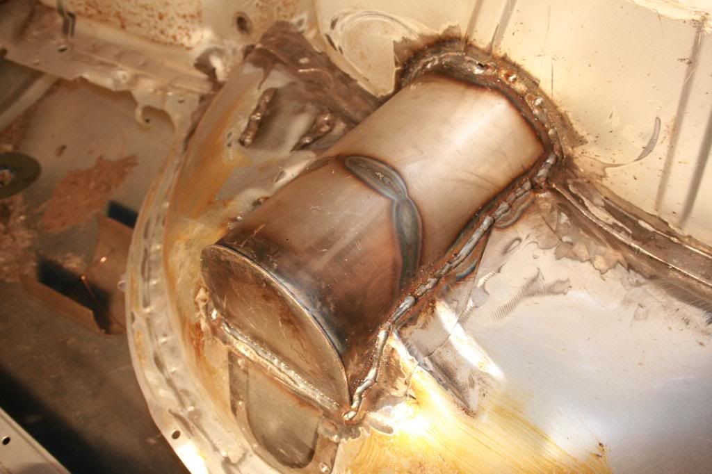

I then moved back to the N/S to continue welding the turret in
http://i248.photobucket.com/albums/g...urrets1111.jpg
http://i248.photobucket.com/albums/g...urrets1114.jpg
As you can see in the pic below there is still a fare bit of material that needs to be removed once i have welded the turret in from the inner arch side (i still have this to do)
http://i248.photobucket.com/albums/g...urrets1115.jpg

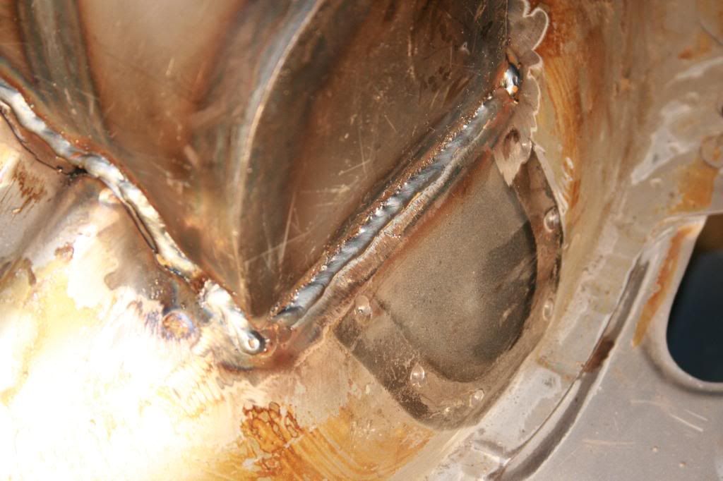

Once the welder was ready to go again i finished off the turret plates on the O/S
http://i248.photobucket.com/albums/g...urrets1120.jpg
http://i248.photobucket.com/albums/g...urrets1121.jpg

I do know one thing...that is some top notch fabrication skills on show there. Good work.
Why thanks...to get them aligned up and tacked in to place it must of taken 10 hours! And it will probably be nearly 20 hours all in but they have come out well IMO so i'm happy :thumb:Quote:

gonna be a shame to cover up them welds with seam sealer! I've told you before tho - you need to slow down, you're putting too many of us to shame!!
are the strips for taggin in the cage to the shell?
I may not cover the welds inside the car yet (more weight lol) i might just paint them with everything else. I can't help myself as far as progress is concerned, i would still be out there if it wasn't for the neighbours!Quote:
