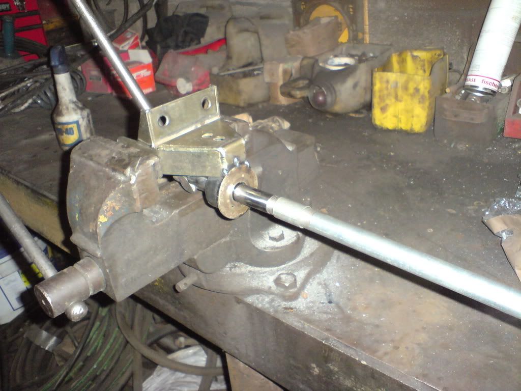

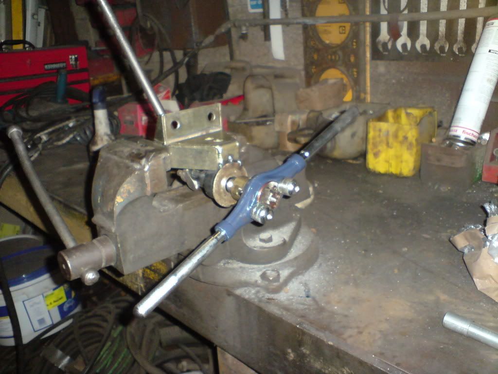

Started to sort the connections for the gear lever connecting rod. Firstly I got a die out and created a threaded end on the gear lever assembly
http://i205.photobucket.com/albums/b...april08001.jpg

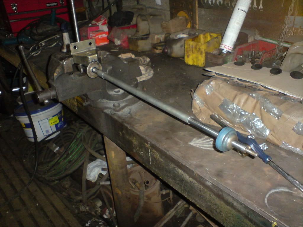

When that was done I then attached the connecting rod which is galvanised steel electrical conduit using a threaded joiner
http://i205.photobucket.com/albums/b...april08002.jpg

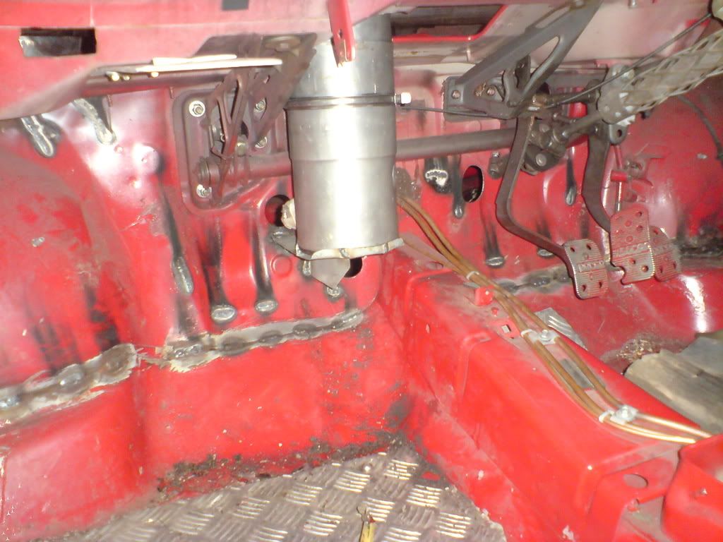

This fits nicely over the shock absorber piston rod
http://i205.photobucket.com/albums/b...april08003.jpg

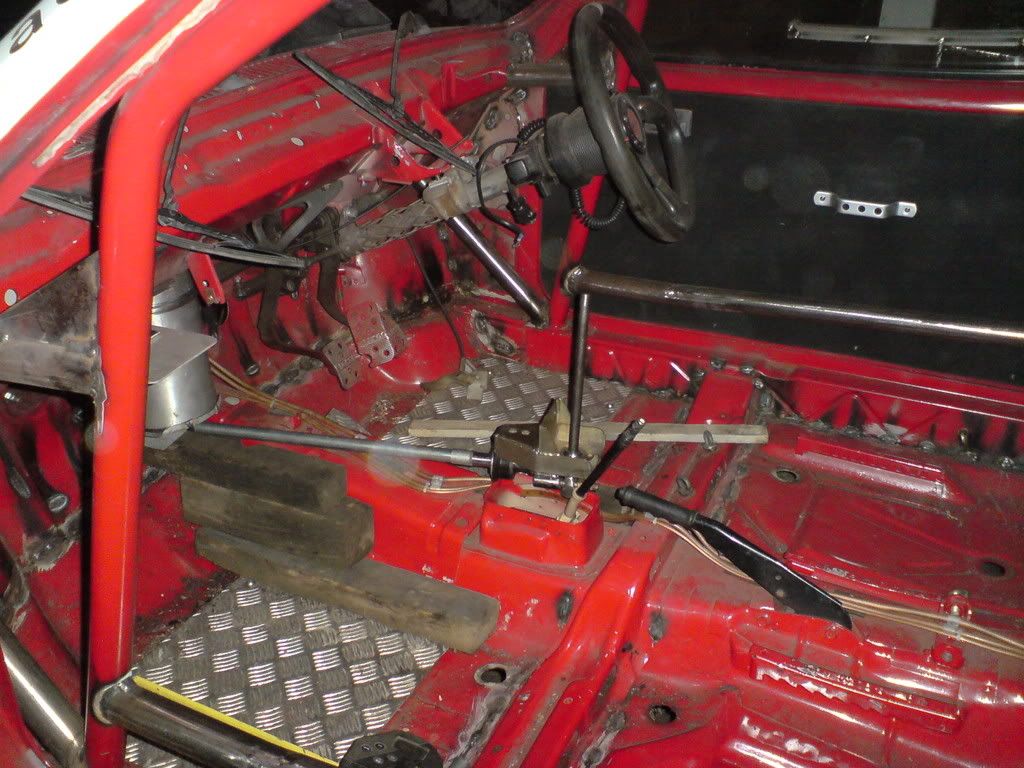

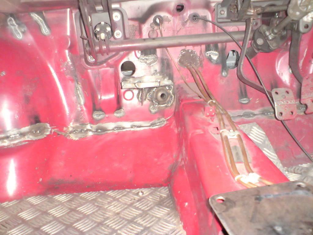

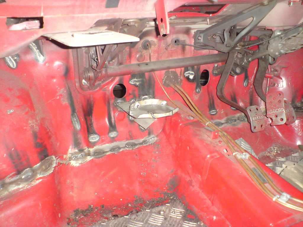

Next I mocked it up in the car with the existing standard gear lever still in place to show how much thinkgs are going to change
http://i205.photobucket.com/albums/b...april08007.jpg
http://i205.photobucket.com/albums/b...april08008.jpg
