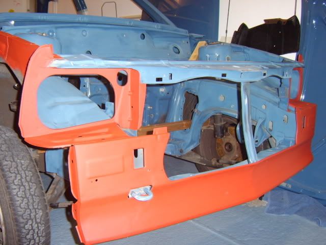

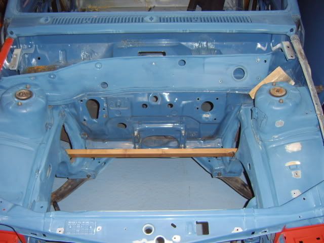

Progress this week seems slow and un-rewarding.

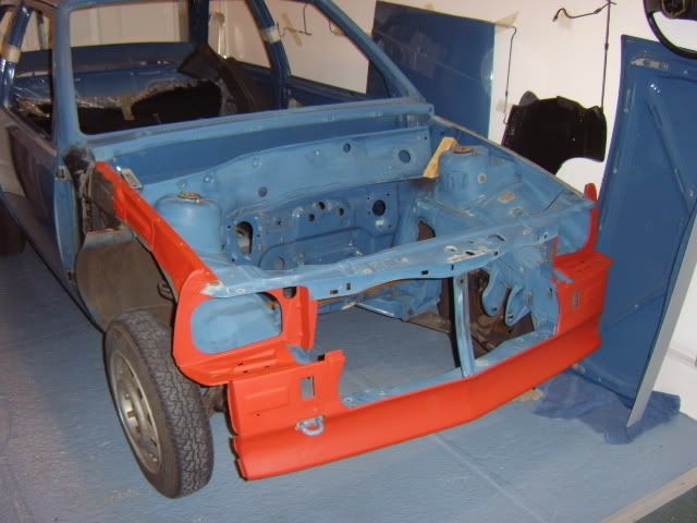

So far I have rubbed down the roof, A & C pillars, scuttle panel, front panel and inner wings. The engine bay work is killing me at the moment, but want to get it over and done with as soon as. Just got the Bulkhead to do then it's back to flat panel preperation. All areas with any sign of surface rust or cracks in the paint are being taken back to bare metal.
http://i73.photobucket.com/albums/i2...STA60052-4.jpg
http://i73.photobucket.com/albums/i2...STA60051-5.jpg
http://i73.photobucket.com/albums/i2...STA60050-5.jpg
I knew the car had some front end damage, but only once I dug out quite a lot of filler on the front panel did I realise the extent of it. All areas on the front panel which have now had 5 coats of red-oxide were stripped back to bare metal. The damage was more over a large area than to an excessive depth. But as I am fitting the lower valance this will be unseen, so I'm not going to smooth it all back over.

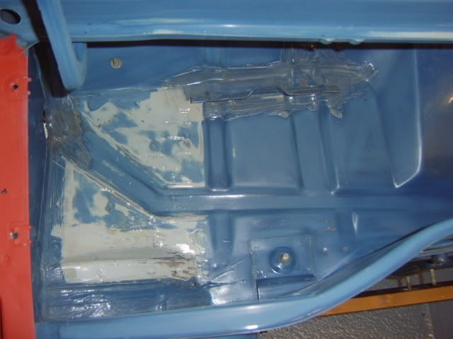

Today, tackled the battery tray. Removed the tar like sound deadening stuff along with some of the seam sealer revealing no rust as hoped.
Before:
http://i73.photobucket.com/albums/i2...l/STA60051.jpg
After:
http://i73.photobucket.com/albums/i2...STA60049-6.jpg

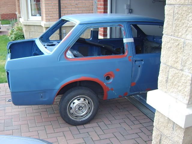

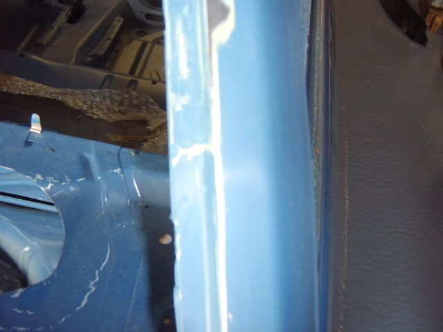

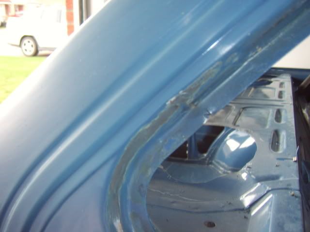

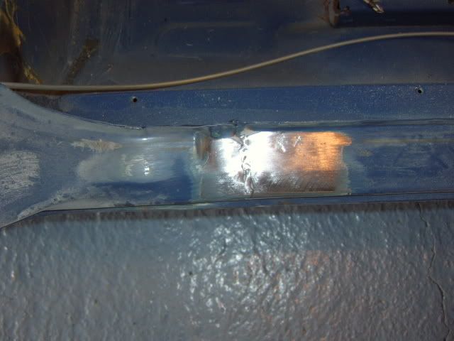

Next job was to sort the small patches of rust on the offside, a few bubbles on the bottom edge of the door, thankfully nothing serious, but a few on the sill which concerned me before I starting digging. I knew that the car had had a few accidents, but my findings today showed the extent of this. The full off-side quarter panel has been replaced at once stage of it's life.
The C-pillar:
http://i73.photobucket.com/albums/i2...STA60051-6.jpg
http://i73.photobucket.com/albums/i2...STA60052-5.jpg
The sill where the rust was:
http://i73.photobucket.com/albums/i2...STA60053-3.jpg

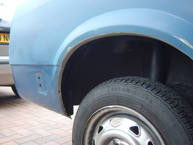

Then on to the quarter panel:
http://i73.photobucket.com/albums/i2...STA60054-3.jpg
Arch lip returned to bare metal, no rust:
http://i73.photobucket.com/albums/i2...STA60055-3.jpg
http://i73.photobucket.com/albums/i2...STA60056-4.jpg
And a coat of red-oxide:
http://i73.photobucket.com/albums/i2...STA60057-1.jpg
