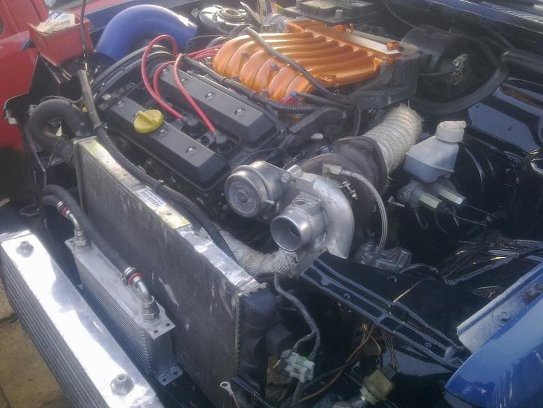

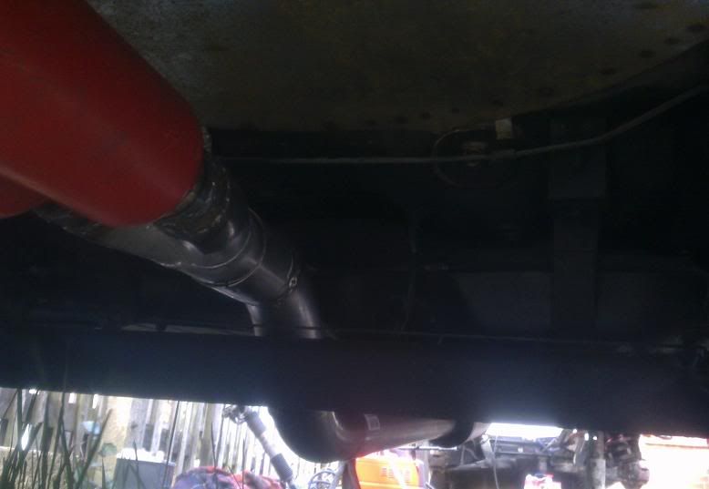

well its about ready to run, should fire tomorrow i think although we still waiting for the intercooler piping to finish it.
We made up some oil cooler pipes and turbo oil feed pipes, thats now all finished too, all wiring and fueling completed, 3" downpipe onto a 3" exhaust system into 2x 2-1/8" back boxes
http://img.photobucket.com/albums/v8...e/novav6t4.jpg
http://img.photobucket.com/albums/v8...e/novav6t3.jpg
http://img.photobucket.com/albums/v8...e/novav6t5.jpg
EPIC, top project :thumb:
You've prob got this in mind already but turbo's obviously give off a hell of a lot of heat, some of the wiring in the pic looks quite close so are you going to shield it?
