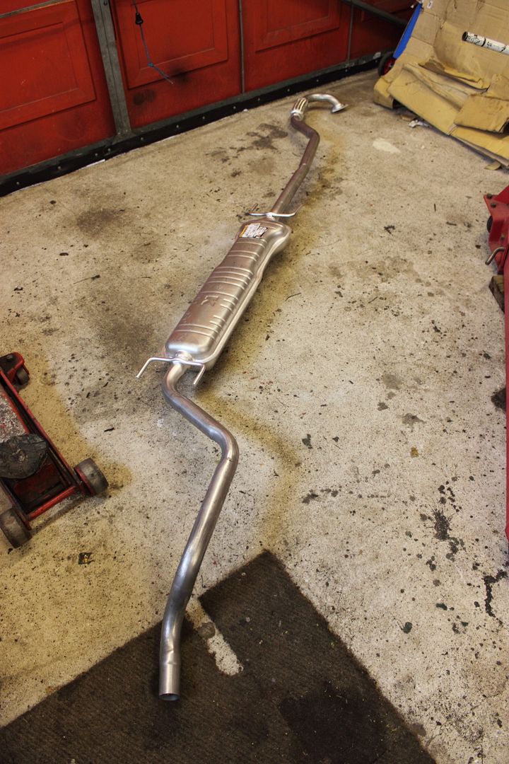

The new exhaust got a coat of VHT paint on the welds just to make it last a bit longer .....

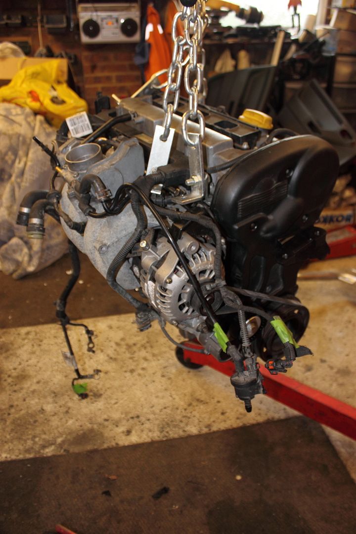

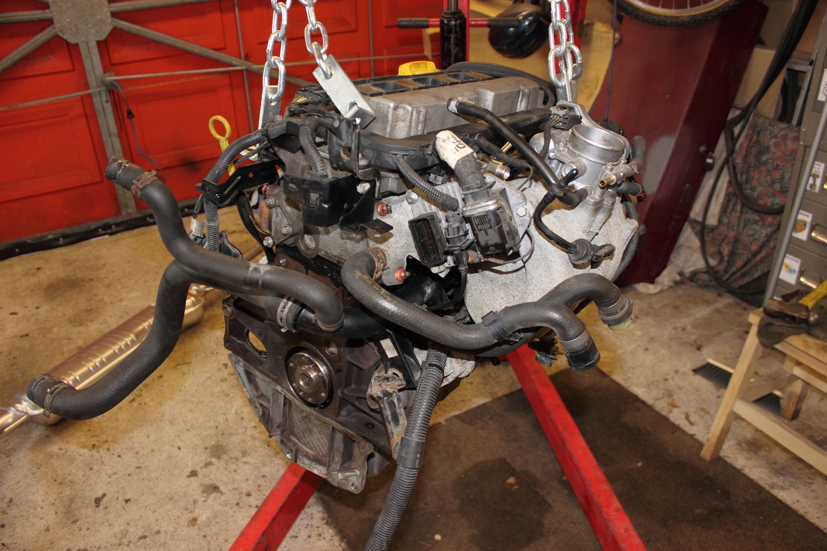

Got busy putting the injectors back in and then the loom and ECU back in place - a bit fiddly in places but we got there in the end ....
http://i2.photobucket.com/albums/y15...a/Z18XE097.jpg
http://i2.photobucket.com/albums/y15...a/Z18XE096.jpg

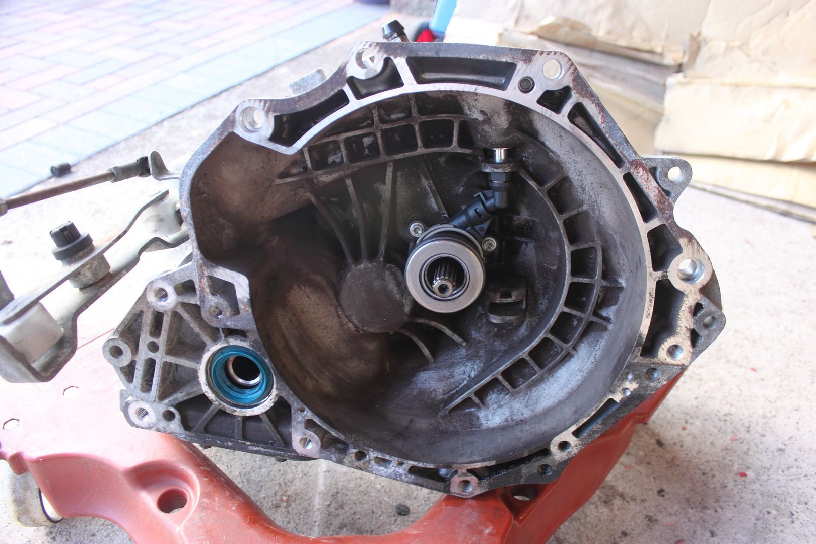

Took the opportunity to remove all the oil from the gearbox by removing the diff plate . Then cleaned everything thing up ready to reseal with a new gasket ....
http://i2.photobucket.com/albums/y15...a/Z18XE100.jpg
Also put in a new slave cylinder in and changed the driveshaft seals whilst I was there.....

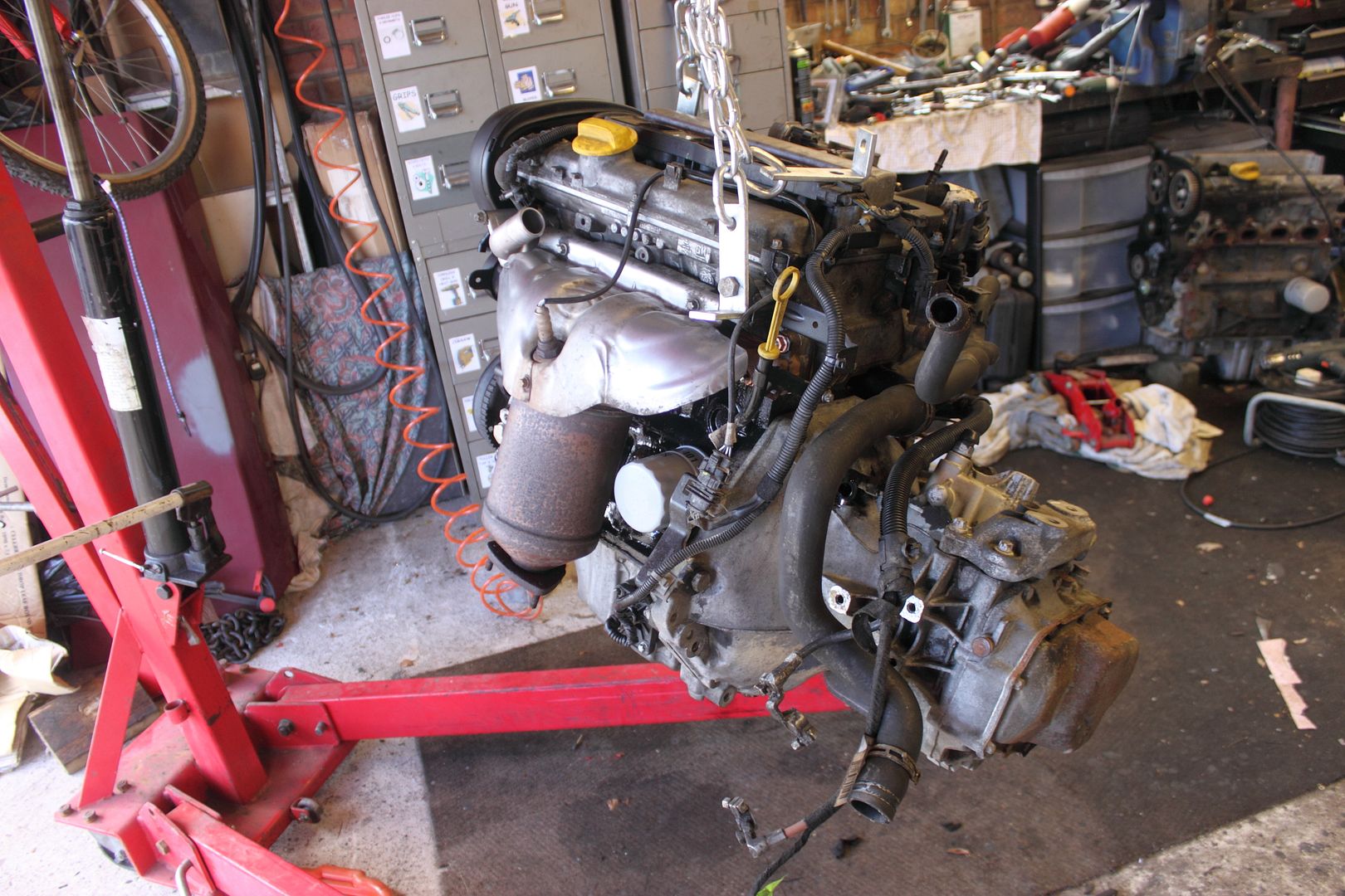

Got the gearbox mounted up to the block .....
http://i2.photobucket.com/albums/y15...a/Z18XE102.jpg

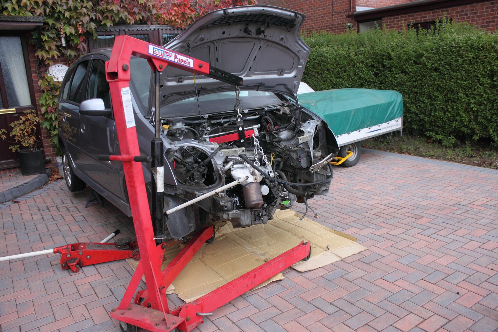

And then craned outside to the car.....
http://i2.photobucket.com/albums/y15...a/Z18XE103.jpg
http://i2.photobucket.com/albums/y15...a/Z18XE104.jpg

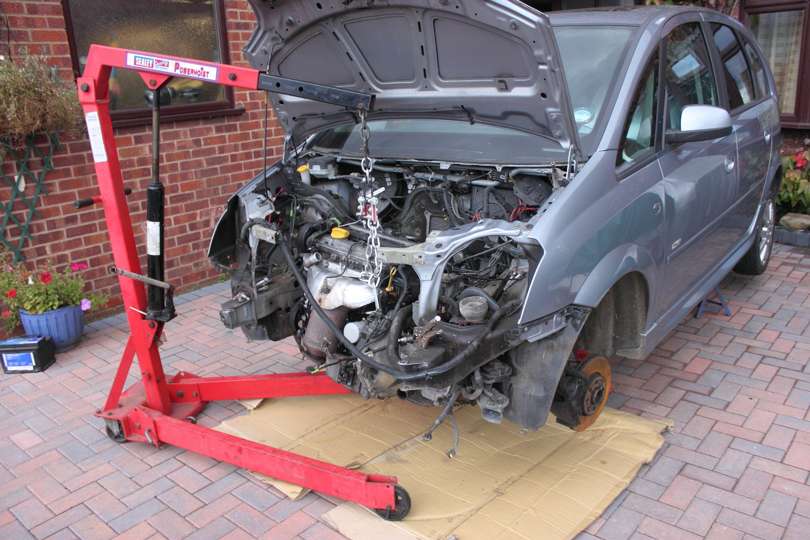

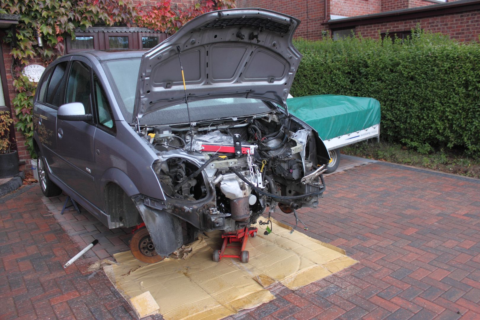

Bearing in mind I was on my own and rushing a bit because it looked like rain, the block was in and installed within 20 minutes !
http://i2.photobucket.com/albums/y15...a/Z18XE105.jpg
Now sitting on the main mounts and this is where I called it a day due to the rain!
Forecast looks better for tomorrow so will crack on with the engine bed and exhaust.

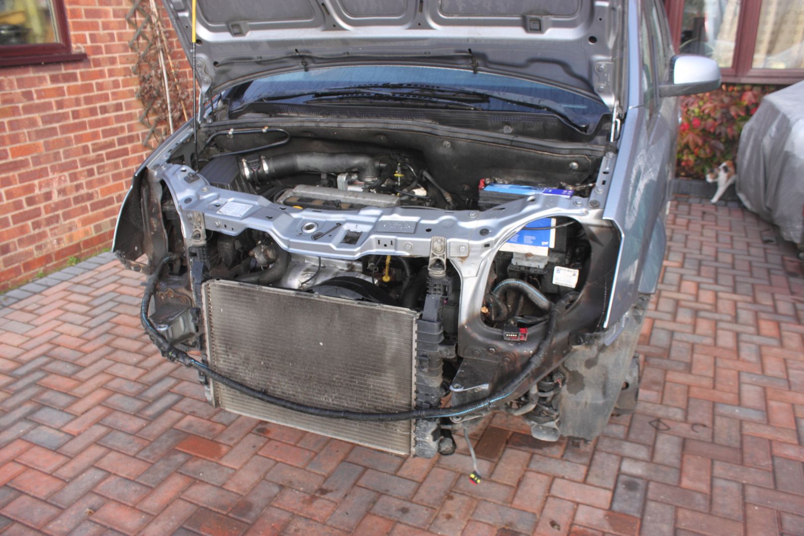

Got the engine bed round to the car, and with the aid of two jacks finally got it in position. This took longer than getting the engine in ! . It was the angle of the steering rack shaft that was causing problems .....
http://i2.photobucket.com/albums/y15...a/Z18XE108.jpg

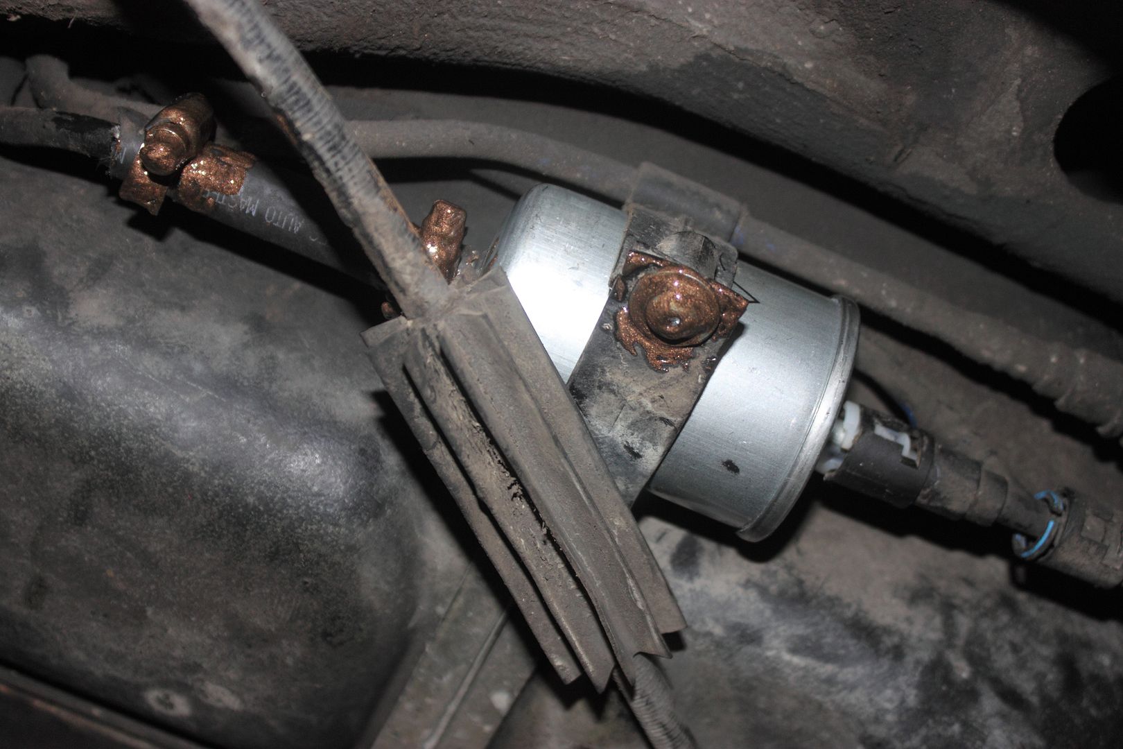

Then got the fuel filter changed. The stupid connector on one side , decided to totally disintegrate which was handy. I had to splice in a bit of pipe which was more of an annoyance than anything ....
http://i2.photobucket.com/albums/y15...a/Z18XE116.jpg

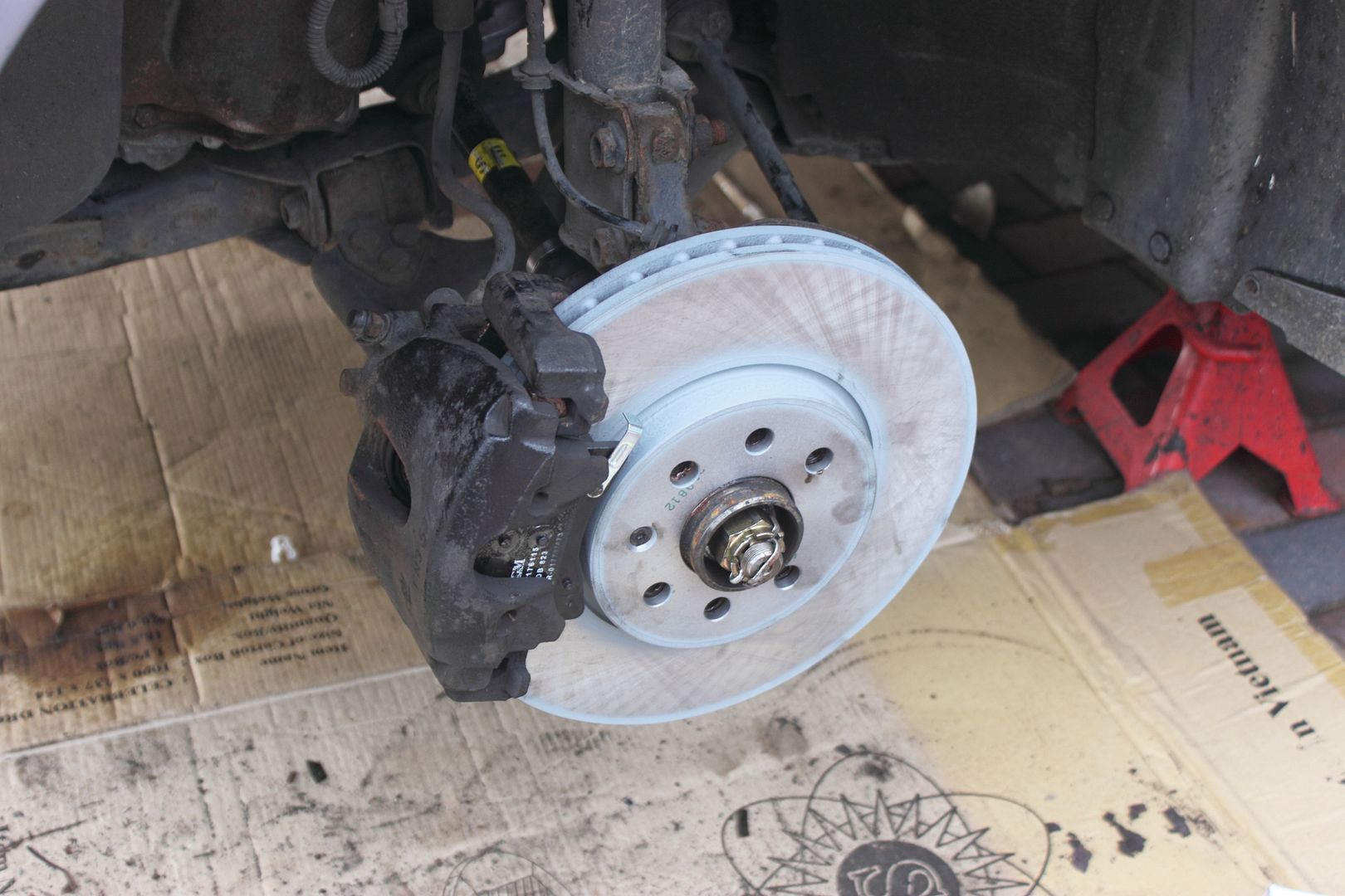

Got all the driveshafts put in and a new set of discs and pads from Vauxhall on trade club ....
http://i2.photobucket.com/albums/y15...a/Z18XE113.jpg
http://i2.photobucket.com/albums/y15...a/Z18XE115.jpg
