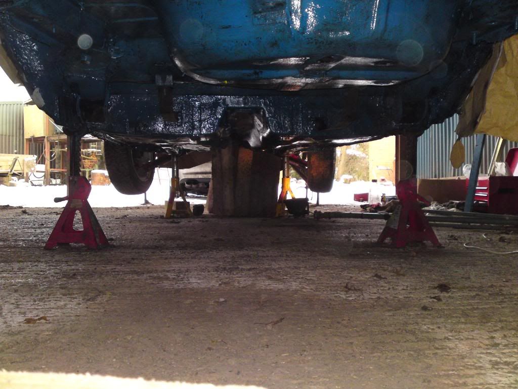

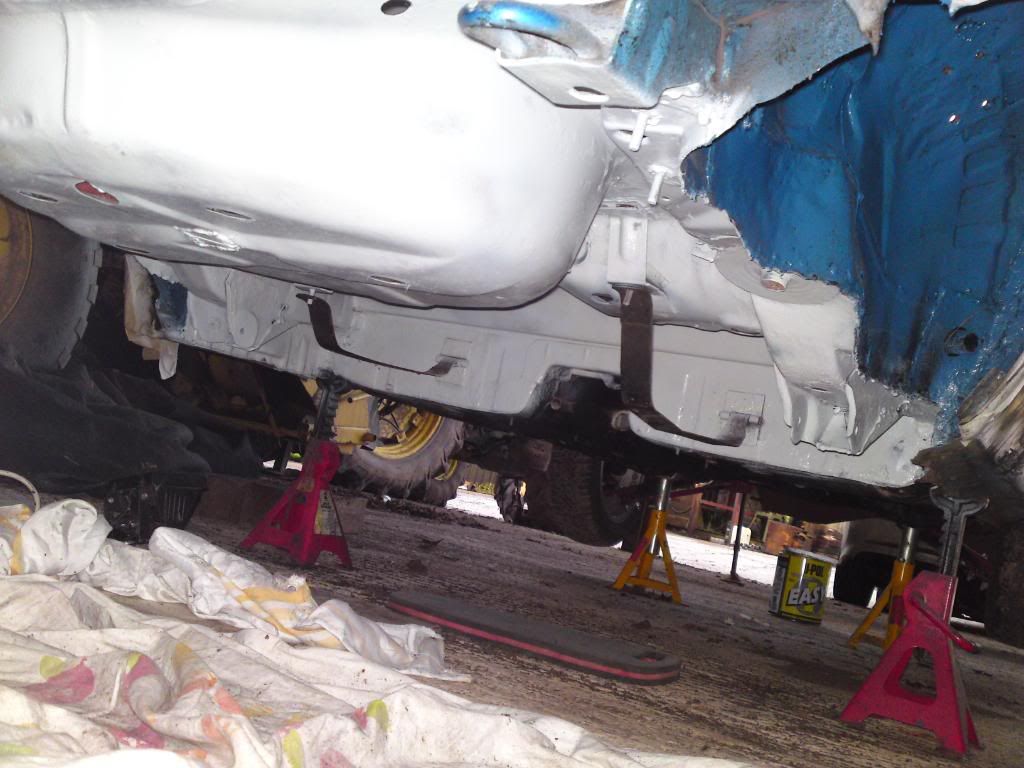

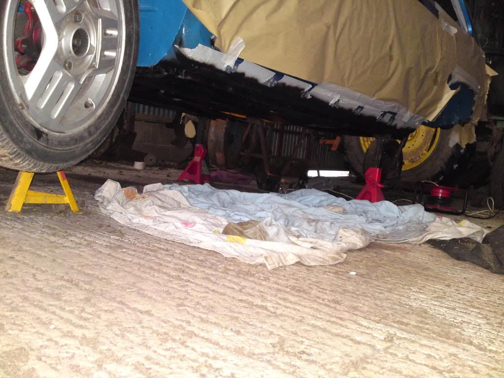

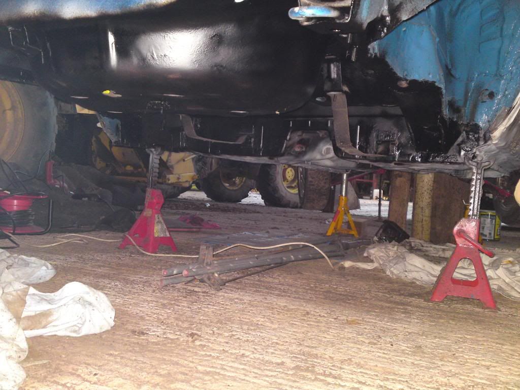

todays update, finished off undersealing the car. also did the lower half of the sill too. this is the first coat.
http://i193.photobucket.com/albums/z...DSC02636-1.jpg
http://i193.photobucket.com/albums/z...DSC02638-1.jpg

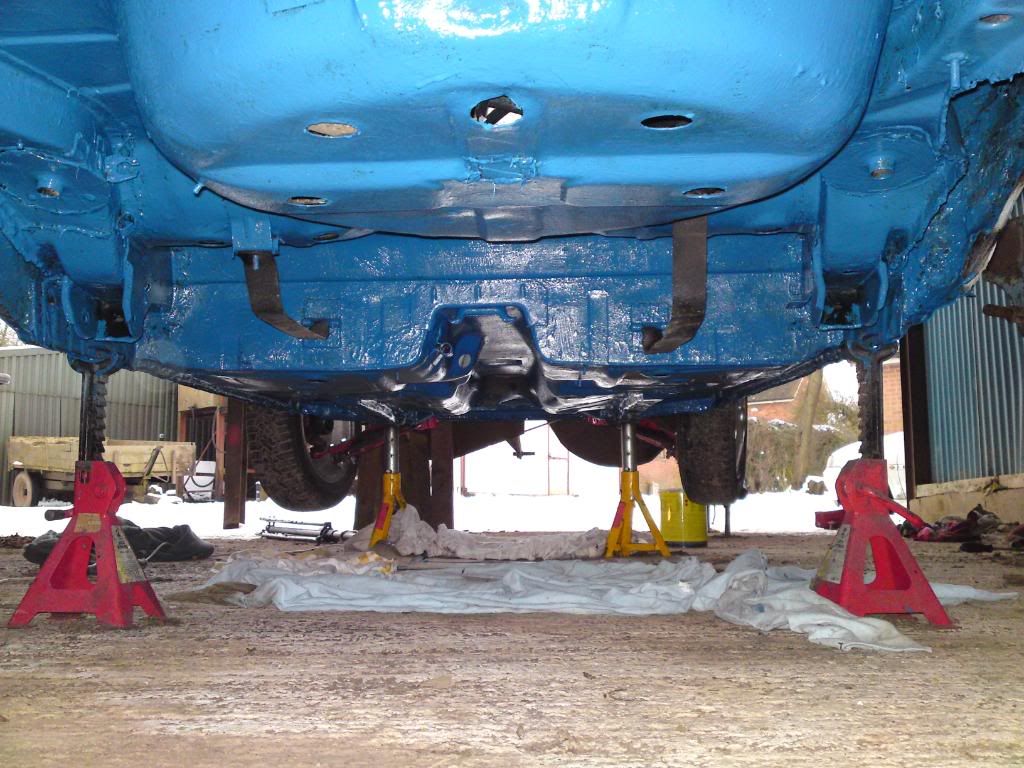

then gave it the first coat of hammerite, took soooo long. will be doing another coat tomorrow, depending if it snows or not.
http://i193.photobucket.com/albums/z...8/DSC02641.jpg

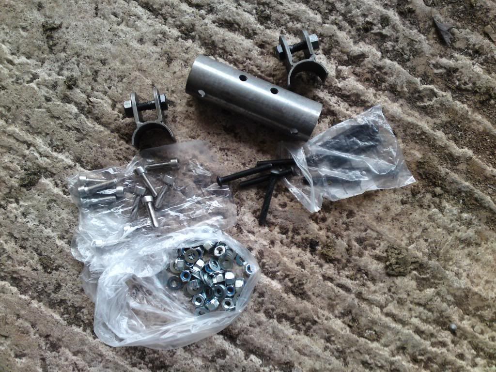

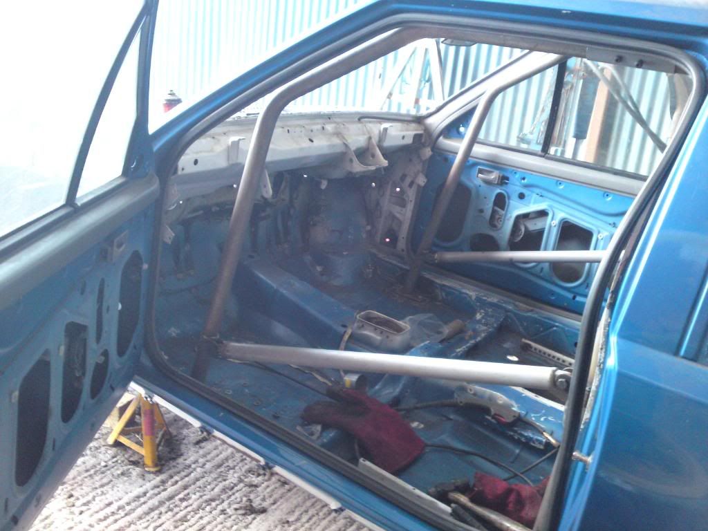

bought the rest of the parts i need to finish off my cage. one sleeve, 2 door bar brackets, some more stainless cap head bolts and some button headed allen bolts
http://i193.photobucket.com/albums/z...8/DSC02640.jpg

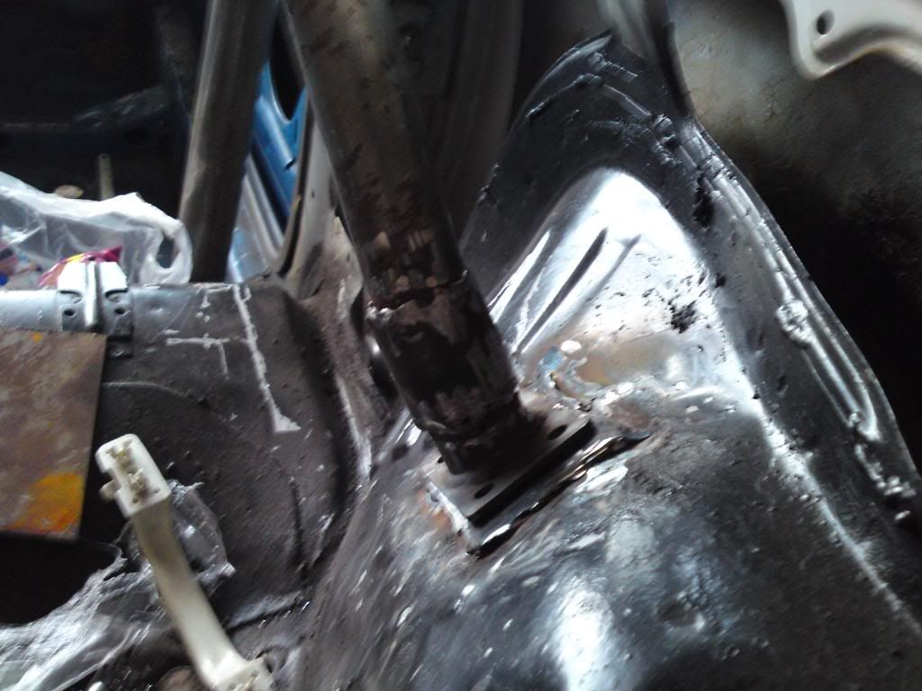

positioned the door bars in place, cut them to length and welded them all on.
http://i193.photobucket.com/albums/z...8/DSC02642.jpg

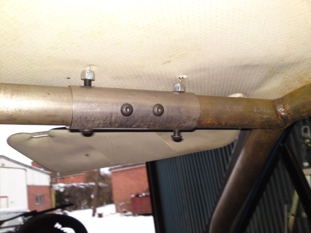

then onto where i cut the front section in half, put the sleeve on and punched where the holes should be. drilled them out and bolted it up.
http://i193.photobucket.com/albums/z...8/DSC02643.jpg

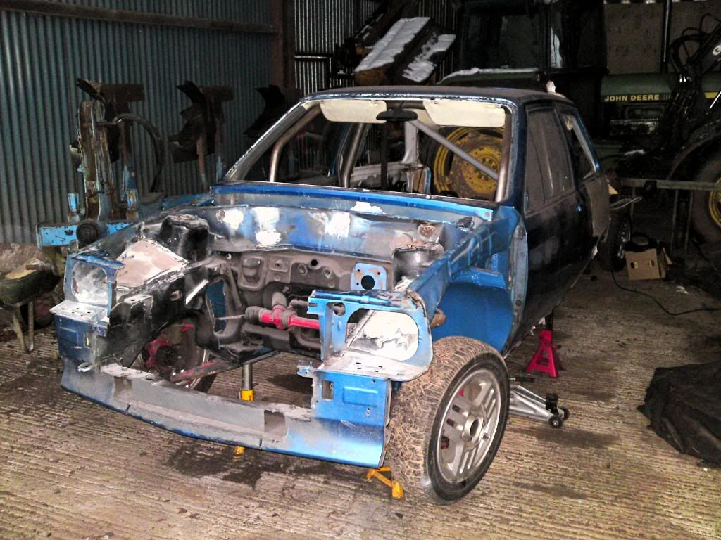

current state of the car, still looking sorry for its self.
http://i193.photobucket.com/albums/z...8/DSC02648.jpg
will be taking the car back to my garage in the next week or so. hopefully get some bodywork done before i do.

What underseal did you use? Didn't think you could paint over the usual gooey stuff.
You can but it takes a good few coats.
im using an underseal made by comma. dries matt black and has a rubbery texture to it. great stuff. theres a picture of the can a few pages back.

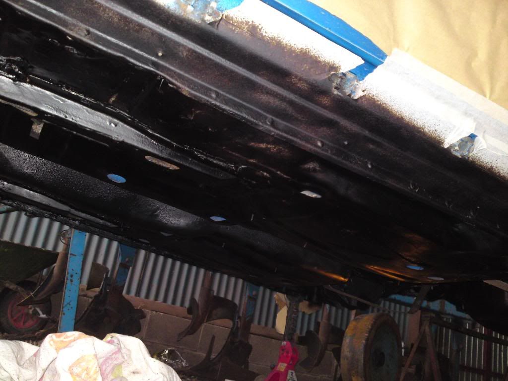

managed to get out to the car again today, so put another coat of hammerite on underneigth. gave it a hoover and general tidy up awell. hopefully look like a car again sometime.
http://i193.photobucket.com/albums/z...8/DSC02652.jpg
Good times, are you giving it a 3rd coat?
unfortunately yes, takes about 2hrs to do and almost the whole can(750ml) of hammerite. so got to get another can.

gave the underside another coat of hammerite, should be enough i reckon.

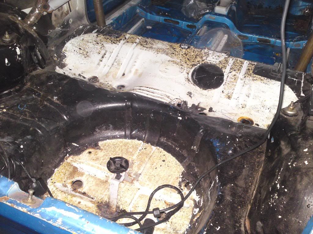

then proceeded with stripping off the soundeadening from inside the car. came up easy with a heat gun.
http://i193.photobucket.com/albums/z...8/DSC02657.jpg

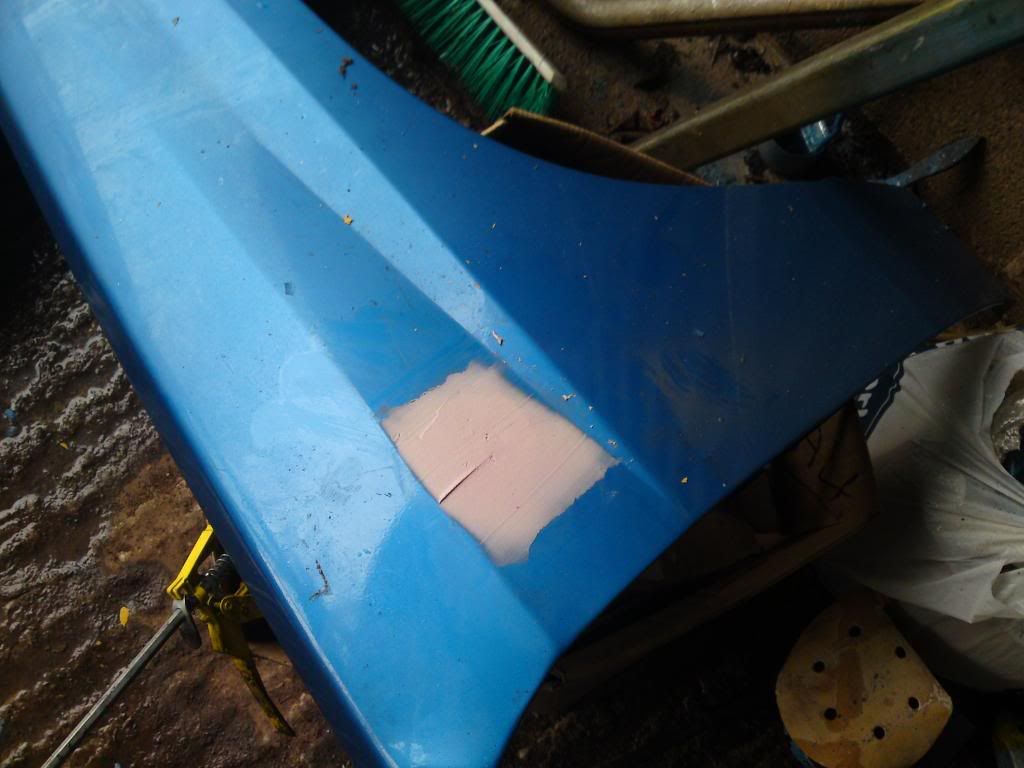

with not much else that i could be bothered with, i welded up the indicator hole on the o/s wing. gave it a little filler.
