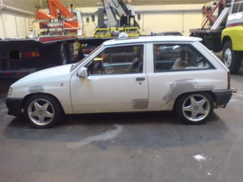

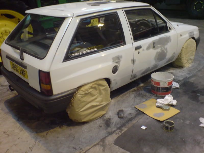

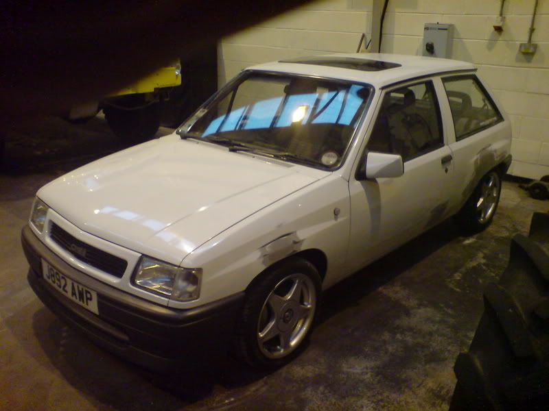

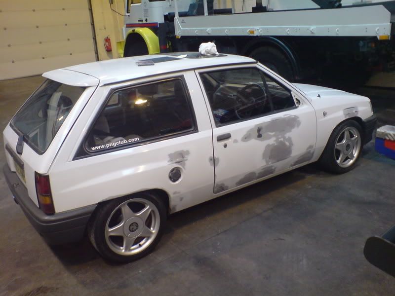

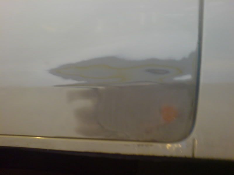

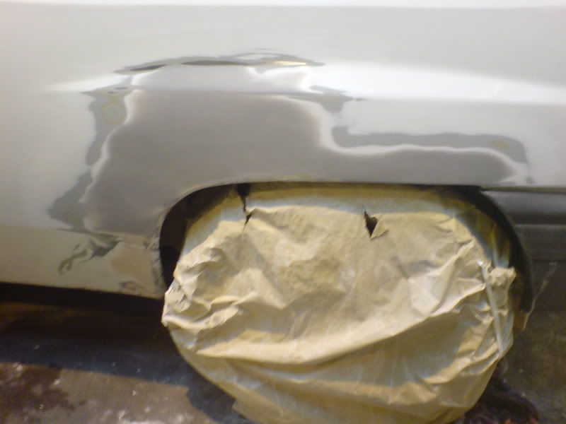

final update before spraying..
all prepped now, metallic filler added to all treated areas to minimize the chance of rust returning, all sanded sown lovely and smooth, took us 3 or 4 times to get the drivers door perfect, but other than that 110% happy with the results. hopefully getting sprayed next week or mabey even this week.. so watch for updates
the nova looking sorry for itself but 100x better than before lol

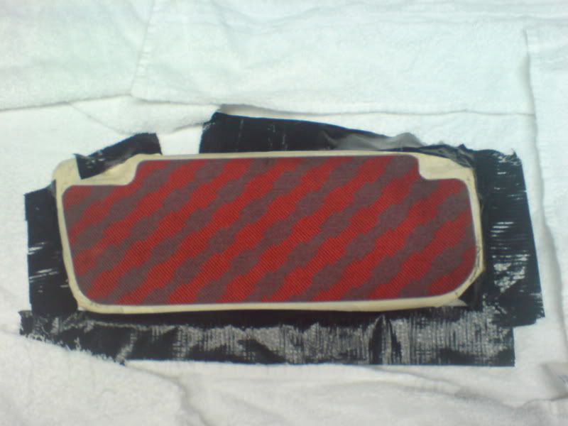

right.. im mega bored over these holidays seen as i cant even drive the nova because it needs to pe clean as funk for spraying, so today i kep myself occupied
rummaging through some old boxes, i found some red sr sun visors, thought id do something with them.
quick mask off..
http://i61.photobucket.com/albums/h8...DSC00425-1.jpg
trip to halfords for some black spray paint
quick blast
http://i61.photobucket.com/albums/h8...x/DSC00426.jpg
left to dry for 2-4 hours
http://i61.photobucket.com/albums/h8...x/DSC00427.jpg
http://i61.photobucket.com/albums/h8...DSC00428-2.jpg
touched up round the edges with a mini brush
http://i61.photobucket.com/albums/h8...DSC00429-1.jpg
http://i61.photobucket.com/albums/h8...x/DSC00430.jpg
:thumb: finito! should look mint in the nova

have you used cellulose putty on the filled sections?
If not I'd recommend giving it a skim. Filler (even the "metal" stuff) will have trapped bubbles in it when mixing - when you sanded it down these micro bubbles will come to the surface. You cant really see them - until you paint the car - then they appear like little pin holes! Even through primer.
Give it a quick skim of cellulose putty to seal the filler - smooth back with 800 grit and then your ready to paint - will save you lots of agro in the long run.
