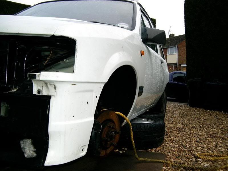

I do however still want to lower the car moreso, without scrubbage and the like - so I'm on lookout for some 4/5 door / saloon front wings so they're round and I can get them flaired.
Was wondering how they'd look, but to be honest I'm not fussed...

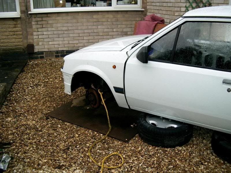

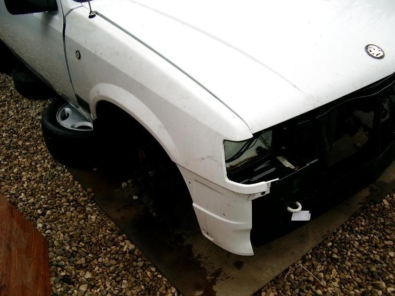

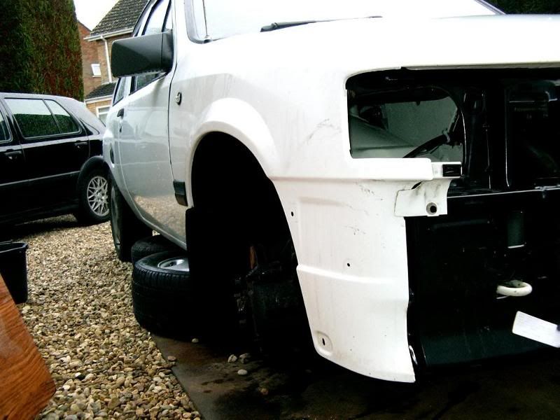

When I had my white Nova and I crashed it, I bought some 5 door front wings not knowing they were different back then... here are some pics...
http://i136.photobucket.com/albums/q...ure/Ragga5.jpg
http://i136.photobucket.com/albums/q...ure/Ragga4.jpg
http://i136.photobucket.com/albums/q...ure/Ragga2.jpg
http://i136.photobucket.com/albums/q...ure/Ragga1.jpg
Obviously a full side on photo would have been better, lol, but the car wasn't at it most photogenic back then lol

Front wings wont be standard, the vertical piece will be pulled out to match the 45degree angle
Might look euro, but thats not the look I'm aiming for

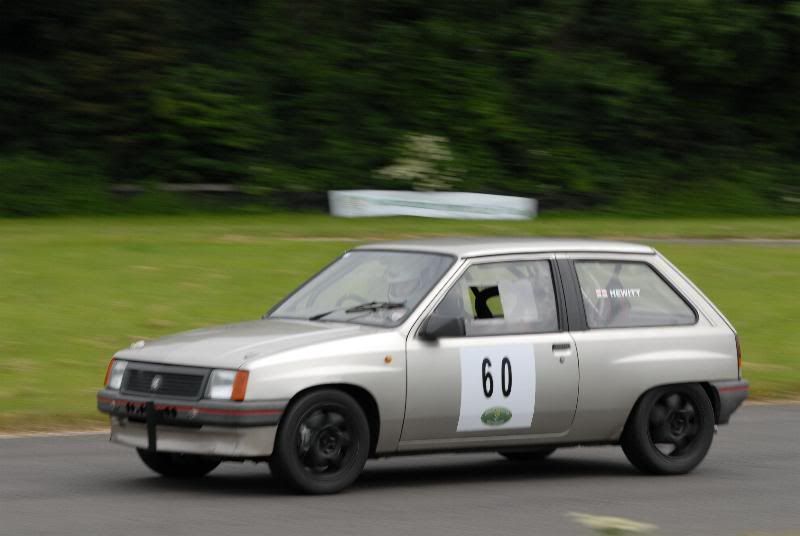

This is with your old 90mms
http://i136.photobucket.com/albums/q...ure/Bobb01.jpg
and I won't be going any lower than this.
