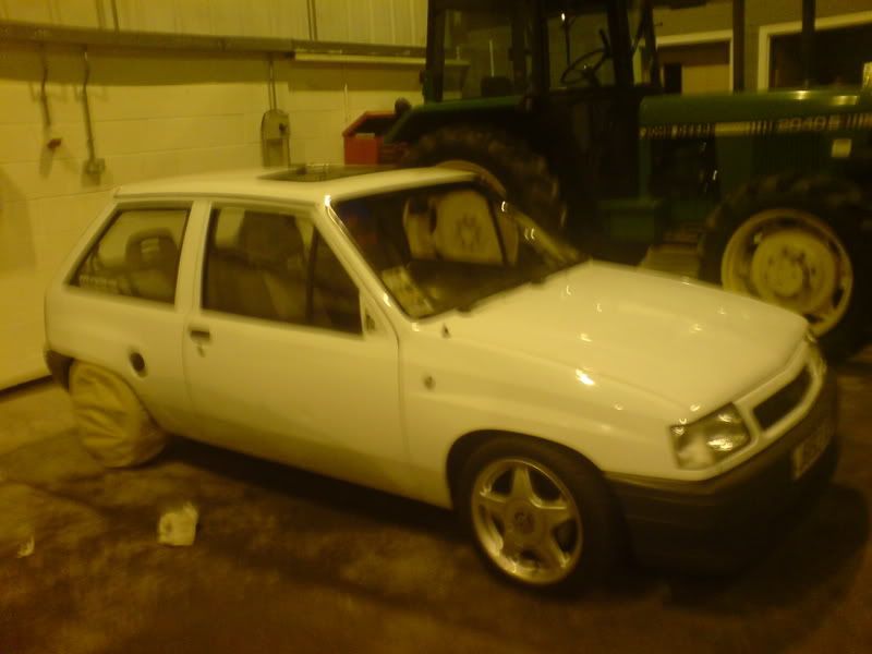

pics of the model when its done :) and does he do them for just anyone ?if he does ill have one when mines done

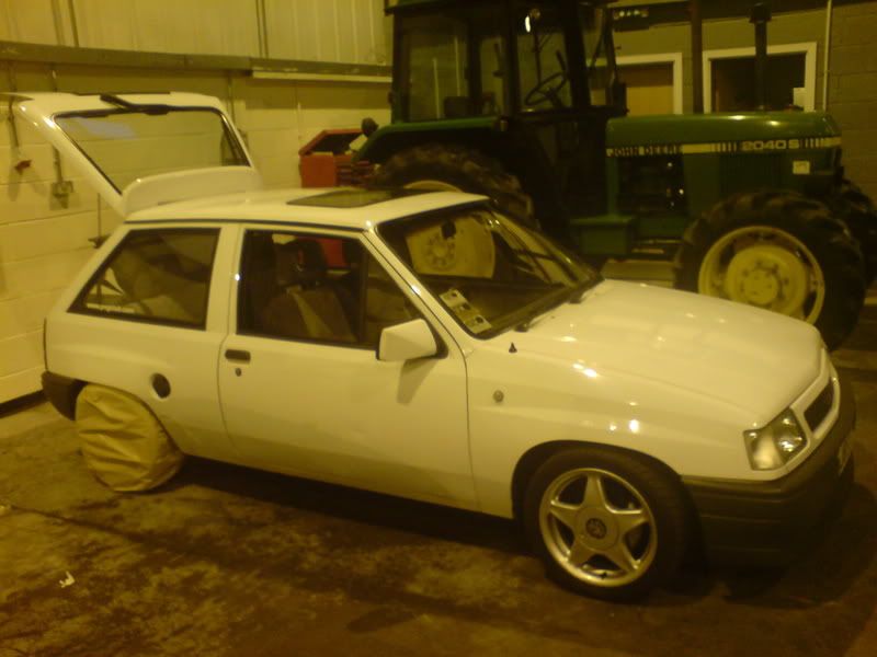

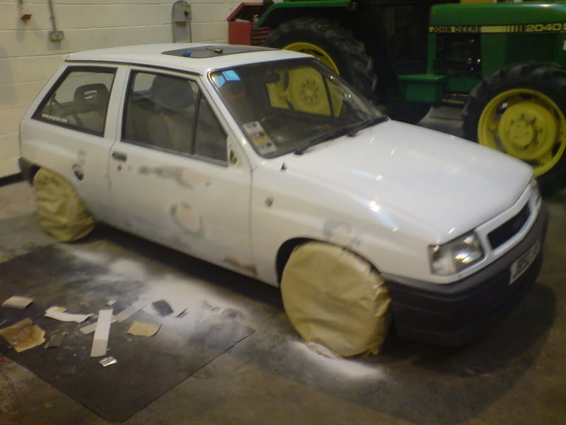

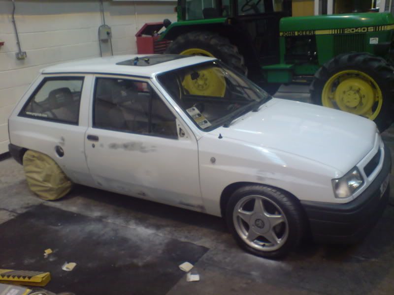

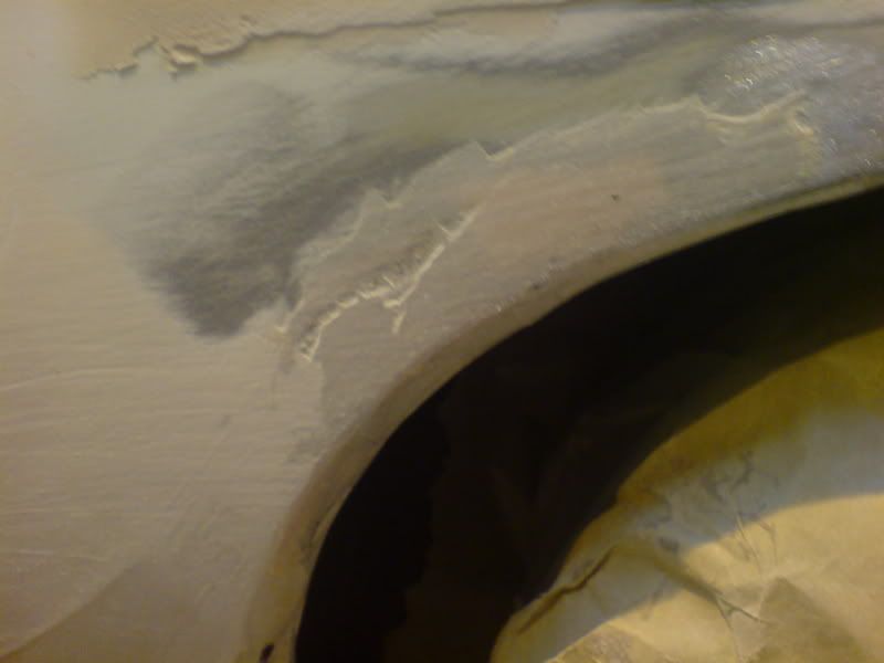

prepping begins tomorrow.. filler and grinding..prepped for preping today lol.. heres what she looks like at the moment..

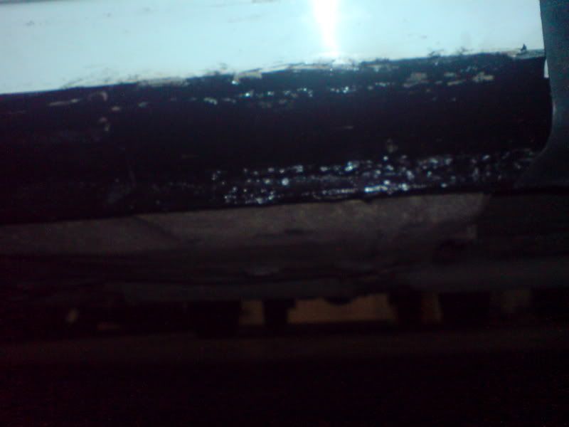

found a lovely weld on the near side sill :(

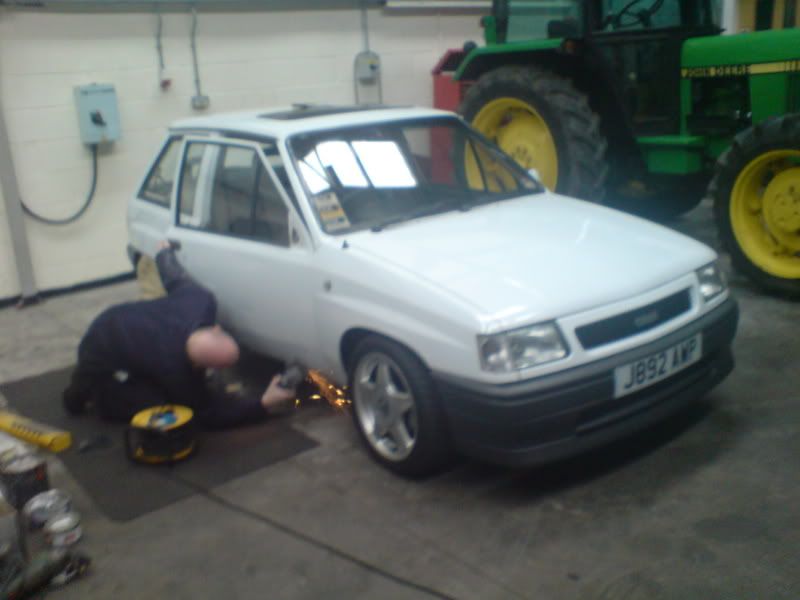

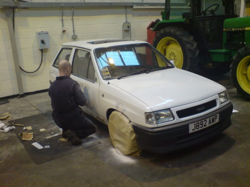

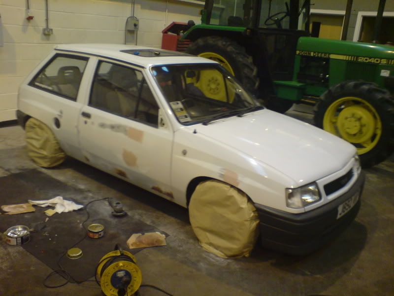

well.. its started.. got all this done in 1 day
drivers door: ground the rust out, found 2 hoels the size of pin heads.. nothing atall.. all the door is structurally sound so we put a re-enforcement inside, and fiberglassed all the ground out rust.. onyl sorface rust. the 3 dents were then saned back , fileld and flattened off roughly with p80 paper for now as we are going to give ti a final layer of metallic filler instead of using normal body filler
drivers 1/4: took back some touch up paint to find soem rust, grinf it out and a lick of filler, sorted. also found some surface rust on the arch/sill corner, took it back to bare metal and a skim of filelr, sorted.
drivers wing: 2 dents took abck to bare metal and then filled and sanded
passenger door: ground the surface rust away, no holes atall but has had filler in it previously, took the filelr out and fiberglassed it, sanded down. sorted
passenger 1/4, what i thought was the worst.. was actually ok, took it back to bare metal, fiberglassed it, sanded it down and got correct shape, skim of filler and a sand, sorted. dent about half way up, nocked in abit, took back to bare metal, skim of filler, sand, sorted.
passenger wing: 2 dents took abck to bare metal, skimemd with filler, sanded. sorted
heres the pics form today is some sort of order.
