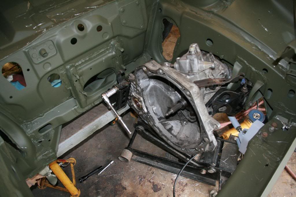

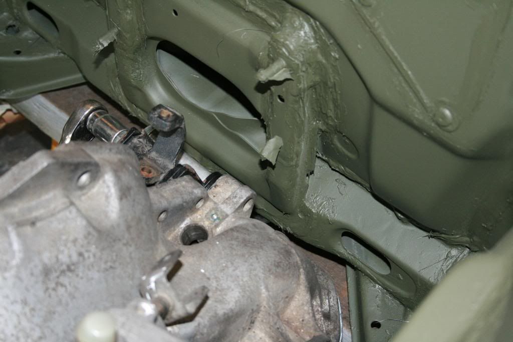

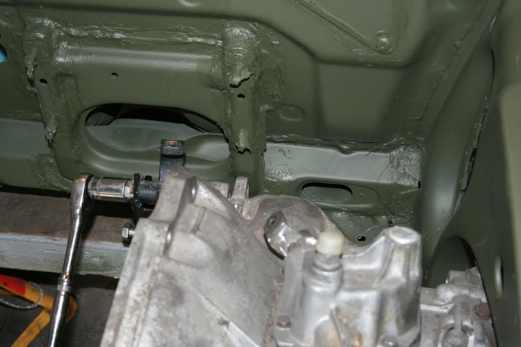

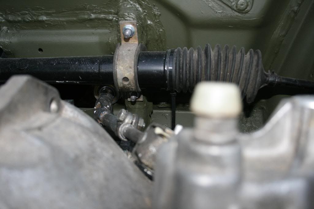

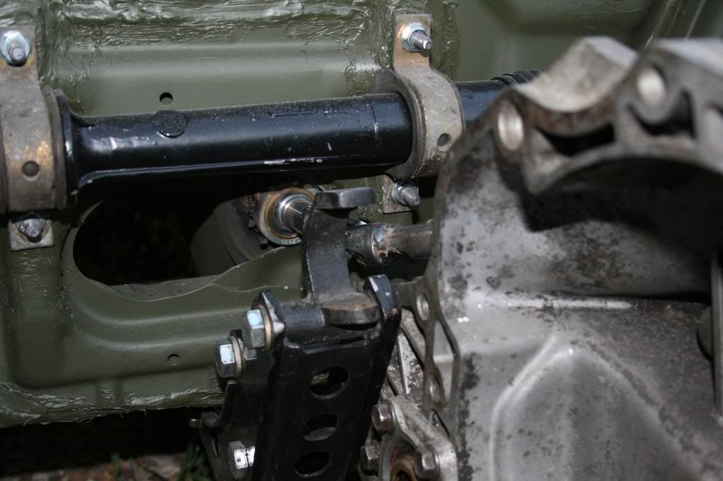

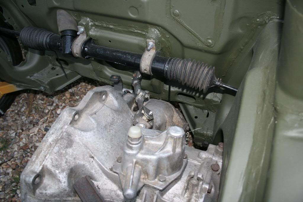

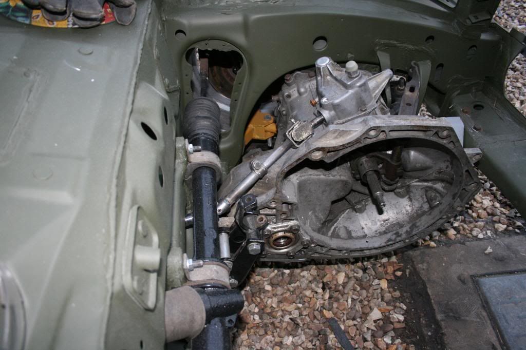

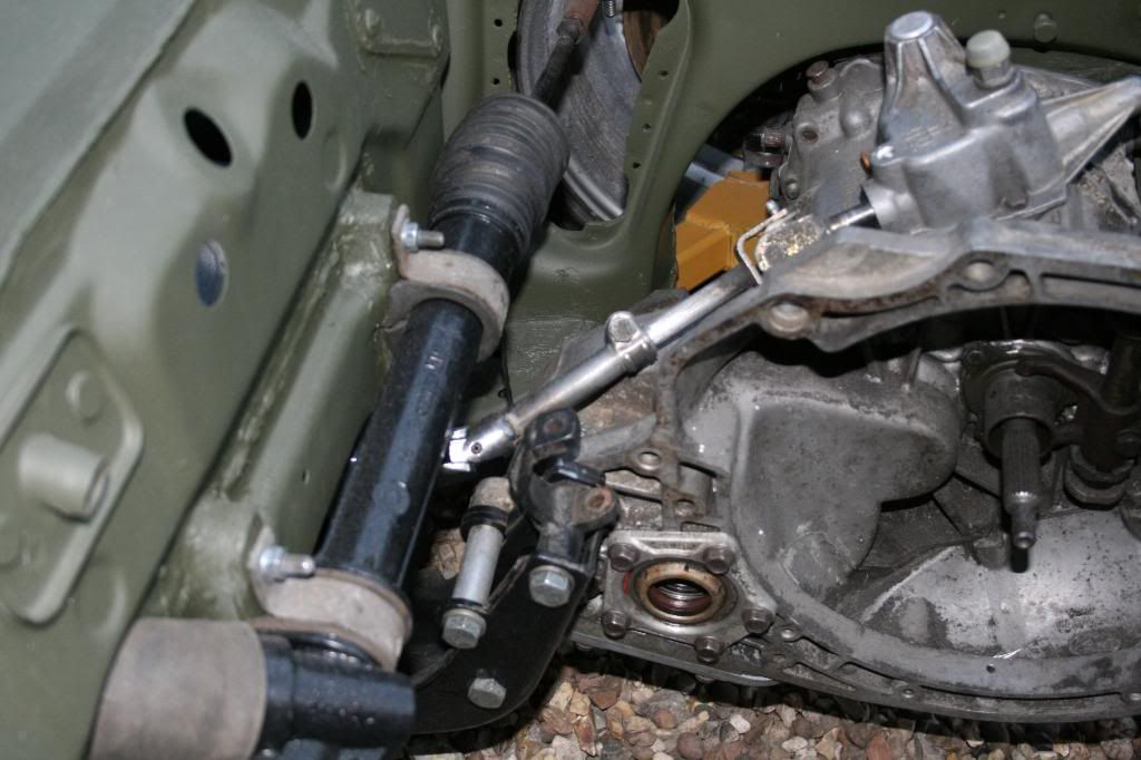

After getting my sccr box back from being serviced i decided i would slip it in the engine bay so i could have a go at fitting my quaife shifter
http://i248.photobucket.com/albums/g...rack1096-1.jpg

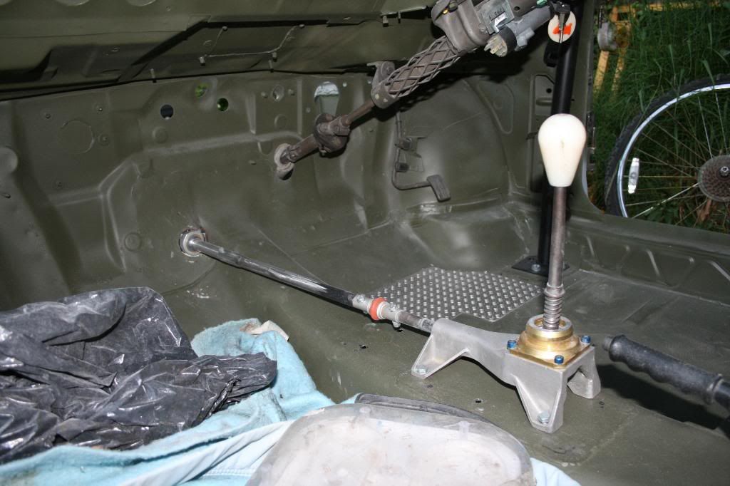

As i have raised the rack there is now a nice clear route through to the shifter turret on top of the box from the cabin
from here
http://i248.photobucket.com/albums/g...rack1099-1.jpg
through and up
http://i248.photobucket.com/albums/g...rack1098-1.jpg
http://i248.photobucket.com/albums/g...rack1100-1.jpg

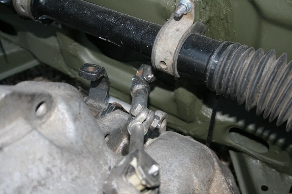

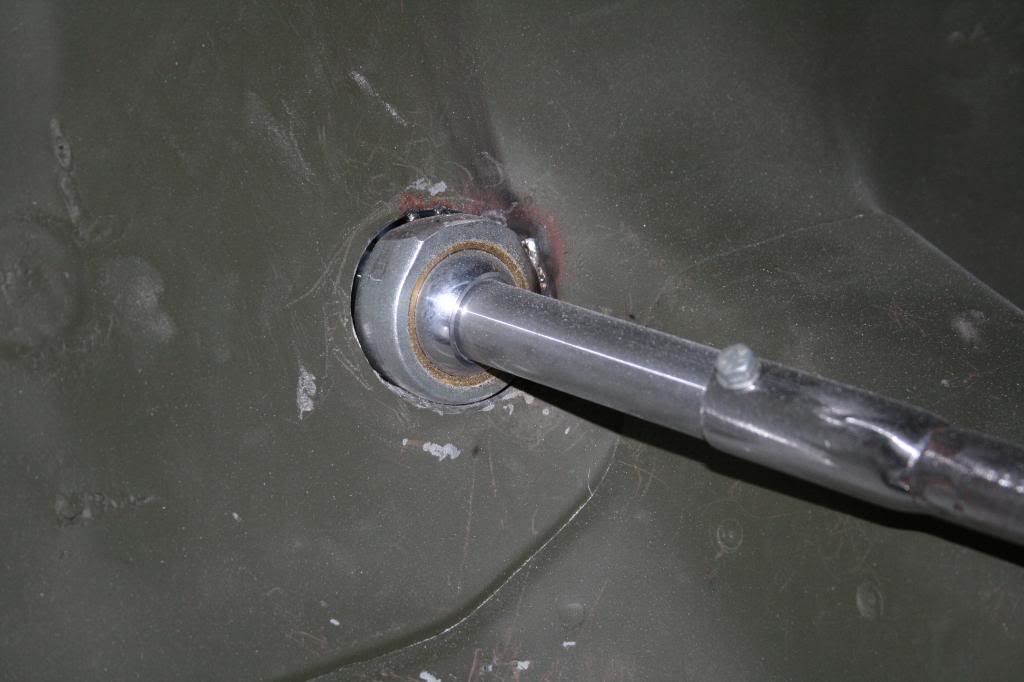

And this is how it sits now (as you can see its a bit DIY but those helicopter joints are funking expensive lol)
http://i248.photobucket.com/albums/g...hfiller001.jpg
http://i248.photobucket.com/albums/g...hfiller002.jpg
I used a very large rose joint i found and cut the threaded piece off it so i could tack it in to the bulk head
http://i248.photobucket.com/albums/g...hfiller003.jpg
http://i248.photobucket.com/albums/g...hfiller008.jpg
Here it is cabin side, it still needs finishing and tiding up obviously
http://i248.photobucket.com/albums/g...hfiller011.jpg
http://i248.photobucket.com/albums/g...hfiller017.jpg

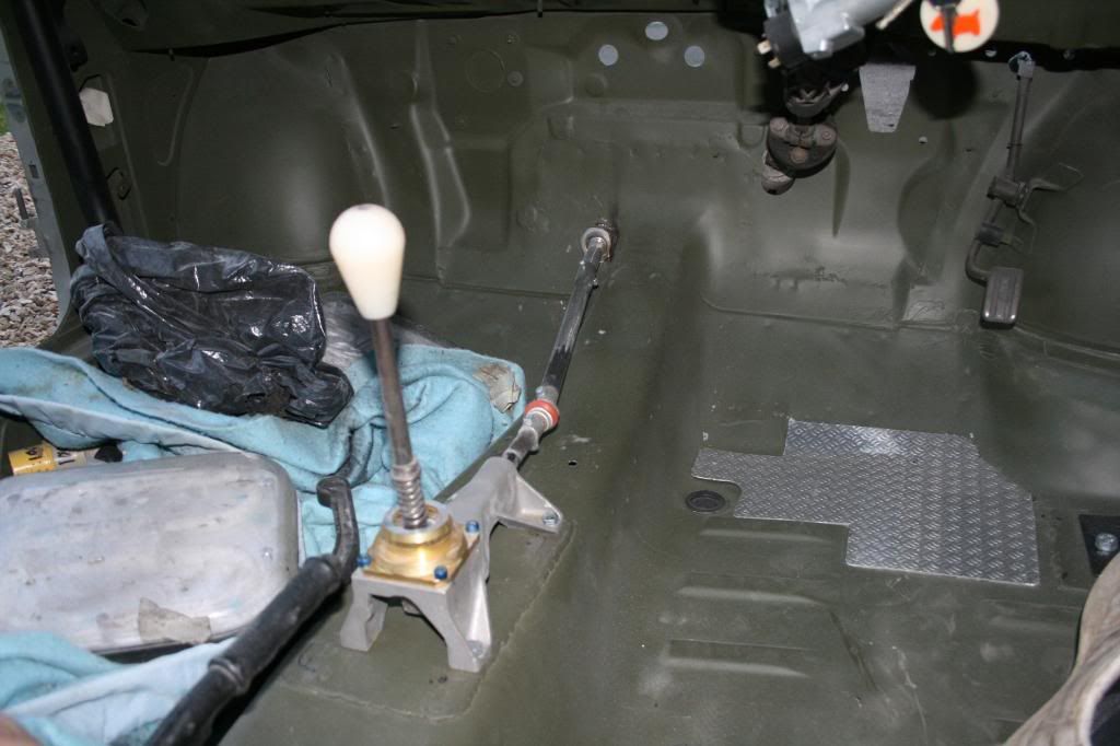

To construct the shifter rod i used one helicopter joint i got with the shifter and then used two 1/2 inch U joints, a large rose joint and various bits of tubing. IMO it hasn't come out badly and shifts smoothly result!
http://i248.photobucket.com/albums/g...hfiller012.jpg
http://i248.photobucket.com/albums/g...hfiller016.jpg
No tight angles etc
http://i248.photobucket.com/albums/g...hfiller018.jpg
http://i248.photobucket.com/albums/g...hfiller019.jpg

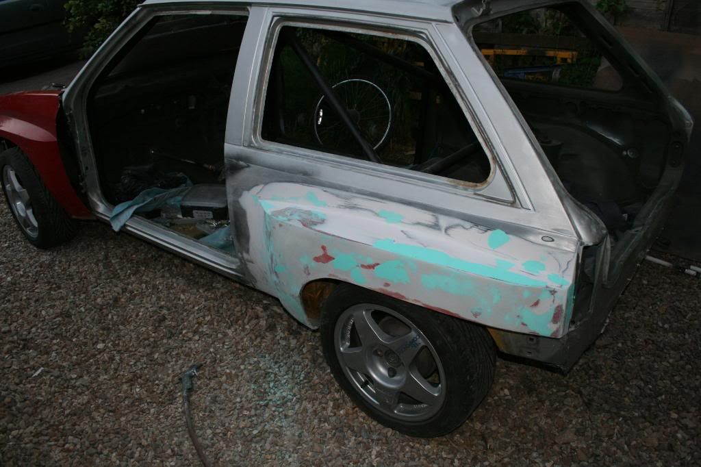

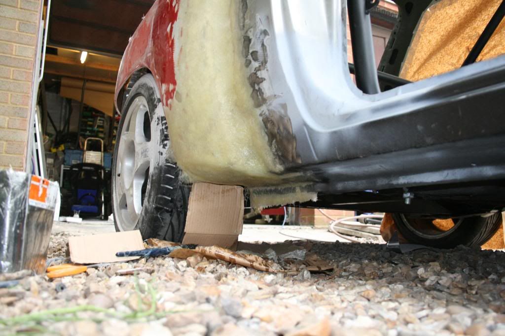

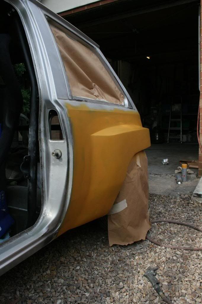

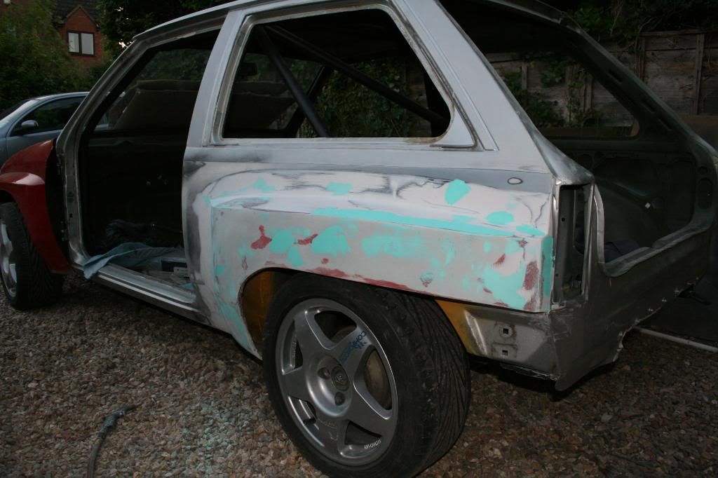

Once i was finished ballsing around with that i turned my attention to my rear arches.

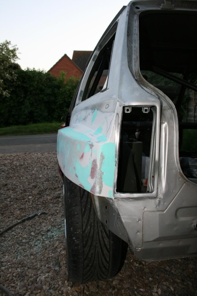

Can i say now i categorically hate filler (this hate doesn't help when trying to get it right) its a messy pain in the @rse job never the less so Mr camera stayed out of the dust until the end of the day. Although its a track car the arches needed some fettling as the FG looked truley w@nk, and would have probably boubled my air resistance lol
Anyway here are the finished results after i finished off the filler (the green is stopper a kind of fine filler for small scratches and blemishes for anyone who doesn't know)
http://i248.photobucket.com/albums/g...hfiller020.jpg
http://i248.photobucket.com/albums/g...hfiller022.jpg
http://i248.photobucket.com/albums/g...hfiller025.jpg
http://i248.photobucket.com/albums/g...hfiller027.jpg

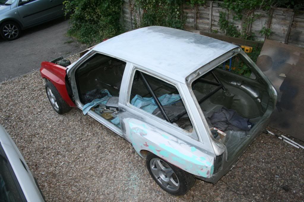

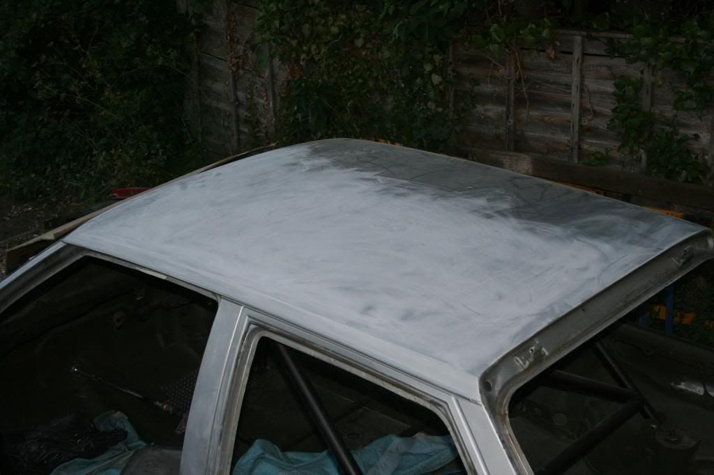

Whilst waiting fo the filler to dry i did start perping the roof
http://i248.photobucket.com/albums/g...hfiller030.jpg
And one from above just because
http://i248.photobucket.com/albums/g...hfiller031.jpg

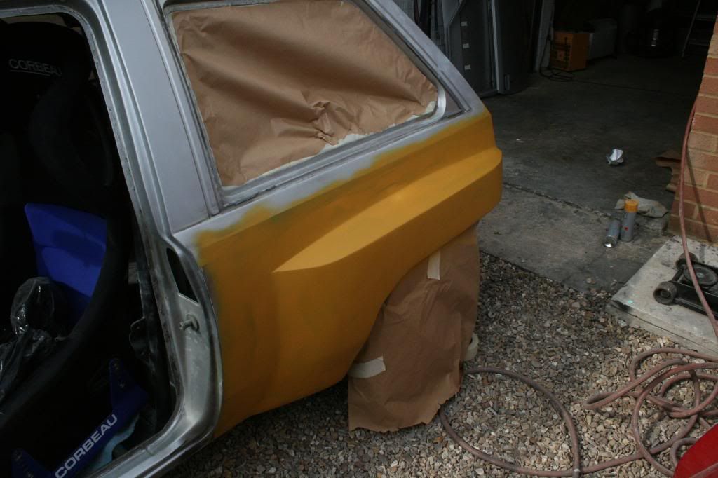

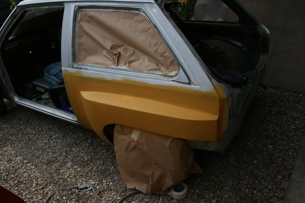

Once i was happy with the shape meany guide coats later i decided to lay on some high build primer to see what it looked like in paint, better than expected thank funk, this side is nearly there now with only a little finishing off needed!
http://i248.photobucket.com/albums/g...hfiller033.jpg
http://i248.photobucket.com/albums/g...hfiller034.jpg
http://i248.photobucket.com/albums/g...hfiller035.jpg

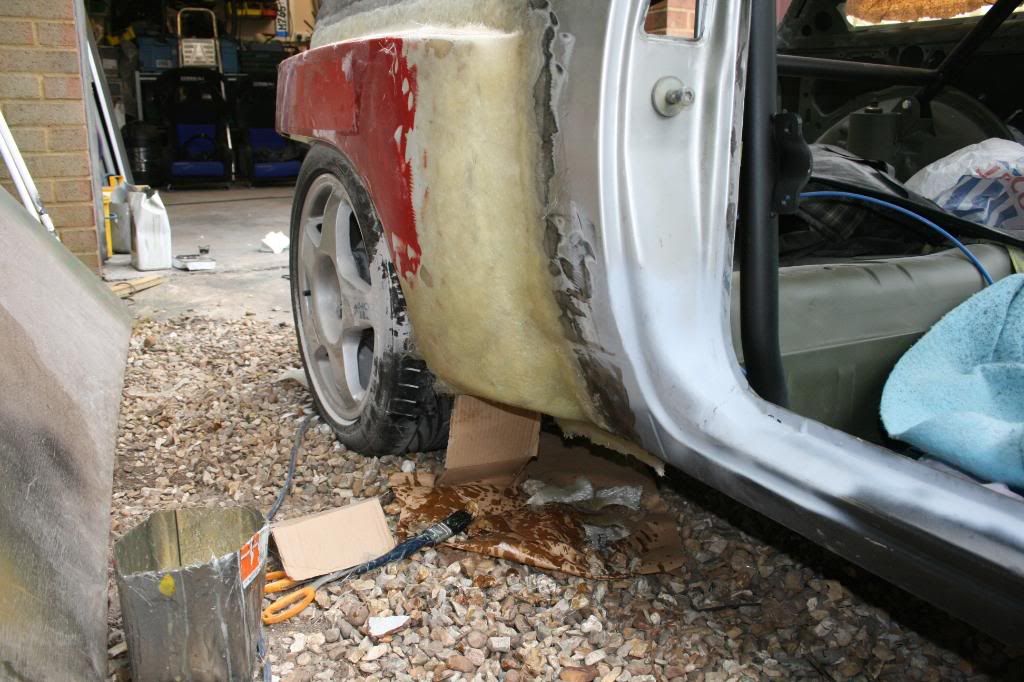

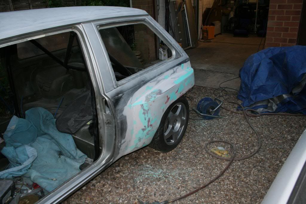

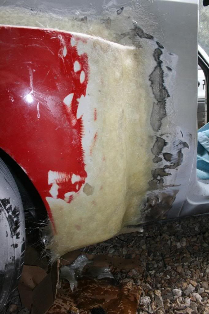

While the N/S was drying and for a change of scenery lol i decided to attack the other side. I started off by finishing off the FG work needed
http://i248.photobucket.com/albums/g...hfiller036.jpg
http://i248.photobucket.com/albums/g...hfiller037.jpg
http://i248.photobucket.com/albums/g...hfiller038.jpg
And tidied up some of the FG i had already applied then left it for tomorrow

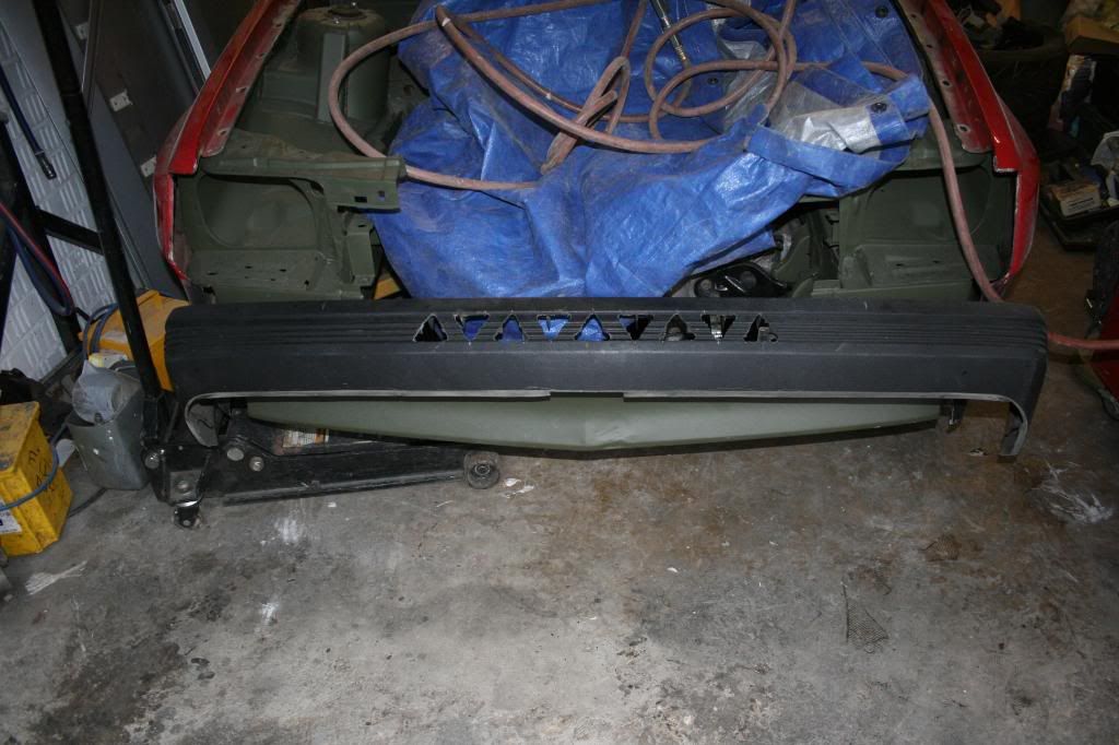

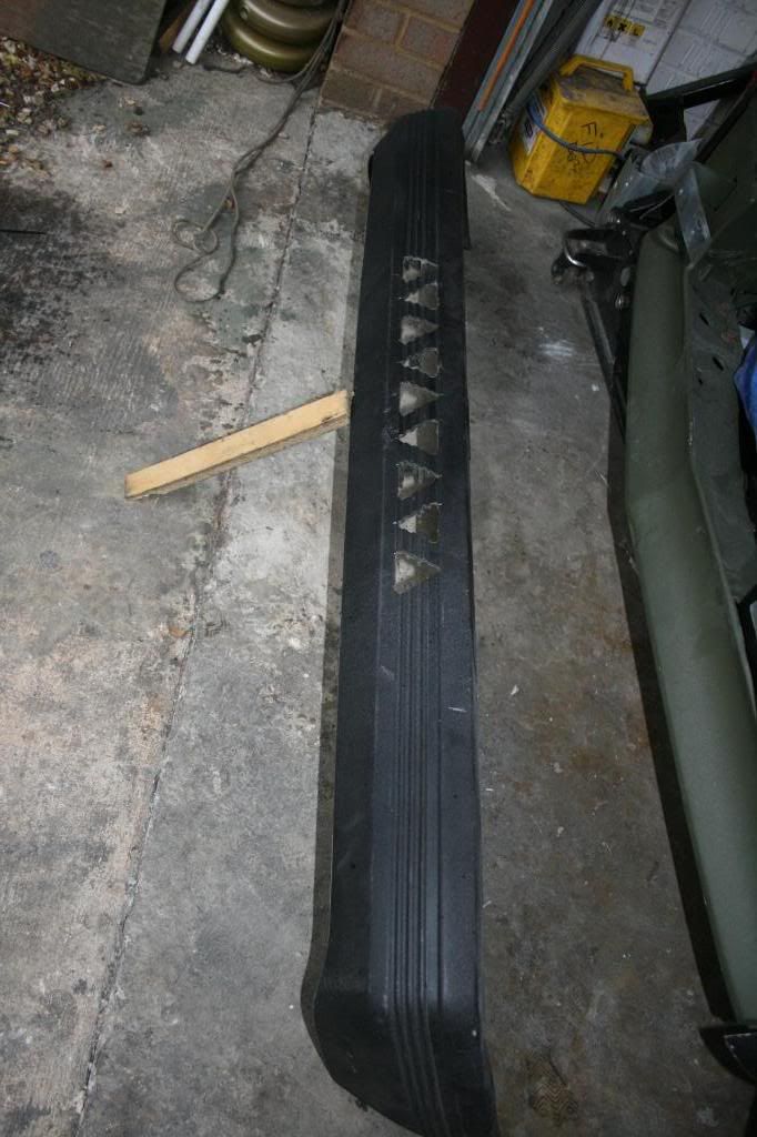

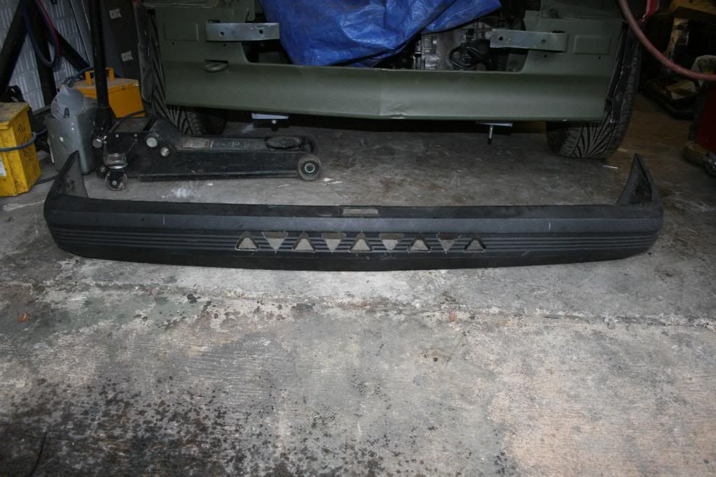

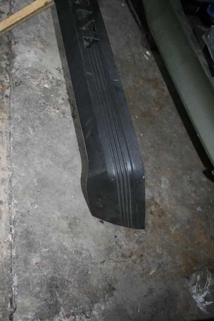

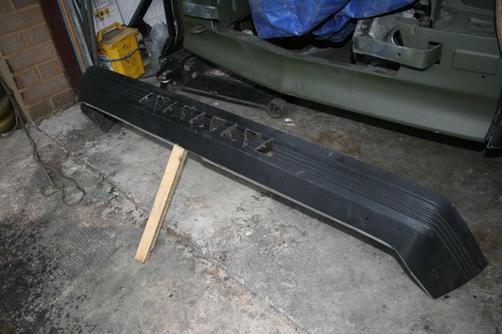

I also thought i would share with you my cut down rear bumper (i know its at the front of the car now but its the only place i had to take a photo of it), basically i cut 6 ish inches off the bottom of the bumper and added some triangles to allow air flow job done and its super light :thumb:
http://i248.photobucket.com/albums/g...hfiller040.jpg
http://i248.photobucket.com/albums/g...hfiller041.jpg
http://i248.photobucket.com/albums/g...hfiller044.jpg
http://i248.photobucket.com/albums/g...hfiller039.jpg
The sides needed to be a little deeper so i could retain the original side clips
http://i248.photobucket.com/albums/g...hfiller045.jpg

Looks a much strighter line for it to run. Nice work.
Filler work looks good, it is a **** of a job but worth it. You can get a stopper, which is more easy to work with and more (cant think of the word but less thick so it fills the small pin holes and such)
Arches do look awesome. Nice work.
Bumpers very cool!
The shifter?Quote:
Yeah see the edit too..Quote:
excuse my confusion but is the rear bumper now going on the front?
I certainly know your pain! I glad that stopper product exits as the bodyshop is certainly going to need it in my case! lol
