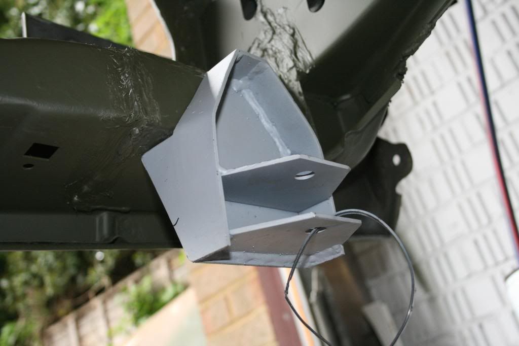

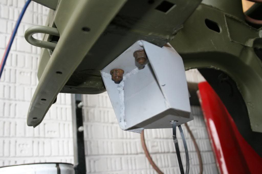

I started with the O/S drop mount as it needed some holes drilling in it
http://i248.photobucket.com/albums/g...etrack2001.jpg
And mounted on the lower panel so i could start building up the arms and tie bars
http://i248.photobucket.com/albums/g...etrack2002.jpg
http://i248.photobucket.com/albums/g...etrack2003.jpg

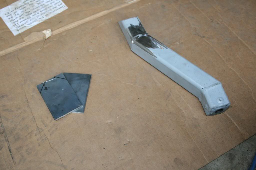

Raw materials and the arm i made previously
http://i248.photobucket.com/albums/g...etrack2004.jpg

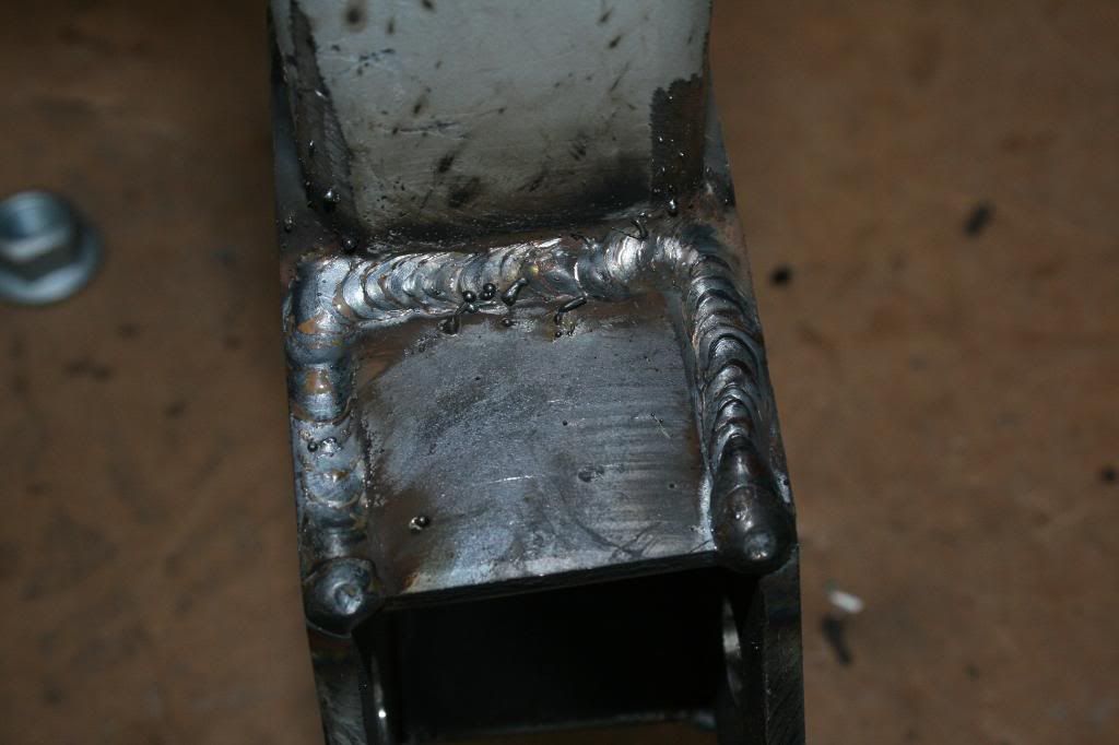

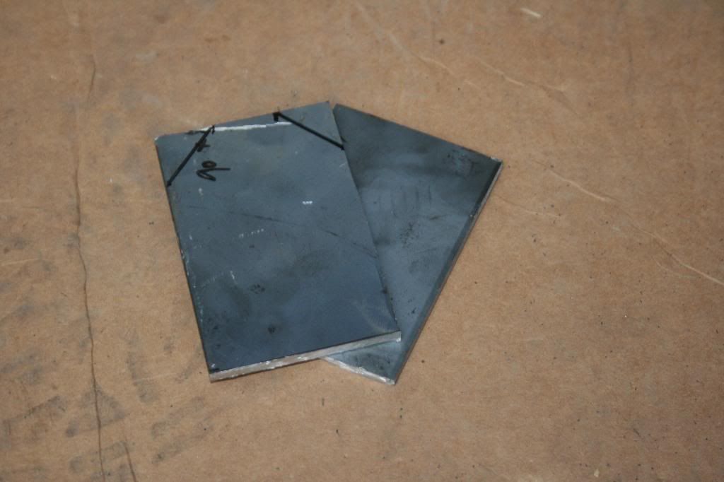

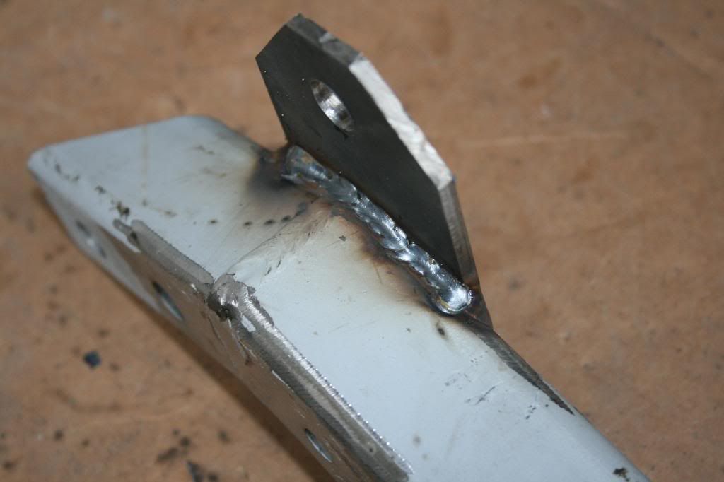

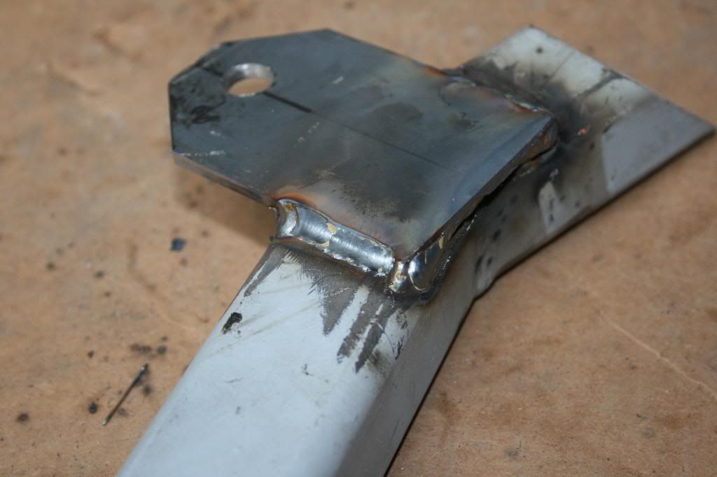

Chopped these bits of plate to size
http://i248.photobucket.com/albums/g...etrack2005.jpg

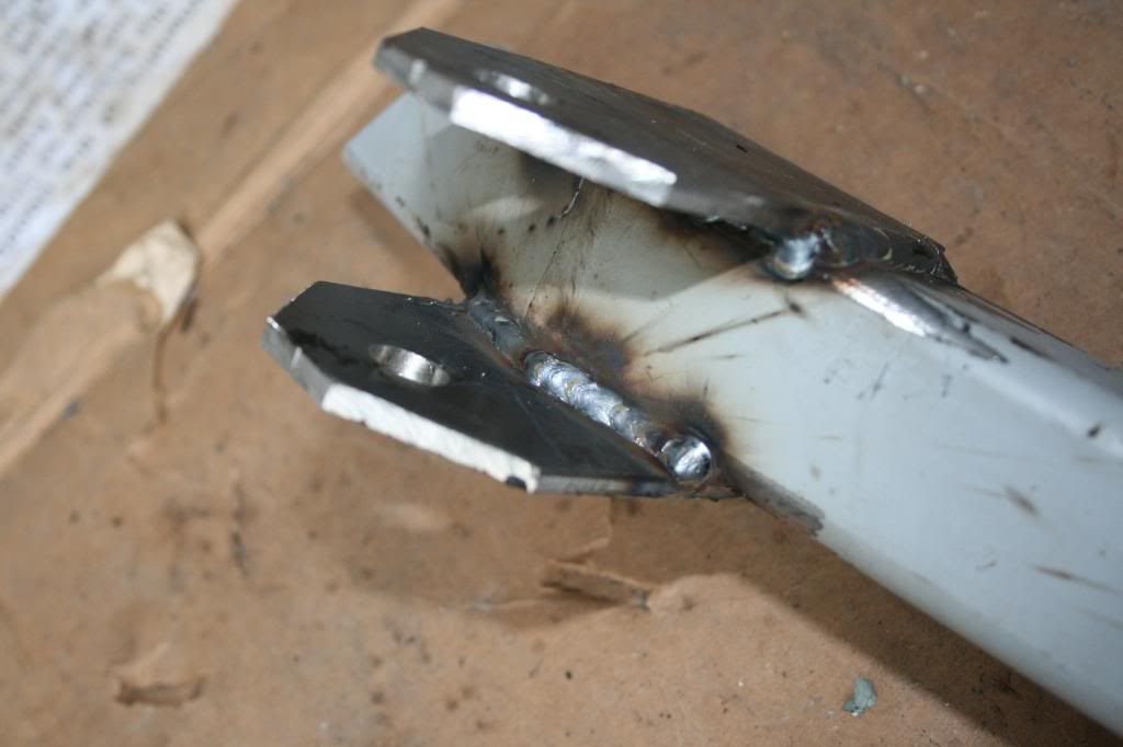

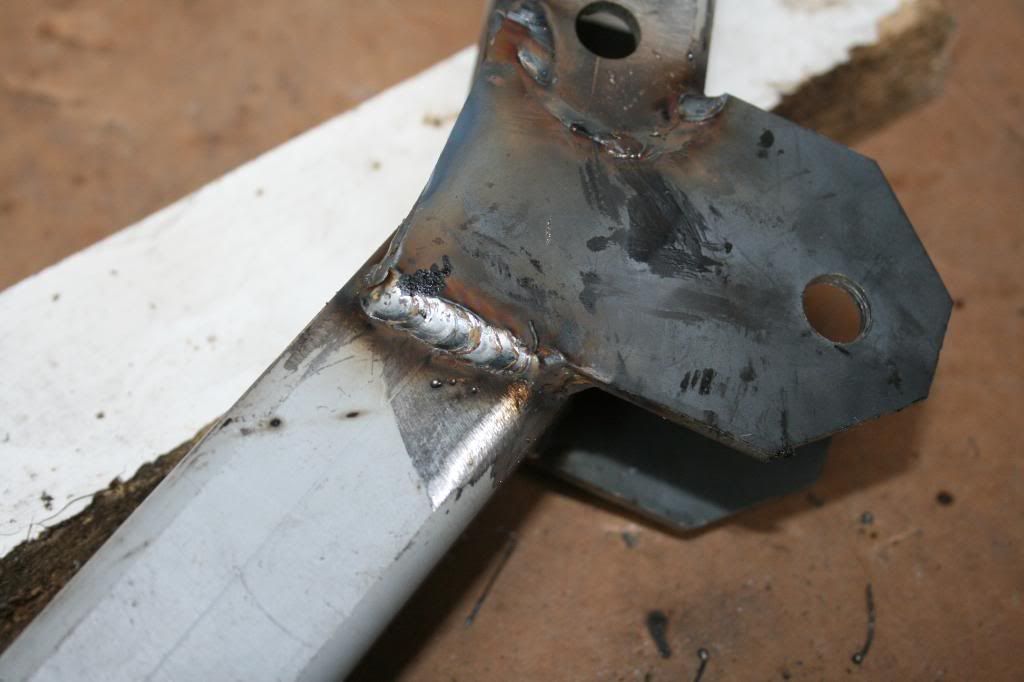

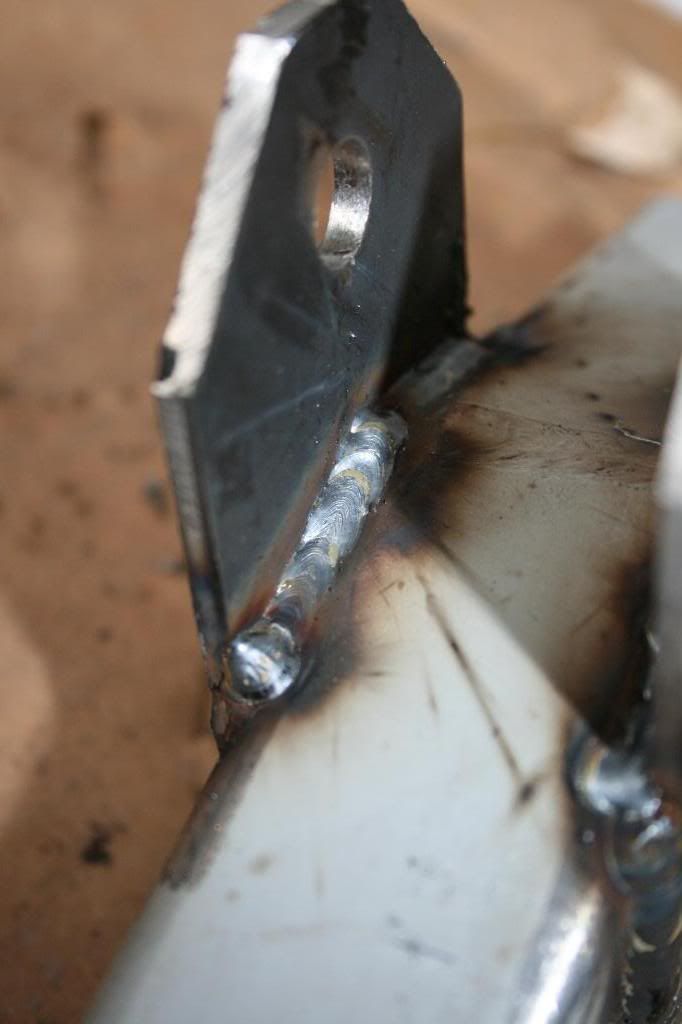

And welded the top plate on
http://i248.photobucket.com/albums/g...etrack2006.jpg
http://i248.photobucket.com/albums/g...etrack2008.jpg
http://i248.photobucket.com/albums/g...etrack2009.jpg

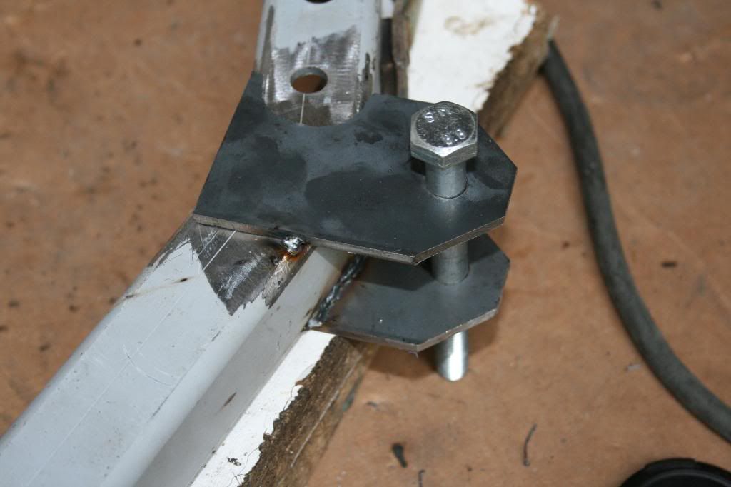

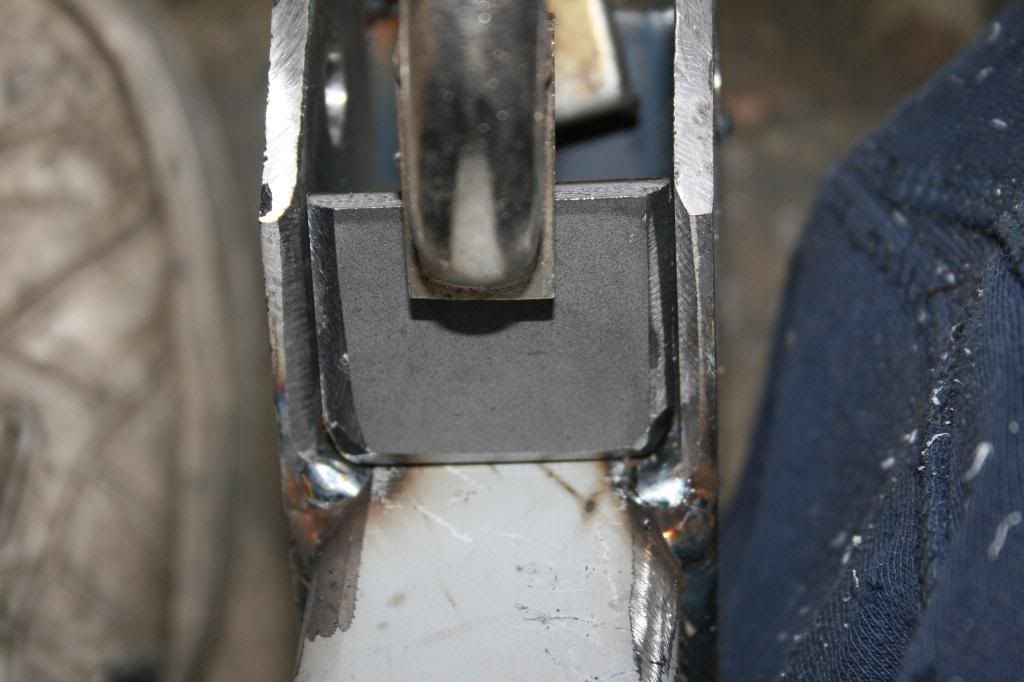

Then shaped the bottom plate so it missed the ball joint bolts
http://i248.photobucket.com/albums/g...etrack2010.jpg

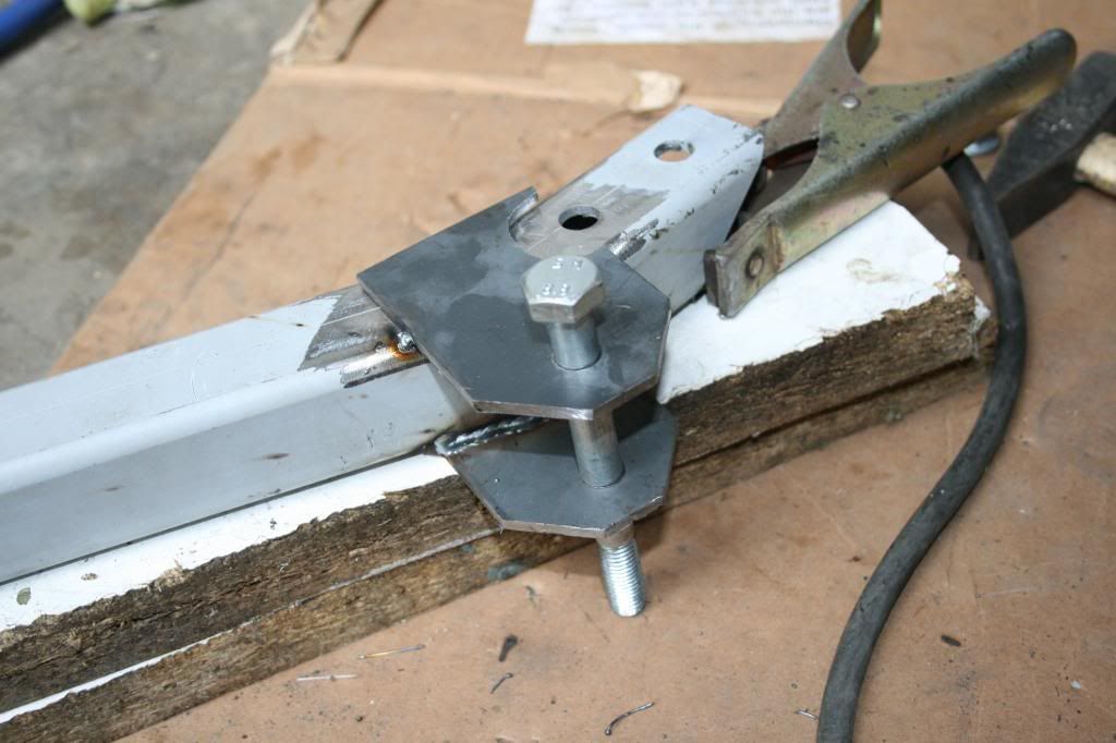

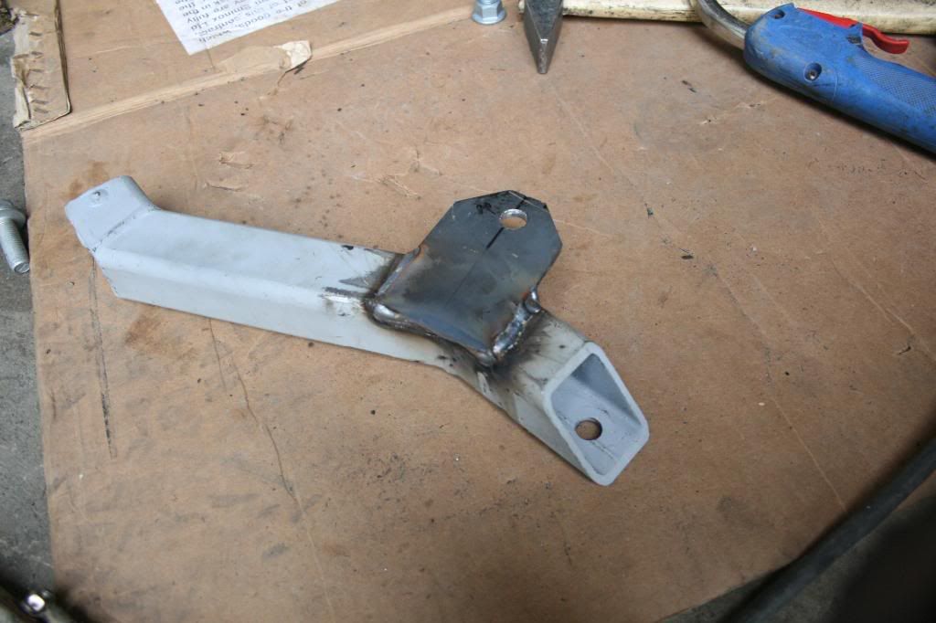

And tacked it on to the arm
http://i248.photobucket.com/albums/g...etrack2012.jpg
http://i248.photobucket.com/albums/g...etrack2011.jpg

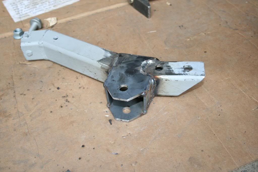

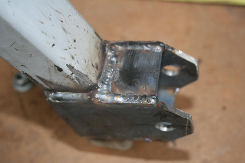

And welded it in
http://i248.photobucket.com/albums/g...etrack2013.jpg
http://i248.photobucket.com/albums/g...etrack2015.jpg
http://i248.photobucket.com/albums/g...etrack2016.jpg
http://i248.photobucket.com/albums/g...etrack2017.jpg

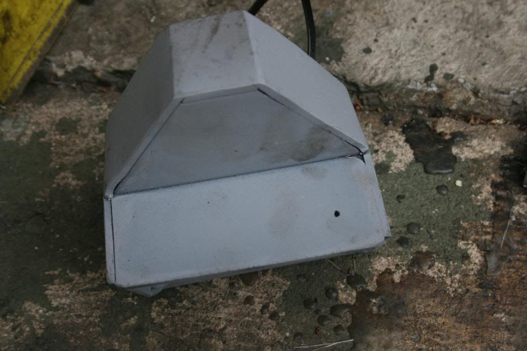

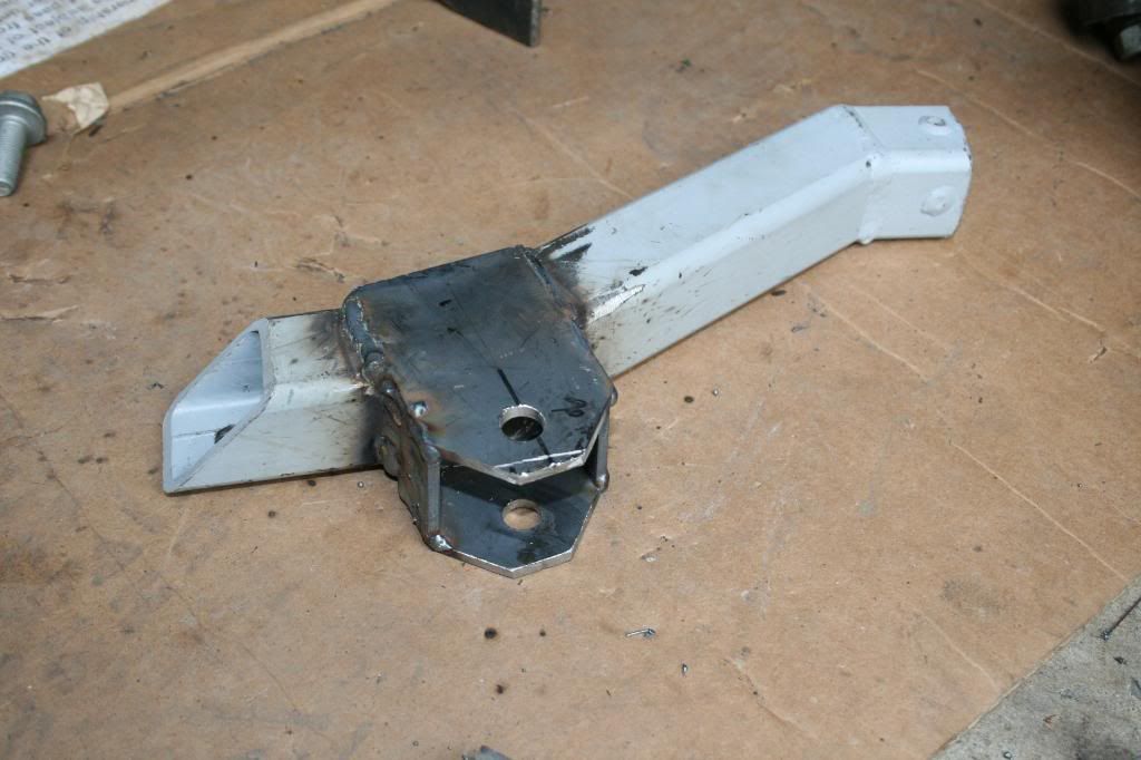

Then made up some sides to box it in
http://i248.photobucket.com/albums/g...etrack2020.jpg
http://i248.photobucket.com/albums/g...etrack2021.jpg
http://i248.photobucket.com/albums/g...etrack2022.jpg
All done with the arms other than paint!
http://i248.photobucket.com/albums/g...etrack2023.jpg
http://i248.photobucket.com/albums/g...etrack2024.jpg
http://i248.photobucket.com/albums/g...etrack2025.jpg

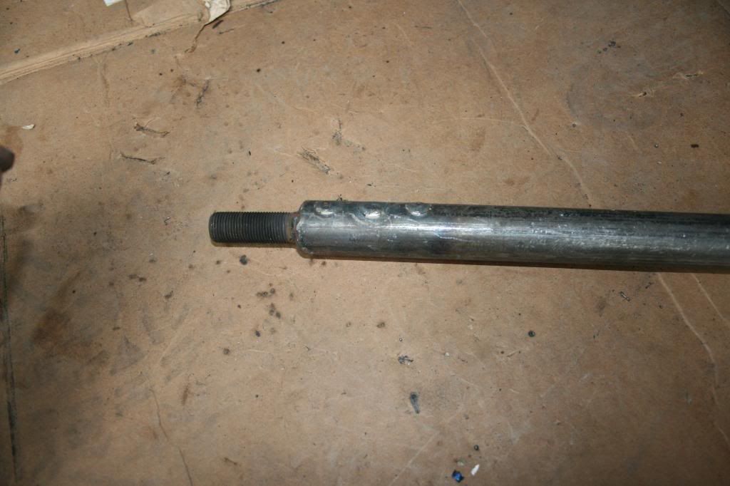

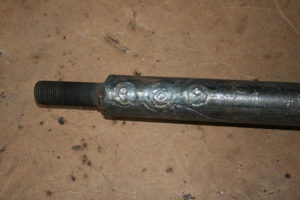

Once the arms were sorted i turned my attention to the bars
http://i248.photobucket.com/albums/g...etrack2026.jpg
http://i248.photobucket.com/albums/g...etrack2027.jpg
I will have to finish them off tomorrow as fish and chips were calling me!
