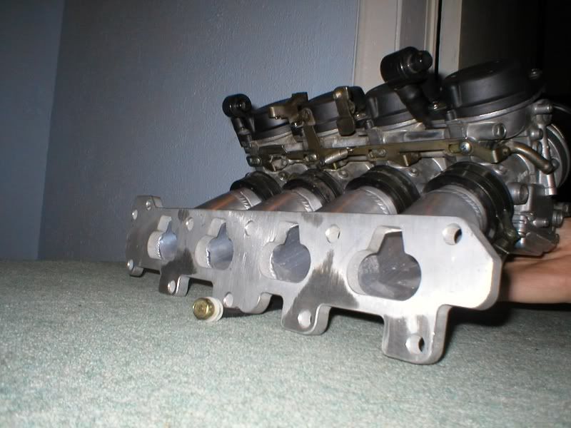

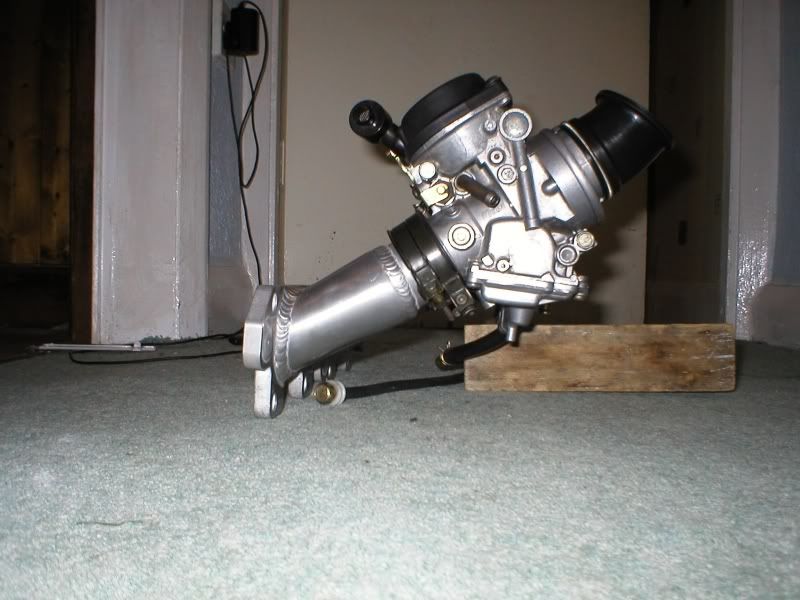

I'd be interested to see the inlet when you have it. (Pics)
I'll get pics up once i get it :)
Edit-heres a pic Tom did when he picked the manifolds up from the maker.
http://i176.photobucket.com/albums/w...id/2ltrxea.jpg
It'll be getting drilled/tapped for coolant connection, and brake servo. EGR is already blocked off(right hand side), and the left hand side will be cut off, as the 16xe head has a cast bolt on gallery for the coolant, seperate from the inlet.
And the runners will need a session with the die grinder to get them nice and smooth.
I might see if i can find another cylinder head, so i can then get the inlet matched to the head ports, re-lap the valves etc, then bolt the whole lot on my block. As i want the car to be off the road for the shortest time posible ideally.

Im picking up the inlet at Donny on Saturday hopefully.
Cheers Chubbston.
Picked the inlet up off Iainel today.
Will get pics later.
Will need some smoothing work, and some mods before i consider using it tho.
They look fapping excellent ad! Get 'em on! Toms manifold doesn't look too bad i have to say.
Aye, for the price saving/waiting time over Bogg bro's, they are worth it.
They do need some work before id use it tho(coolant passage drilling etc). And a brake servo union fitting

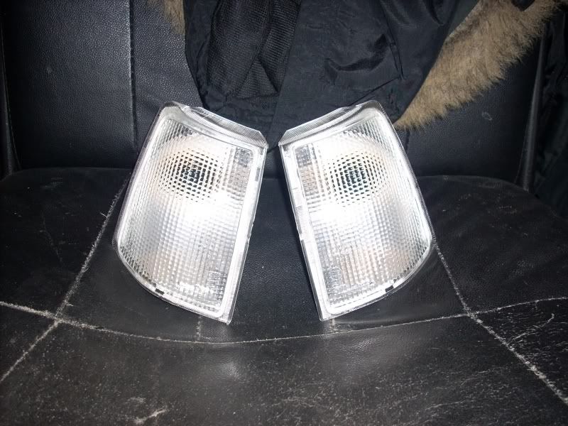

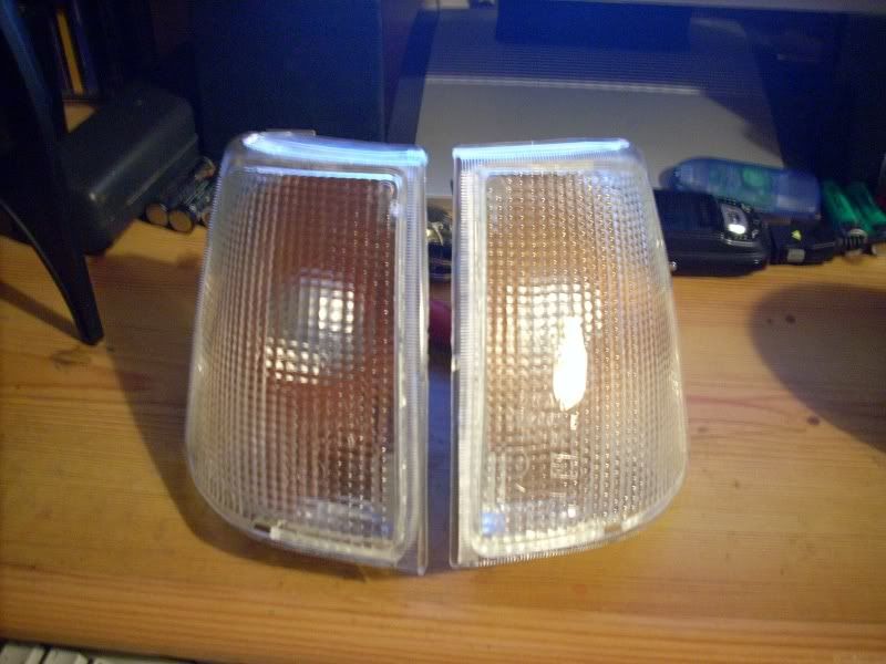

Anyhow, quick update.
Noticed that the front indicators were getting ****ty looking/mouldy in the corners.
So i popped on ebay and found a set of brand new gm ones.
Bought them and received them today.
So got to work with "de-tangoing" them(removing the orange bulb filters)
How they started:
http://img.photobucket.com/albums/v8...w/DSCN0031.jpg
After removing the filters, much cleaner/fresher look to the front end. Will fit Silvertec bulbs too, so no orange bits on sight,Lol.
http://img.photobucket.com/albums/v8...w/DSCN0037.jpg
That is all for now.
How'd you do that?
Screwdriver, and a big fcuking hammer :)
The filters are just glued inside the lens, so just smash it in bits and remove with pliers,lol.
Stealing my idears again i see... ;)
Looks much better, hope you've got the silver coverd orange bulbs...
Will be Mr Benn ;)Quote:
:plollolQuote:
Looks smart :thumb: Do you take the lens off? or shatter the filter through the bulb hole? I wanted to make a smoked/clear set for when I back to mk2 :cool:
Shatter it through the bulb hole mate, and then remove the remains with long nose pliers.
