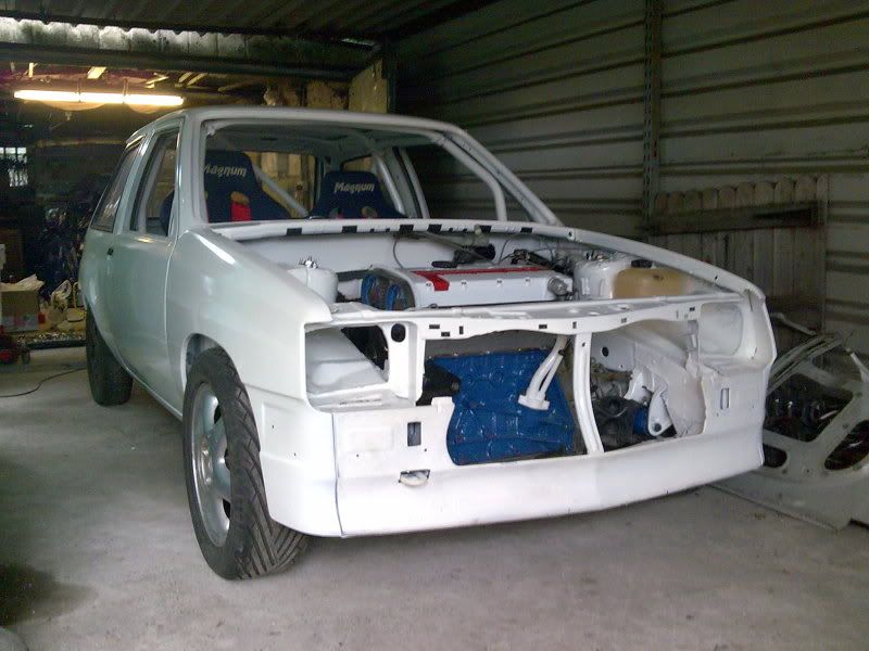

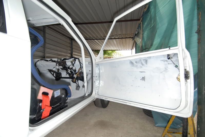

Thanks dude, Its deffo changed a fair bit since the last time you saw it, and looks even better in the pics you took compared to my pics lol :thumb: Soz I ain't got them up sooner, just not had chance to get online!Quote:
Originally Posted by trackdaynova
Here we goes anyway, as it stands... (Well sort of ;) )
http://img.photobucket.com/albums/v3...a/DSC_4999.jpg
http://img.photobucket.com/albums/v3...a/DSC_4969.jpg
http://img.photobucket.com/albums/v3...a/DSC_5011.jpg
http://img.photobucket.com/albums/v3...a/DSC_4971.jpg
http://img.photobucket.com/albums/v3...a/DSC_4988.jpg
http://img.photobucket.com/albums/v3...a/DSC_4977.jpg
http://img.photobucket.com/albums/v3...a/DSC_4994.jpg
http://img.photobucket.com/albums/v3...a/DSC_4992.jpg

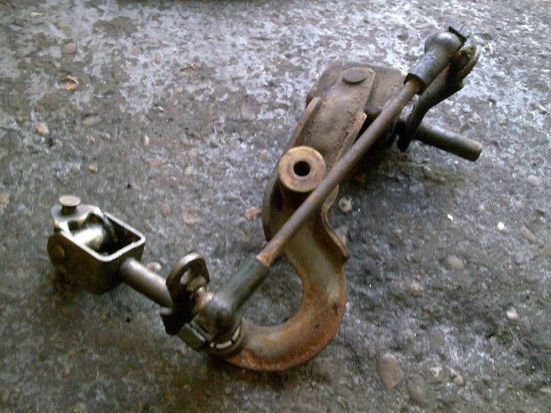

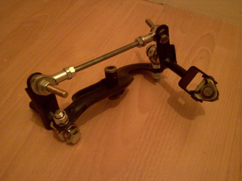

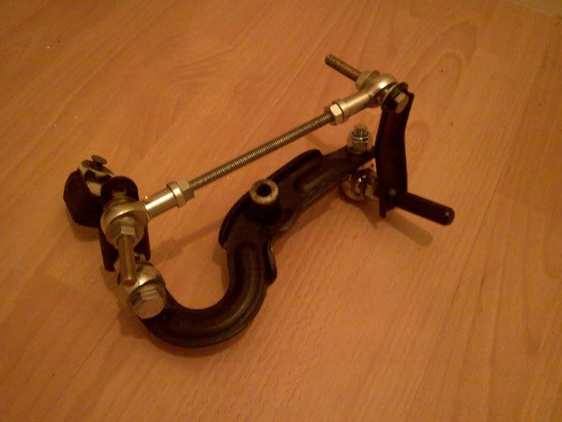

One manky slack linkage
http://img.photobucket.com/albums/v3...a/Image096.jpg

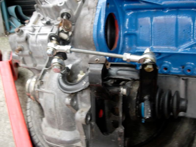

Plus some shiney new rosejoints and by following Dar's excellent guide (Just got to trim the bolts down and its finished)
http://img.photobucket.com/albums/v3...a/Image097.jpg
http://img.photobucket.com/albums/v3...a/Image098.jpg

LOOKING AWESOME MATE SHELL LOOKS SPOT ON and thumbs up on the rosejointed gearlinkage

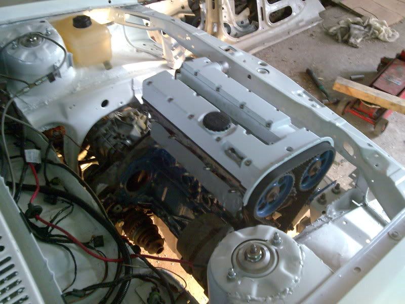

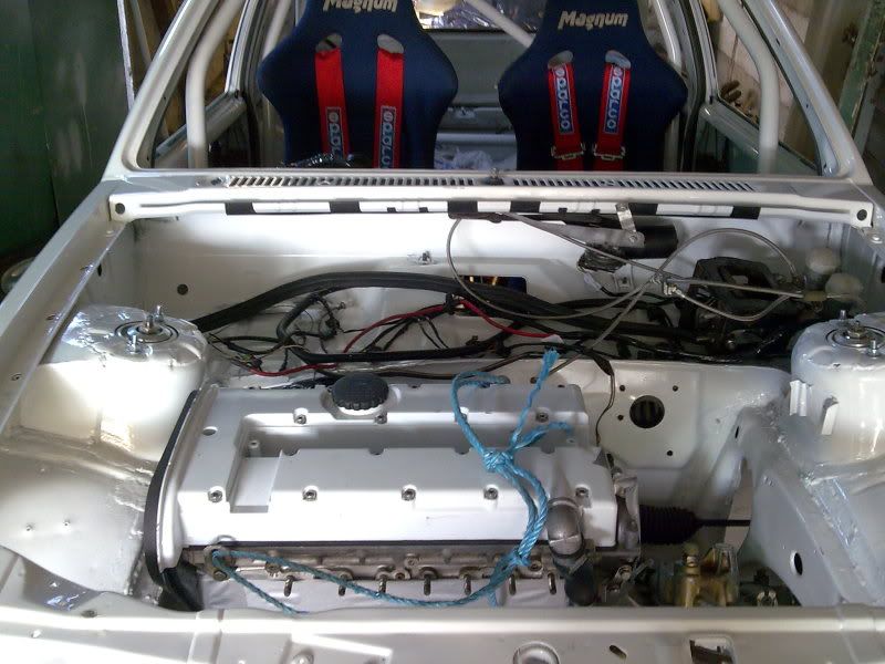

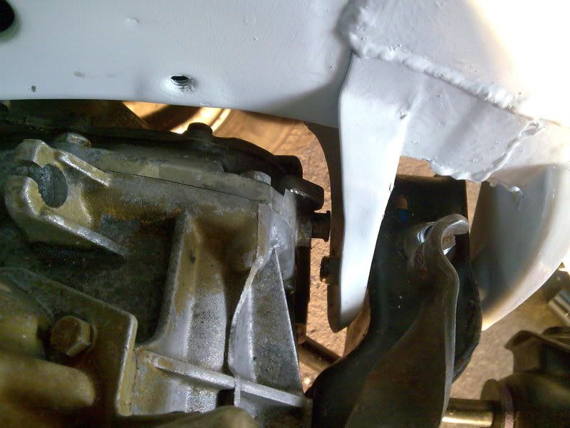

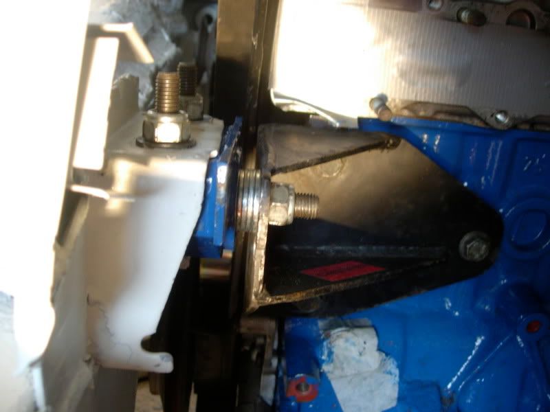

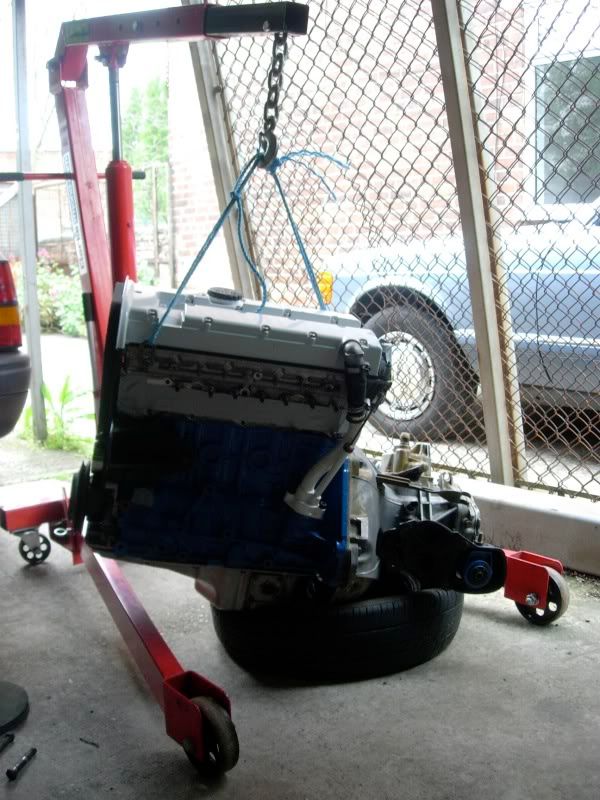

Well I've been busy working away over the past couple of days, and been working on the nova till 11pm tonight trying to get the engine to sit right on solid mounts, what a nightmare!! I will have to get some pics of where I was having problems, although one area was the rear gearbox mount which I've had to enlongate as most people seemed to have done, but my main problem was the front engine mount (drivers side) as it was under far to much pressure when bolted up tight, I need to put a spacer in between the mount and the bracket, will get some pics tomorrow t show this. Massive Thanks to Ernie who I called to get some advice off too, cheers pal:thumb:

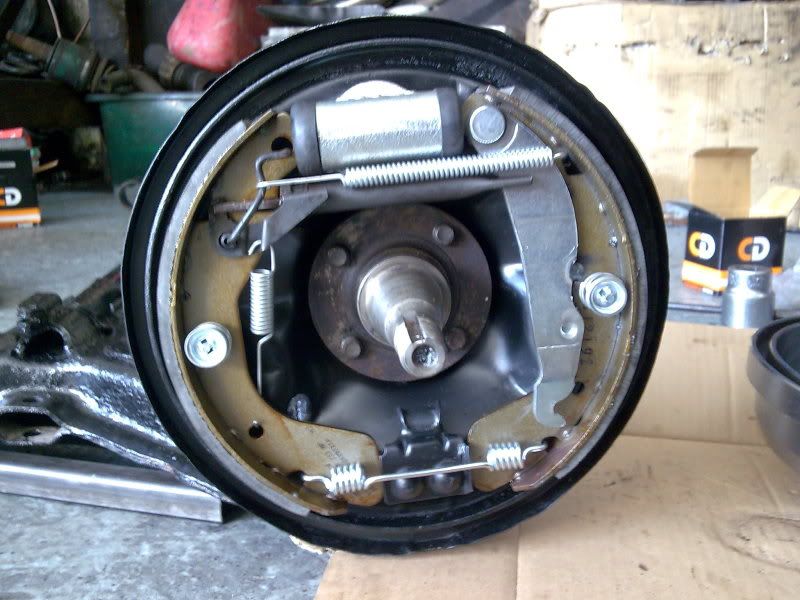

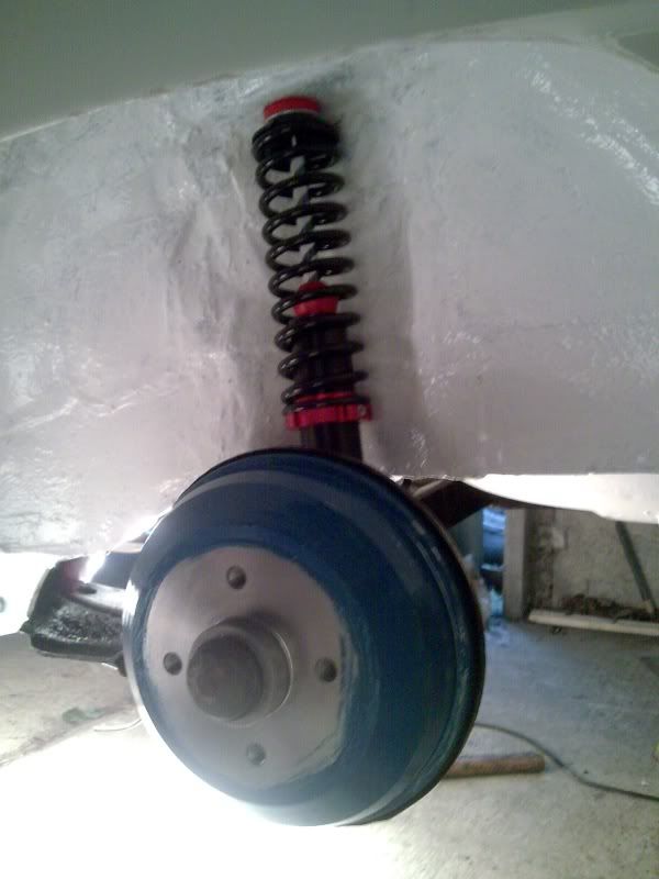

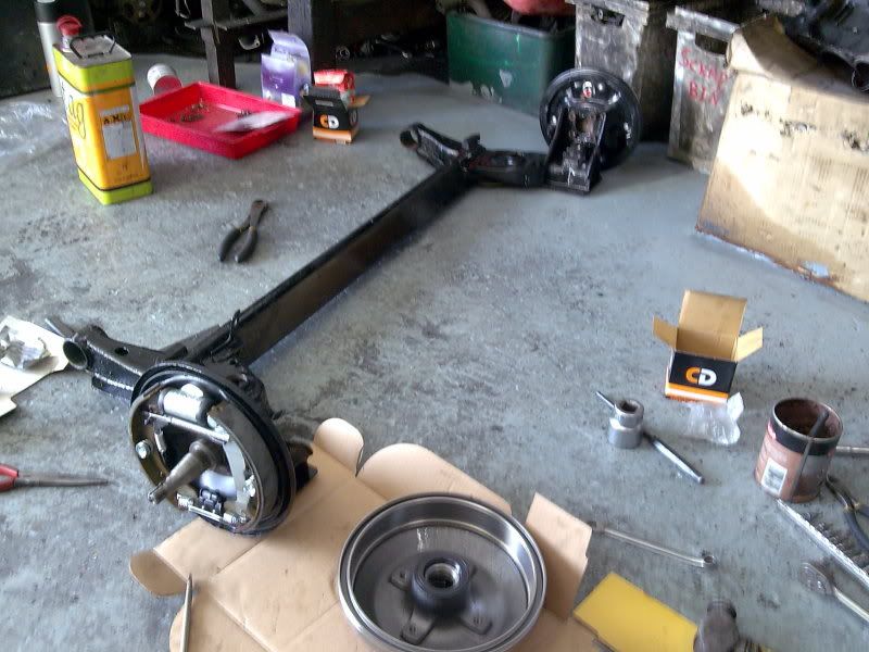

Cleaned & painted the rear beam. Fitted new drums, shoes, wheel cylinders, bearings and fixing kit
http://img.photobucket.com/albums/v3...a/Image101.jpg
Looking fresh!
http://img.photobucket.com/albums/v3...a/Image100.jpg
And fitted to the car with the coilovers in the freshly painted rear arch painted by wonderful fiancée, who also cleaned and painted the rear beam! Thankyou :)
http://img.photobucket.com/albums/v3...a/Image102.jpg

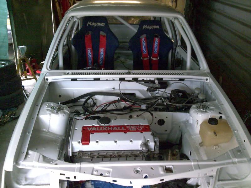

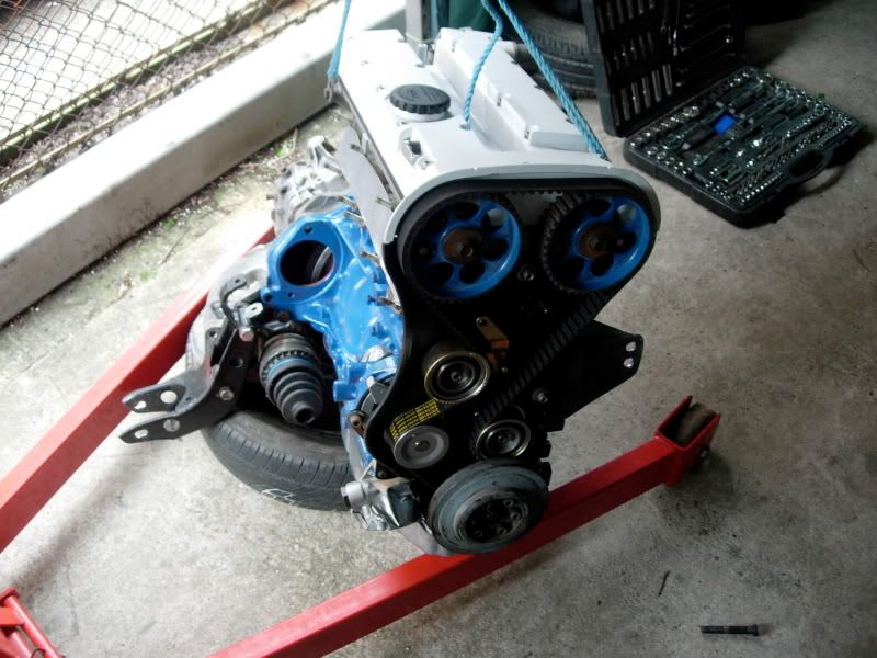

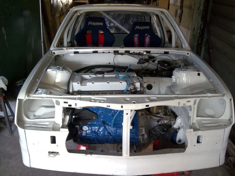

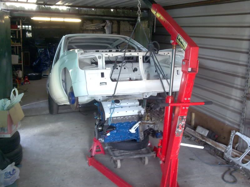

Engine getting ready for its new home
http://img.photobucket.com/albums/v3...a/DSCN2458.jpg
http://img.photobucket.com/albums/v3...a/DSCN2459.jpg
Rose Jointed linkage on (Sorry for the bluriness)
http://img.photobucket.com/albums/v3...a/DSCN2460.jpg
In from the bottom, nearly there!
http://img.photobucket.com/albums/v3...a/Image103.jpg
And in on the front 2 mounts, before all the problems arrose!! lol
http://img.photobucket.com/albums/v3...a/Image104.jpg
http://img.photobucket.com/albums/v3...a/Image105.jpg
very nice love the mint brakes in the rear beam top marks :thumb:

These solids sound like a right ar$e!
For the engine mount - did you have to put the bolt through the chassis like Adam did?
looks really clean mate
You mean he had to drill through the chasis leg to get a bolt in?? I didn't do that, I bolted it on loosely first and had to use a pry bar to tighten it as my spanners were to thick to fit up the back of it...Quote:
Originally Posted by The Simps
I'm not sure if the conversion bracket I have is right for solid mounts as were it sits with no pressure on and without pulling the bush right out to one side is about half inch away from the mount, hence why i'm going to space it. Need to get a pic, but was trying to get it done last night that taking a pic didnt even cross my mind! lol
And as for the front gearbox mount, it can slide about between the two chasis brackets, so do I need a spacer in to stop it from moving? again it will be easier to see what im raving on about with a pic! lol

I didnt have to drill anything, the holes are already there in the chassis leg..
So i assume the drivers mount i have was designed to be fitted like i did, and make use of the holes....
Originally Posted by Adam
I had a look at mine the other day and there's is a hole that goes right through but the plate kit covers it up. Easy enough to drill through tho.
Yep, thats the hole i made use of :)

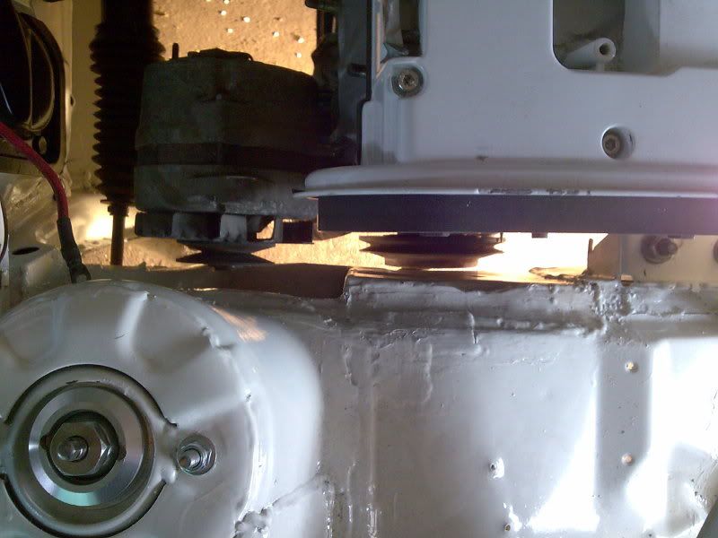

Few pics of the how the mounts are sitting after faffing with them to get the engine sitting right with no tension on any mounts...
Front Engine mount had to be spaced between mount and bracket
http://img.photobucket.com/albums/v3...a/DSCN2461.jpg
Rear Gearbox mount hole elongated
http://img.photobucket.com/albums/v3...a/Image109.jpg
Clearance on Front Gearbox mount
http://img.photobucket.com/albums/v3...a/Image107.jpg
Alternator clearance
http://img.photobucket.com/albums/v3...a/Image088.jpg

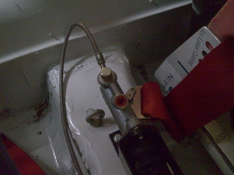

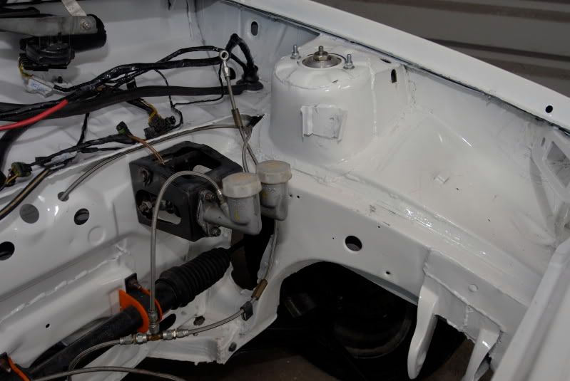

Brake lines in progress to the handbrake with some banjo's
http://img.photobucket.com/albums/v3...a/Image108.jpg

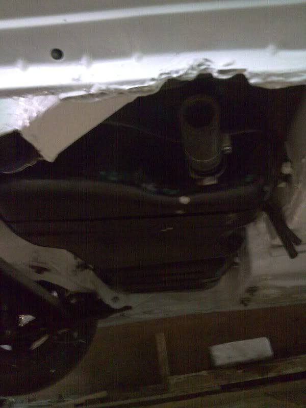

Fuel Tank In

You have more clearance than i do on the gearbox bolt/mount.
Comming along well well dude, love the hydo handbrake. Everything looks good in the bay.
Is there a particular reason as to why it needs spacing out?
Also, how come the rear mount needs elongating? noticed Stubbs has also done this? I've never need to do this, yes its tight, but surely you want it to be held tight in place?

Mine wasnt tight, it was impossible to fit :thumb:Quote:
Theres no way the rear mount would fit without elongating the hole/re-drilling it
The bolt should "clamp" the bracket to the mount hole to stop it moving anywhere, so it should be 'reet.
Quite a few others have had to do it too with solid mounts :)

I have had it bolted up without modifying or spacing any mounts, but there was so much stress from the rear gearbox mount that it was pushing the front gearbox mount right forward, and the drivers side front engine mount had pulled the rubber bush through in turn pulling the bolt head over so I couldn't get a spanner on to tighten it and had to use a pry bar... I just wasn't happy with the engine stressing all the mounts as to me if there under stress before anything is able to move then they can't do there job when there meant too.Quote:
Excuse the shocking drawing but below shows how the mount was sitting unspaced and with the washers on
