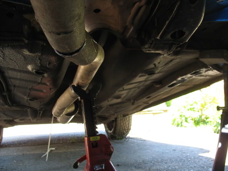

Exhaust is "finished" with my bodged plate.

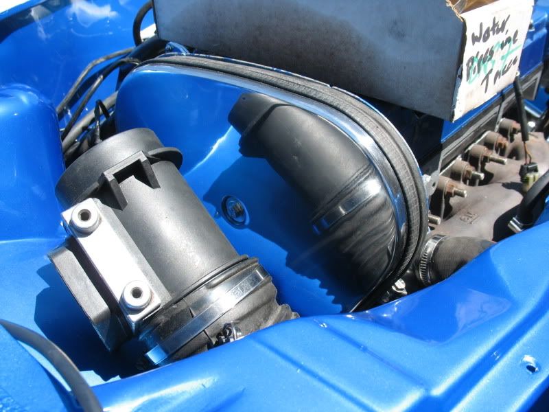

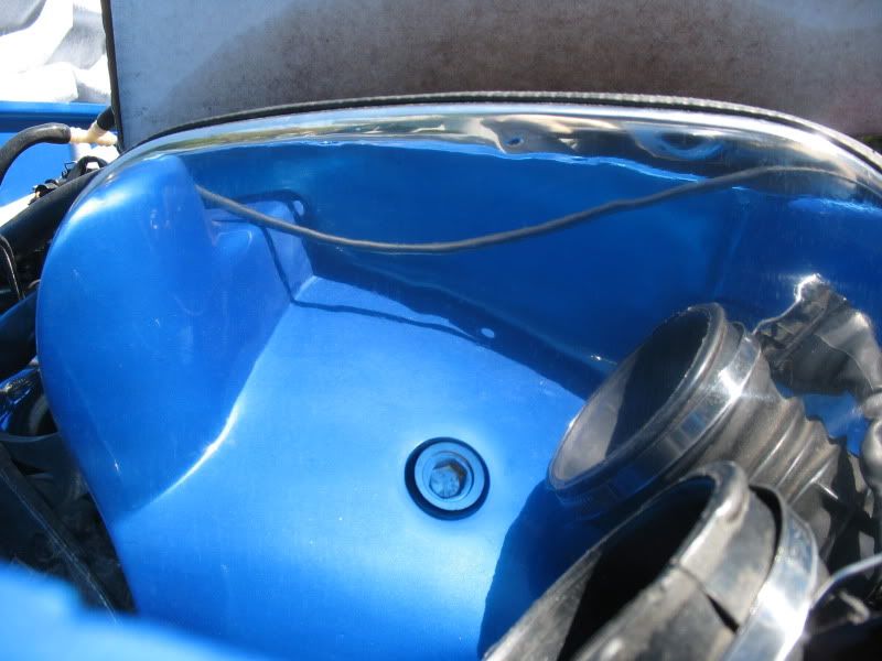

The long awaiting (which turned up today) replacement elbow and clearance mod..
http://img.photobucket.com/albums/v3...s/IMG_7829.jpg
Ooooo shiney...
http://img.photobucket.com/albums/v3...s/IMG_7831.jpg
http://img.photobucket.com/albums/v3...s/IMG_7833.jpg
http://img.photobucket.com/albums/v3...s/IMG_7834.jpg
http://img.photobucket.com/albums/v3...s/IMG_7838.jpg
My exhaust mod..
http://img.photobucket.com/albums/v3...s/IMG_7836.jpg
http://img.photobucket.com/albums/v3...s/IMG_7837.jpg

Can't quite beleive the front panel hackage benn! Me likes the long sniney inlet pipe though!
