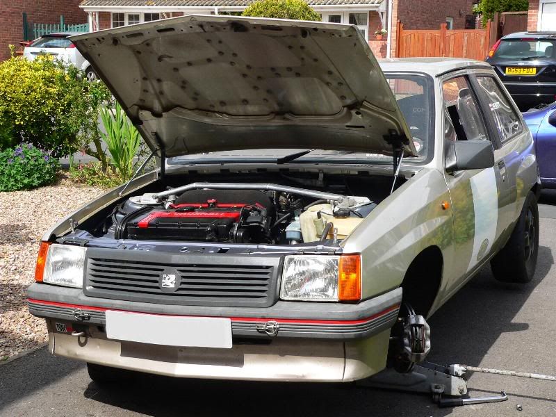

Well all the important jobs are done for tomorrow.
- re-centred steering wheel, dead easy with snap off system

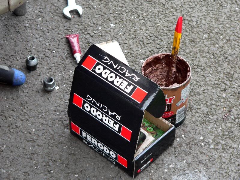

- put new brake pads in, but have to put some serious mileage on them today to bed them in

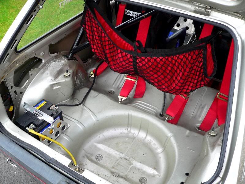

- finished relocating battery to rear left
- sort out a dodgy stud/ nut on my wheels
- slightly modified chassis to gain clearence on steering arms lol
brake pad swap in process
http://i136.photobucket.com/albums/q...ure/nc0878.jpg
ferodo ds2500s

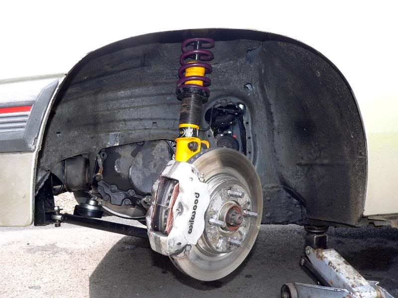

whilst putting them on, i noticed i was not getting full full lock, and due to castor changes,
http://i136.photobucket.com/albums/q...ure/nc0882.jpg
the steering arm was fouling
http://i136.photobucket.com/albums/q...ure/nc0881.jpg
got the hitting stick out and sorted that for clearence
and new battery position which helps a great deal

Looks good Olz, I forgot to mention I had to do the same to Ads shell to get the steering arms through.
