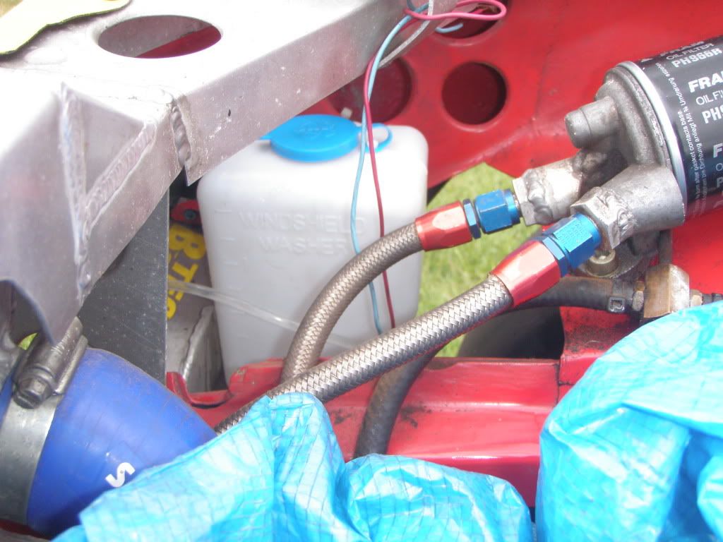

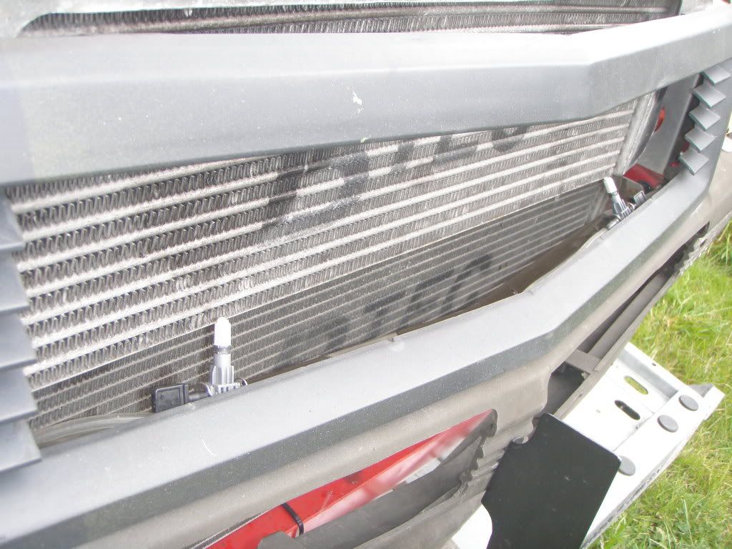

Managed an hour on the car today, so here's a progress report;
Intercooler Spray System now piped up, filled with water and methanol, and all tested. It just remains for me to wire in a switch to activate it;
http://i285.photobucket.com/albums/l...ort/010-26.jpg
http://i285.photobucket.com/albums/l...ort/009-24.jpg

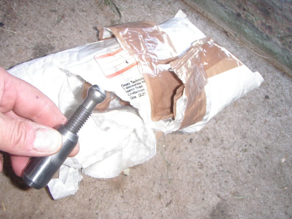

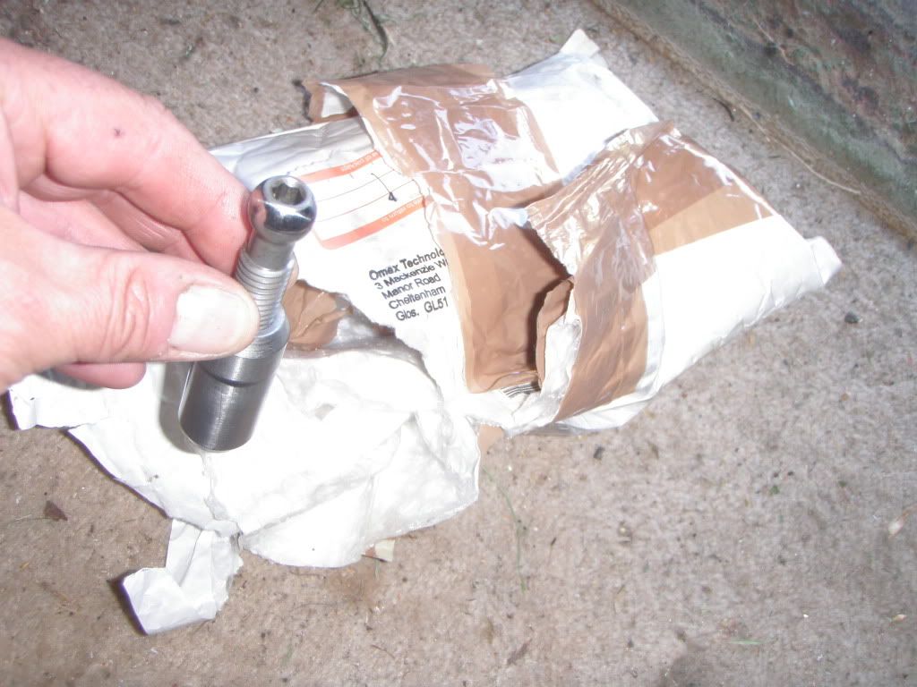

Solid lifters (Kent Cams top adjustable) ready and waiting to be fitted to the engine;
http://i285.photobucket.com/albums/l...ort/014-19.jpg
http://i285.photobucket.com/albums/l...ort/015-20.jpg

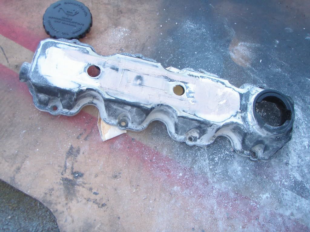

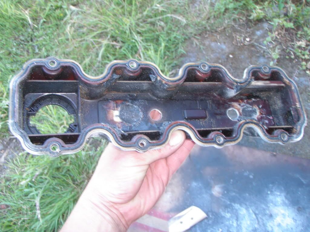

Work in progress on the rocker cover (last time attempt was not a 100% success);
http://i285.photobucket.com/albums/l...ort/016-23.jpg
http://i285.photobucket.com/albums/l...ort/017-26.jpg
I will plastic weld in some more oil splashguards when I'm happy that this one isn't going to leak from around the breather pipe unions.

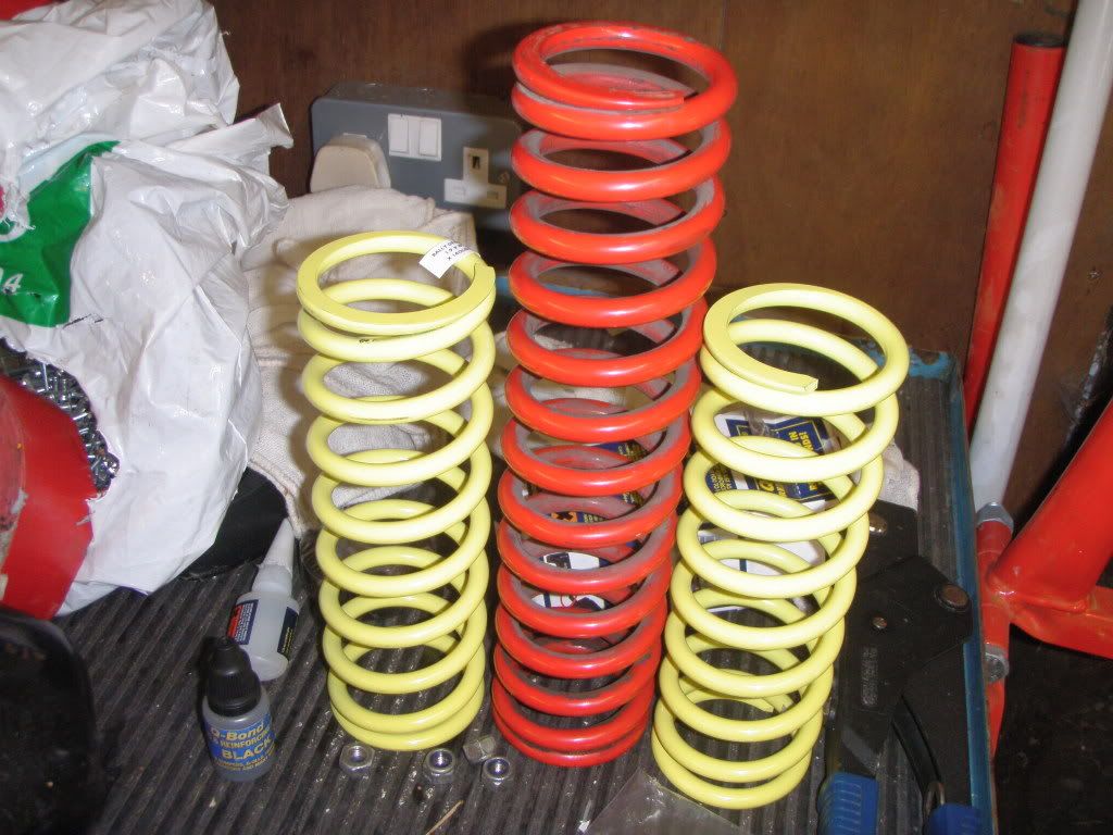

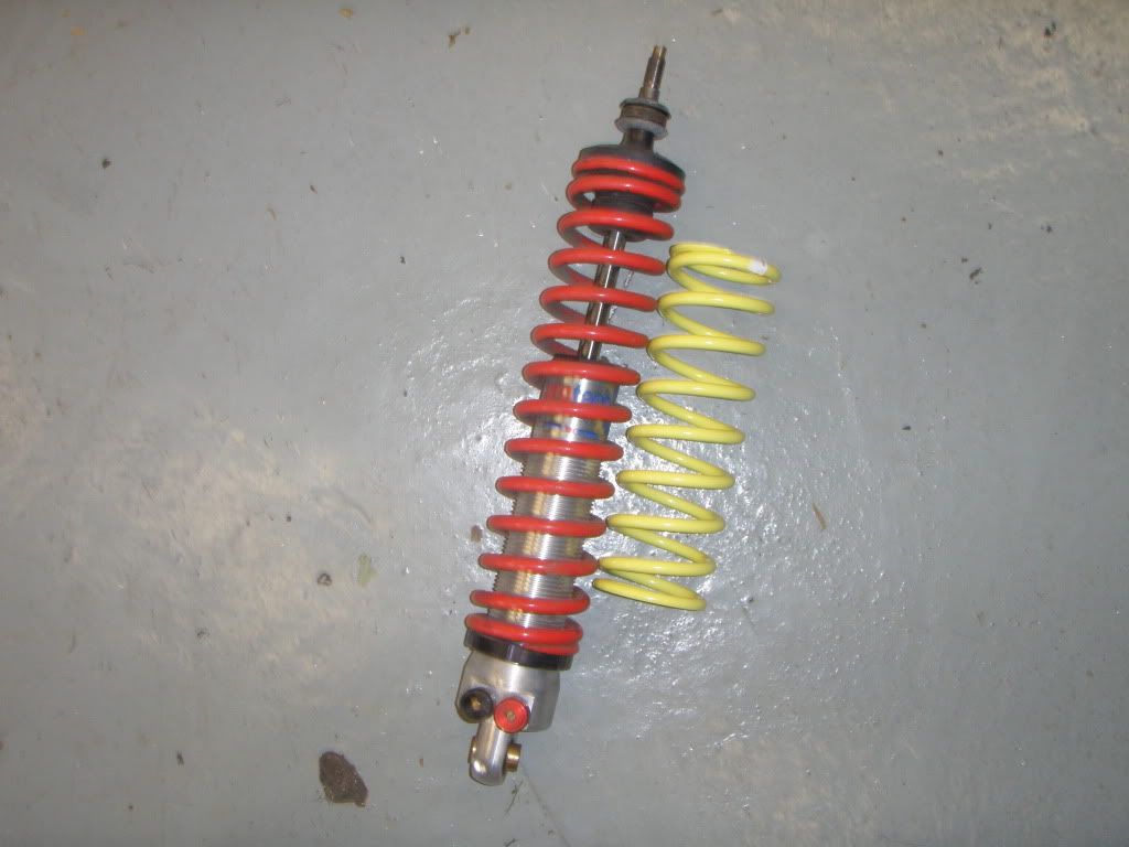

And for a long time I've been meaning to get some lower rear springs. The originals were 11 inches long, and I had to wind the coilover platforms right to the bottom of their adjustment to get them to fit.
So I ordered some 8" ones which are much more suited, and have the added bonus of being HALF the weight of the 11" ones!!;
http://i285.photobucket.com/albums/l...ort/011-22.jpg
http://i285.photobucket.com/albums/l...ort/012-22.jpg
http://i285.photobucket.com/albums/l...ort/013-16.jpg
Colin,
I am intrigued to know how you adjust the solid followers when fitted?
Are there any lock nuts?
Do the followers have holes in for the allen key?

Rally Design springs?
