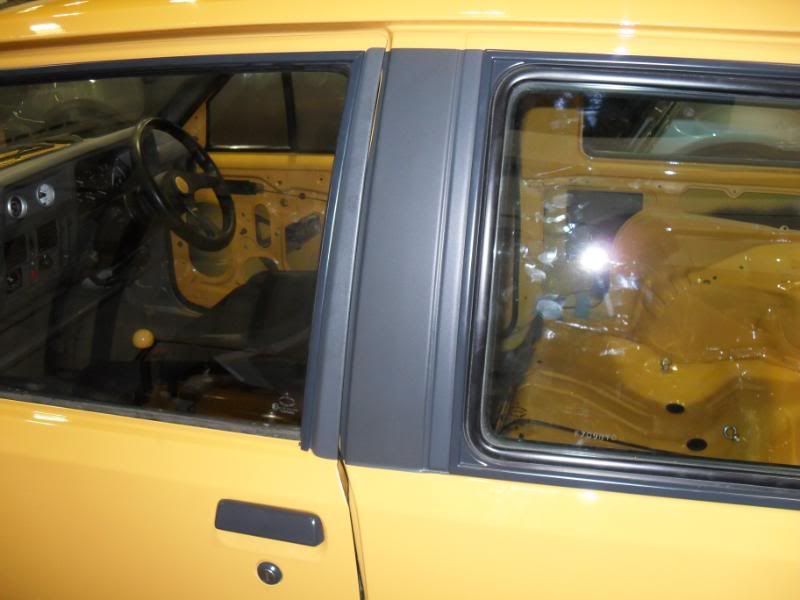

On to an update then.......... Another weekend of long hours has seen a fair bit of progress on the car. Window surrounds were painted up in the same grey Ive used on the majority.......
http://i84.photobucket.com/albums/k2...g?t=1269890920
http://i84.photobucket.com/albums/k2...g?t=1269890954

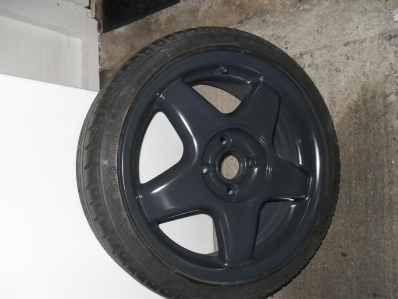

Along with my spare allesio for the boot etc...
http://i84.photobucket.com/albums/k2...g?t=1269891230

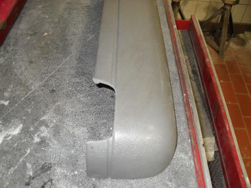

Previously both doors have been a pain to shut as the cage bolts catch on the door card pockets which had resulted in the pockets cracking. A short while ago I collected a full set of mint interior cards from Sloth and thought Id try to reslove this problem from happening again. This is what I came up with after a little die grinder session......
http://i84.photobucket.com/albums/k2...g?t=1269891595
http://i84.photobucket.com/albums/k2...g?t=1269891786

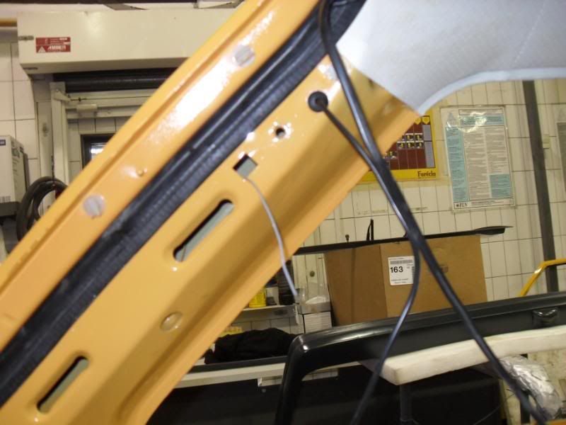

Neatly done and it should fix that problem! Another thought I had pre paint was a memory of brett warburtions old car now owned by Matt.... The interior B and c pillars were left open after painting which looked great. So when I painted the rear I went up there too. Ive trimmed the necesary parts off the headlighning and was left with this.....
http://i84.photobucket.com/albums/k2...g?t=1269891964
http://i84.photobucket.com/albums/k2...g?t=1269892078

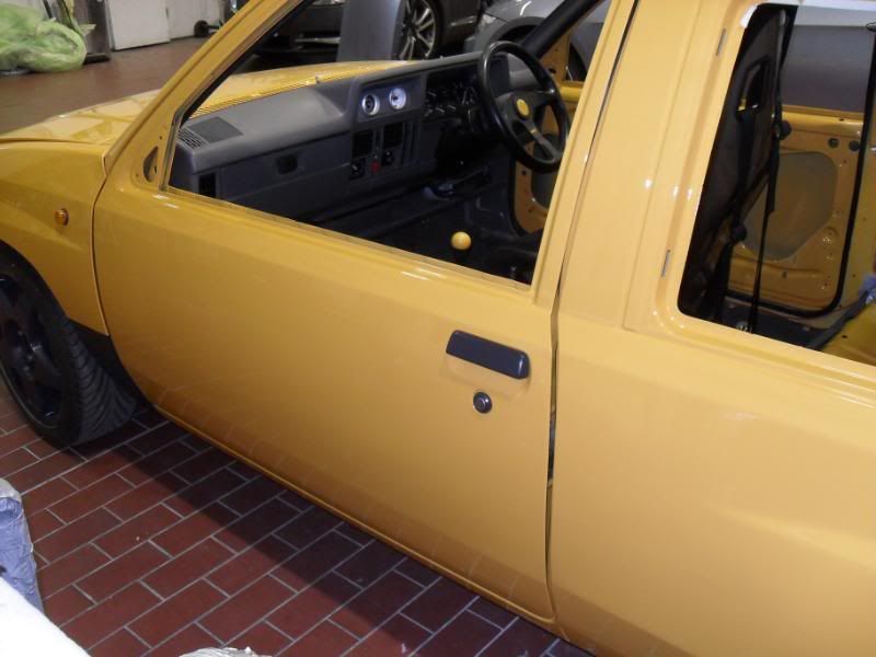

The drivers door then went on........
http://i84.photobucket.com/albums/k2...g?t=1269892444

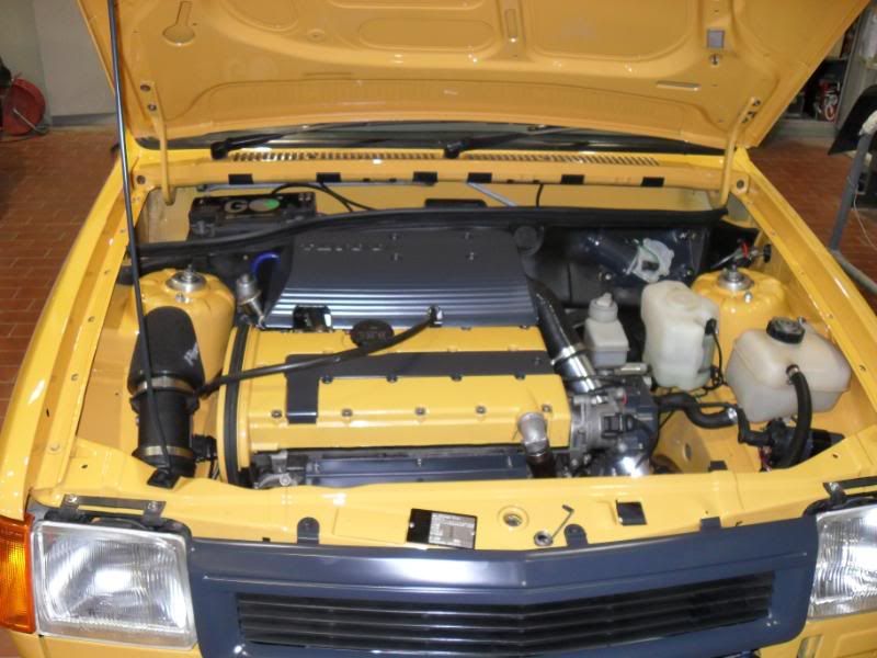

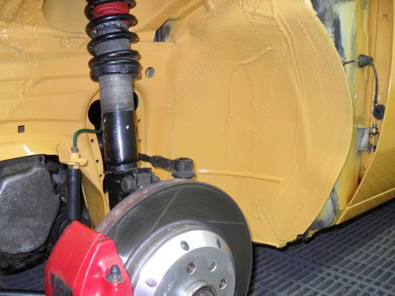

Then I was left with the headache of what to do with the bay.... I didnt want to go through the full procedure of painting the bay with the motor and box in and as the bay saw paint only a short time ago when shaun converted the car it was in great condition just a little dull for my liking. The slam panel had a few chips.marks here and there so what I decided on was to paint the slam panel but clear only over the original yellow already in the bay around the strut top areas,inner wings etc to re gloss them. The engine bay and slam panel areas were fully stripped apart from the motor/box and I cracked on. Once built back up I was very pleased with the results.......
http://i84.photobucket.com/albums/k2...g?t=1269892895
http://i84.photobucket.com/albums/k2...g?t=1269892916
http://i84.photobucket.com/albums/k2...g?t=1269892935
The engine bay now matches everything else being uber shiny! Following that a few more parts when back on after work today.... The gm 3 piece pillar vinyl set was applied and rear windows went in.....

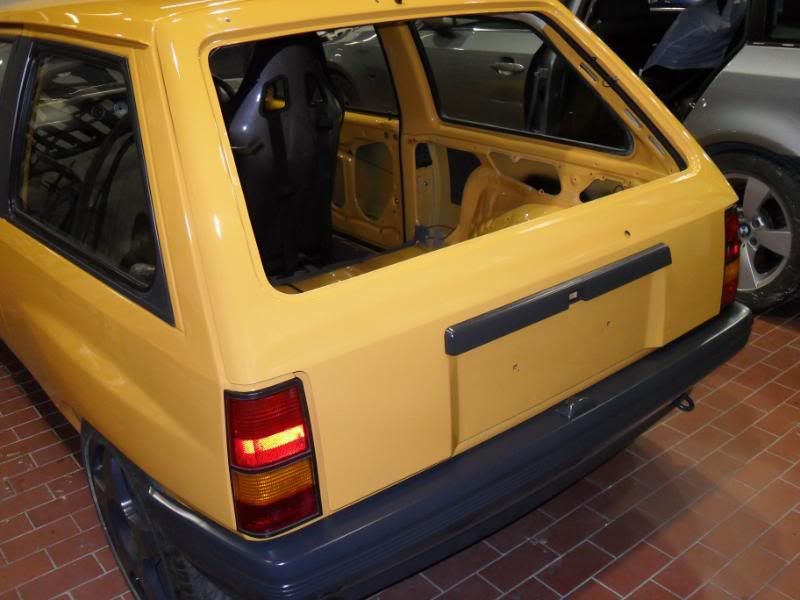

The rear bumper,smoothed and painted boot grab and rear lights also went back in with my new euro fog as Im not a fan of the reverse light.......
http://i84.photobucket.com/albums/k2...g?t=1269893192
http://i84.photobucket.com/albums/k2...g?t=1269893269

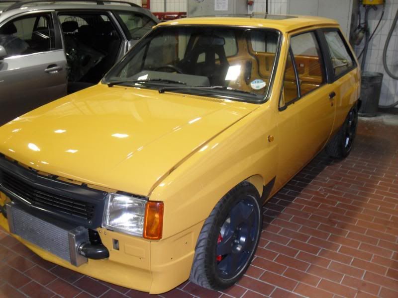

Both doors were then built up and its now almost looking like a car again!........
http://i84.photobucket.com/albums/k2...g?t=1269893361

Glad that you also done the strut tops, i never liked looking at them when i popped the bonnet they were still the original paint, dont know how they got missed in the first place.
